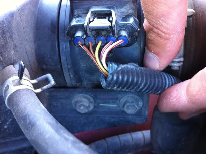

    So I'm about to do my spark plugs and clean the MAF and throttle body while I'm at it.
    All the write ups I saw said to remove the two mounting screws on the MAF.
    Mine doesn't have mounting screws. Mine has two bolts at the bottom (see pics).
    I found this thread: http://forum.ih8mud.com/95-gen-toyota-trucks/445033-1998-tacoma-3-4-maf-sensor.html which explains my situation.
    So I just undo those two bolts, remove the whole fandangled thing from the air intake tube and look for the wires to clean?

    Im not 100% sure what your question is, but those two bolts do indead hold the MAF sensor on the intake. Remove those two bolts and pull the MAF sensor out

    yes its the two bolts, i believe 10mm. I used a good flashlight to to look into the tube to see the two wires, and to clean them. mine was dirty, i did it 3 times, soaked, let it dry, and 2 more times.

    Also loosen the tube clamp right behind your thumb

    Yeah I'm doing my spark plugs, so I was going to take that whole tube out for better access.
