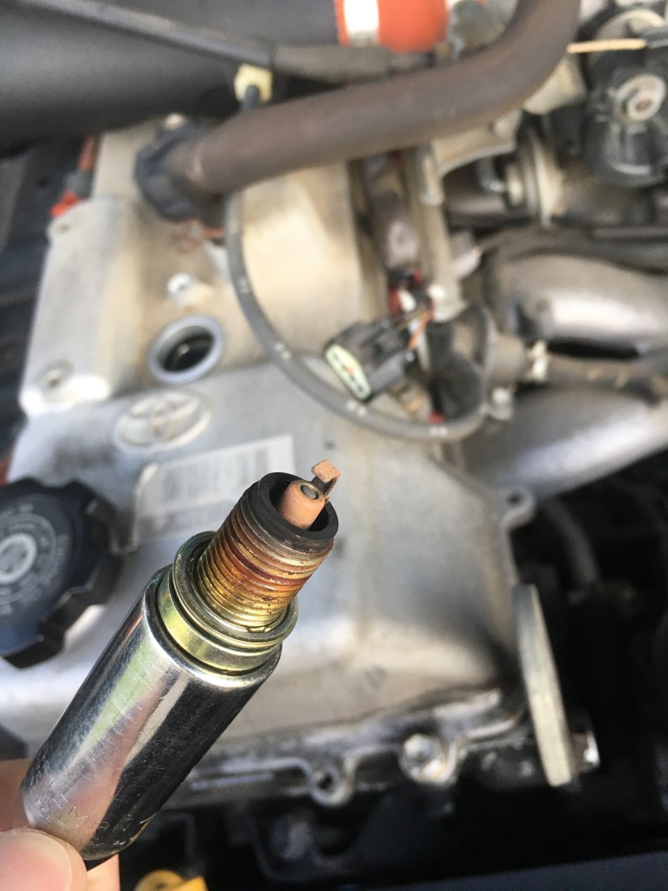

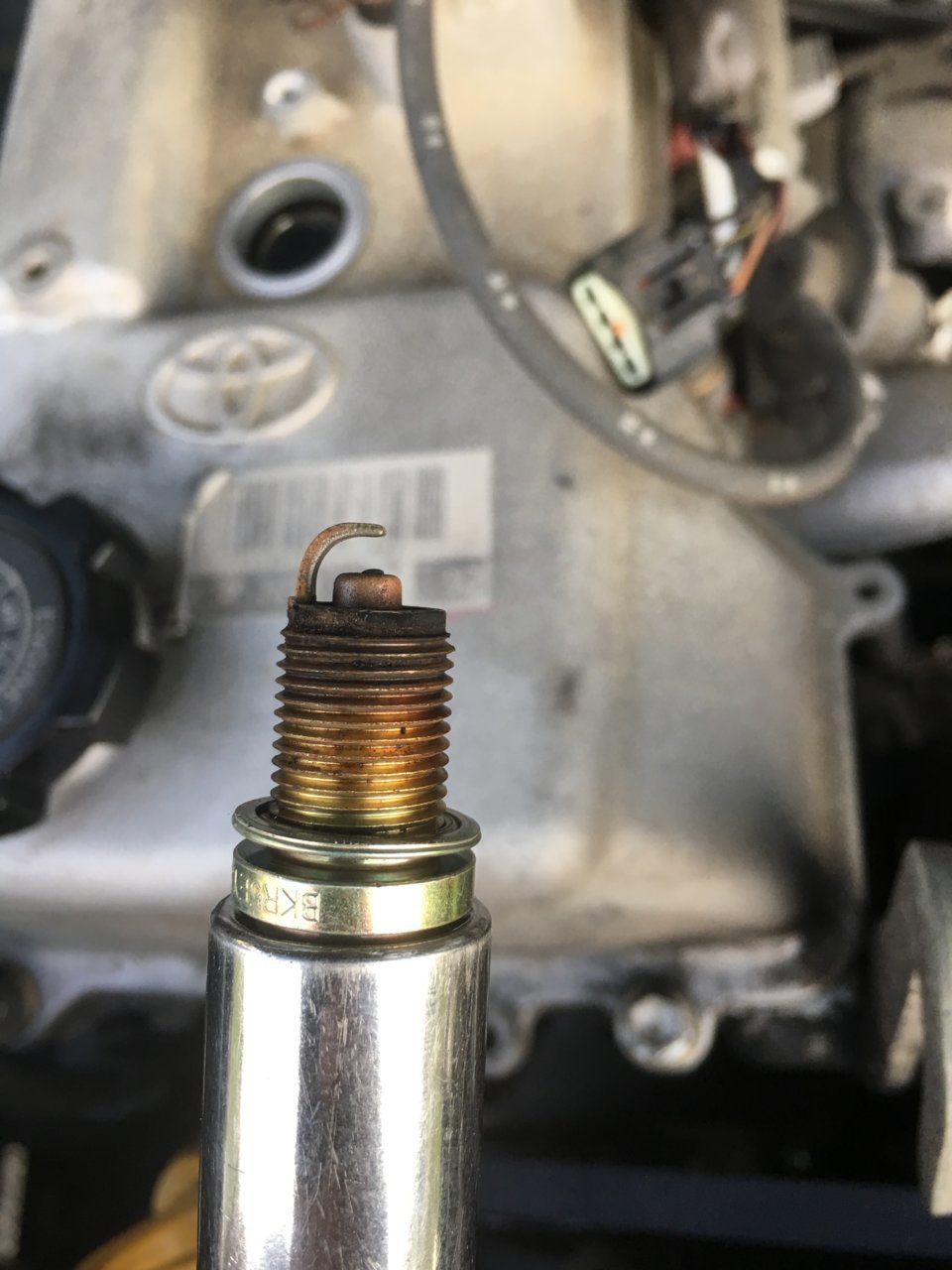

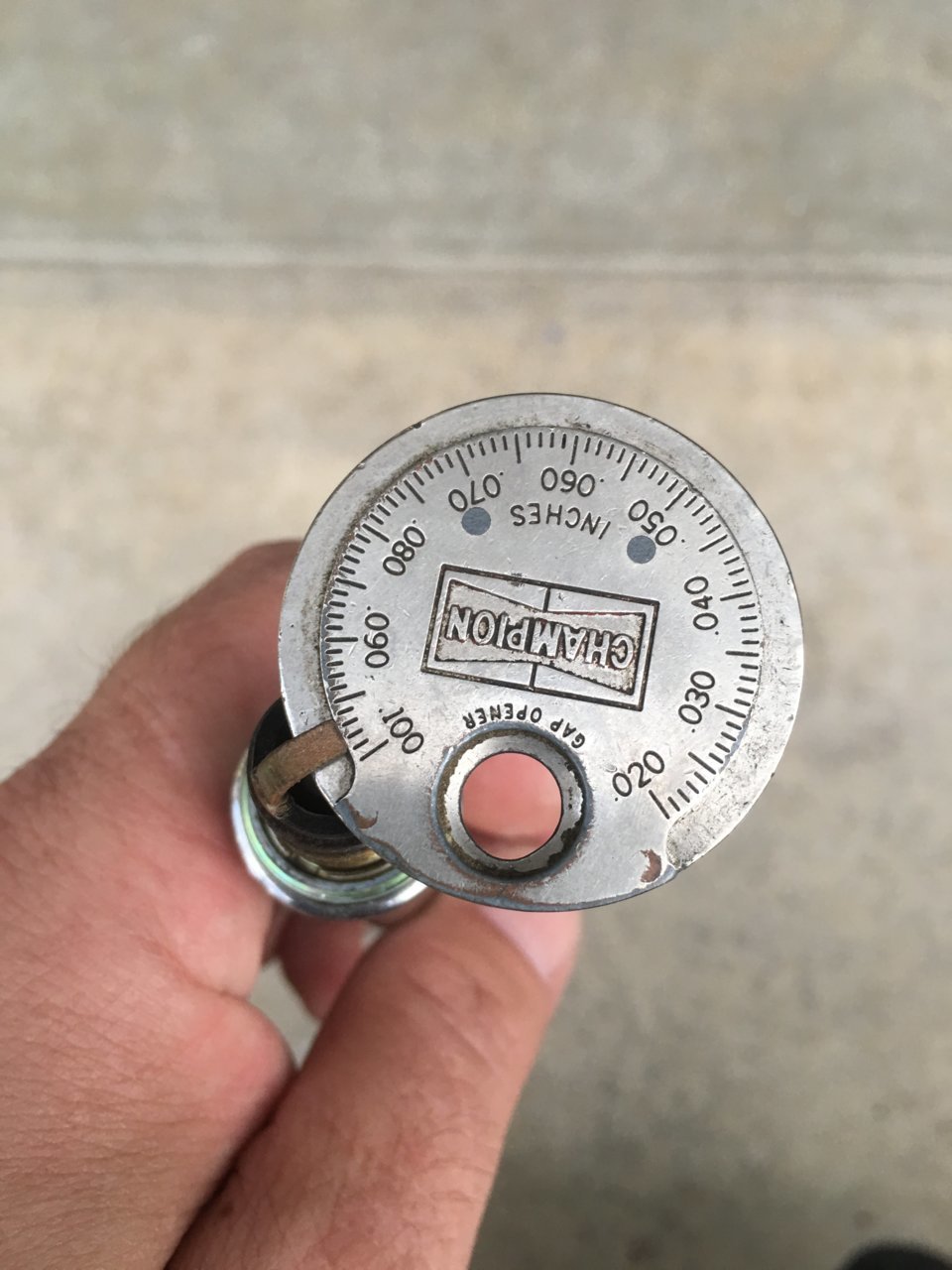

    Got all motivated on my way home and stopped and picked up some spark plugs and a fuel filter. Keeping with the lack of previous maintenance theme... I think these plugs were original 167,000 mile plugs. AE65557E-6292-4D27-A97A-D48B3967DCB7.jpgFCFA91C8-6DB8-4683-8E6E-3797DE9A7577.jpg
    My helper was out with me through the first plug. Guess I’m boring.
    My only thoughts after doing the plugs are its a testament to how unkillable these trucks are. Also, there’s nowhere inside that engine bay to set stuff down. They should have designed in more flat surfaces for the mechanics. On my old F250 I had acres of space to set tools.
    Excited to take it for a spin tomorrow and see if there’s improvement. I can’t see how it could not be a huge difference.

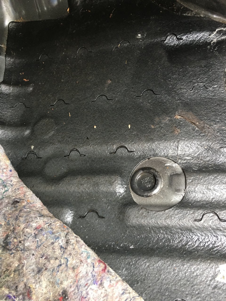

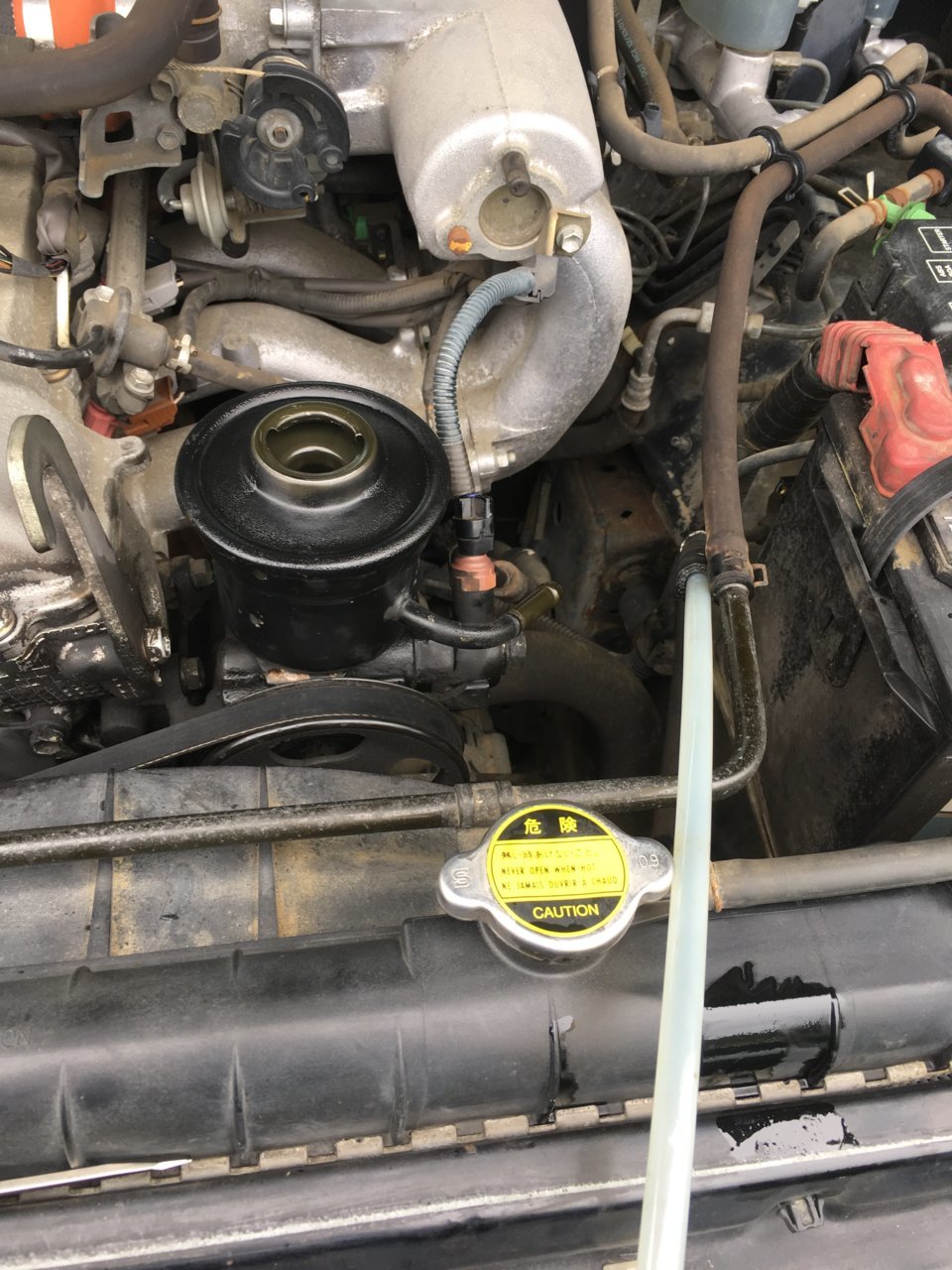

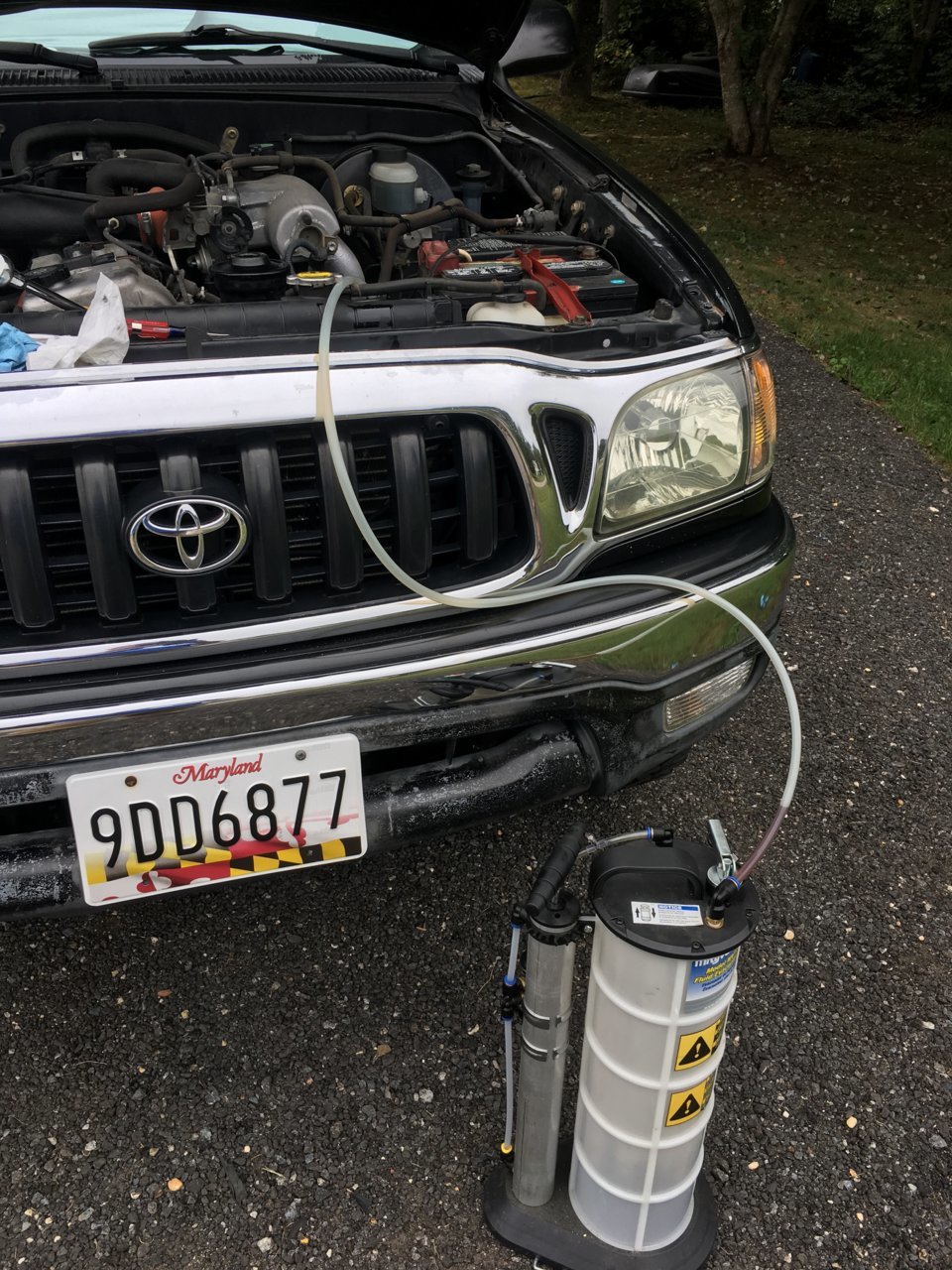

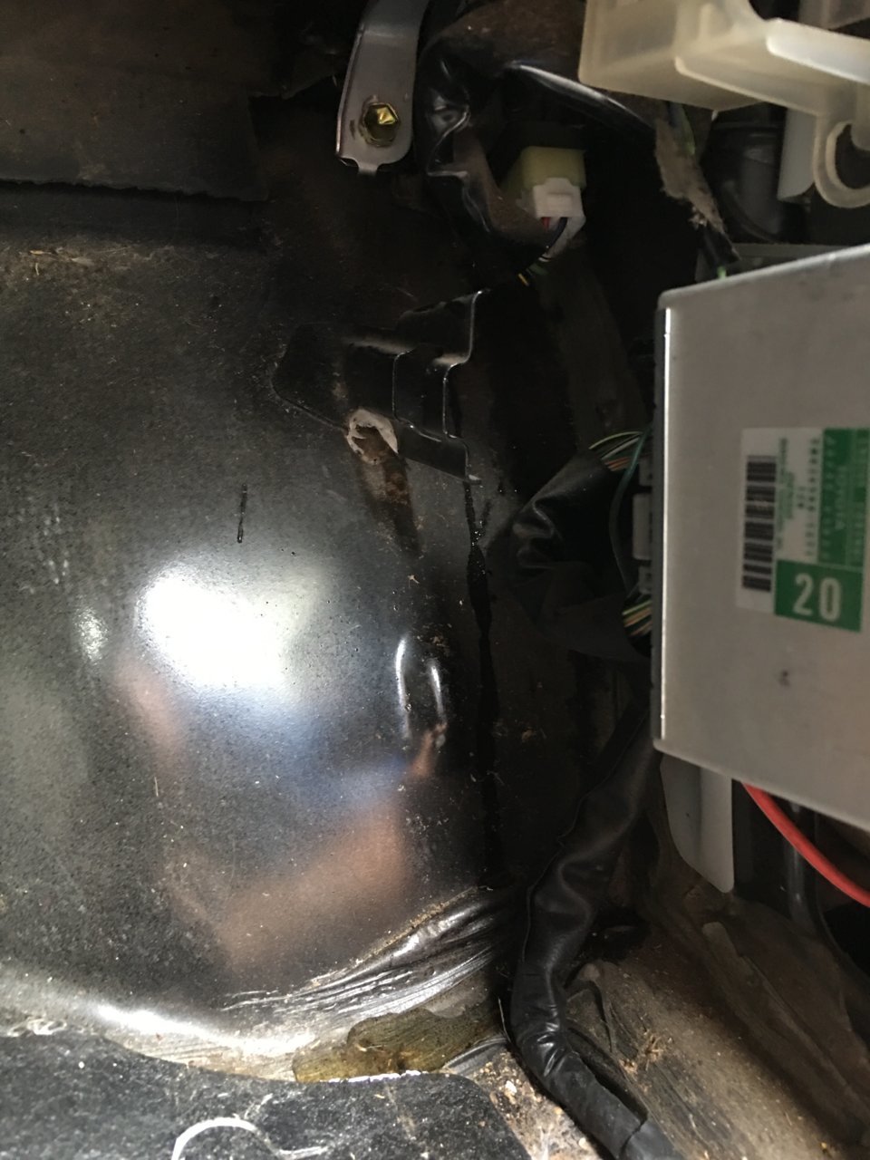

    Bit of a good news bad new situation today.
    First off my power steering fluid flush and fill went pretty well. Used the fluid extractor to suck out everything in the reservoir then I popped the reservoir off to check the screen. It was pretty clean but I cleaned it out anyway to be sure. Jammed the fluid extractor into the return hose and basically emptied the system. Then ran some good fluid through it by plugging the reservoir with my finger and spilling ATF all over the place while I tried to fill and pump the extractor at the same time. It worked but there are definitely cleaner ways to do it.
    F179F3E0-2BA2-4147-BBC0-7FF69A98ED58.jpg A50C4744-A295-4BFF-931E-6FB0A4765253.jpg

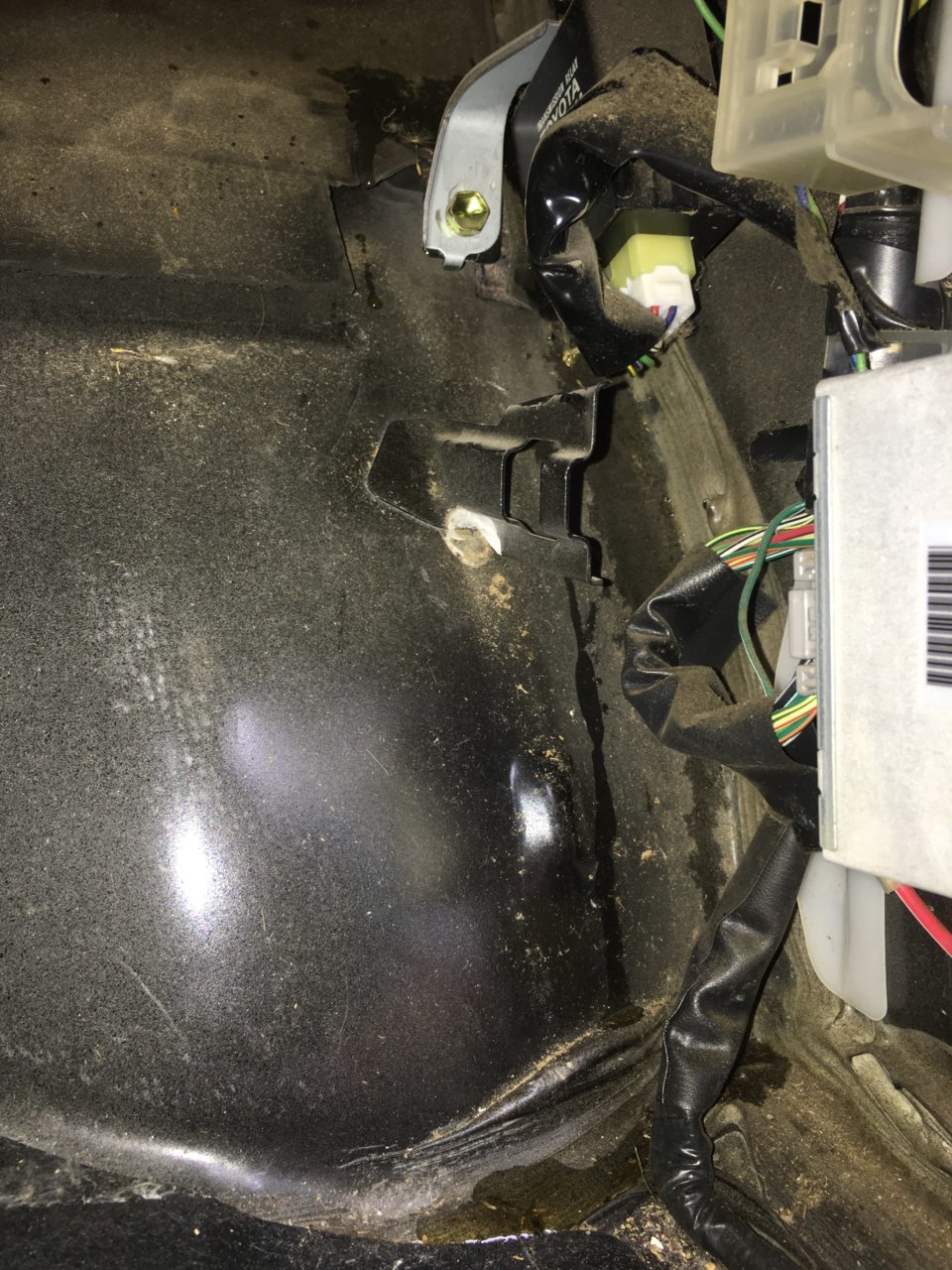

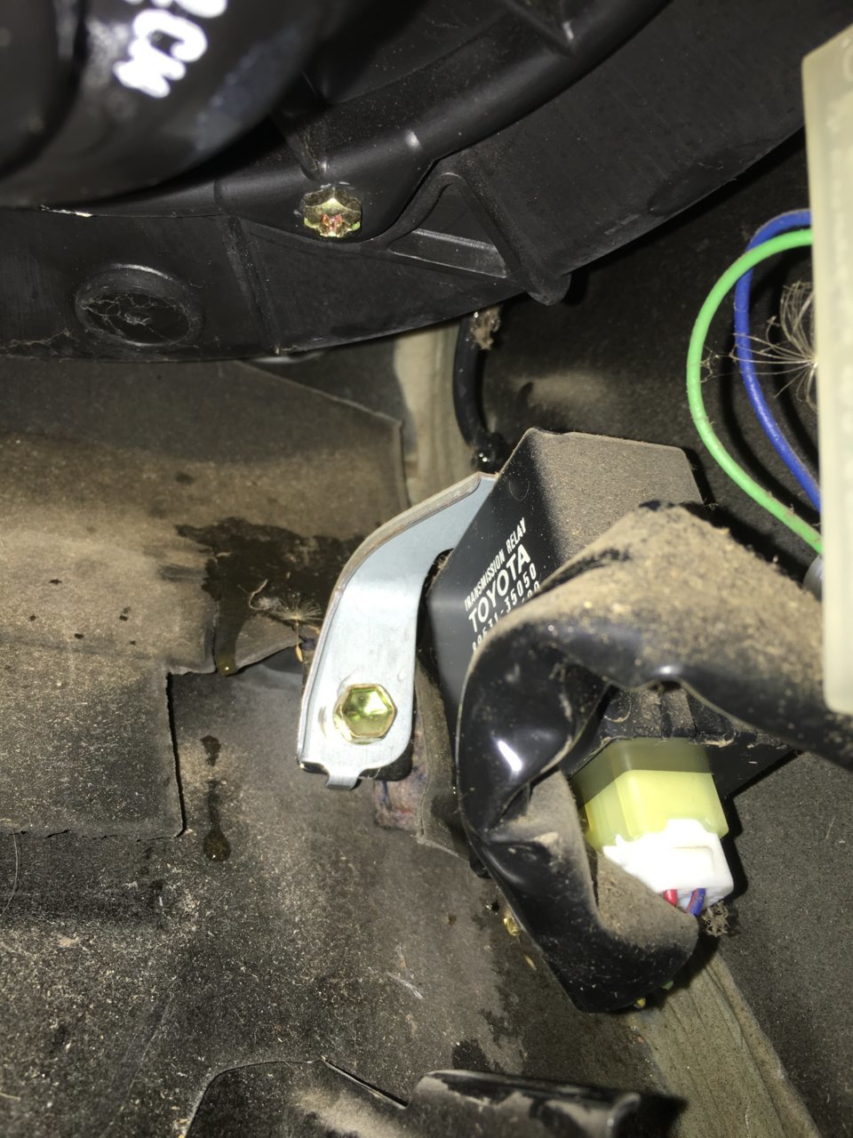

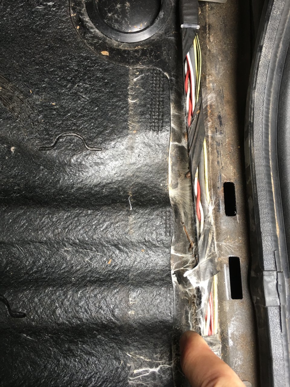

    Helper girl was out in full swing for me to diagnose the leak in the cab.
    Pulled the carpet up and it was damp. Which is crazy to me since it hasn’t rained for over a week. But made a nice discovery of some fungus growing under the carpet.
    Hard to see but the floor was wet.

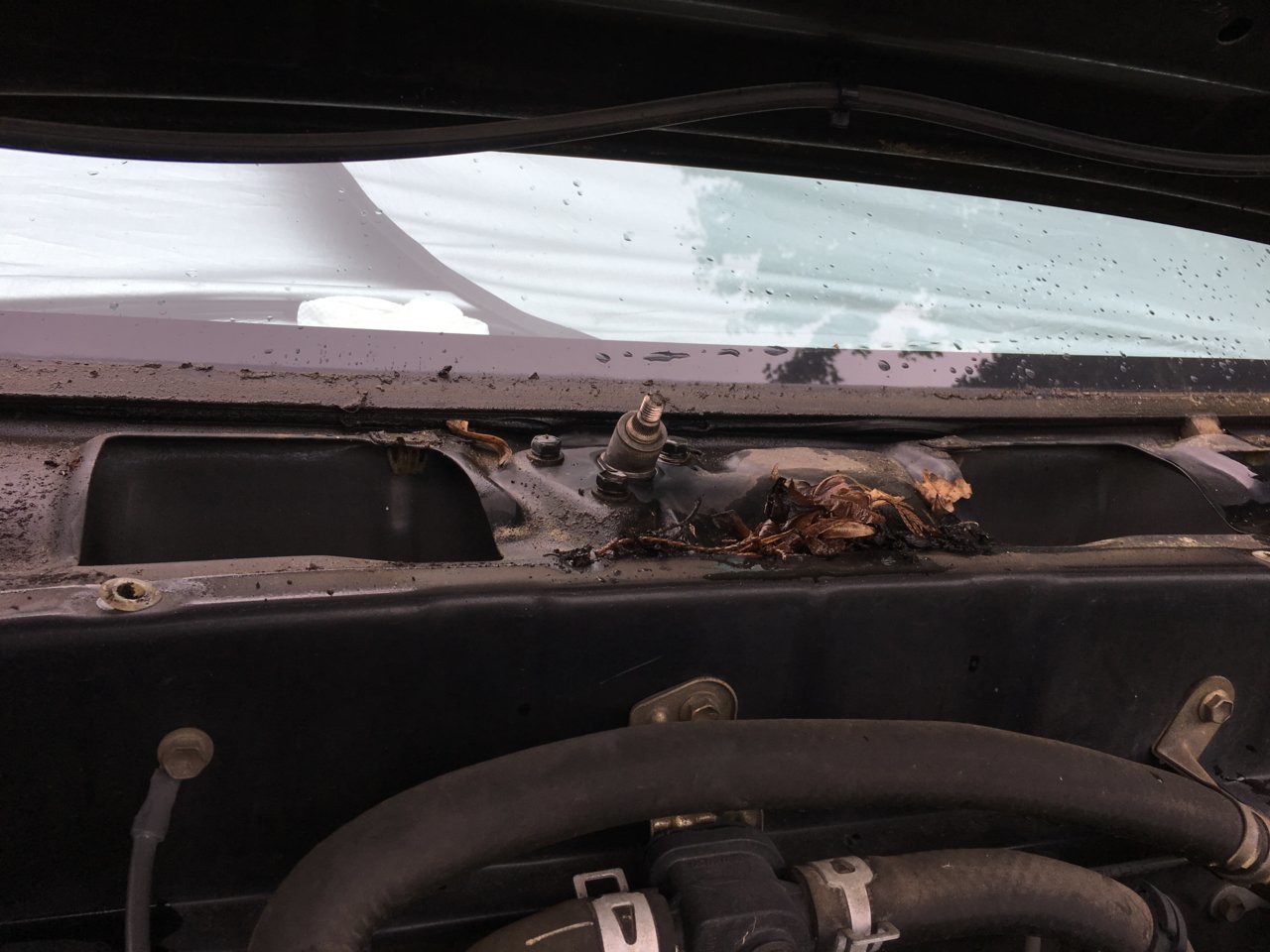

    Hosed down the cowl area trying to find any evidence of water leaking in. Nothing. No sign of anything running down the firewall either. At this point I was getting frustrated. Whatever I’m pulling the cowl anyway. So that was nasty.

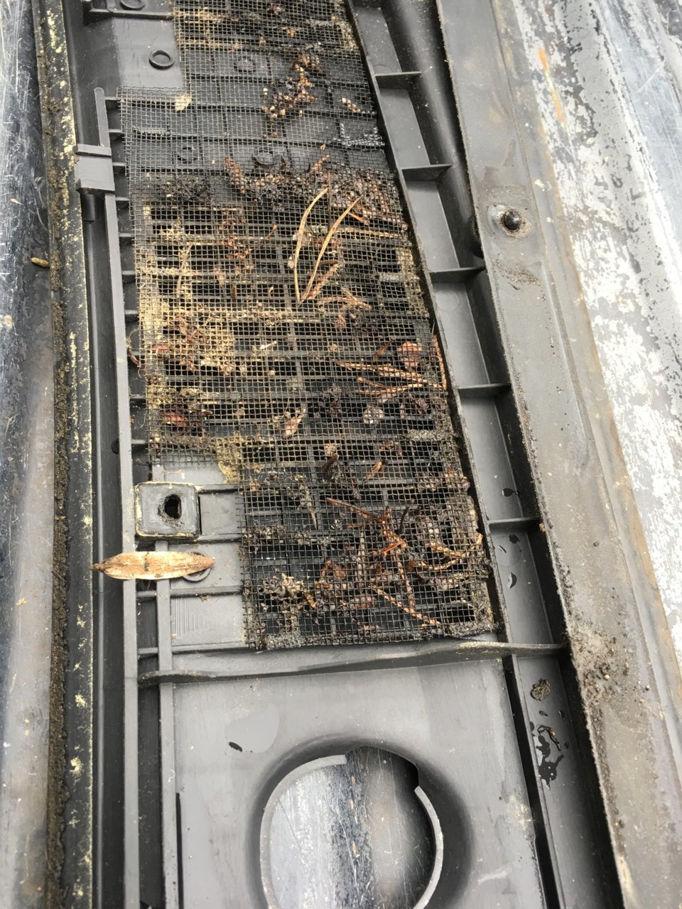

    81F2C659-E9A4-4C1A-ADF9-DFA3F09A764B.jpg 86358E61-1ADB-45ED-8705-D7C29F52C761.jpg
    Pulled the wiper motor and linkages off. It took me far too long to figure out how to get the linkage off the motor. Sprayed water all in the cowl and everything. Looked back in the truck expecting to see crap running down the firewall at this point annnnnnd nope.

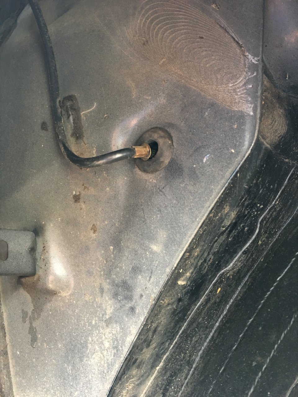

    But wait! What’s that in the corner? 4C87BE07-3802-4958-9A92-1BCD477C4F9D.jpg4986CCCD-F4F8-4FA5-9D1E-552F16BB2B69.jpg
    If you look close at this picture you can see the antenna wire is dripping. Right above the relay and below the heater box.
    Feeling around, I think the leak is only coming from where the antenna passes through the side of the cab. At least I’m hoping. So the good news is I found my leak! The bad news is that I might have done all that work to take off the cowl for nothing.
    Taking a lunch break with small right now and maybe I’ll figure it out while she’s napping.

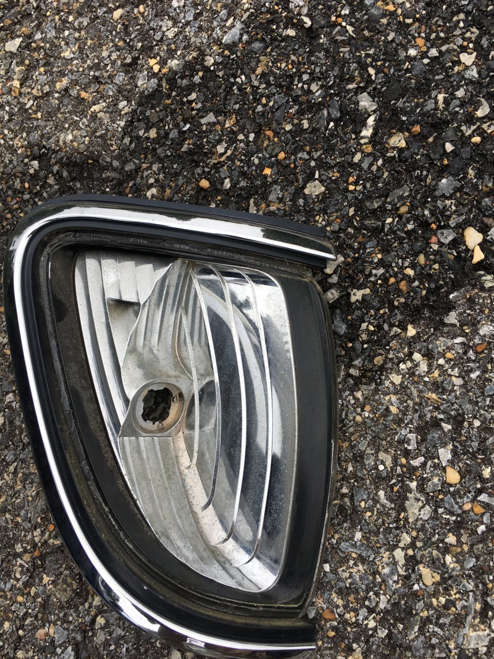

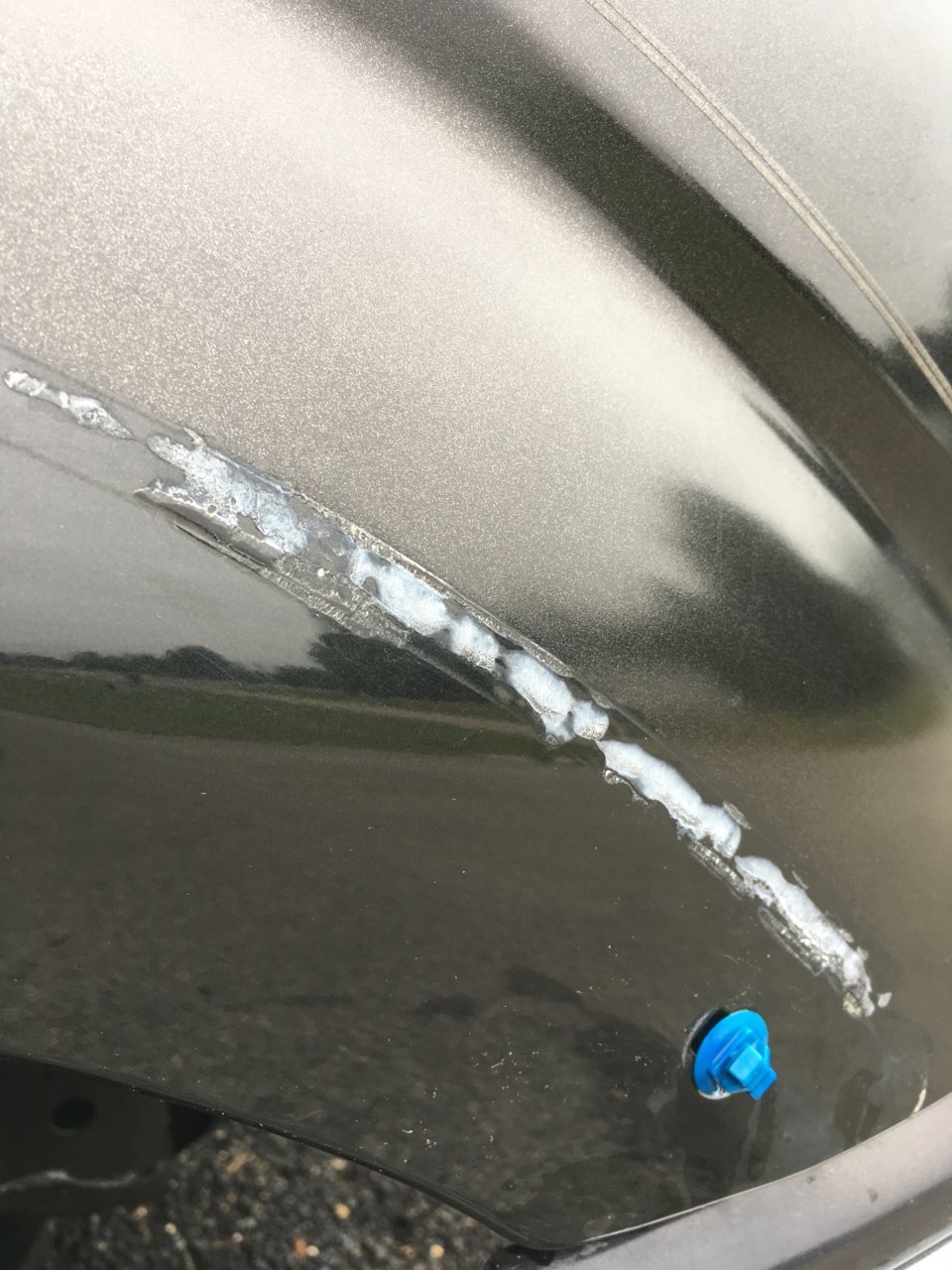

    Well the crappy part is that’s definitely not the leak. Sprayed really good under the cowl and there’s about a river coming in. And not through that grommet. So it looks like that can of flex seal wasn’t a waste after all. Pulled the flare and the fender liner. Of course broke clips along the way. So now I need to order those. Got to the grommet on the outside and while there may have been a tiny bit leaking in there, it wasn’t the source. That’s above the heater core.
    Decided I was going to pull the fender to get in the opening in the cowl under the fender because that’s where the leak seems to be coming from. Promptly broke my corner light. I knew it was crappy anyway because of how it looked inside but the lens was barely on the housing and I broke the top tab. 47E7D44F-60CD-4DF3-9CF0-70F1CD6DF0A3.jpg

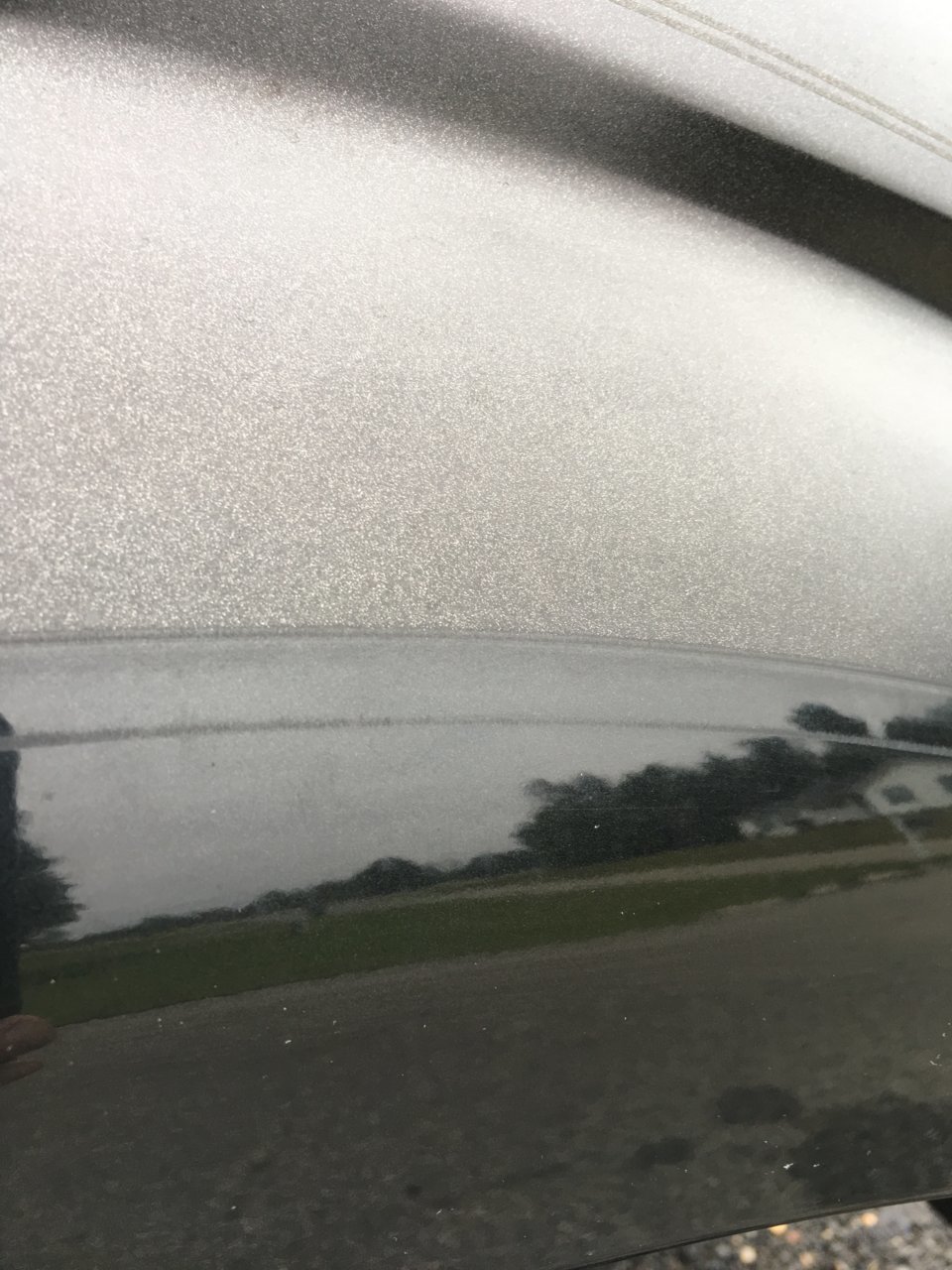

    And just to make it all come together... a previous owner obviously super glued the rubber strip on the fender flare to the fender. I’m guessing because it was popping out and they couldn’t get it to stay down. 48F93EF4-8877-44A8-B6C0-EAEE9D0A32A7.jpg
    Here it is after I cleaned it up and a couple shots of the factory paint under the flare versus the rattle can job that’s on the majority of the truck.
    Kiddo is napping and should be waking up soon so that’s about as far as I’m getting today without being a negligent father. I’ll probably sit here and order up some replacement clips for the flares and look into some new headlights and corner lamps. Glad I didn’t buy that new rear bumper I was debating!
