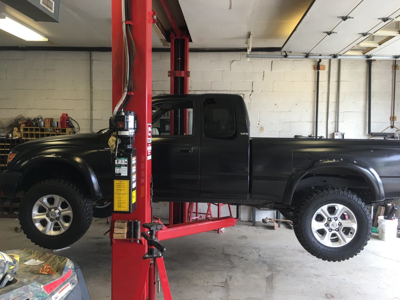

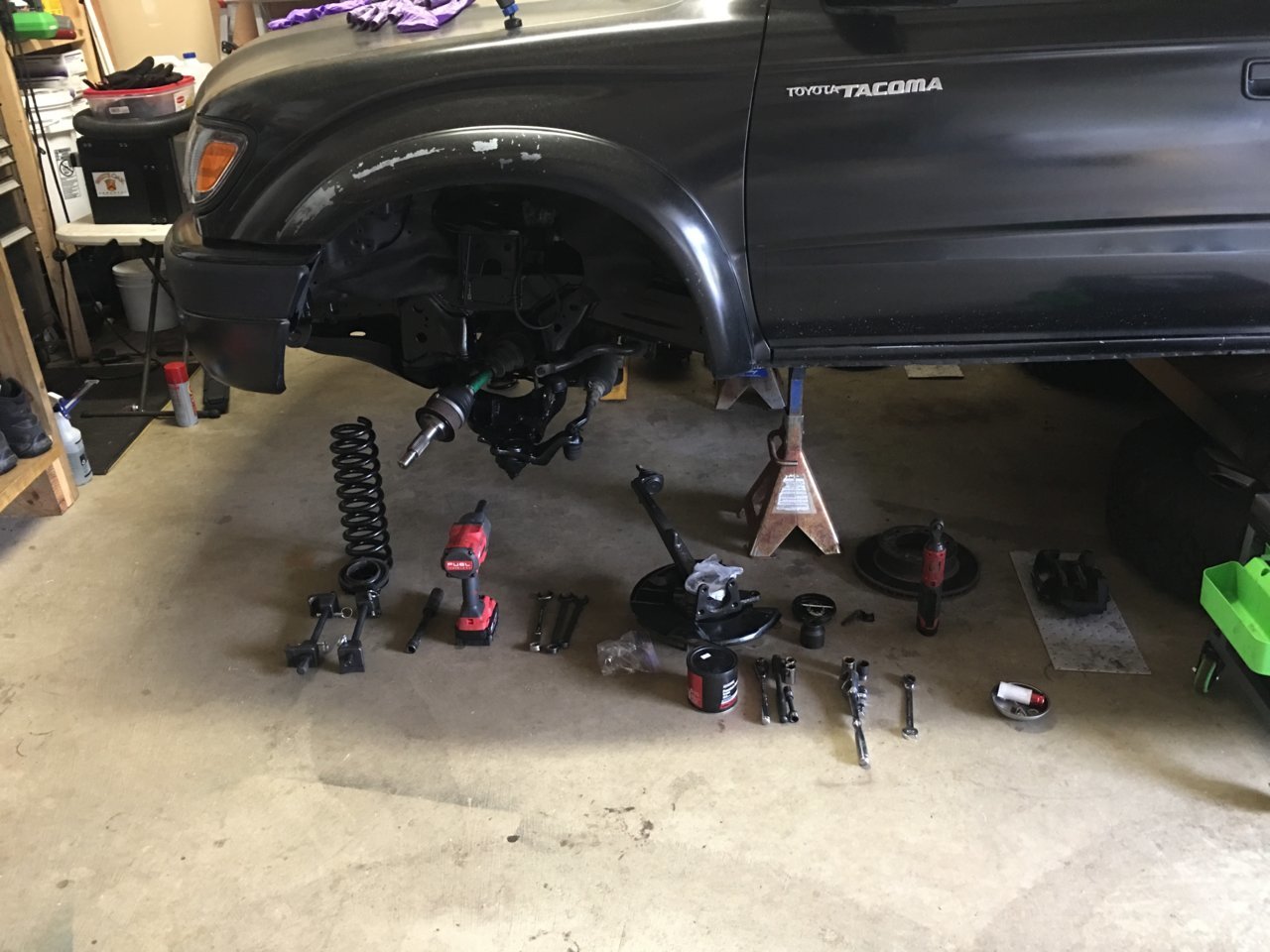

    For a while now I’ve just been beating the truck up and driving it around. It’s loud and obnoxious because of some bearings that need to be replaced and the mud terrains in it. But mostly I think it’s the wheel bearings.

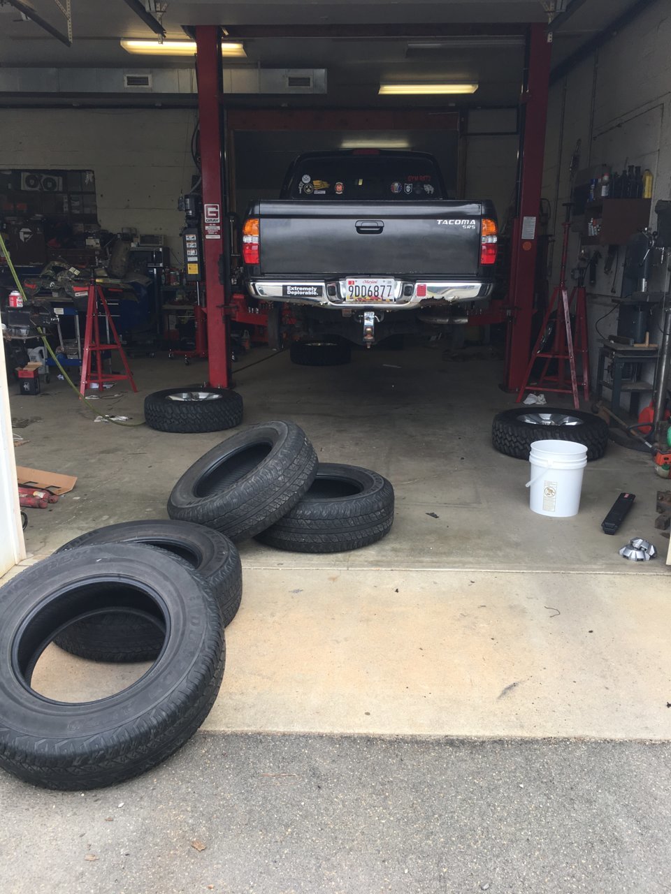

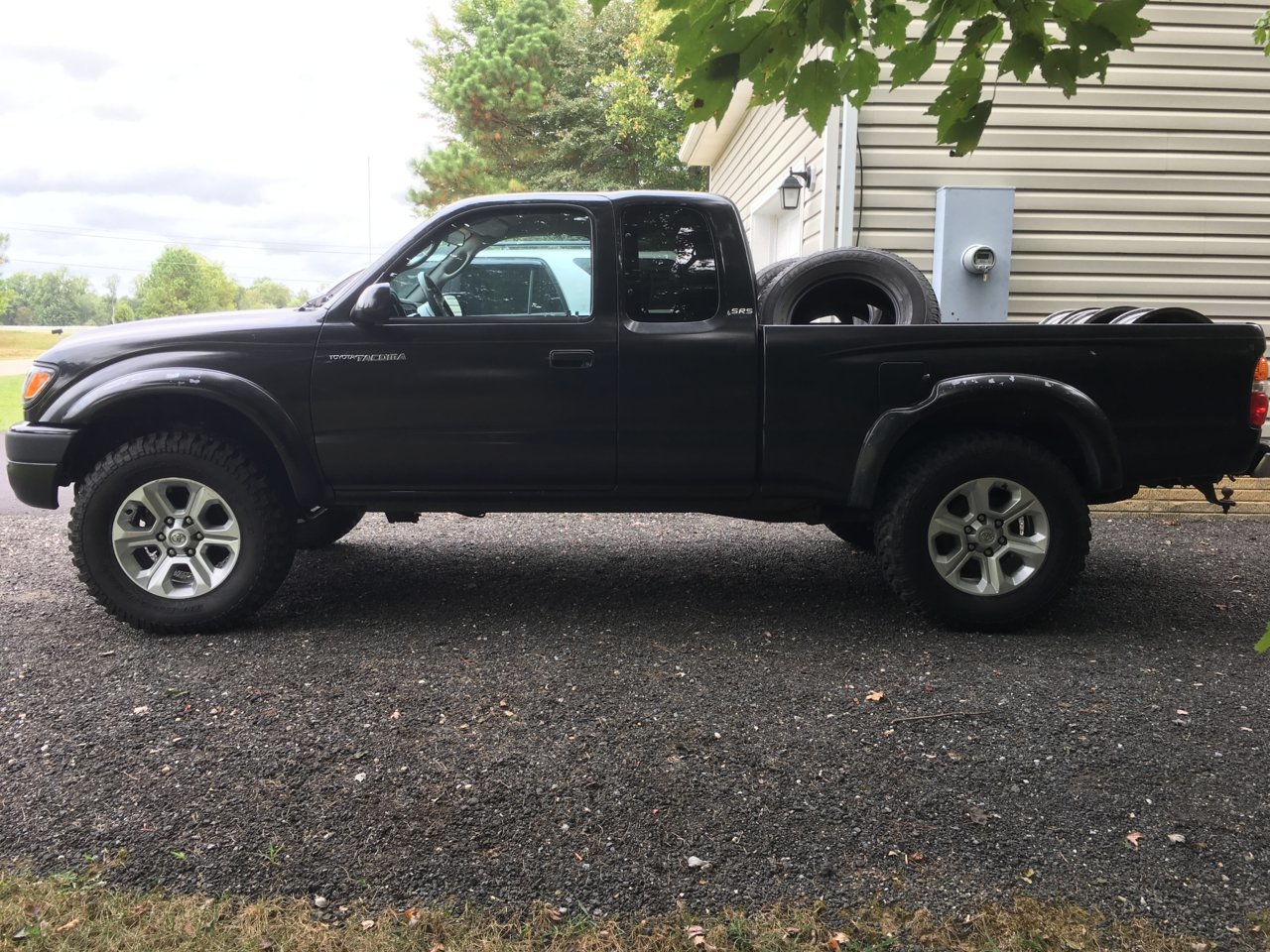

    Surfing Facebook Marketplace a few months ago and I found an amazing deal on some 5th gen 4Runner wheels. So I went off and bought them. They sat for a month while I tried to find some time to sneak into my buddy’s shop on the weekend and use his tire machine. I’m no pro, but I’m proud to say I did it all myself this time. I think it looks way better.

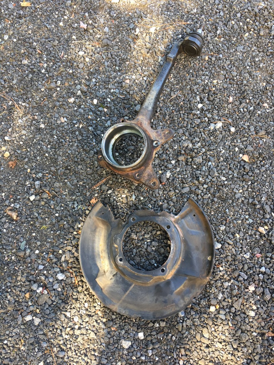

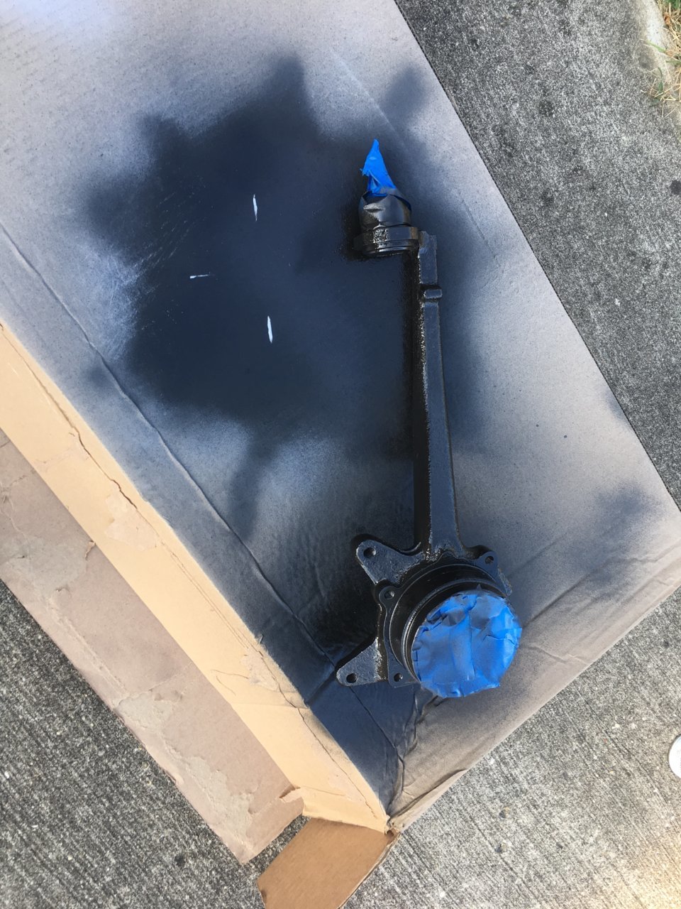

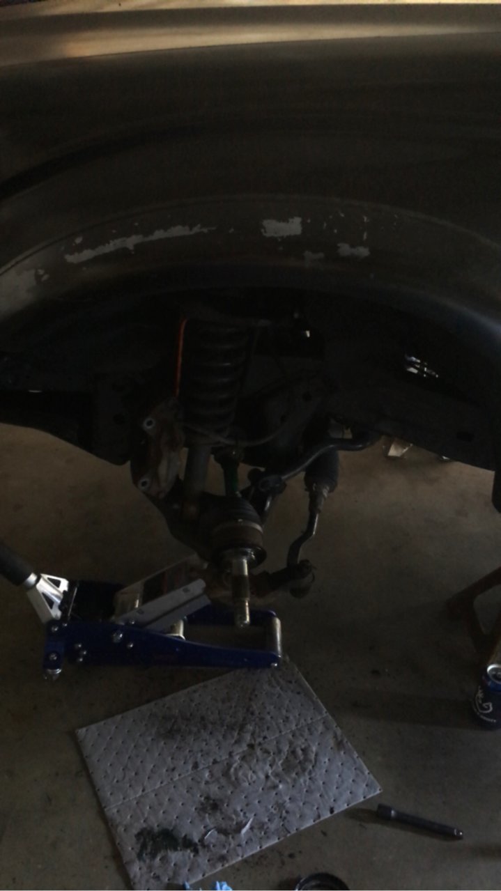

    Almost as soon as I got home from putting tires on, I ordered up a small box of bearings and seals for the front wheels. I got excited and ripped the front end apart before I even had everything. It’s on stands, the jack was just there to take pressure off the strut.

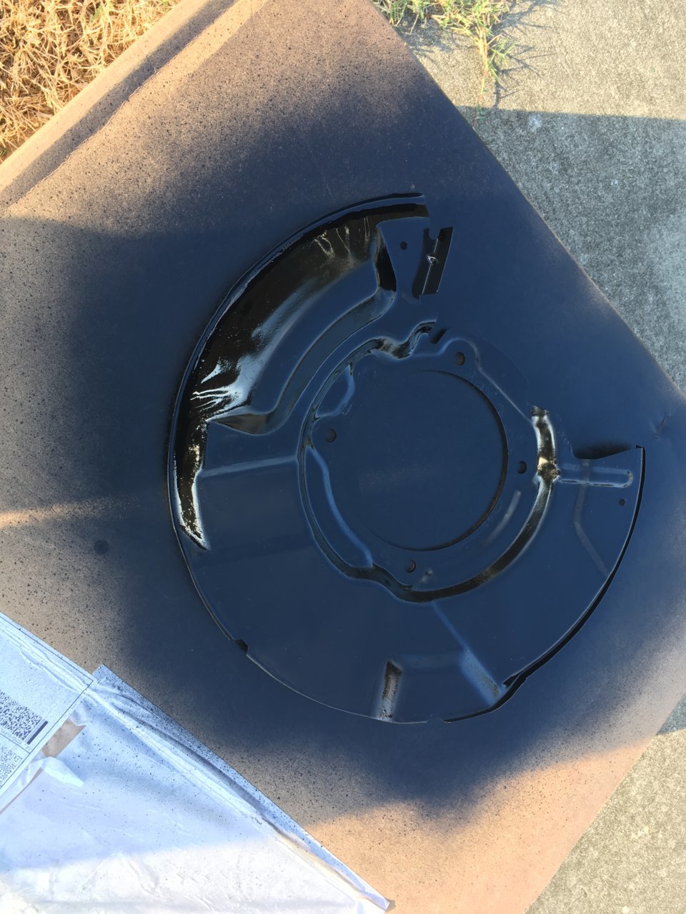

    I broke (bent) my little 12 ton harbor freight press trying to get bearings out. I don’t have any good pictures. But this is another job I’m happy to say I did myself. I blew the knuckles apart and got some paint on everything.
    Today I went over to the “Auto skills center” on base and pressed the new bearings in and pressed the spindles back on. Interestingly I’m not the first person to put wheel bearings in this truck unless Toyota was using Timken bearings at some point.

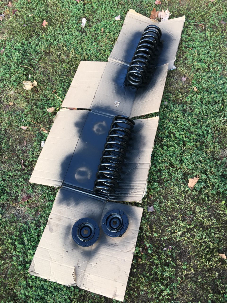

    Being the way I am, and looking at the suspension mostly ripped apart, I decided it would be a good time to order struts. So I have some Bilsteins coming from Wheelers Off-road. Those show up on Tuesday so I’m going to attempt to get everything cleaned up and taken apart so I’m ready to slap the struts back together and reassemble everything.

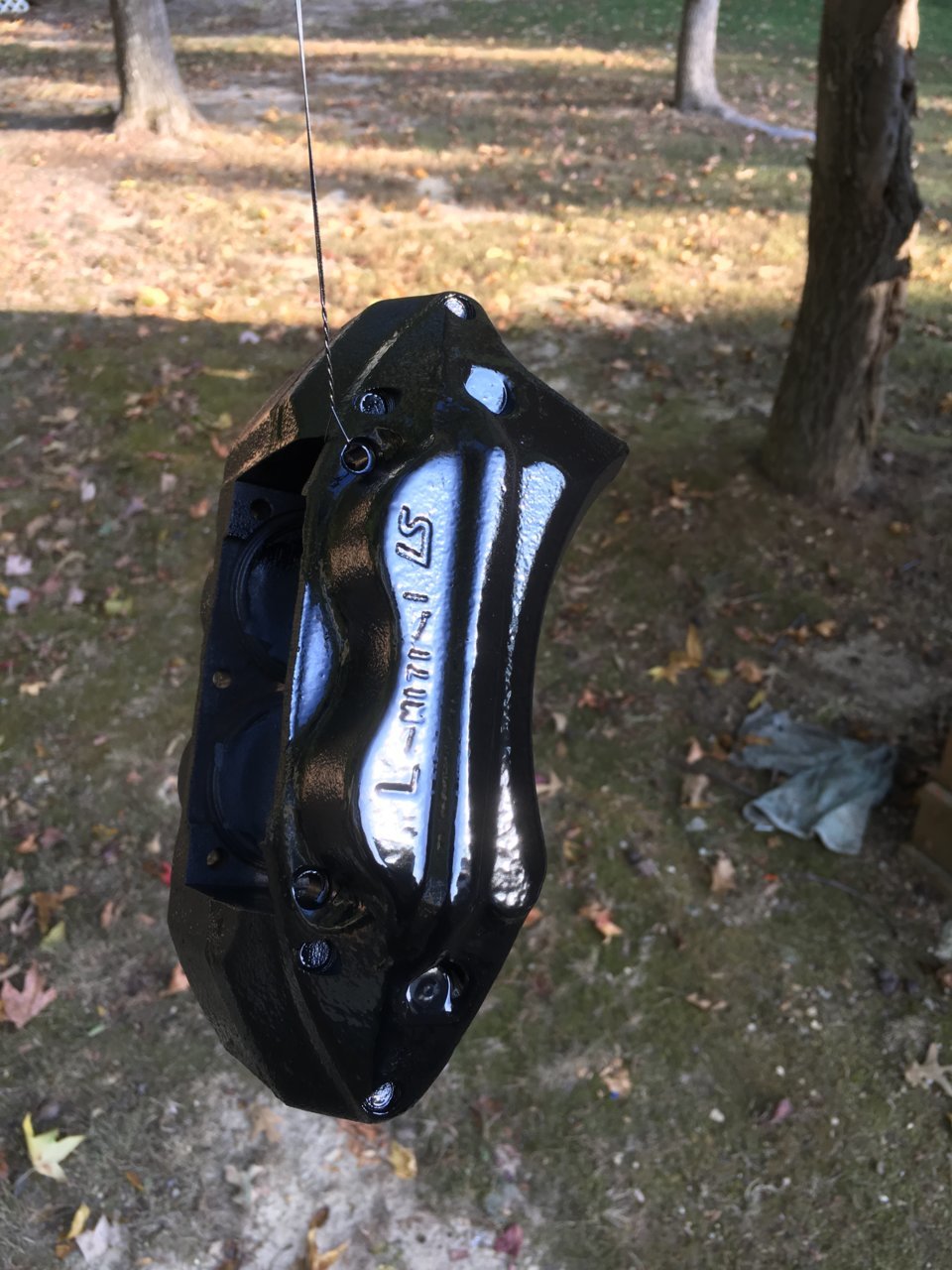

    Last bit for today, I decided to paint the brake calipers while it was apart. I’m killing time till the struts come anyway. So might as well. I already had the paint.

    All the things will be black!
