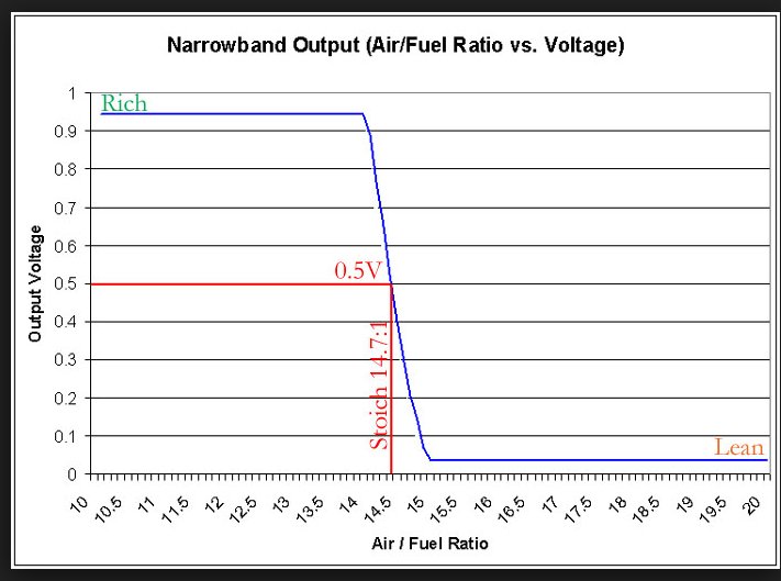

    I've never figured out exactly what the difference in sensor range is between the so-called narrow and wide band sensors. With a scangauge my stock narrow band will read from 10.5 to 17 AFR or so, but my Bosch LSU 4.9 wideband isn't a whole lot more. Is it just that the wideband is more accurate at the extremes?

    Torspd Tor-nication
    Sep 18, 2009
    #22958
    26,445
    Tor
    The Great America!
    MMVI 4.4L 4x4 Access Cab
    Torspd Custom Turbo kit [] Borg Warner 9180EFR Turbo [] Haltech Elite 2500 [] TiAL Q BOV [] TiAL V44 Wastegate @ 15psi [] CP Pistons [] CP Carrillo Rods [] ARP Head studs [] ARP Main Studs [] ARP Header - Head Studs [] Ported Heads w/ 1mm oversized valves intake/exhaust [] Brian Crower Forged Stroker Crank [] Darton M.I.D. Sleeved Block [] Kelford Camshafts [] Torspd 160* T-stat mod [] APR Large Fuel Rail [] Walbro 460 LPH E85 Fuel Pump [] FueLab FPR [] APR T56 Conversion Kit [] KP RACING Built T56 [] McLeod Racing Custom Twin Disk Clutch [] One Piece Aluminum Driveshaft [] MGW Shifter [] Custom lowering kit [] Ohlins Front Coilovers [] QA1rear shocks [] Custom Ron Davis Radiator [] Dual SPAL Electric Fans []

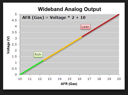

    Helpful link, thanks. This leads me to believe that the AFR reported by my scangauge is only accurate as far as lean vs rich, and is not varying linearly with voltage. Or at least, when the narrowband voltage goes to 0, AFR reading drops to a minimum (10.5ish) and when it hits 1 volt the reading maxes out at 17 or so.
