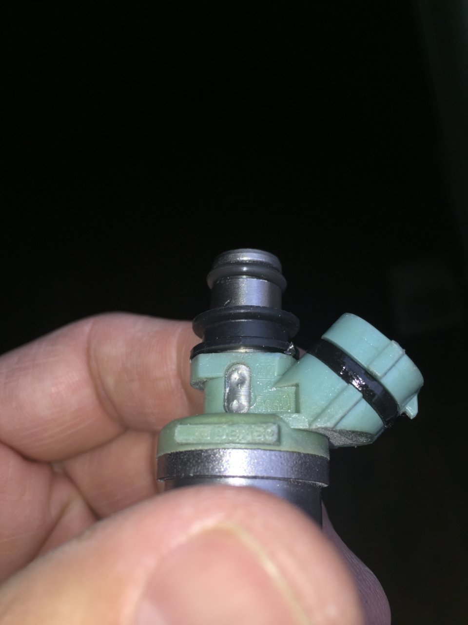

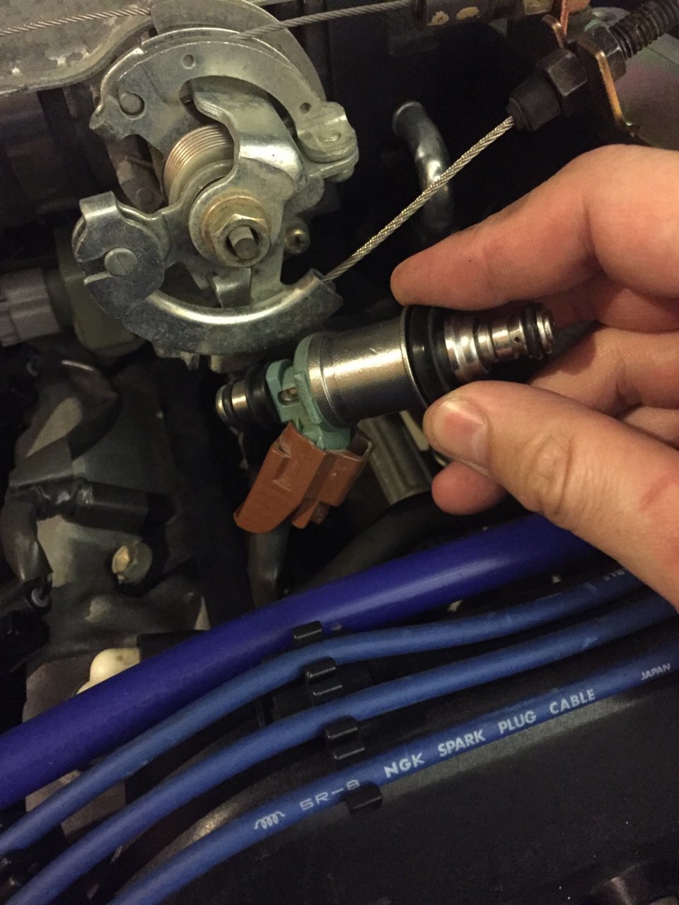

    Like this?
    9AF1680D-B307-4725-9CD2-663626C14C79.jpg 7C887AE1-EEFE-4695-870F-B1562DE35FBC.jpg
