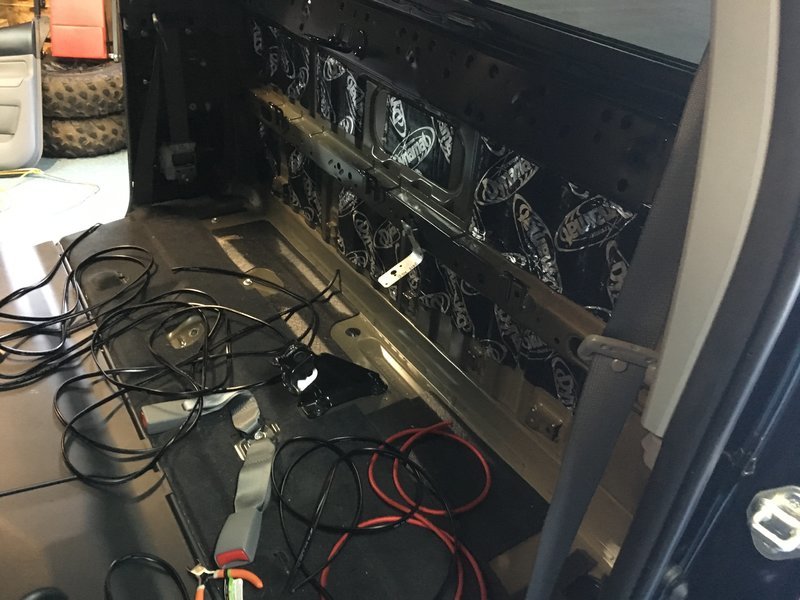

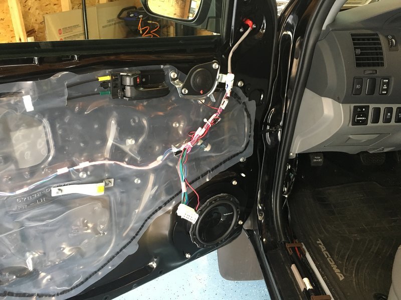

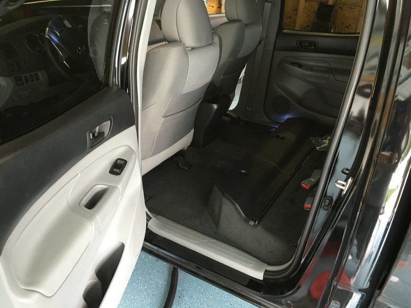

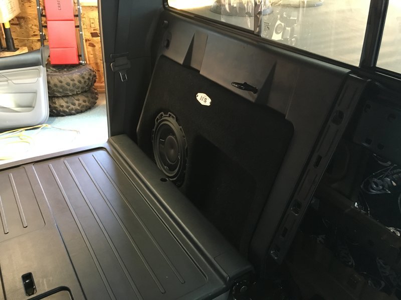

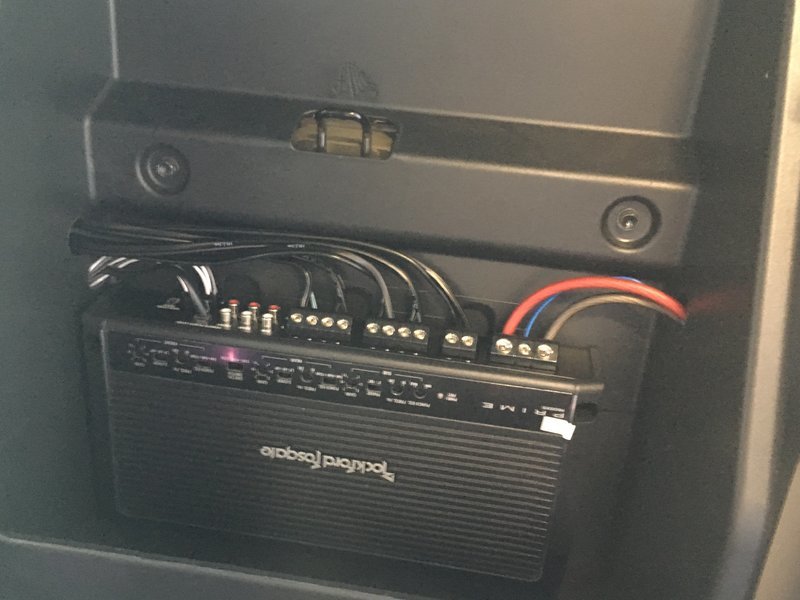

    Spent a few days this week installing a new system in my 2015 Tacoma Double cab
    Components are:
    · Rockford Fosgate 600X5 Amp
    · Rockford Fosgate Punch P3SD4 10” Sub
    · Rockford Fosgate Punch P1675-S (Front Door)
    · Rockford Fosgate Prime R165X3 (Rear Door)
    · JJ’s Audio Custom Box
    · XTC Speaker Baffles
    · Scosche and Metra Speaker Adapters
    · DynaMat
    · 75’ Stinger 14 gauge OFC speaker wire
    · 25’ Stinger Speedwire
    · Rockford Fosgate Amp wiring kit
    UPDATED 02/01/17: I ended up replacing the Factory HU with a Kenwood DDX-9903S

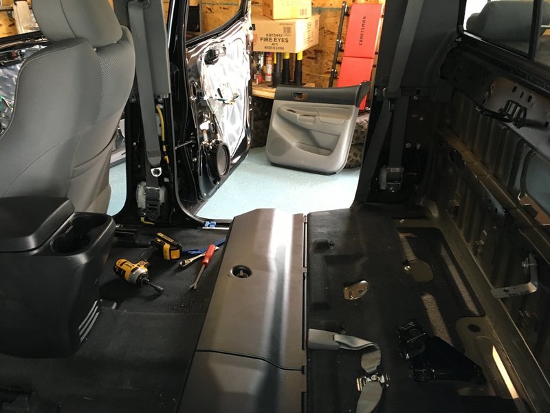

    Total, i have around 24 hours into the install. I really took my time and made sure that i was doing everything right the first time, and i was doing it all solo.
    ran into a slight issue getting the wire into the passenger side front door, but the others were all fairly easy to work with.

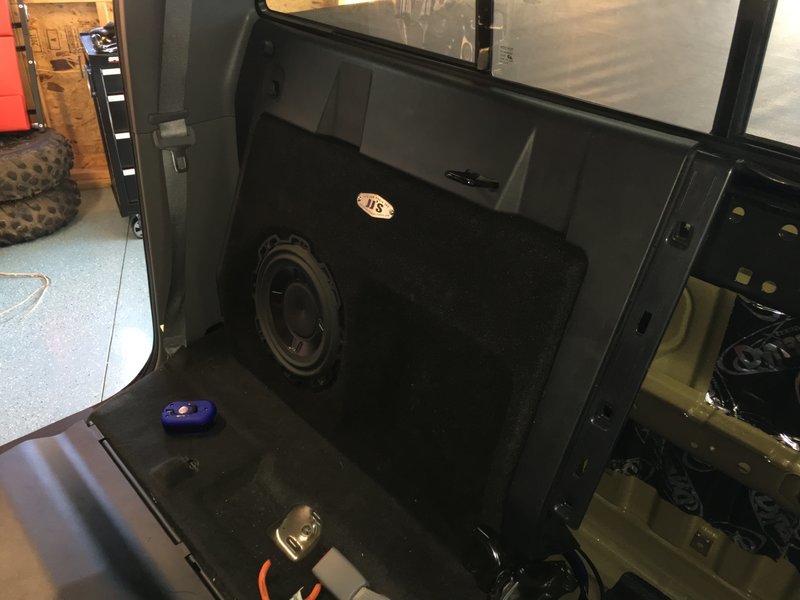

    Nice setup! How do you like that sub? I am about to install the same sub in my truck and I'm curious how the low end bass is and how hard it hits. I was apprehensive about a shallow mount sub since I've never had one before. Thanks

    my first shallow sub as well, and i really like it. I'm putting 300W RMS at it, and its hard hitting.
    I listen mostly to metal, and its keeps up nicely to fast double bass. I threw some "old school" bass CD's(from the early 90's) in and the low end is awesome!

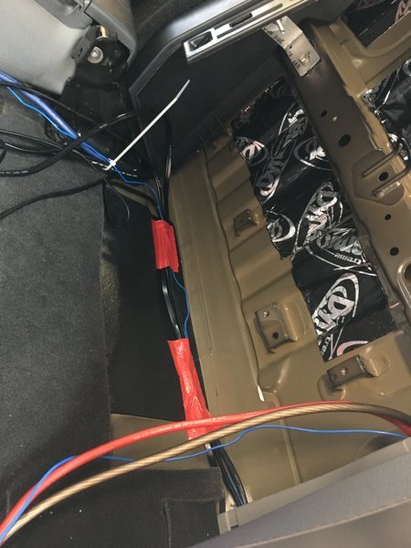

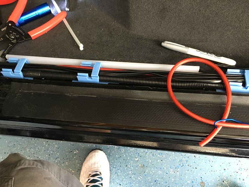

    the speedwire is for the speaker leads, all 4 channels and amp turn on lead. I used it to run the high level signal to my Amp from the factory head unit

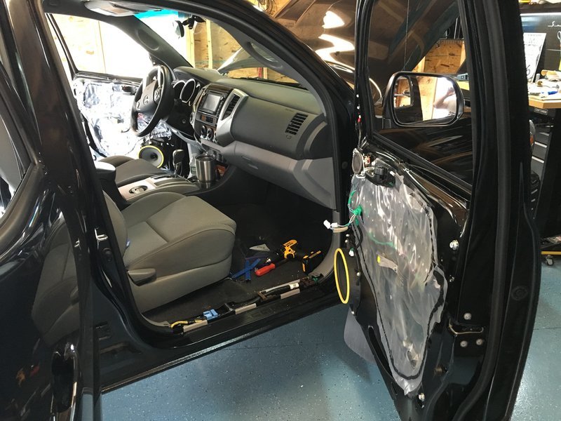

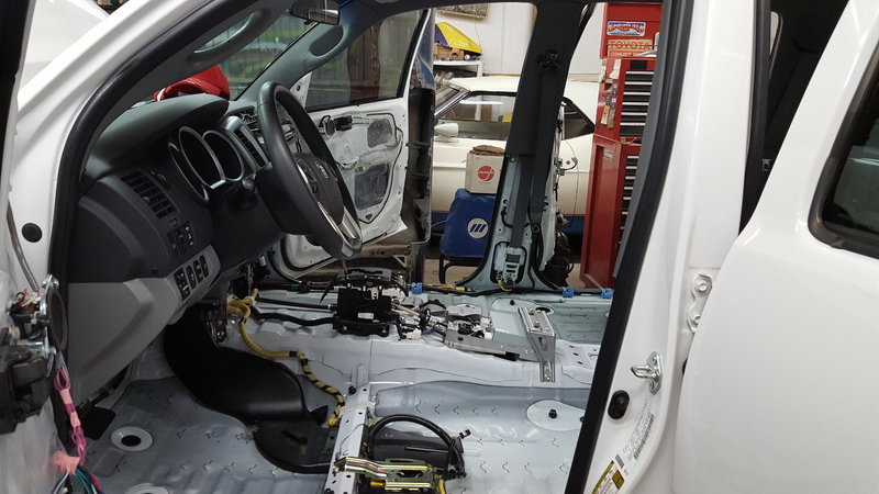

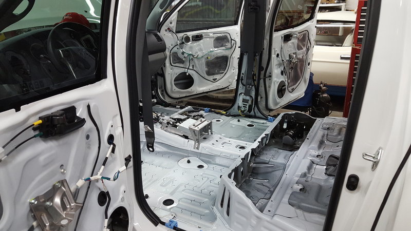

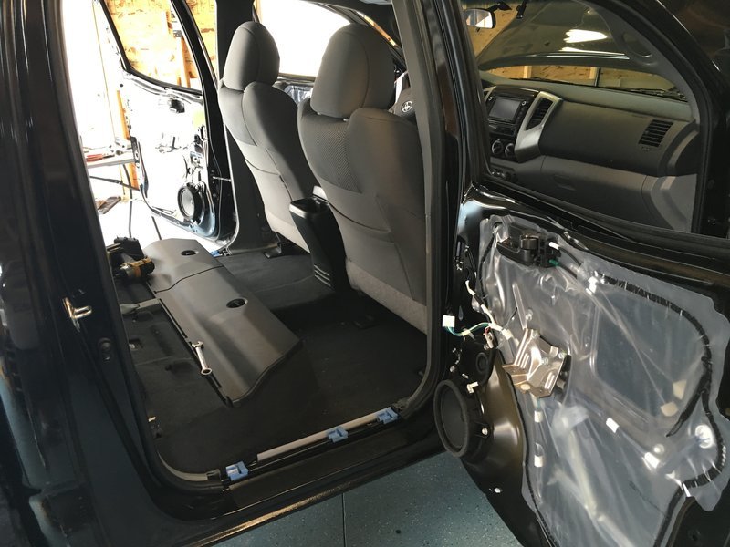

    Took me 23.5 hrs. Began at 5:30 Thursday night, finished Friday night at 11:00. Will never attempt to do that again, especially in such a short period of time.Taco1.jpg Taco2.jpg

    Yessir, easy to put in 20+ hours on it! so far i have taken the sub out a few times to reseal it, and pack the box with stuffing. made a huge difference

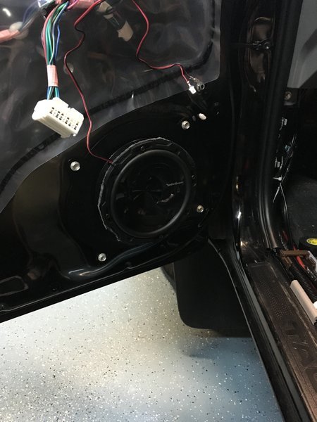

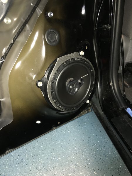

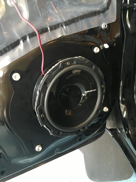

    Just curious - did you cut the backs out of the foam baffles or leave them sealed?

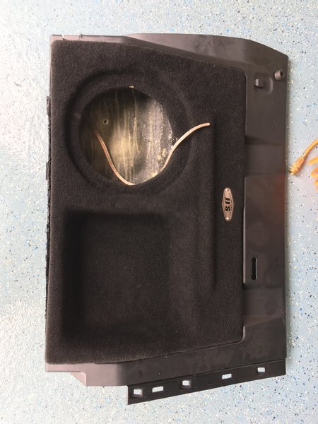

    Can you provide more information or a link for this box? I couldn't find it searching. Thanks

    Originally i left them sealed, but it sounded horrible! so i ended up cutting the backs out of them. just took about half off the back, so water stays off the speakers

    Probably a wise move. However I did discover they can be useful in some circumstances. With cheap speakers that don't really handle midbass well anyway, and lower power, they can improve FR and distortion profiles. Think OEM setups here.
    This is a cheap pair of NVX VSP 525 woofers with and without a complete 'sealed' baffle. 3 sweeps each channel & averaged.
    Blue = No Baffle
    Red = Baffle Installed
    Pretty dramatic difference huh? It also allowed me to play them much louder as it kept the cone from moving very far and distorting as much. Those 2 big dips are part of my cabin's transfer function and difficult to work with and still kinda exist even with lots of work.
