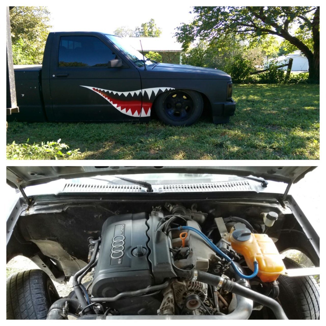

    2.7 swapped b7 in the back there?

    very nice. stage 2 1.8t in a bagged and bodied s10 for my daily and i have a '99 A8 4.2 for winter daily2016-12-30_20.21.00.jpg

    cool swap, don't think I have seen that one before!

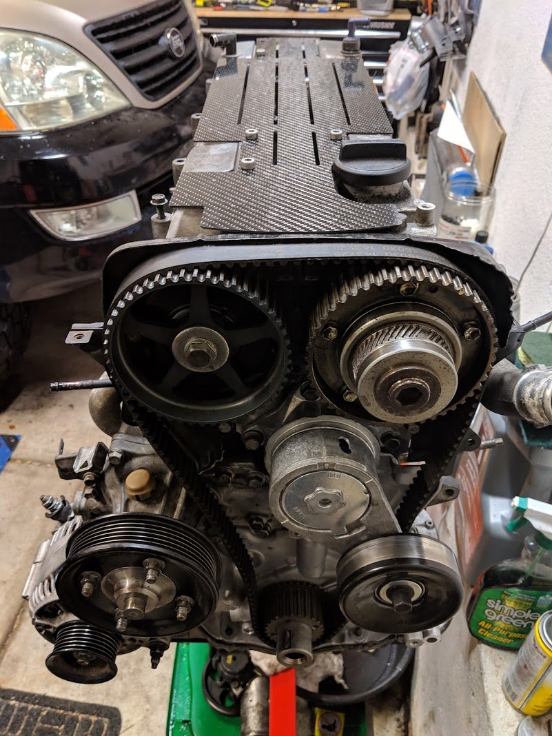

    Slowly making progress... cylinder head is on and torqued down, now just gotta wrap up all the small stuff :facepalm:
    Hopefully the weather will get a little warmer soon so I can paint the cam gears and valve covers etc..
    It all looks a little dirty right now but it will be cleaned and painted hopefully soon :D
