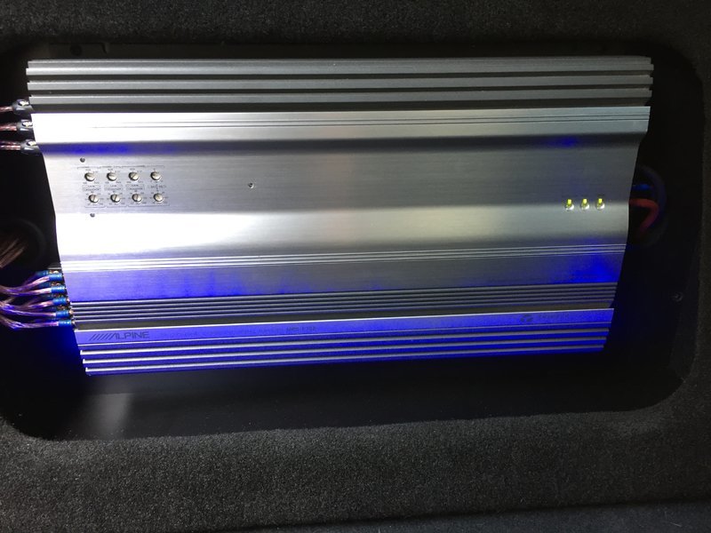

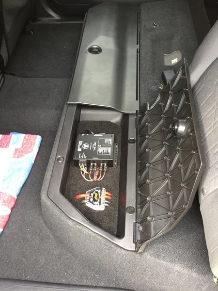

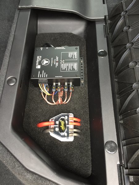

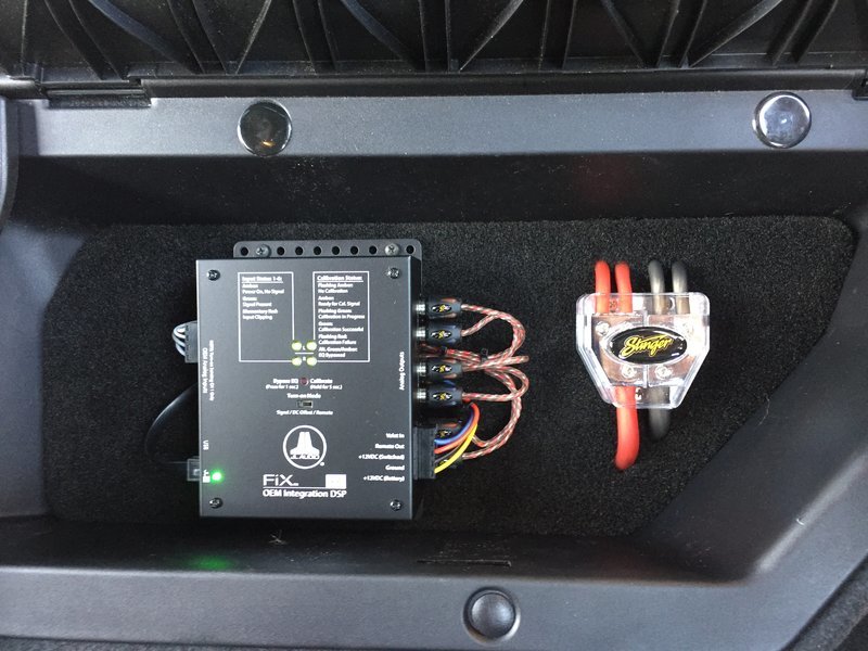

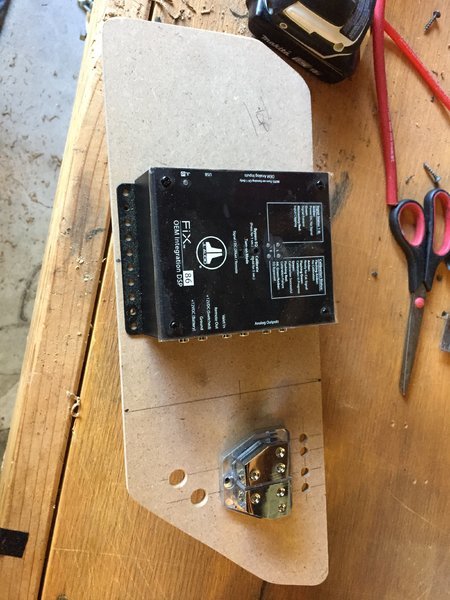

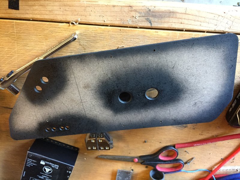

    I figured .74 before I added the small reinforcement blocks to mount the sub.
    So I went back to it yesterday afternoon and got the FIX and wiring finished. As others have done, I utilized the space under the rear seats. I didn't want to see any holes and as little wiring as possible. I basically created a false floor which hides most of the wiring underneath.
    Don't forget the black paint.
    I wrapped it in the same black carpet to tie it all together.
    Wrapped it up just before it got dark and realized I never finished the wiring under the hood...lol. I called it a night.

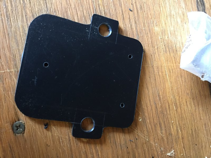

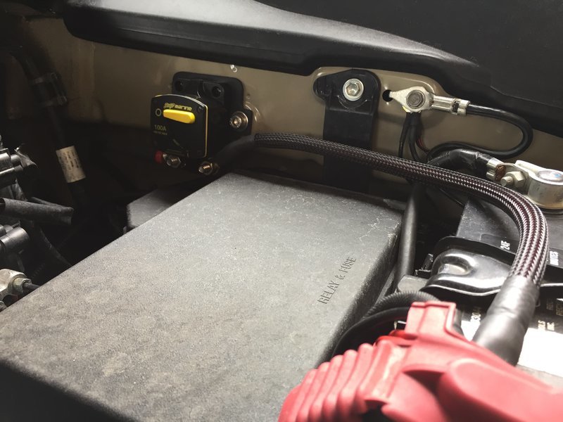

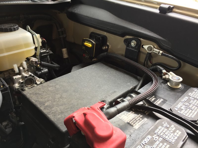

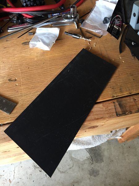

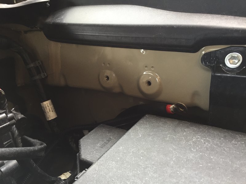

    So back at it this afternoon and worked on the circuit breaker. Not sure what these two threaded spots are for under the hood but certainly a perfect spot for mounting the breaker.
    I took a scrap piece of kydex that I had laying around and fashioned a mount. Kydex is super easy to work with and worked perfectly for this.
    Attached with a couple of M8 cap head screws.

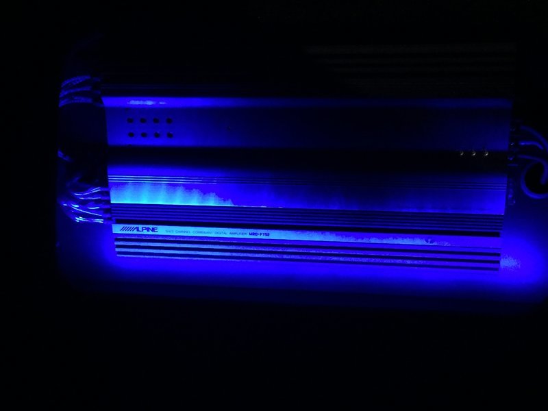

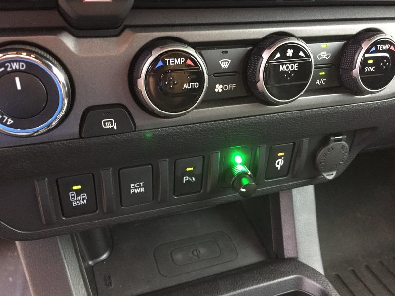

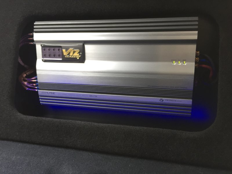

    With everything powered now, I immediately calibrated the FIX, which was uneventful and only took 30 seconds or so. I spent a good hour playing with gains and x-over points. I got it dialed in pretty well for now and buttoned it up. I should have waited as I'm going to have to play with the gains a little bit now that the rear seats are back in. The Alpine amp has a decorative cover over the gain and x-over adjustments, I just need to find the Allen wrench again.
    All in all it sounds pretty damn good for a factory head unit and line level conversion. Zero noise which is always a plus. My only gripe is the status indicator on the master volume control is obnoxiously bright at night. I'm going to email JL and see what they say. Hopefully it's as simple as just adding a resistor to the led.
