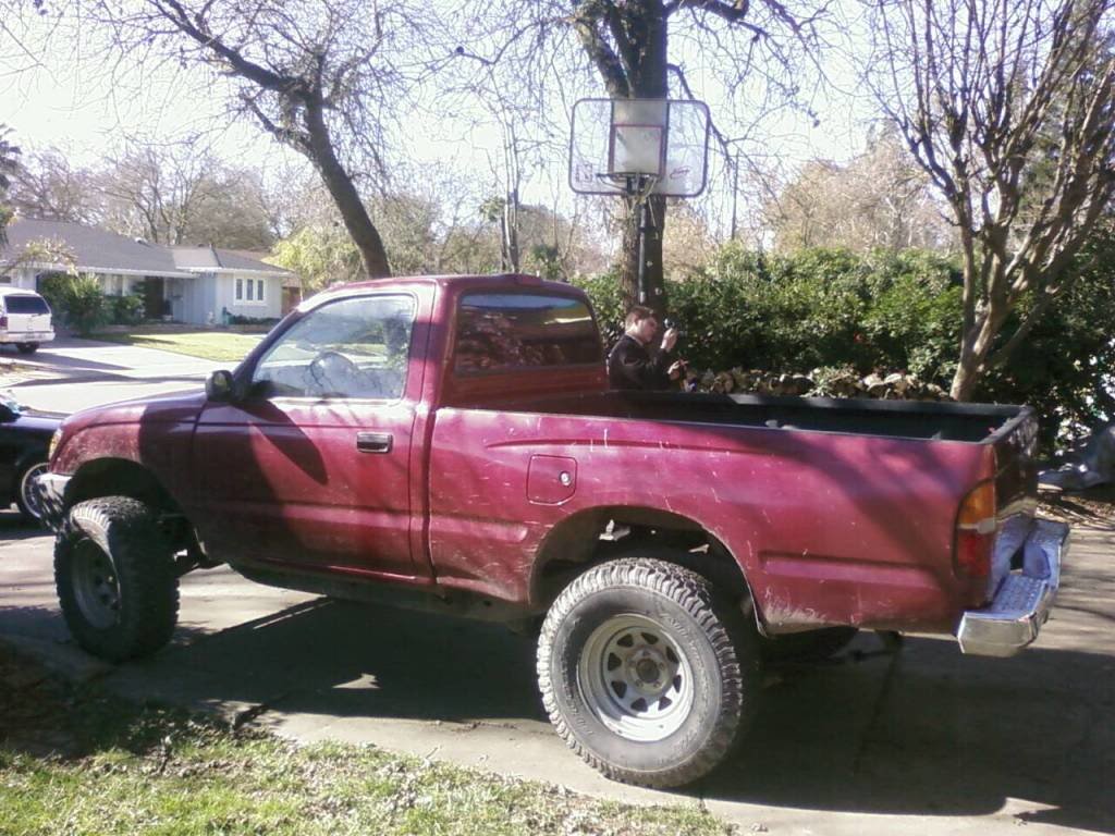

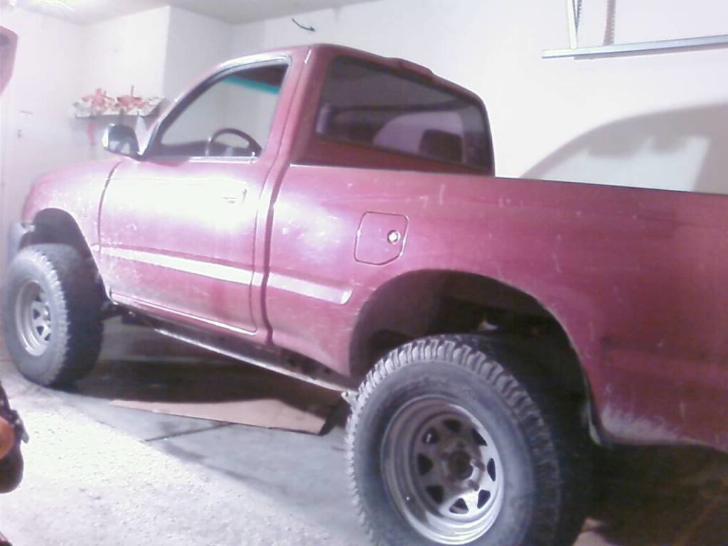

    Just picked this up for 400 bucks. Its been beat to shit, It was my buddies, he's broken several ball joints with it being a 5 lugger, but the price was right so i went for it.
    98 2rz, shifts great, 136k drives and has decent power, 31" bfg at's in good shape, in need of a cyl head, header, rear suspension, 3" body lift brought down to a 1" so i can adjust front camber accordingly... and who knows what else.
    downy wen't out of business so i don't have any info on this kit, he bought it right as they were going out of bus, and finally put it on. It has virtually no miles on it. Anybody know what kind of travel this kit pulls?

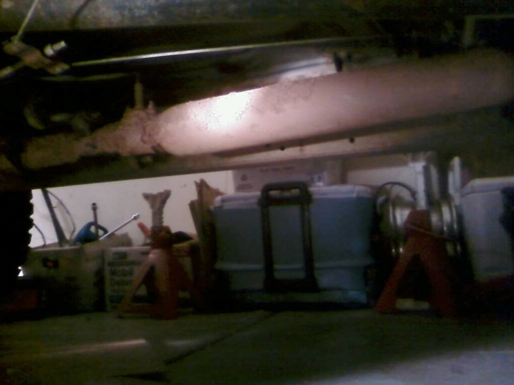

    owner before my buddy got into an accident and bent the frame so he cut it... Now i have to add some box tube to the extend it enough for some shackle mounts to accomidate my chevy 63's i just got.
    it'll give me a reason to do the necessary frame re-inforcing anyway

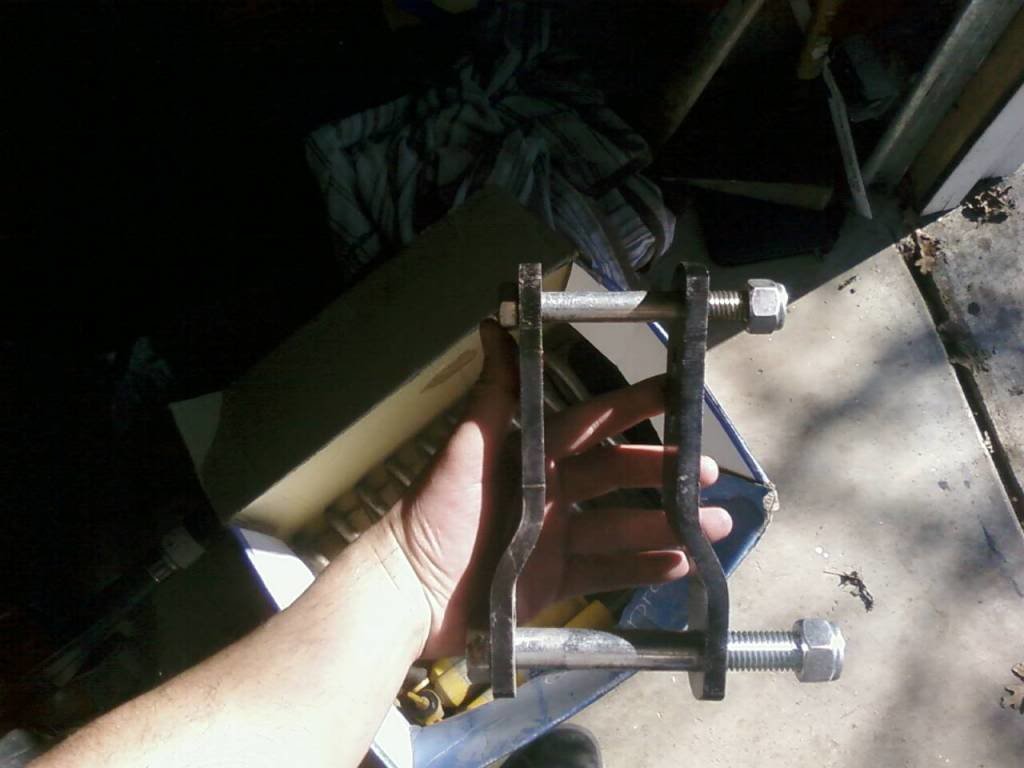

    lil bitch that just sold me these chevy 63's and shackles didn't tell me they were slightly ben't in the middle... hopfully re-arching will fix it. This shackle that came with them is too short.
    both front fenders are eff'ed from ball joints breaking
    need fiberglass asap
    i'm thinking i may have 8-10"s of travel. i need to cycle it. their billy's w/ downy coils.
    he didn't put the shackle on yet, its from downy and i think too short as well.
    int is decent, need cage asap

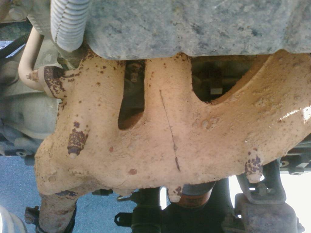

    crack that supposedly did in the burnt ex. valve and killed compression in that cyl. We'll see once i pull the head.

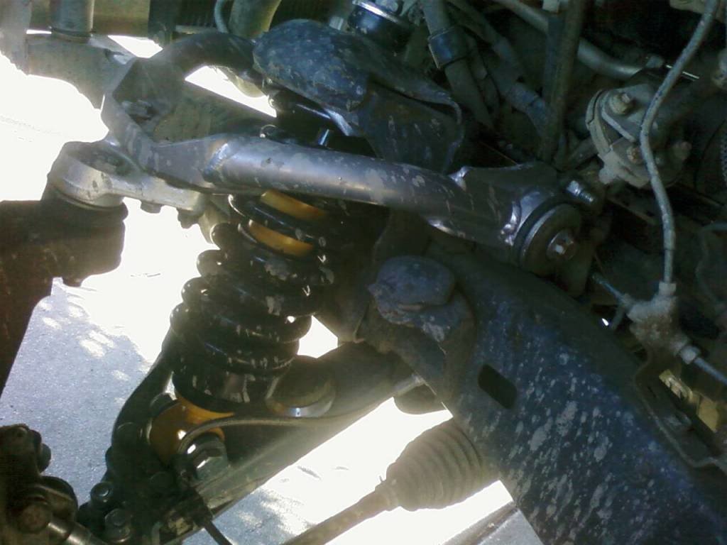

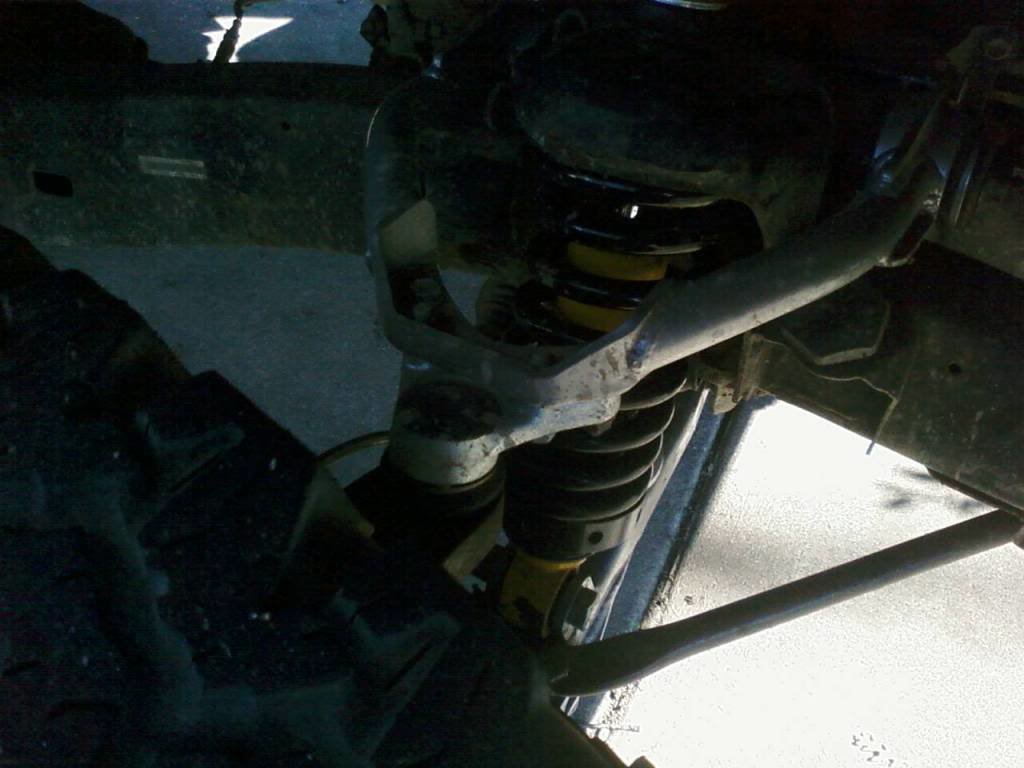

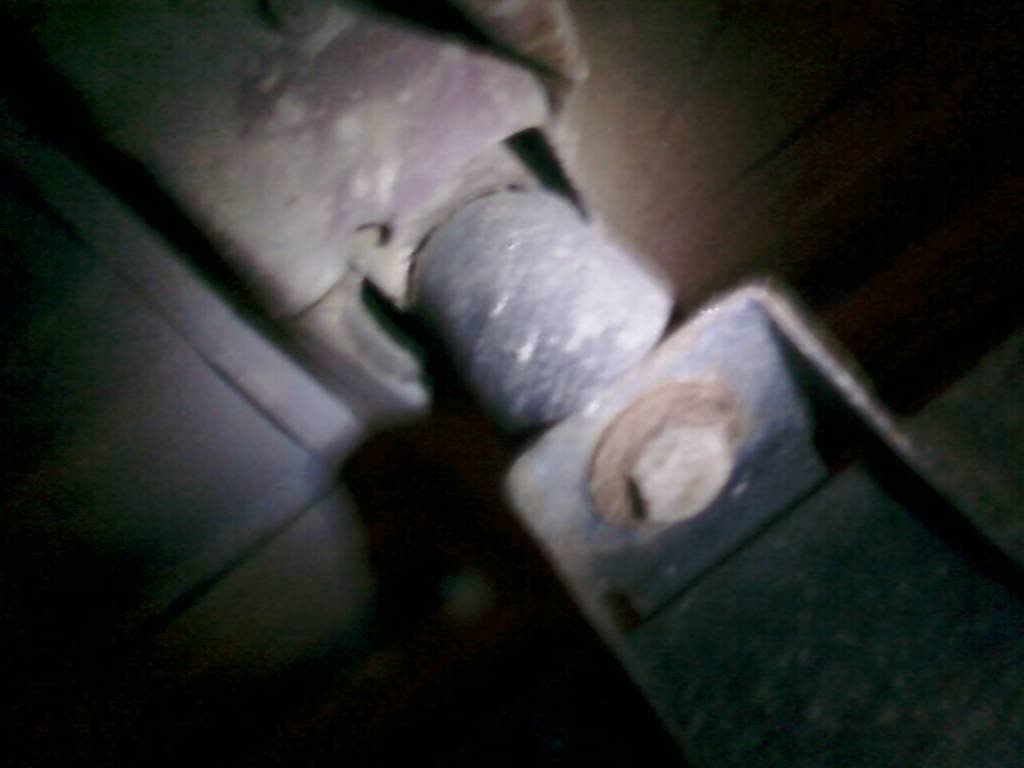

    wtf.. more pictures of the arm plz

    which arm? lower?

    Yea i think thats what he talking about

    ok i'll get some more tomorrow. Anybody have any experience with this kit? travel numbers? I don't see any of it breaking before a lower balljoint. I think the only way to get away from that is to convert to ibeams if i wanna keep this budget. We'll see...

    Nice project for $400. Can't wait to see the results. Have you looked at Kuneff's Black Beater? He's pretty much done with his...the first phase anyways...and it was in the same condition as yours.
    The interior actually looks really nice. Probably in better shape than my $8000 truck, lol.
    That is a totally weird lower control arm set-up. I've never seen one with just one main arm coming out of the middle, and not a traditional triangle/A-arm. I'd say you're probably getting 8" out of that.
    I see some nice upper control arms, though. That's a definite plus.
    That manifold looks exactly like mine when I bought my truck - the crack, mud, rust. I bought some Doug Thorley Ceramic Tri-Y's for $350 at TRDparts4u.com

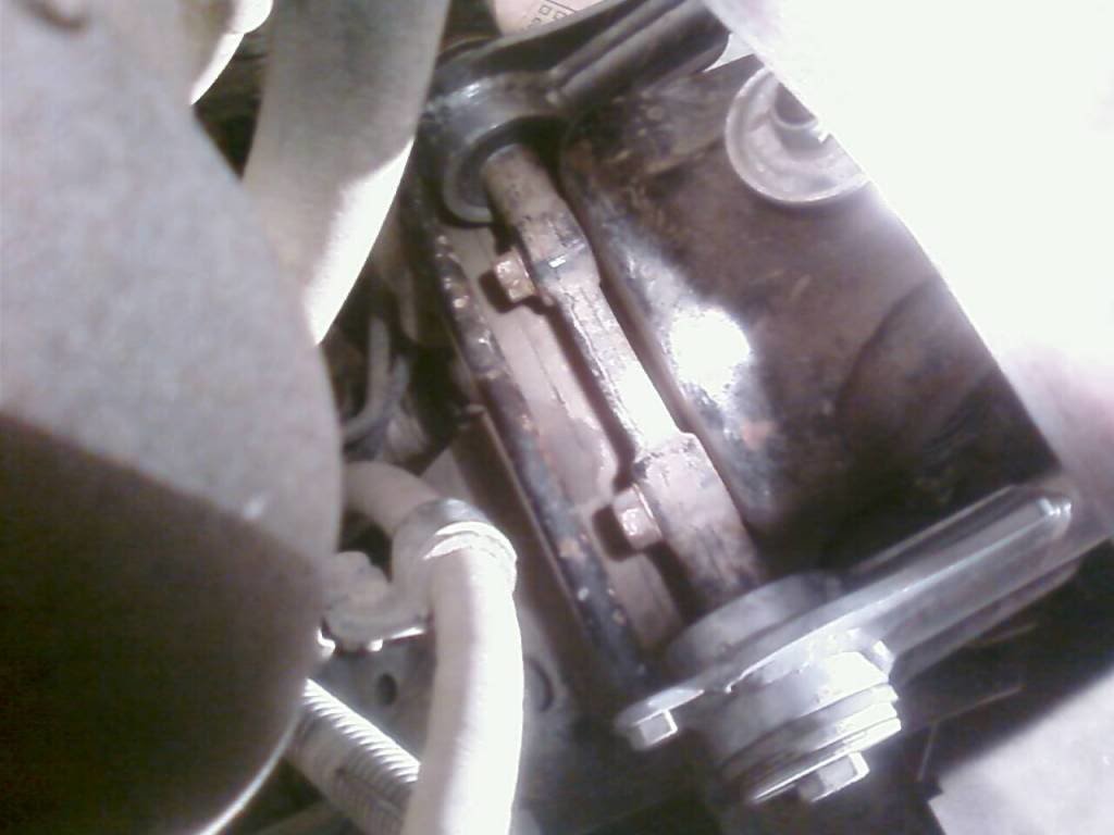

    some dude on here wanted to see better pics of the lower arm...

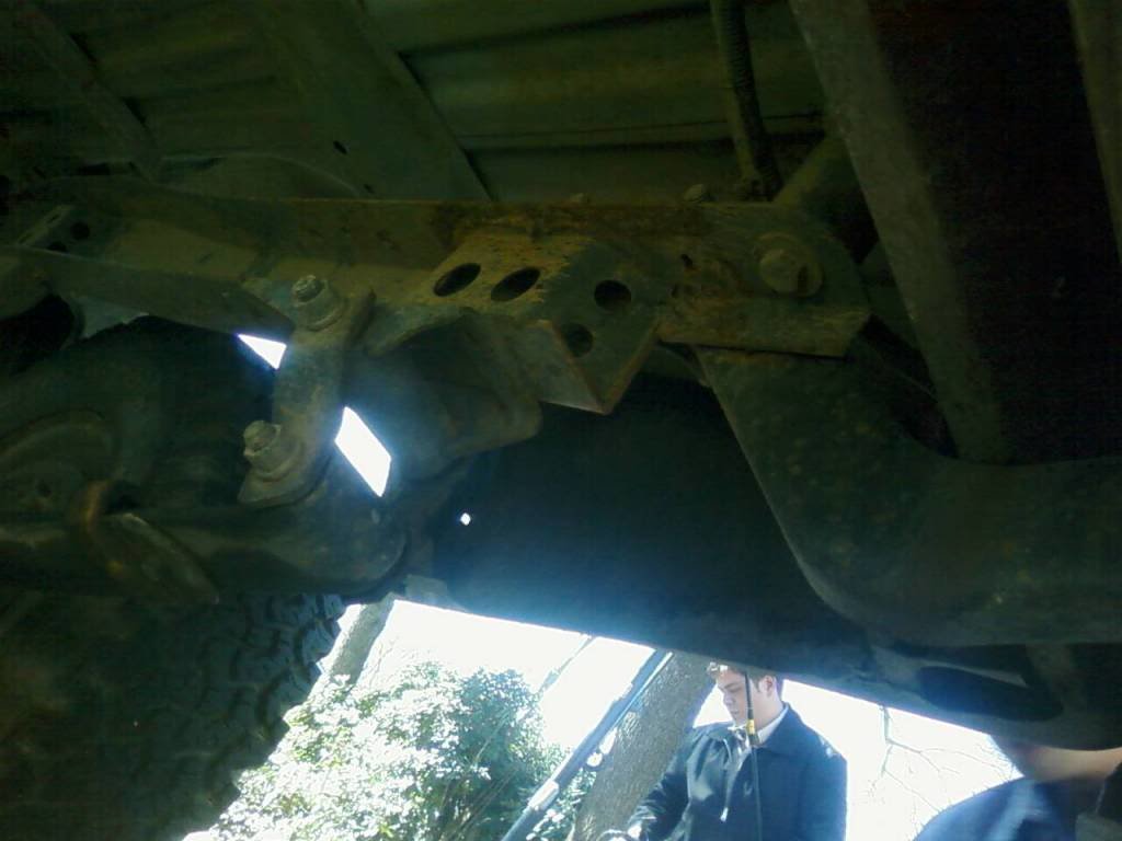

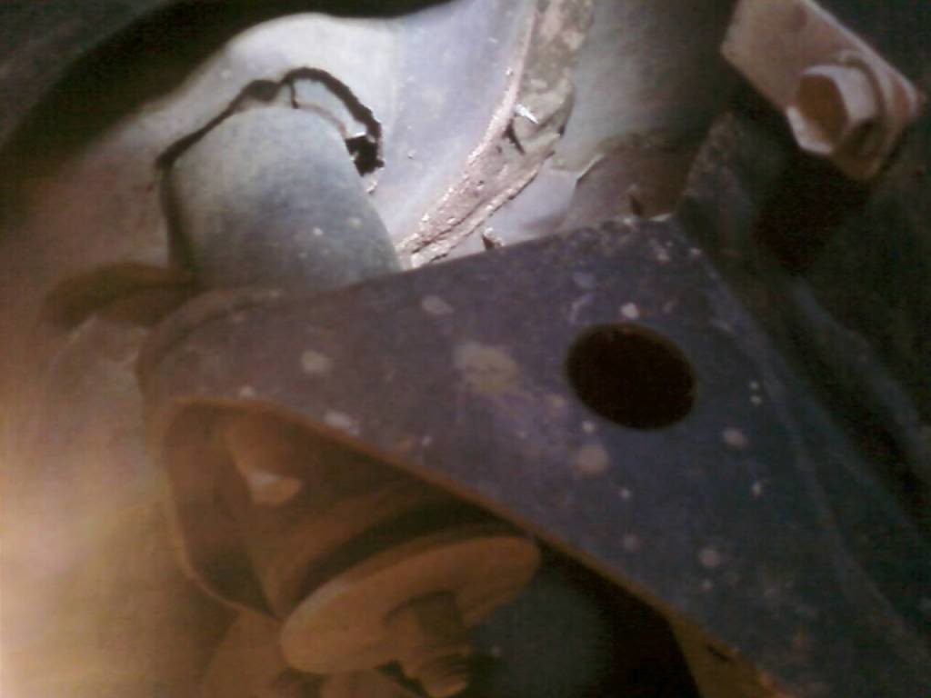

    i definately see a weak point in the junction between the lowerarm/lower ball joint. I'm going to have to figure out how to beef this up a lil
    who want's to recomend a 3" body lift after seing this...
    every body lift mount on the driver side is destroyed. for some reason the passenger were all intact but a couple were cracking.
    Has anybody fixed this before? guess it's custom plating time...

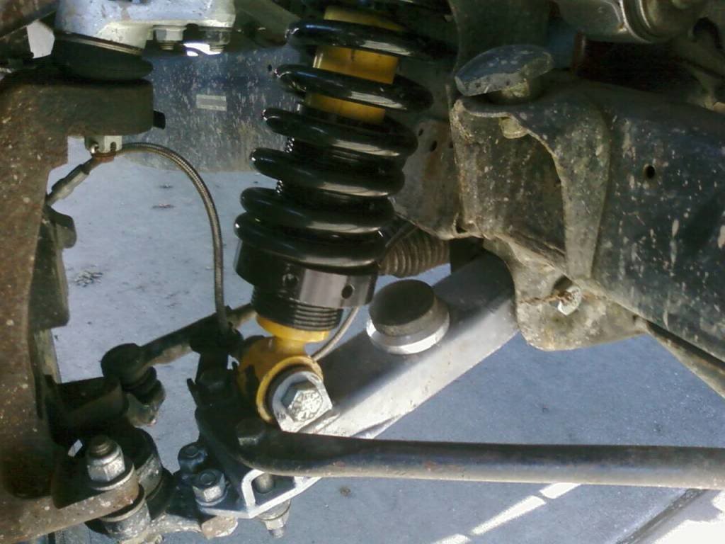

    does anybody know if this steering shaft looks extended? Its angled slightly to the drivers side too much and is in the way of moving my upper a-arm back so i can adjust camber. I'm hoping once i fix my body lift this shaft will move to the passenger side a little.
