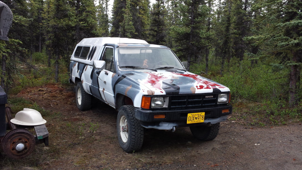

    Meet Roland:

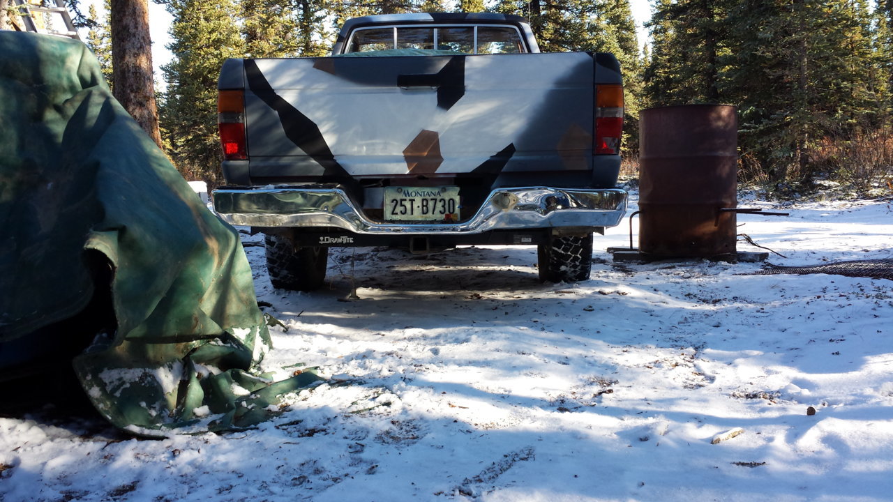

    just finished the AlCan.

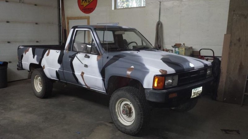

    Post rattle can camo job

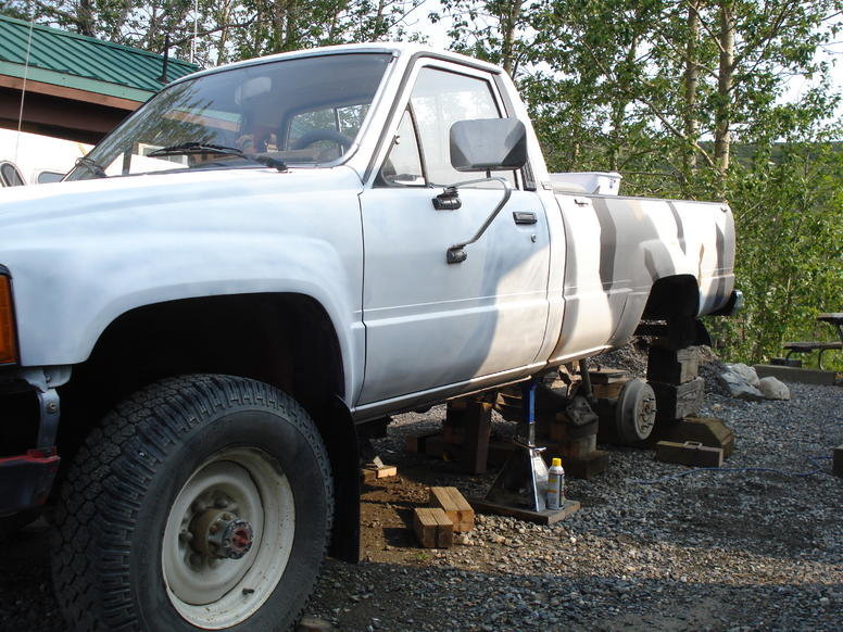

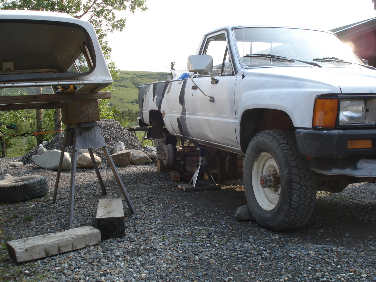

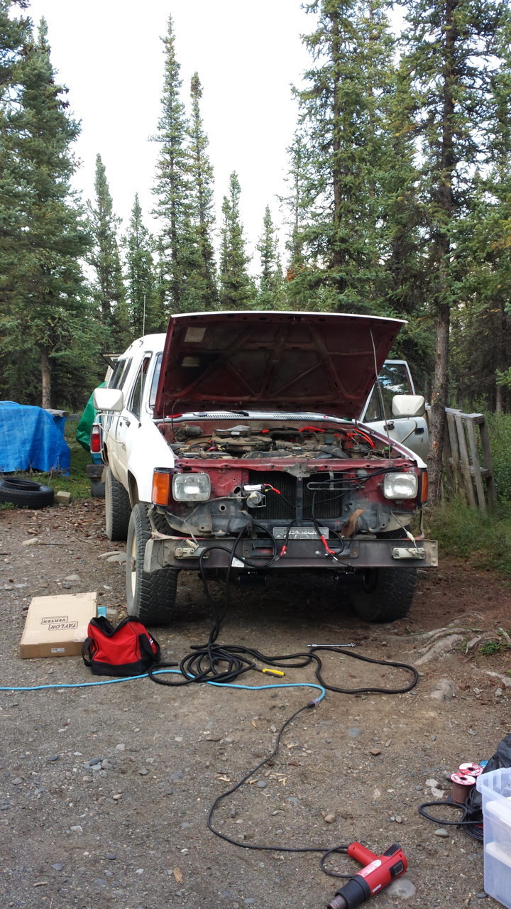

    Suspension work in the open air Kantishna Spring shop & garage:

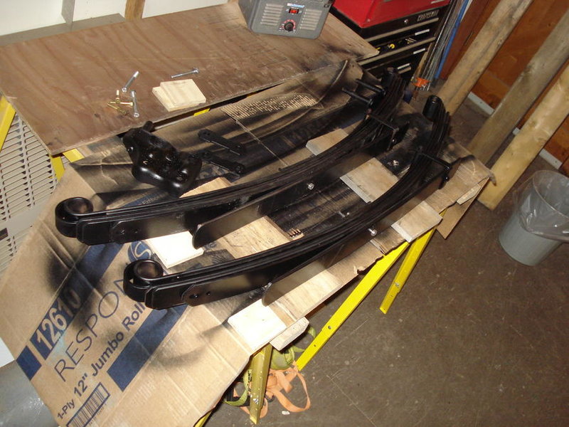

    Built up rear springs, fronts already completed, donor springs from a 79 3/4 SR5 2wd.
    Semi finished product:

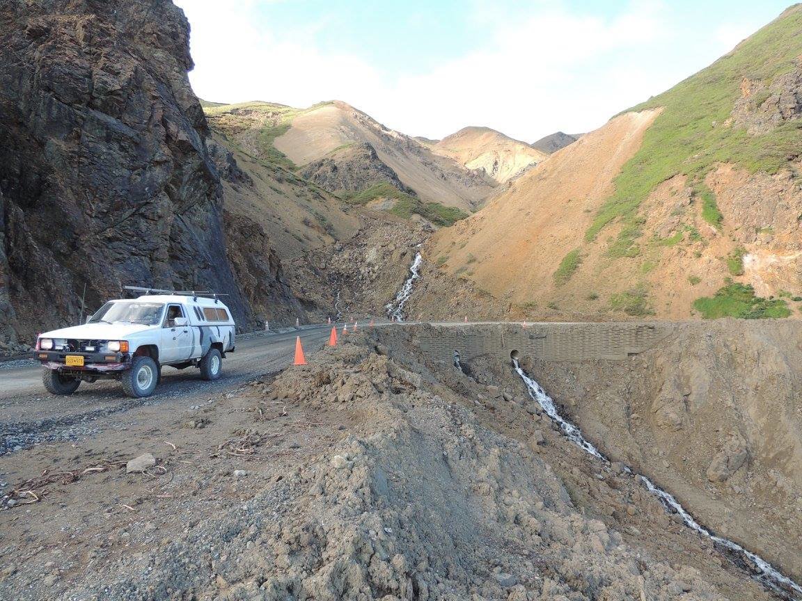

    couldn’t get through here the week before...

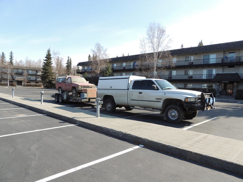

    Another photo of Roland out at work a couple years ago, still doesn’t like trailers:

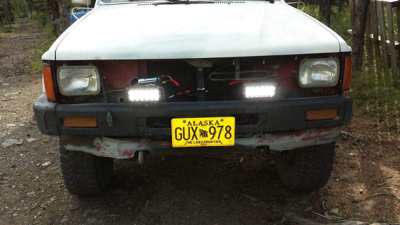

    getting a new baby air horn, and LED road lights:
    for lights press here:
    for moose press here:
    Lights:

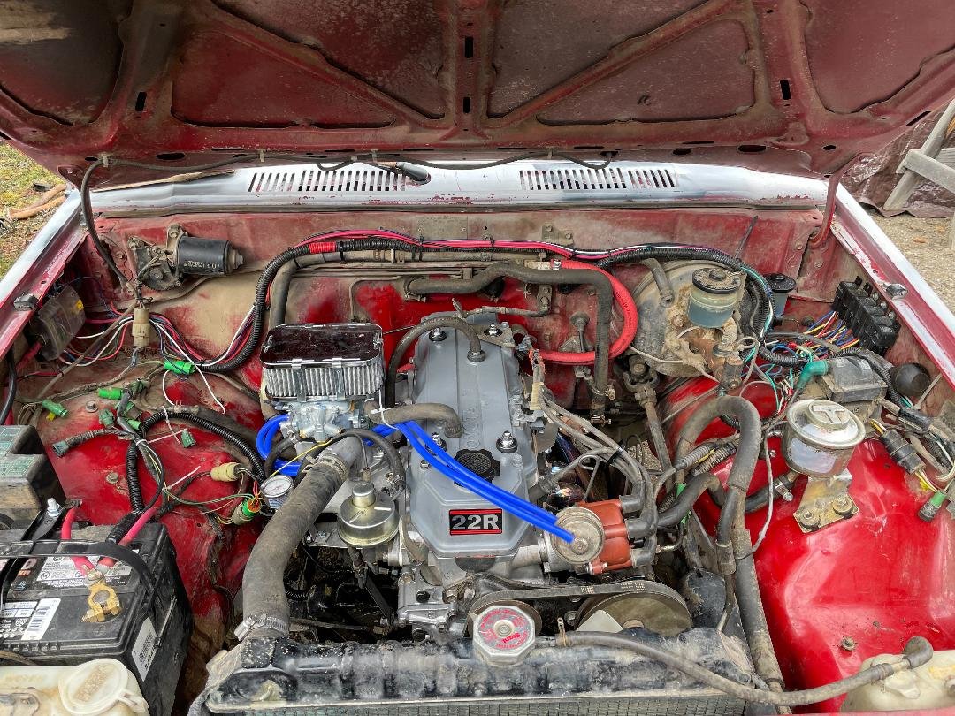

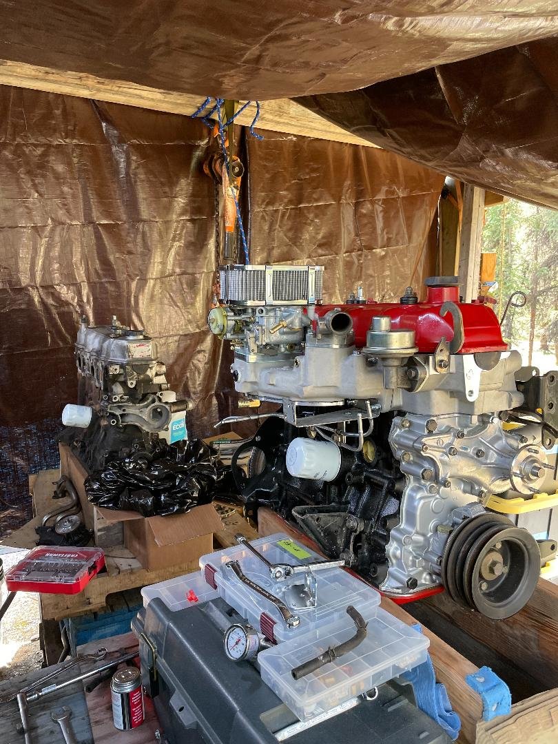

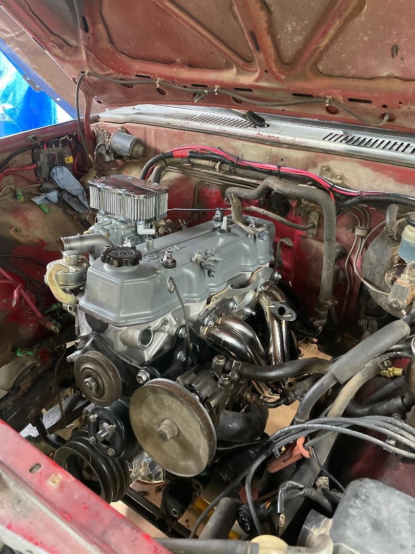

    I picked up a rebuilt long block from SunWest engine builders in Medical Lake, Washington. Ordered it with a ‘stage ll’ cam.
    Well apologies for the delay, but open heart surgery on Roland is now complete with no rejection issues- waiting for a timing light to get it dialed in.
    Here’s the build list so far:
    LCE de smog kit, Weber 32 carb, swirl adapter and LCE-Offenhauser intake, Trail Gear Rock Ripper header, and LCE Flowmaster cat back exhaust and cat.

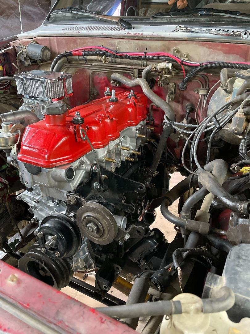

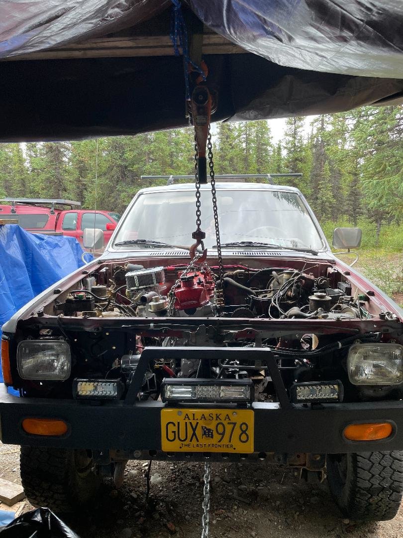

    So after a 3 day lag, the photos have arrived:57BE704F-4D61-4A60-B978-434FCDBB5D5A.jpg
    Roland getting ready to pull into the tarp shop
    last minute prep for the installation-while figuring out how to wrestle the old one out of the way.
    In with the new motor:
    Started out with a different valve cover- the idea being not to have to swap parts(and clean them-Roland had a lot of oil leaks) and just swap them out. Sadly the shiny orange one was from a different Toyota application and the throttle linkage would not mount correctly

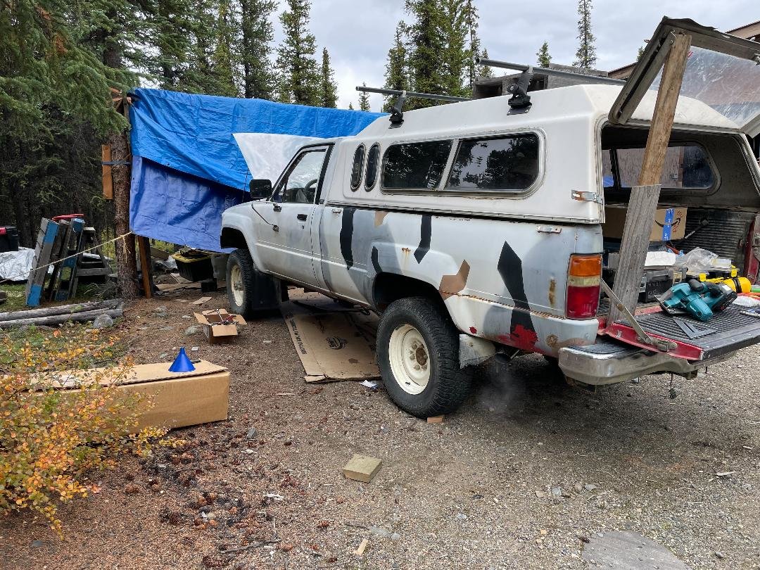

    A few more of various stages of re assembly
    Shortly before I noticed the linkage issue- I had a couple extras and couldn’t find the red/orange paint so grey it was.
    Time for the head scratching to begin- lots of extra plugs and wires after the emissions removal.
    Used up some of the extra silicone lines from the upgrade kit for the Tacoma

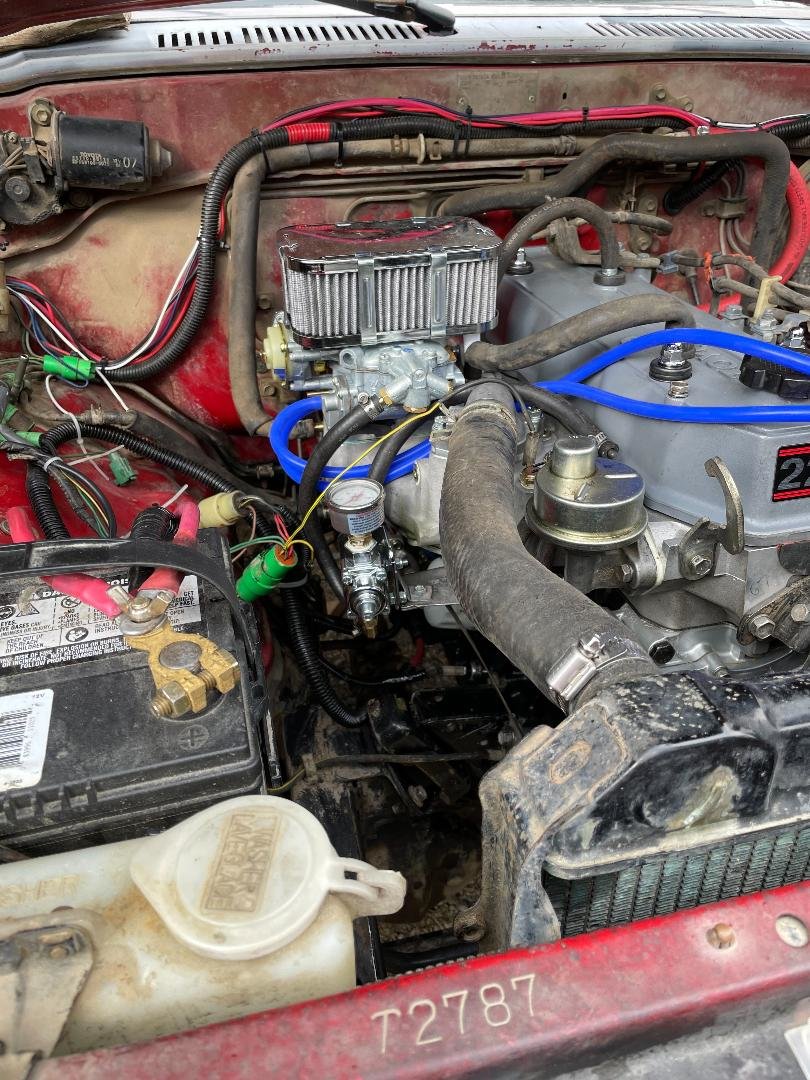

    Some final shots of the ongoing adjustment process, mainly for the fuel pressure regulator and other angles:
    Before the silicone vacuum lines- all 2 of them!

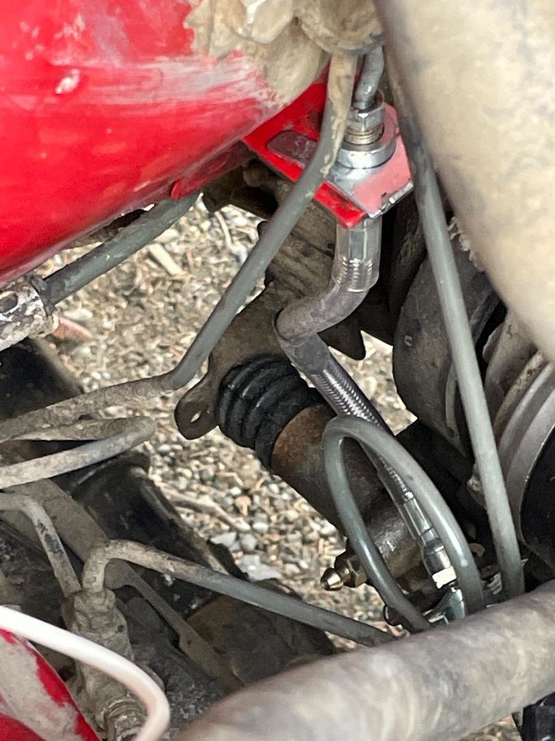

    and of course the constant pain in the ass, the new clutch slave cylinder, bleeding is ongoing…
    trying to sort out the wiring for the choke and the fuel cutoff solenoid, also ongoing(fuel cutoff anyway)
    Carb adjustments are getting close and I think the timing is close as well, word from eBay is the timing light has arrived in the mail and we’ll see how close it is.

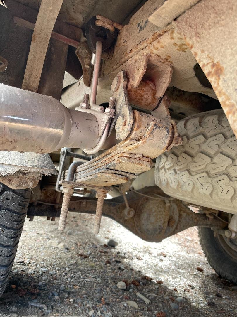

    Looks like 2” lift shackles and some springs doctoring have moved to the top of the list. About a 1/4” of clearance Clarence…
