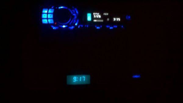

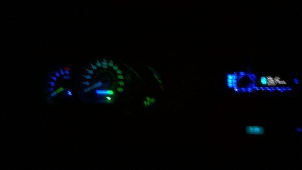

    i kinda have one pic. ill post another one up later

    heres the other pic

    That looks good. The clock looks clearer than mine.

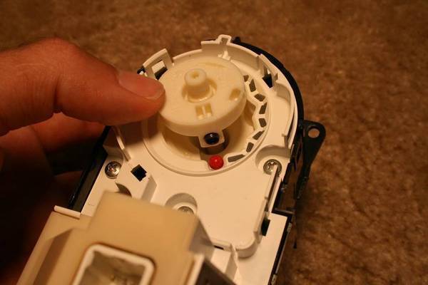

    Hello, I really appreciate your posting. I am changing out the orange LEDs for super bright white ones. I have two questions. First, where I bought my 3mm superbrite leds I was told I have to solder an inline resitor for each led on the longer side of the led. I did not see that you had to do this. Second question, I have taken apart my a/c control assembly and while I was studying the pc board, a short fat spring fell out. Do you remember where this goes? I am fairly sure it goes on the far left end of the 3 ac adjustors, but where? I went to my local dealership, but they only had a picture of the assembly together and were no help. So any suggestions would help. Thank you, sweet pea

    I did not add any resistors, I just swapped out the stock, amber leds with the new, blue ones. I'm pretty sure that you would only need a resistor if you were replacing a non-led bulb with an led.
    The only spring I remember is for the detent ball in the left-hand knob.
    For additional pics check out the other thread -
    http://www.tacomaworld.com/forum/lighting/106324-ac-controls-disassembly-pics.html
