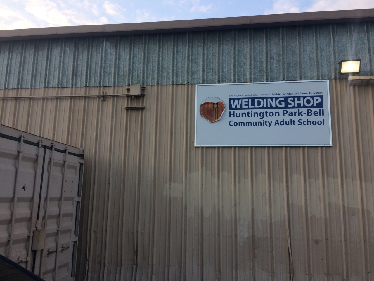

    Looks like school's back in session lol
