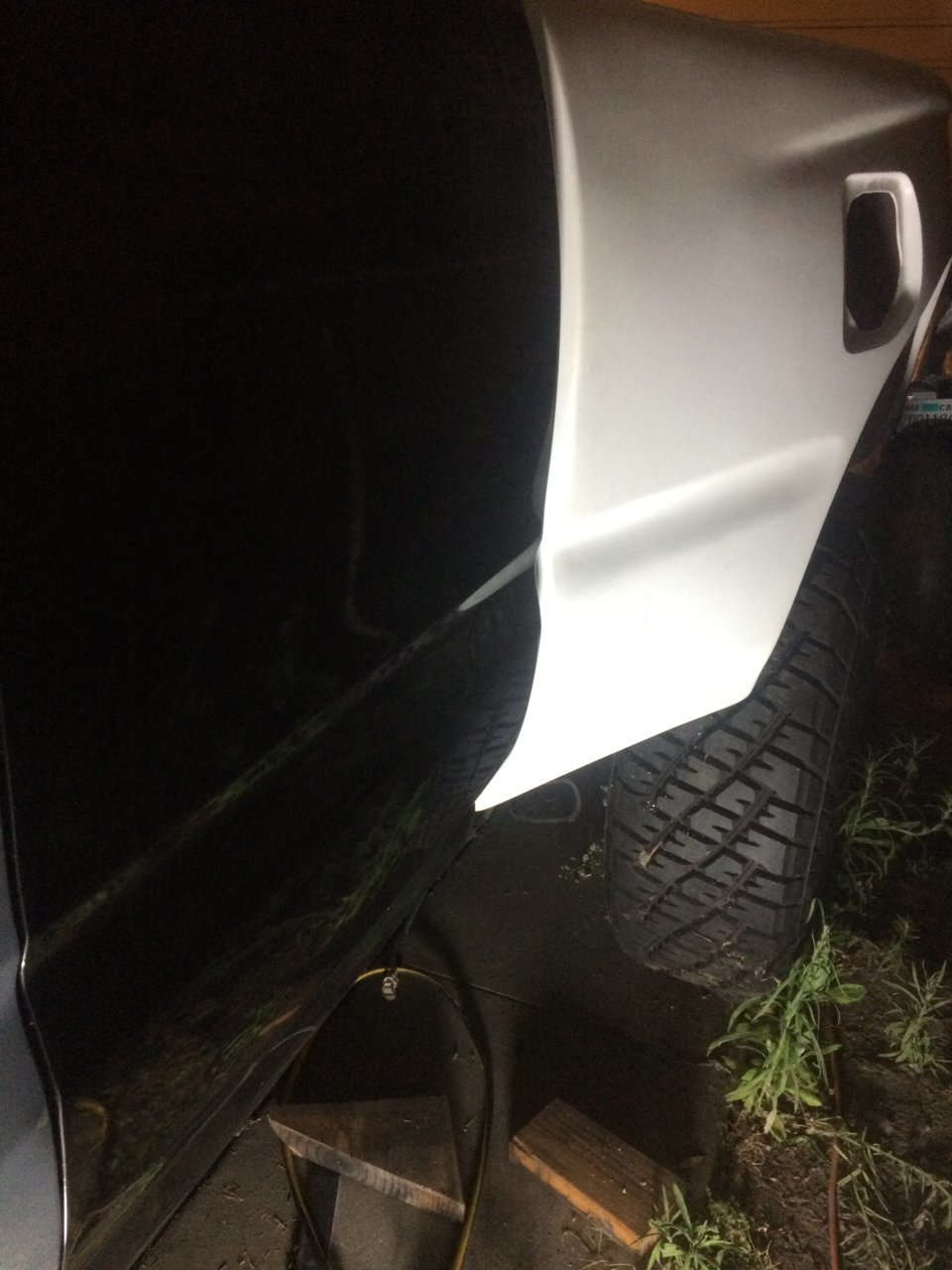

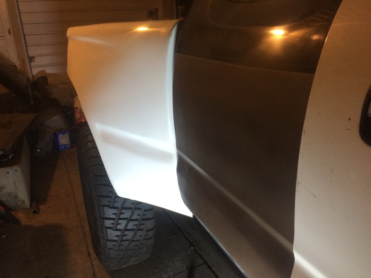

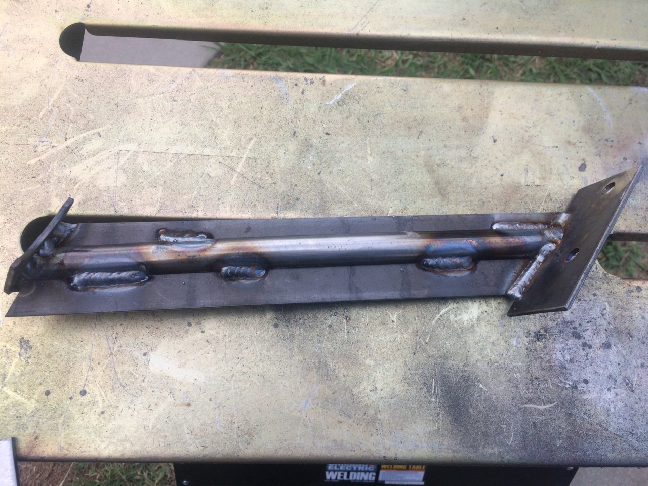

    Spent more time working on making the bedsides look good - the passenger side is like a factory reject, but whatever it's close enough after all the attempts made to get it looking alright.
    Made bolt on supports.
    The bad side.
    Completely different fit on this side, fit well.

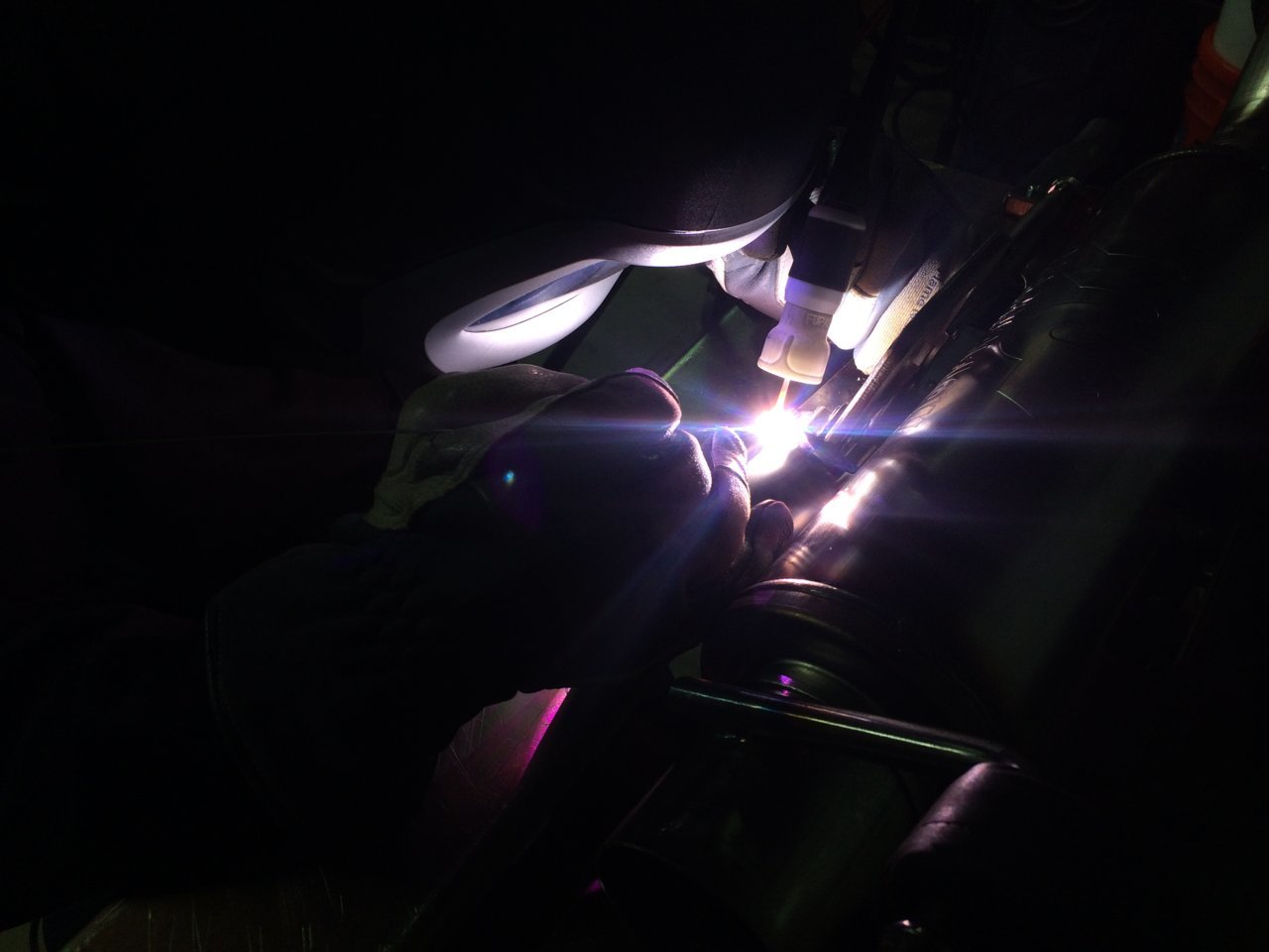

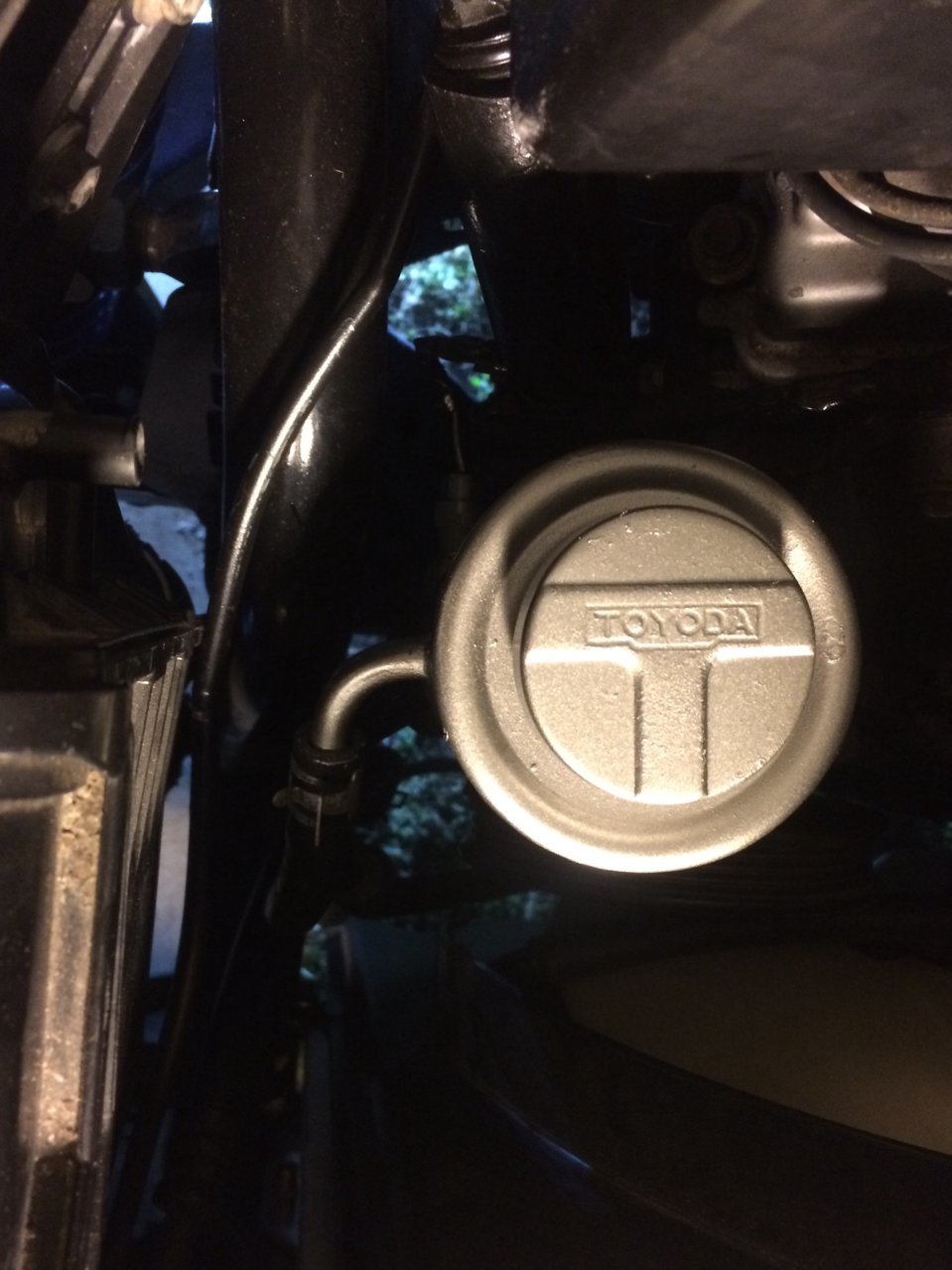

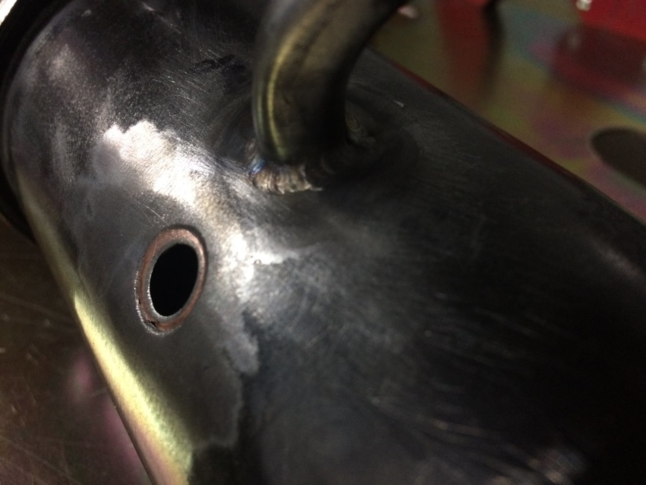

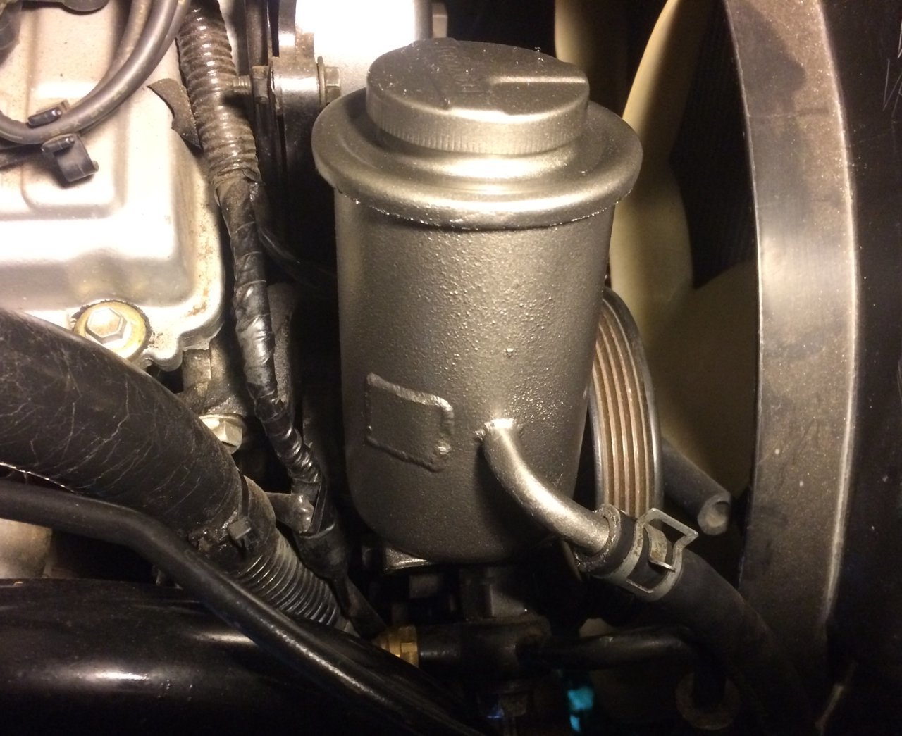

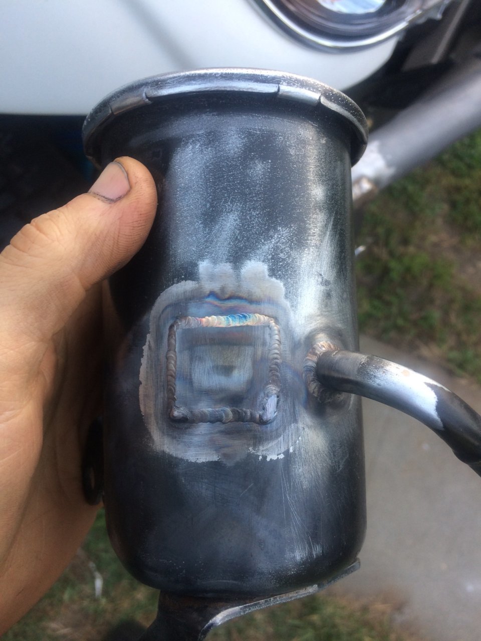

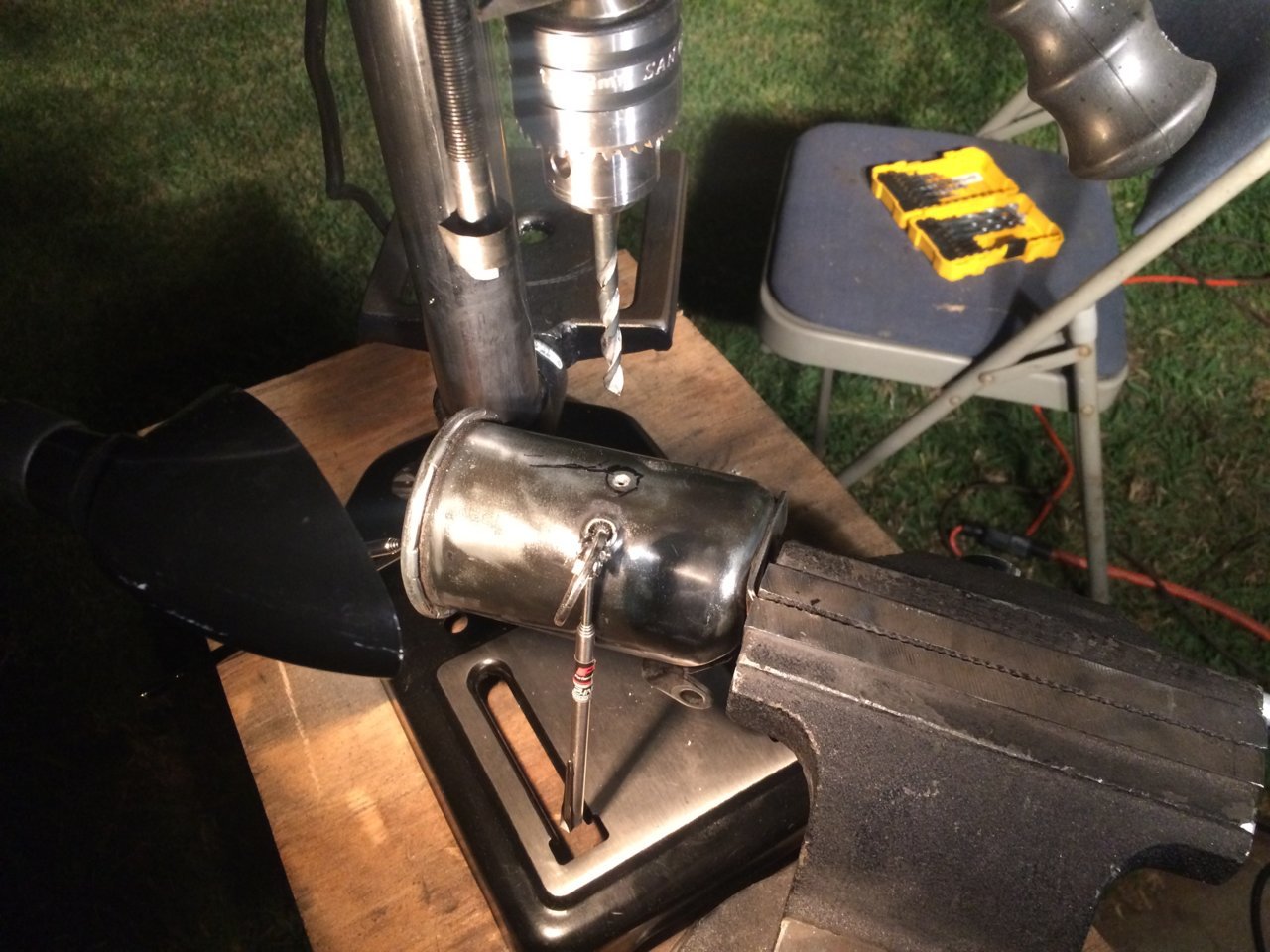

    This was a cool solution to an issue from installing the shock hoops. The power steering return line pressed up against the shock hoop making the hose difficult to remove and get back on.
    I cut tube off of the reservoir and drilled another hole for it.
    @Tacomoto23 tig welded the tube and covered over the old hole. (Alert observers will notice that he's not welding the reservoir, but part of his exhaust, but I got a good pic so I'm putting it haha)
    There was a layer of a copper color metal sandwiched in the middle of the metal the reservoir is made out of. I'm not sure, but there was a lot of smoke when welding and I had cleaned the reservoir with acetone and brake clean inside and out and wire wheeled the heck out of it so I'm thinking the multi-metal material may have had something to do with that.
    All welded up.
    Painted with Seymor 316 Stainless Steel paint - not too impressed with how much overspray it puts out, but compared to steel-it it's super inexpensive.
    Tons of clearance now for the hose.

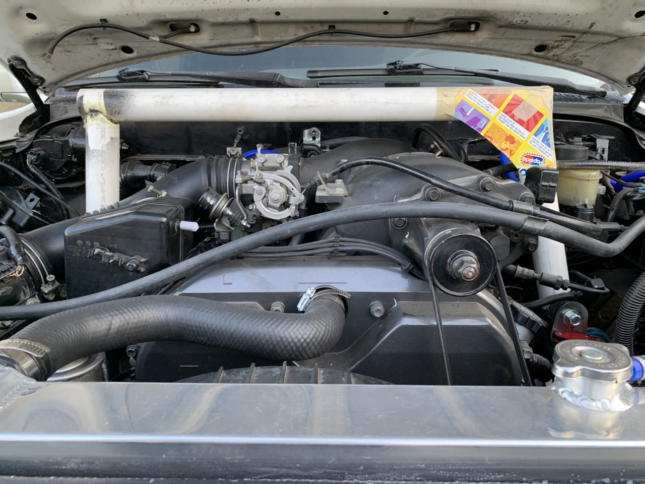

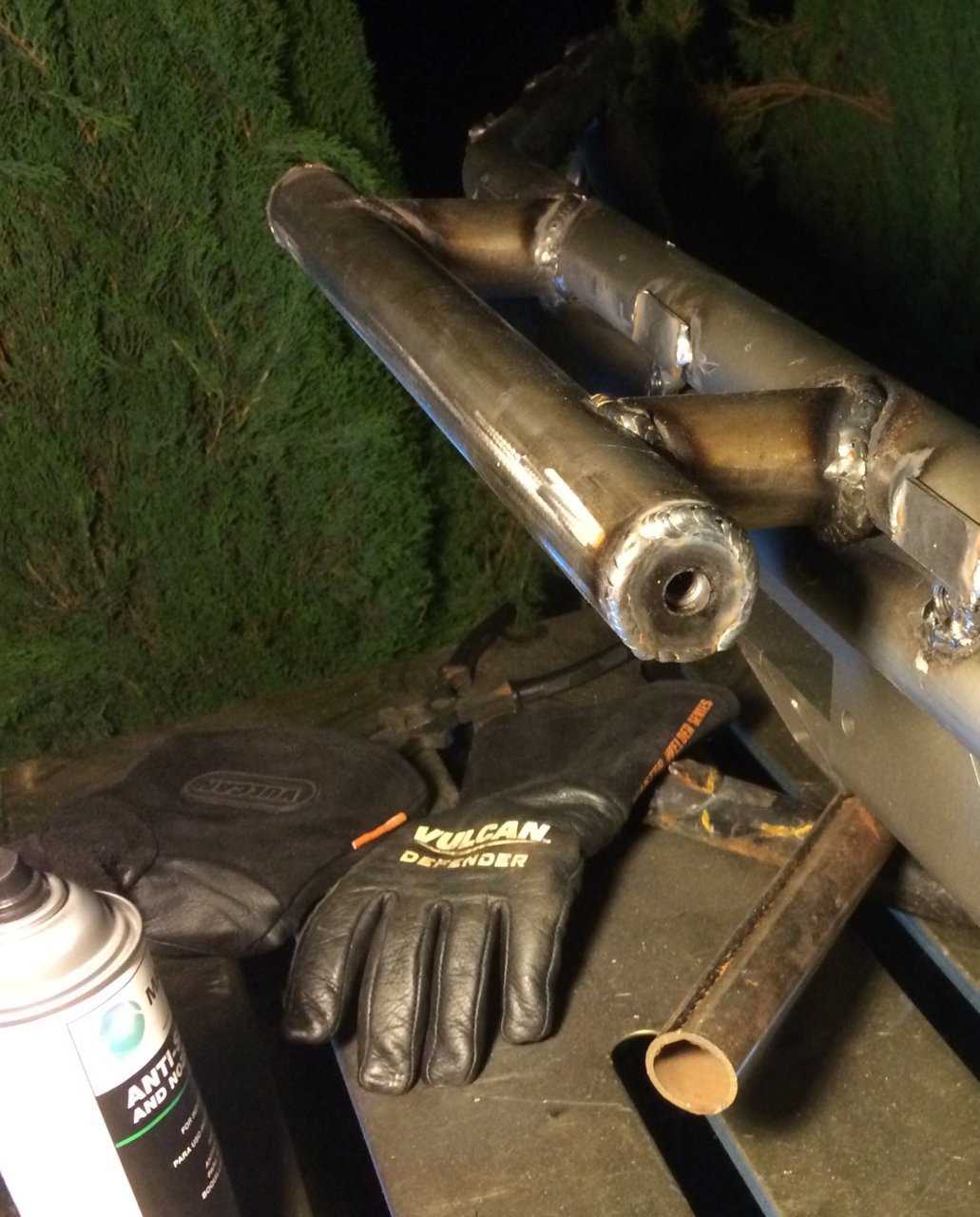

    Working on an engine brace:

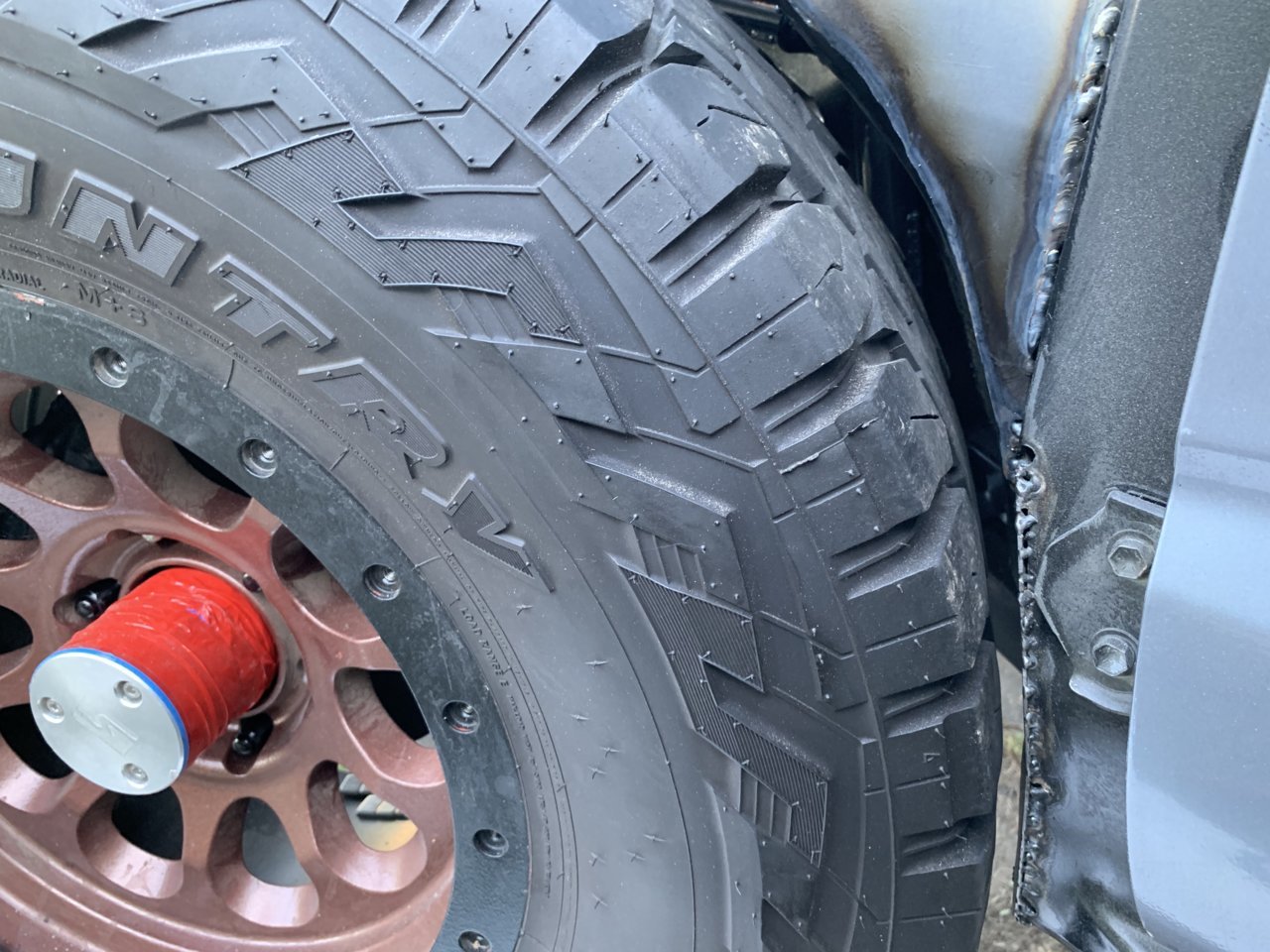

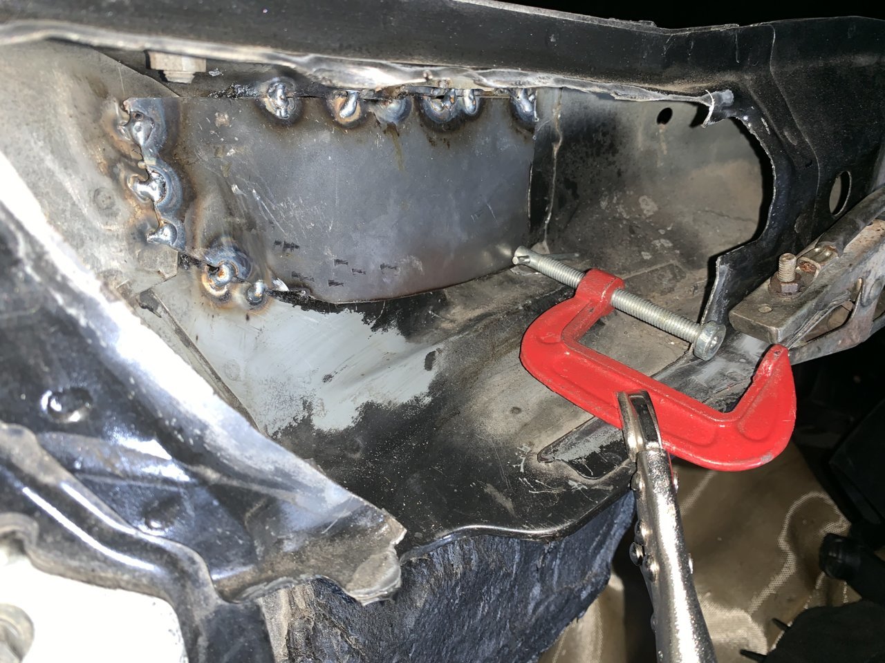

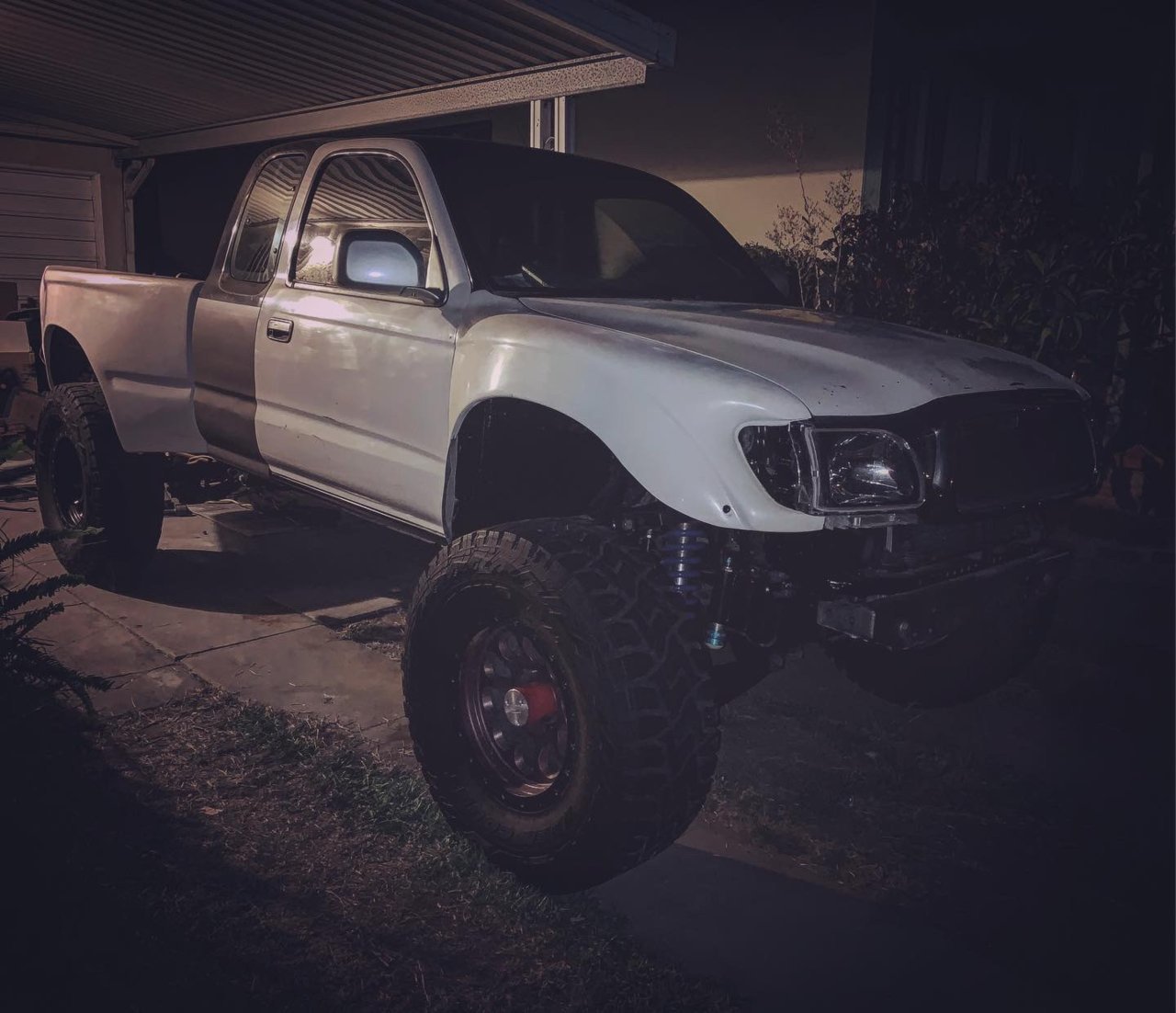

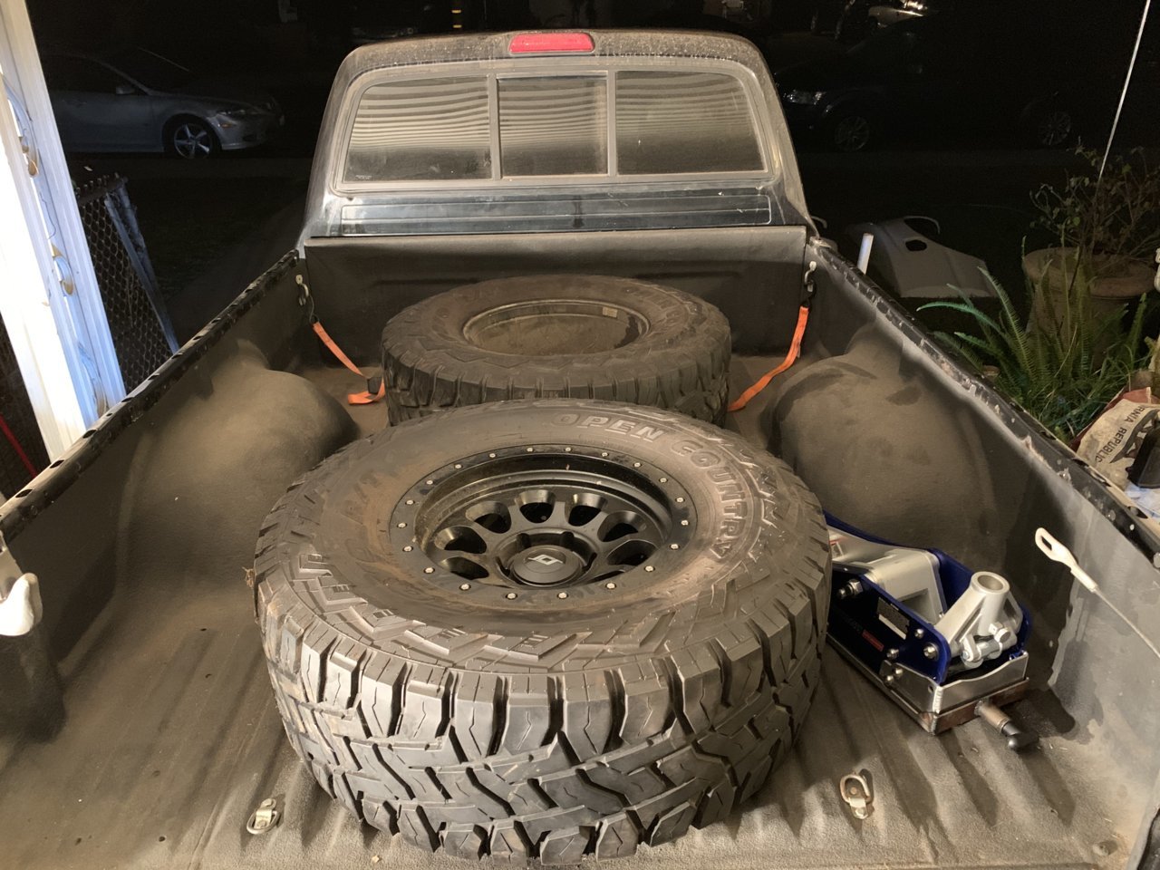

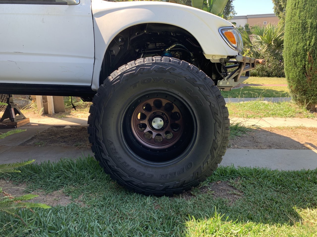

    Went to 35’s - two spares and a good used set of Toyo RT’s
    Had to cut what felt like a ton.
    81E88319-96F3-4DBA-8B36-B49654B1E53C.jpg B83EEAB3-9A47-4EA0-9F5A-D003BFFD487F.jpg
    Sealed it with Henry’s roofing / construction sealer

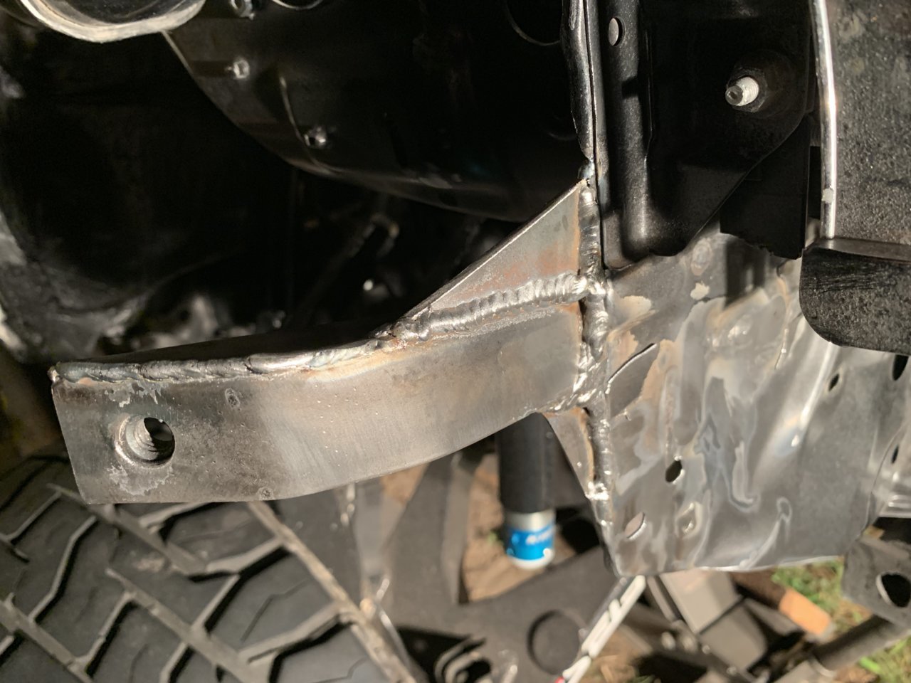

    Started an engine cross bar and made some new fender mounts since 35’s would have clearanced ones I made before.

    Back on it's own weight w/ 35's

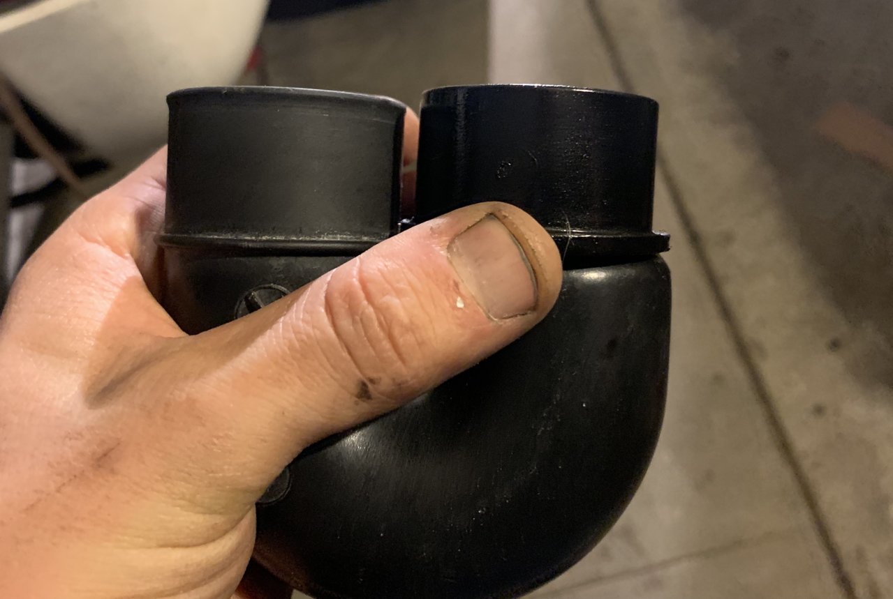

    Made a little pvc plug where the stock air tube will interfere with the cross brace.

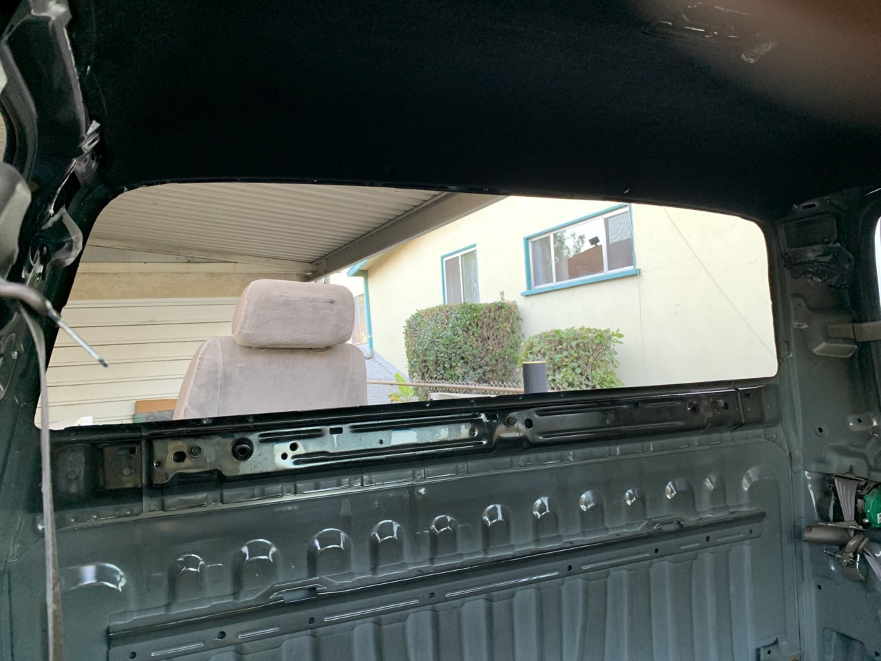

    Got a hand from my neighbor and put in a 3 piece sliding window - I like it more than the 4 piece it had - same design as my 08.
    Wanted to make sure I wasn't getting the "infamous passenger side leak" by the HVAC intake - sealed it up with more Henry's I had left from the firewall. I found out the leak may have been from the AC drain grommet. I'll seal that up as well.
    https://www.tacomaworld.com/threads/the-infamous-passenger-side-leak.415269/
    Sealing the intake back up, had to get a little creative on how to get the sheet metal to form to the core support.
    Gotta trim the front fender a little on this side - looks a little funky, but it's not a huge deal.

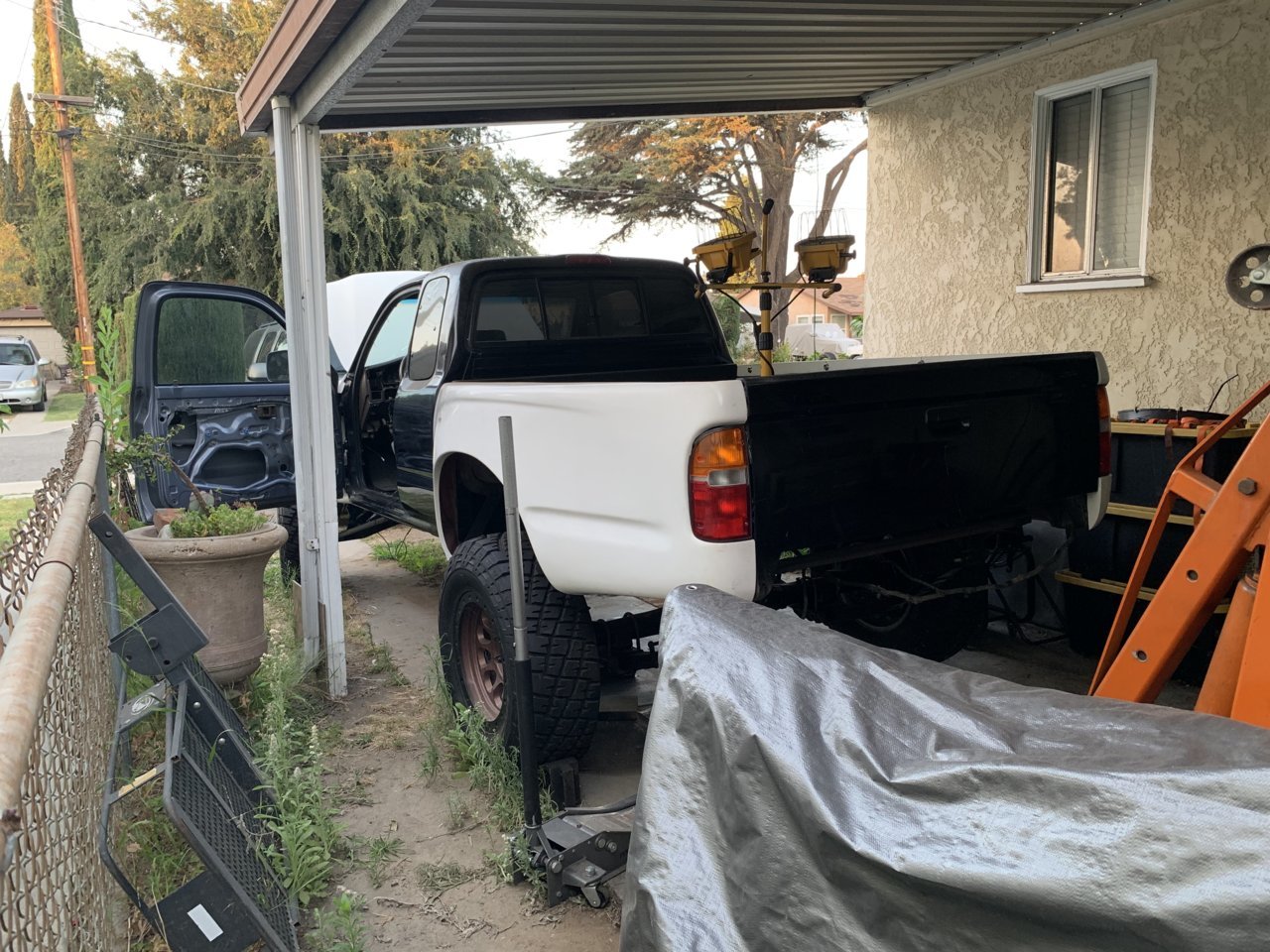

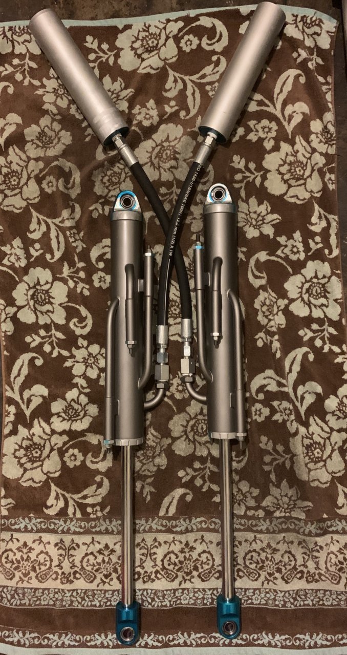

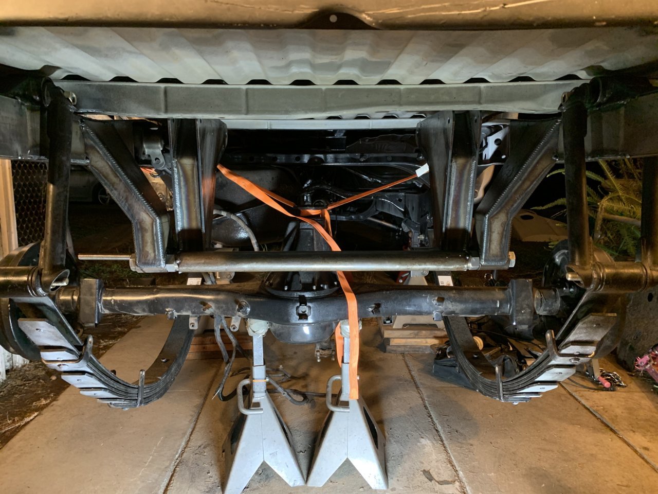

    Began the install for the cantilever suspension with @Anthony250
    E8BE102B-C309-41C6-BB20-97DC53C9F070.jpg CCDE5DBF-9B23-4F67-83E6-EA27833BCC64.jpg

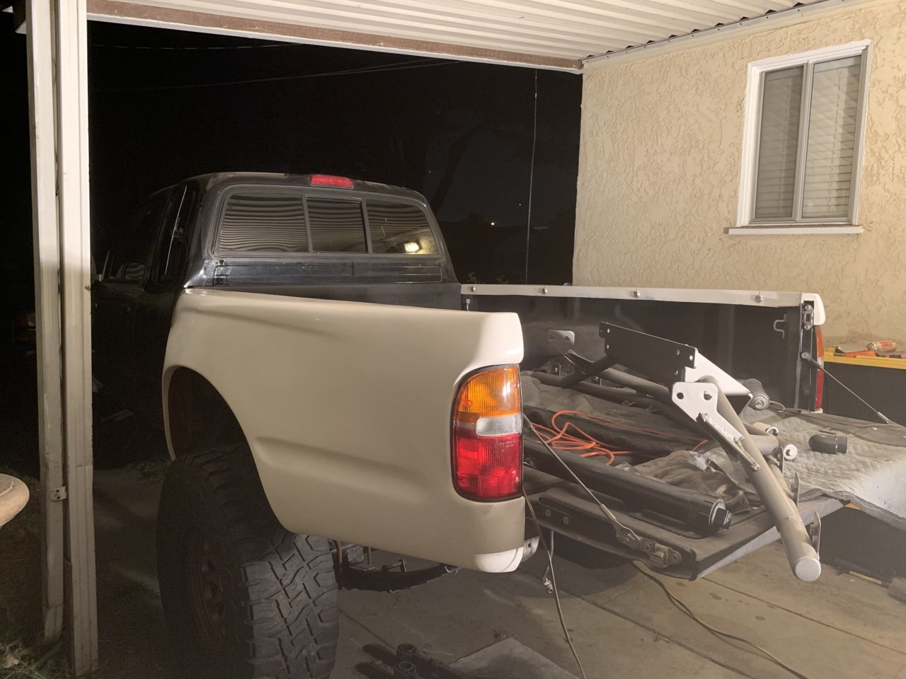

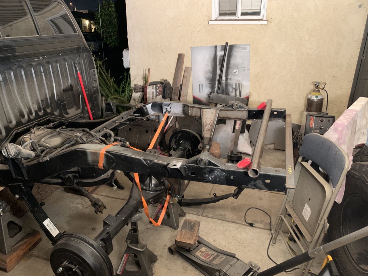

    Getting a bit further with the cantilever and possible bed setup!
