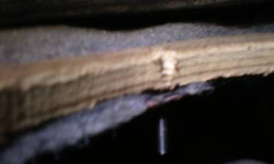

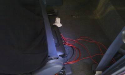

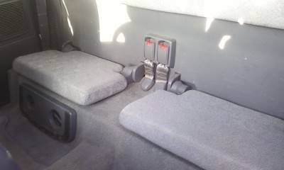

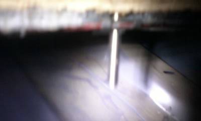

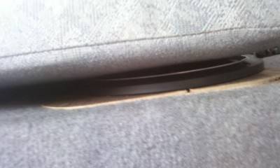

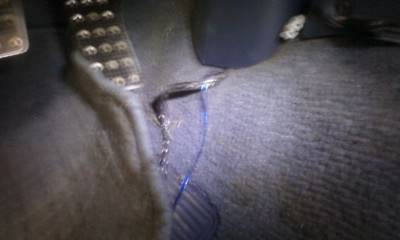

    OOOk, so I went back in today to try and fix my rattles and shore everything up a little. I drilled a hole through the middle of the enclosure and all the way through the bottom of the truck and stuck a bolt through it to stabilize it a little. I comes out right above the gas tank so it a bit tough to get to, but do-able. Sorry I never took a pic of that. But on the driver side I've had a horrible rattle goin and being that I couldn't figure out how to get a hole in the bottom of the truck where I need it, I took a piece of all-thread and threaded a nut and washer up against the underside of the enclosure and another on top to help hold it in place.
    The all-thread is just butted against the bottom of the enclosure so make sure its tight or it'll sound like a jackhammer in there when you turn your music up. then just cut the extra off with a hacksaw and put the carpet back.
    It's not pretty by any means. I would recommend sanding the wood down good and at least painting it to match the interior. Also some day i plan to router the under edge of the covers to help them set in better. Oh, and there will be a bracket that holds the jack that you may have to grind out, depending on the size of your magnets. I did, and its by far the hardest part of the project.
    And I used speed nut clips and machine screws to fasten them down. my biggest regret is not getting bigger ones. I can't remember what size they are, but they don't hold like I think they should, but the do the job. No serious issues so far. Just make sure you measure and get ones that fit the holes well. And make sure you take the plastic frames out when you do this so you can use the holes that are already in the enclosure!

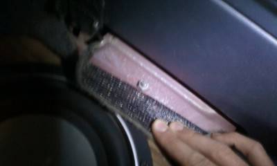

    [​IMG](sorry for the crappy pics)
    I just put the wires under the floor mat. If you REALLY wanted to you could cut a slit in your carpet to run your wires through. I don't have an issue with this though.
    ...and there is a hole in the enclosure you can run the wires through. Just pull up the carpet, run your wires, and put it back.

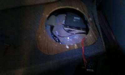

    [​IMG]...
    ... and the finished product.
    With the seats down you'd never notice there were subs in there (aside from the serious vibrating on your ass when they're turned on:D). But It's a good idea to turn them off when people are sitting there to prevent any damage.

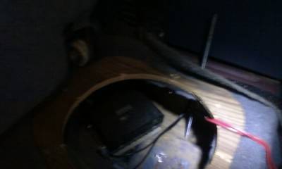

    Amp just sits under the seat (passenger side should work too if you don't like it this way, just reverse all the wiring and stuff)
    some other pics of the wiring... in the firewall there's a rubber plug you can slit to run the power wire (not pictured, its under the floor mat there) through for your amp.

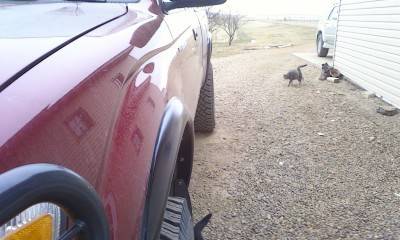

    So I got an itch to do something to my pickup the other day so I picked up some black spray paint and rim clearcoat...theres always something you can do with that stuff. I was never really into my chrome door latches, so I painted those.
    Hey, I finally found a good use for that ridiculous pile of walmart bags piling up in your pantry!
    And my fender flares had some rock chips so I painted those too.
    (its kinda hard to tell much of a difference, but they look better in person)
    Before:
    After
    Notice how in almost every one of my pictures there's a freakin' cat somewhere.:rolleyes: Oh well they keep the mice down, and they're friendly.

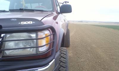

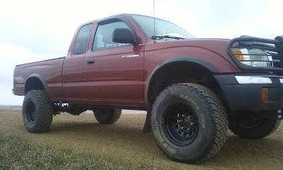

    Well I FINALLY got some better (black) rims installed!:yay::taco:Here they are, 15x10 with 31x10.50 on them.
    I definitely love the wider stance and the more agressive look they gave me. Hopefully in a couple months i'll have some 33's on there too.
