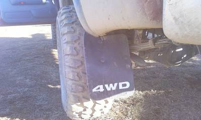

    I did a few minor things last weekend. Changed my oil, rotated my tires, and threw my mudflaps back on the rear, even though they look kind of ridiculous. I plan to fab some sort of brackets to move them over so they actually cover most of the tires. And since i don't have any I took a couple pictures of my diff drop and cv angles while i had the skids off.

    Mud flaps do look a bit ridiculous lol

    At least now people will know i made an attempt to keep the mud down haha. And they'll catch some of tue mud at least. Better than nothin.

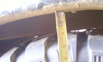

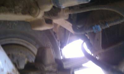

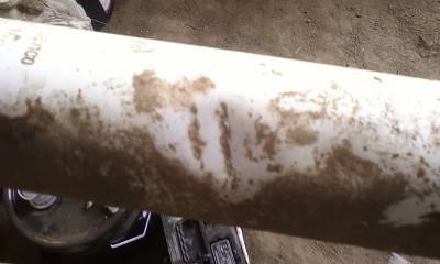

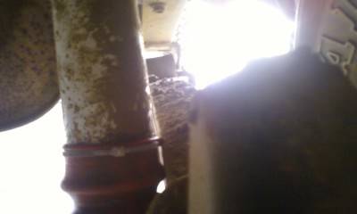

    Well, did some checking on my suspension after discovering my right shock is blown out because it hit on the leaf spring:facepalm::frusty:. Lesson, DONT flex hard with twin tube shocks without modifying first. So I did some measuring to kind of get an idea of how I want to relocate.
    Sorry for the sketchy pictures. Most all my pictures are taken with my 2 megapixel phone camera.
    The shock was at this point touching the leaf spring, and it was not quite at full flex. Had it been a monotube shock I would have probably been alright. But alas, I was not :mad:
    Here you can kind of see where the leaf spring dented the shock body. I had the shock mounted bodies down, and have since flipped them to keep shit from building up around the seals. It also seems that the shock lost it's charge, as it is now sloppy and has little dampening resistance. (I can easily compress it between my hands).
    You can see the leafs are beginning to invert and the bumpstop is nowhere near bottoming out, and i want my leafs to be flat at full flex to prevent any damage.
    This is my passenger side tire measured from the top of the fender.
    This is where my driver side was at while flexxed. The tire still isn't rubbing at this point so I'd like this to be my full stuff to keep my leaf springs from going inverted. Measuring from the edge of the lug it gives my about 12 inches of flex, which makes me worry about my 10 inch travel shocks :(
    I had my truck on ramps, one under the front passenger tire and one under the rear driver to try and find out about how much travel I actually have, and where I want my suspension to stop.
    I ordered some shock mounts and a new passenger side shock, so hopefully I'll start relocating this weekend.
