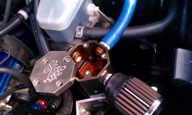

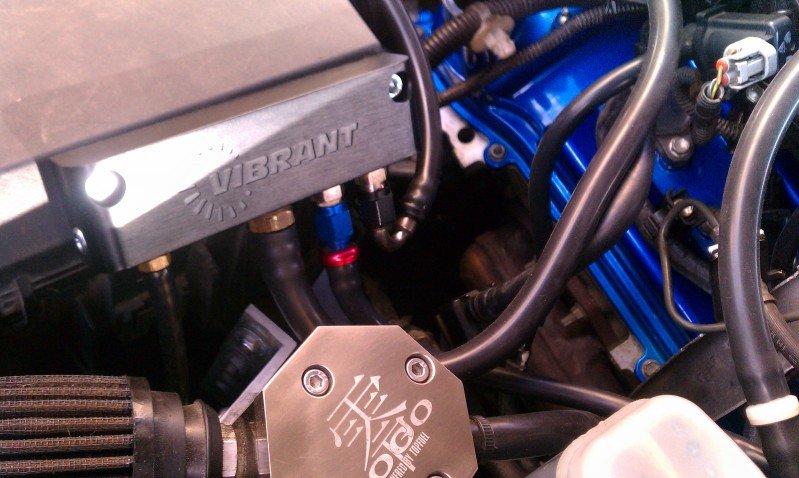

    Torspd Custom Turbo kit [] Borg Warner 9180EFR Turbo [] Haltech Elite 2500 [] TiAL Q BOV [] TiAL V44 Wastegate @ 15psi [] CP Pistons [] CP Carrillo Rods [] ARP Head studs [] ARP Main Studs [] ARP Header - Head Studs [] Ported Heads w/ 1mm oversized valves intake/exhaust [] Brian Crower Forged Stroker Crank [] Darton M.I.D. Sleeved Block [] Kelford Camshafts [] Torspd 160* T-stat mod [] APR Large Fuel Rail [] Walbro 460 LPH E85 Fuel Pump [] FueLab FPR [] APR T56 Conversion Kit [] KP RACING Built T56 [] McLeod Racing Custom Twin Disk Clutch [] One Piece Aluminum Driveshaft [] MGW Shifter [] Custom lowering kit [] Ohlins Front Coilovers [] QA1rear shocks [] Custom Ron Davis Radiator [] Dual SPAL Electric Fans []
    My current catch can setup.
    And it working....

    do you not get a CEL or code since your setup isnt air tight with that filter?

    No sir. Both valve covers are routed into the can. Then it vents on its own. No suction. So it isn't tied into any of the intake or related parts at all. I plan on rerouting it later, but it will still be independent of the intake.
    Mine also has to be slightly different since I run a turbo. I have to route it in such a fashion that i don't add boost pressure into the crank case and surrounding areas. Otherwise, it causes LOTS or oil leaks. Plus it reduces power.

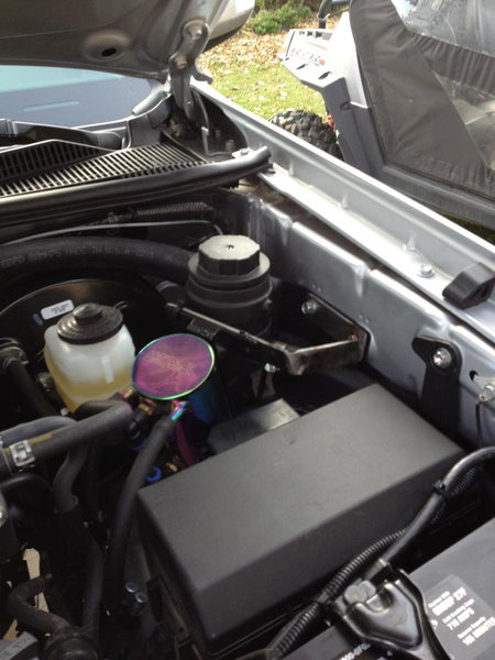

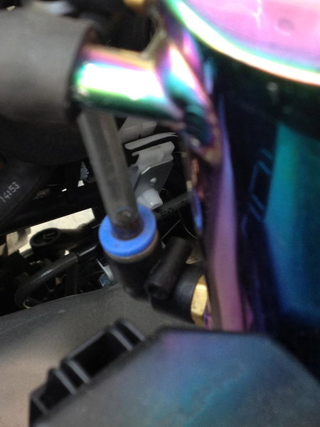

    My ghetto rigged catch can holder that my brother fabbed up for me, and a pic of it working :D

    That looks pretty dang good actually.

    Thanks man, Yours looks quite good/professional!!! I got most my ideas from people on this thread, so hopefully more people add to it!
