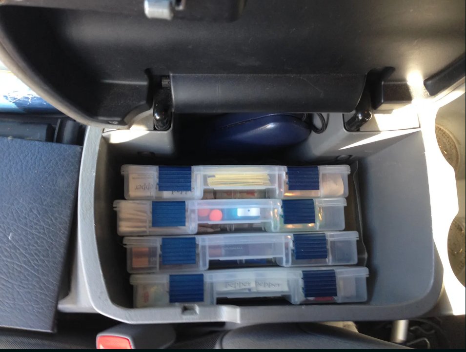

    I've turned my attention that the collection of stuff accumulating in my center console storage bin.
    On my 2nd Gen I used Plano 23500-00 Size Stowaway with Adjustable Dividers to keep everything organized. I had containers for breakfast, lunch, toiletries, & misc. items.
    I've been searching and not finding a similar solution that fits the 3rd Gen Taco. None of Plano's products fit. I'm aware of the inserts & don't like that option. Has anyone found a storage box that fits in this location?

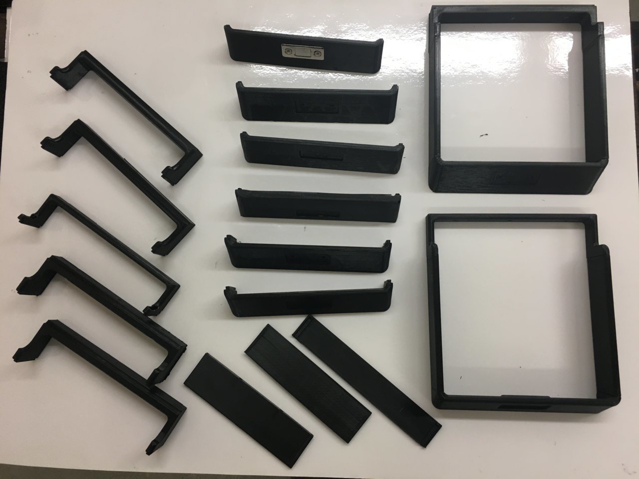

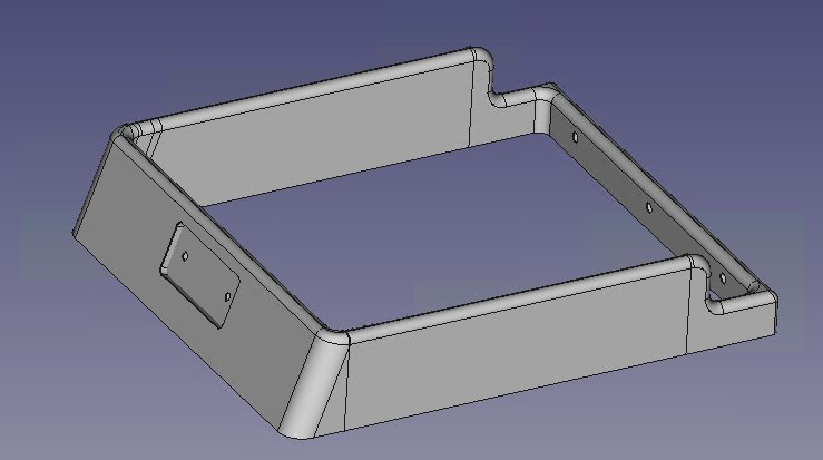

    For the center console lid storage, I haven't found anything I like, so I started designing my own part. The part is too big to print on my 3D printer in one piece so I'm going to have my local TAP Plastics shop make a 3/32" sheet of ABS plastic like this:
    Then I can 3D print the sides in 4 separate parts that lock together"
    I've ordered magnetic latches
    And these piano hinges
    Lots of details to work out: glue? fasteners? but I'm excited that I've got a solution that looks like it will work.

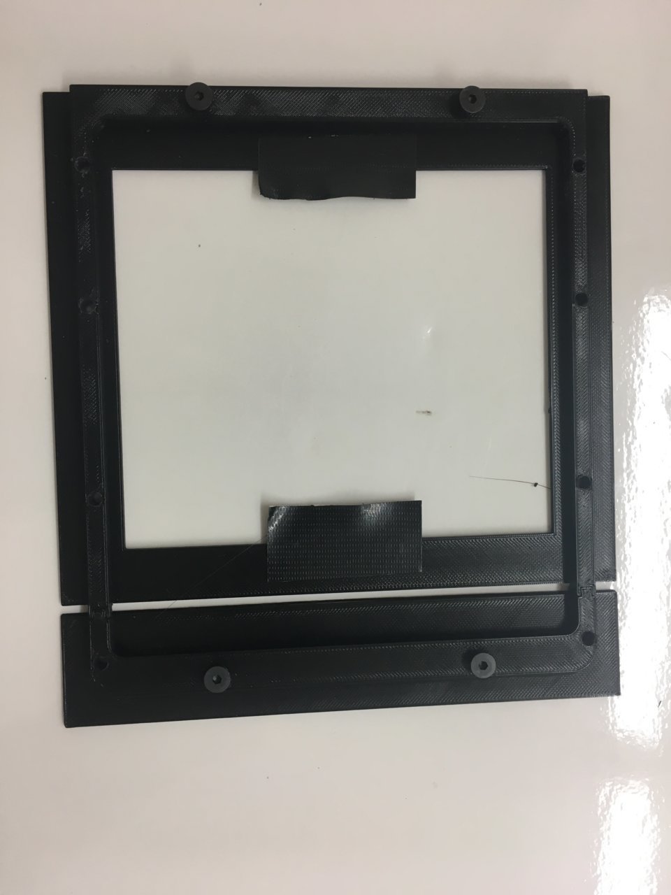

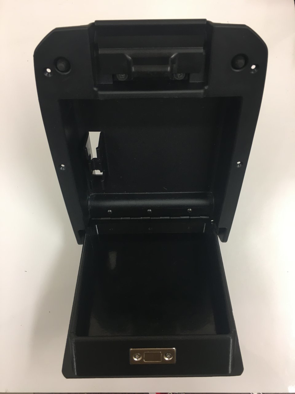

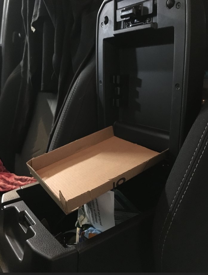

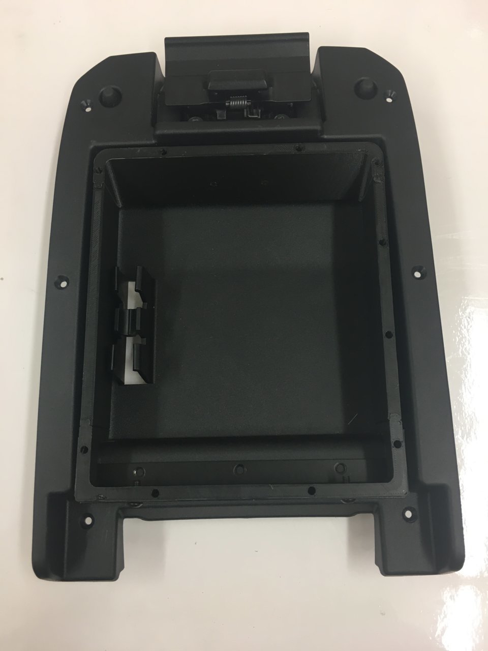

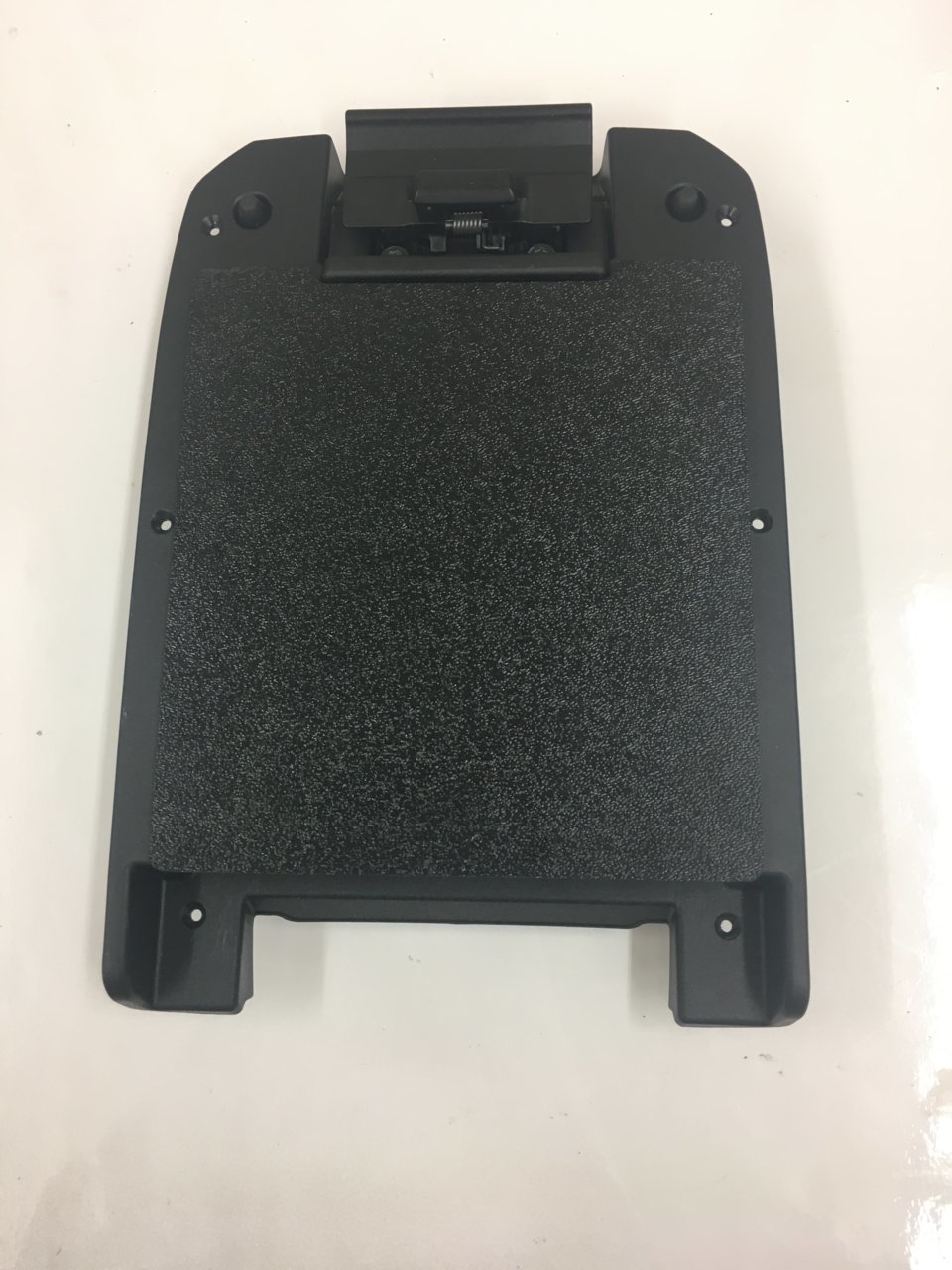

    Here's my progress on a hidden console lid compartment:

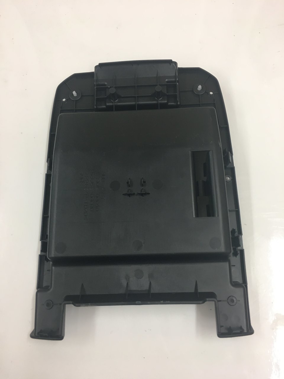

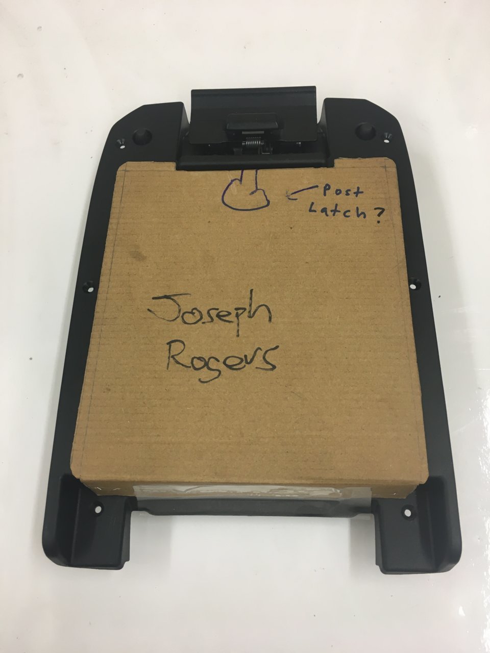

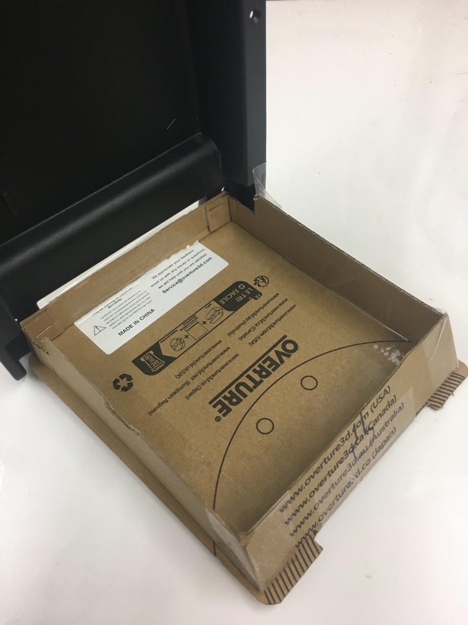

    I removed the center console cover insert so I could mock up a tray that fit.
    Then I used cardboard to get a rough idea of how it would work. Where the latch and hinge would be located and how it would fit.

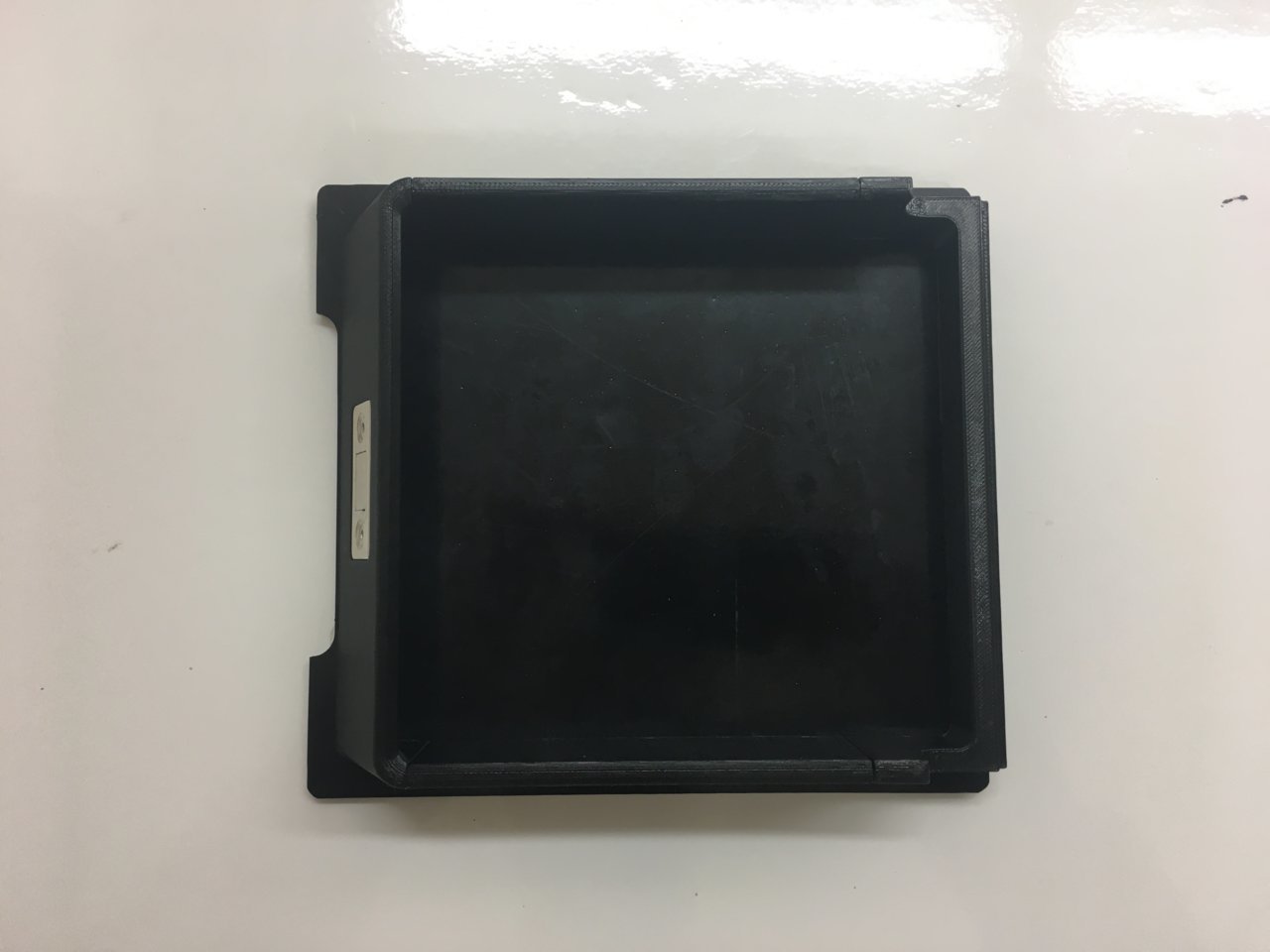

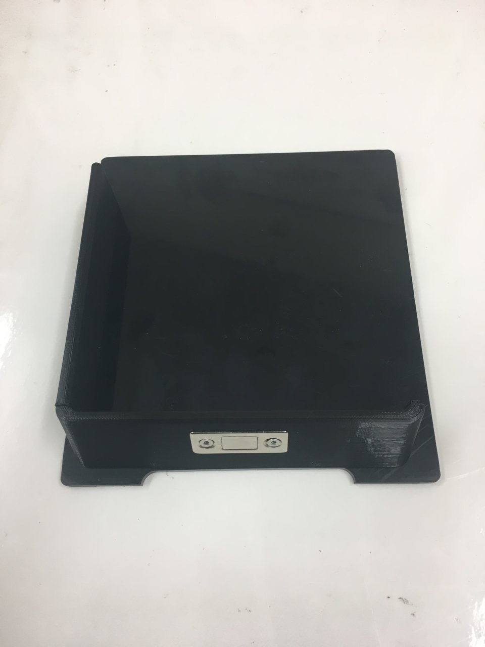

    With the dimensions of the cover, I had TAP Plastics make one out of ABS plastic. I mistakenly requested 3/16" instead of 3/32" so it is much thicker than I want. But good enough to get started.

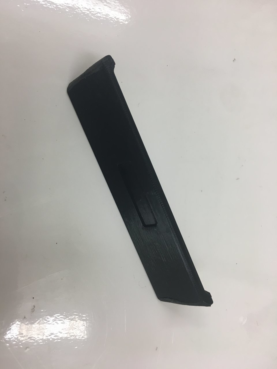

    My first draft with 4mm sides proved flimsy:
    So I switched to 6mm thickness and started working fine tuning the parts. Basically this means printing a part, testing fitment, changing the design, and repeating until it works.
    First draft of the front part with the latch (latch hole wrong position) and does not fit console.
    Second draft of the front part with the latch (latch hole wrong size) and does not fit console.
    My third attempt on the part with the magnetic latch is close but still needs some minor touches. Like the fact that the screws almost protrude out the other side of the wall.
    Here you can see the tongue and grove technique I'm using to fit the side parts together.
    Here I found I needed to do some trimming to get the sides to fit.
    But with that the hinge placement looks good.
    So the (hopefully) final draft looks like this. Four 3D printed side parts with a hinge and magnetic latch:
    With an ABS plate from TAP Plastics:
    That pen holder is an annoyance that I will probably delete. I can make a blank to fill that hole.
    The 3/16" ABS is too thick. On Monday I will get some parts ordered in 3/32.

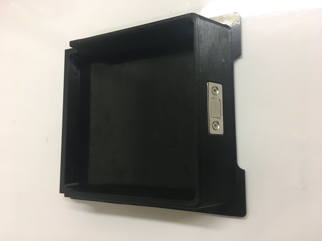

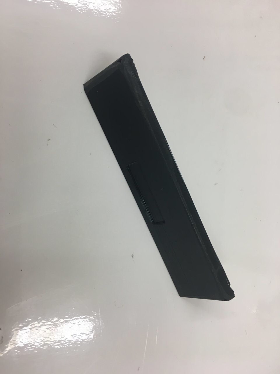

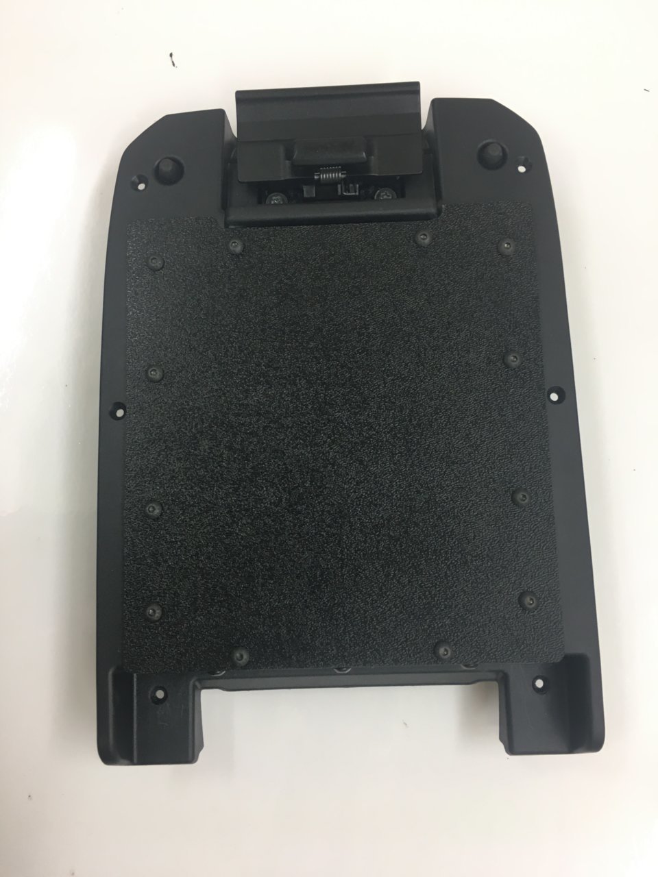

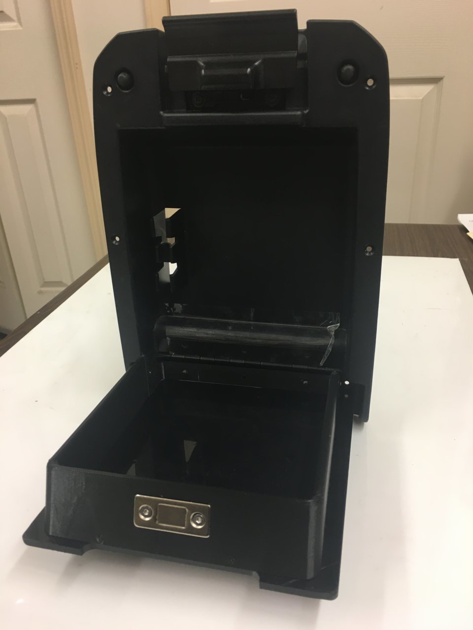

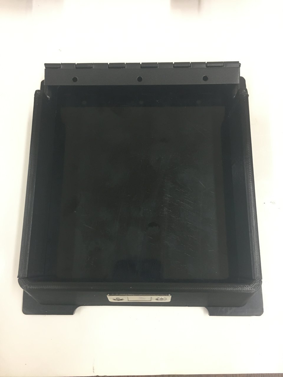

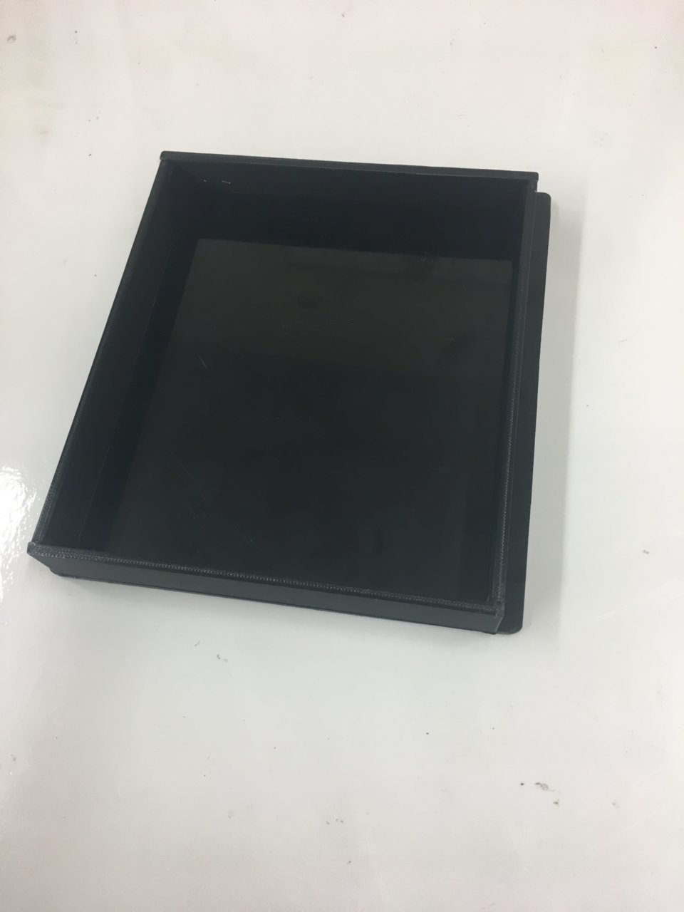

    The iterative process of design, print, test fit, wash, and rinse; repeat:
    Note: the above photo is of parts that didn't work. Hours spent spend in the design process...
    Combined with a jig which is printed to drill holes in the 3/32" ABS plastic sheet:
    Ultimately, this process reaches an asymptote:
    Which we call version 1.0

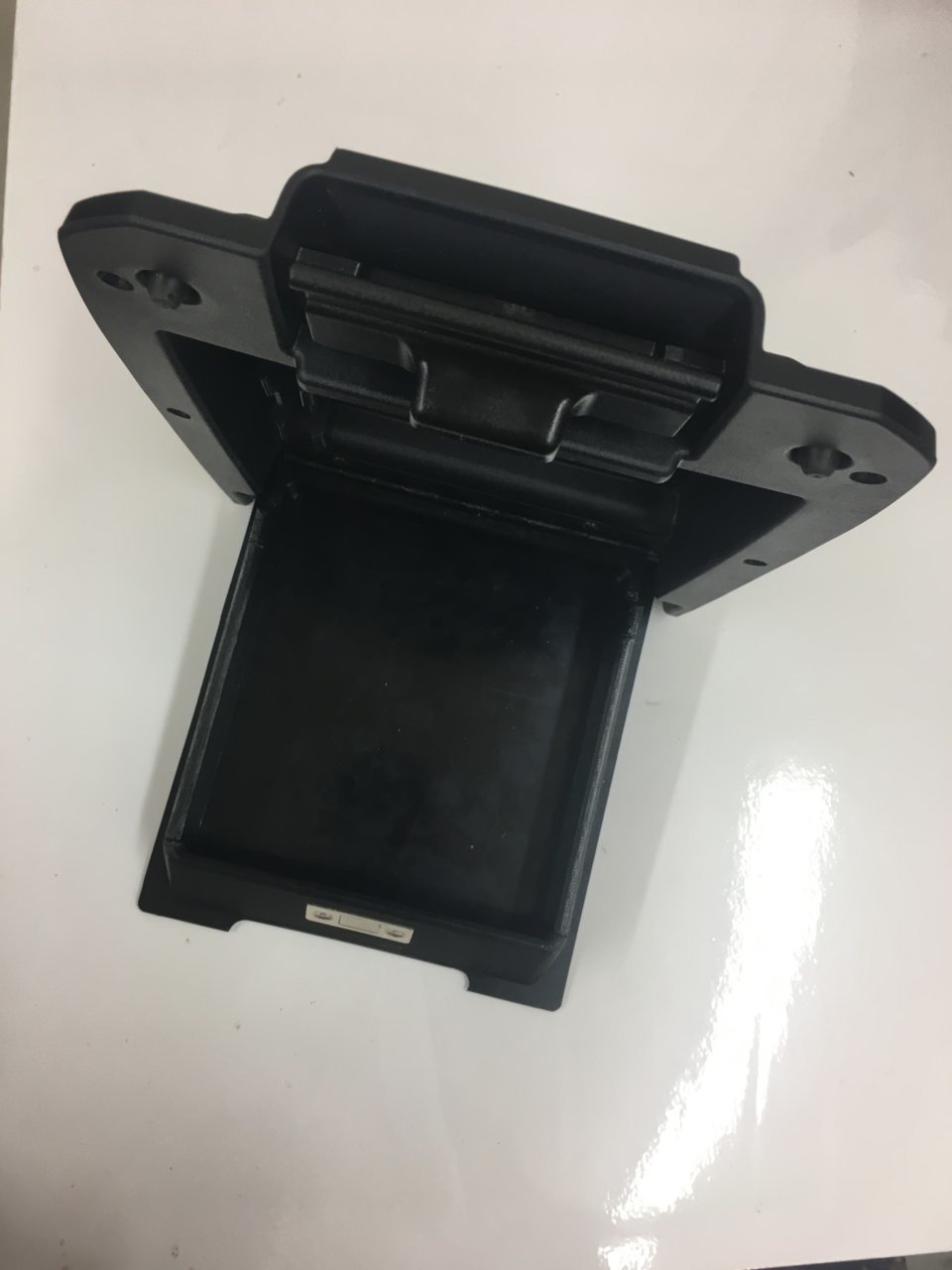

    A hinge and steel plate for the magnet need to be installed on the console lid part:
    Tray attached to hinge:

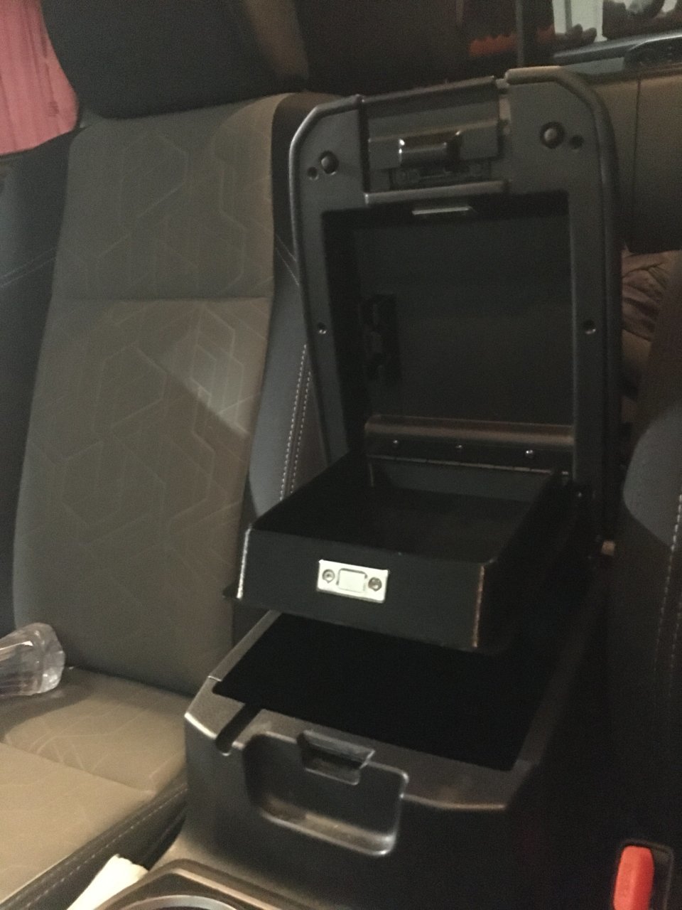

    Test fit in truck:
    Flash photography makes the ABS plate sparkle but it is in fact quite dark.
    So that's version 1.0.
    I oscillated between button head and flathead screws for the ABS plate. The advantage of button head screws means only one screw type is needed for the hinges and attachment of the ABS plate AND no need to countersink flathead screws.
    Another design challenge is the placement of the hinge screw holes and steel plate for the magnetic latch. The magnetic latch only works if the magnet in the tray contacts the steel plate directly. So a reliable way to align the hinge holes and steel plate needs to be developed to simplify the installation.
    I also think the holes for the machine screws can be optimized both in position and number of attachment points. Ultimately (with a reliable adhesive) the number of machine screws could be reduced to 4 (for alignment) or zero with the appropriate jig.
