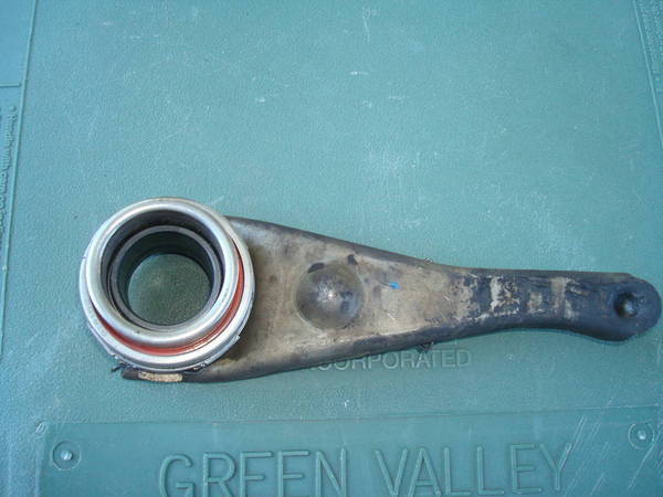

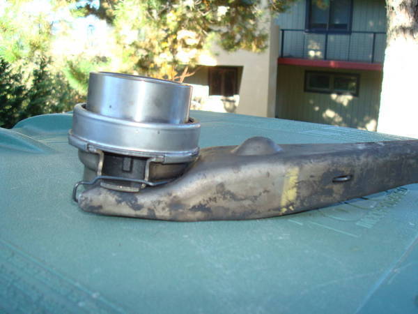

    ok so I had the transmission back on this morning. Felt like i forgot something so i kind of putzed around and found that the release lever that controls teh throwout bearing was stuck in one place. I finally got it to move bt it was all over the place. I took the transmission off again.... and im pretty sure i installed the bearing to the release lever wrong. i might have it right now but there isnt any resistance puching the bearing backwards once the lever pushes it forwards.(if that makes sense). Is there supposed to be back resistance created by the retainer clip that holds the bearing to the lever? or is the pressure created once i put everything back together? Heres some pictures of how I have it now it would be great if someone could tell me if this is right.

    It looks right...how did you have it before?

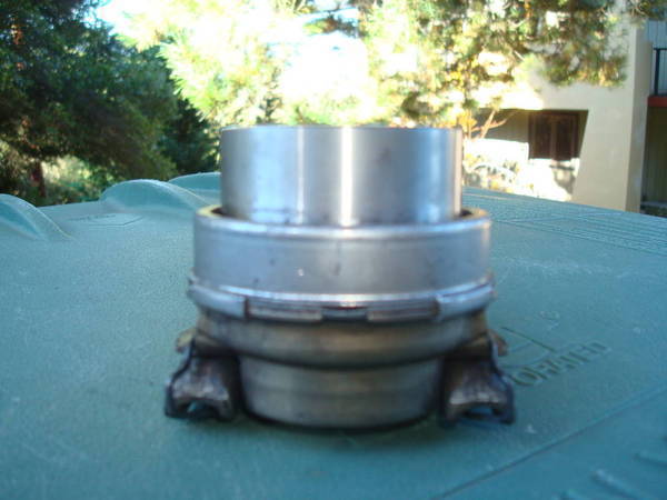

    well I had the retained clip turned upside down from how it is in the pictures. and then the throw out bearing was upside down as well. The clip fit into the lever better that way and gave good back pressure on the lever from the bearing. but from the pictures in the haynes I needed the longer part of the bearing towards the clutch assembly...

    It almost feels like the bearing is going to fall off the lever if i leave it like this. but if there is pressure coming from the clutch assembely then i think itl be fine. Im just not sure how everythign works still

    the bearing on my truck (chevy) was held pretty solid but the bearing on my civic felt like it was gonna fall off but there should be tension on it when its back together.
