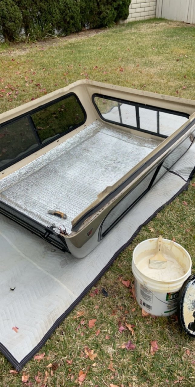

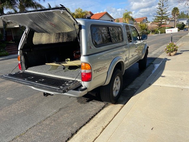

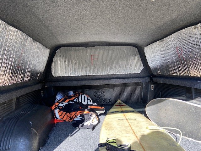

    I bought a used leer off craigslist and did reflectix insulation, upholstery, removeable Velcro reflectix windows, and racks by myself. I redid the brake light. I threw two layers of yoga pads for the bed and with carpet on top, cut for the wheel wells. I had new keys cut so it locks.

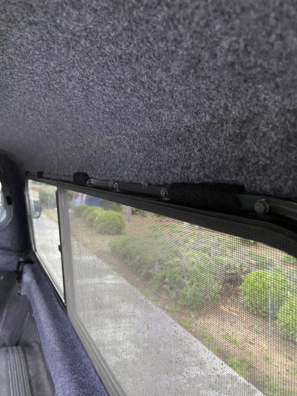

    I’d love to do something like this to my shell if it’d stop leaking from the sliding windows. Do you have any pics of how to relflectix sticks over the windows?

    Where did you get the parts to fix the tail light?

    Velcro on the window sill and the reflectix windows. Use acetone on the sills before you attach any adhesive velcro
    eBay searched “camper 3rd brake light”

    Velcro adhered to the metal window frame is redundant. Fabric on headliner is "velcro friendly" (loops); just adhere Velcro "hooks" to Reflectix and fasten Reflectix to the headliner.

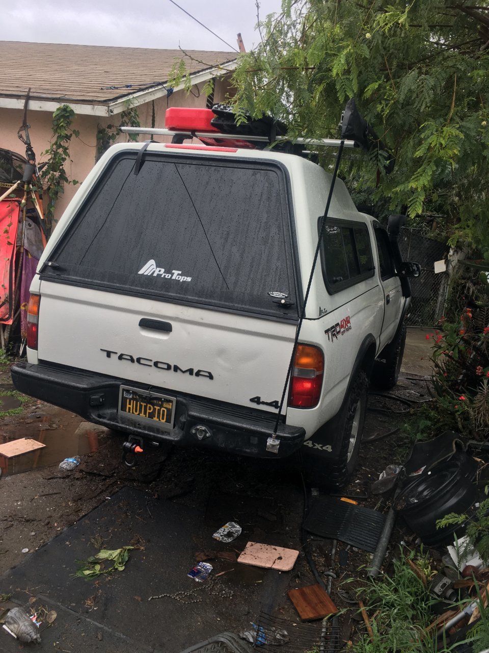

    Brah you live in a dump ? Whats up with all the trash

    Not my house lol
