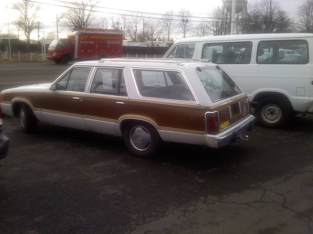

    I found a wagon finally in 2010 on a small local used car lot. I eventually picked it up for $500.

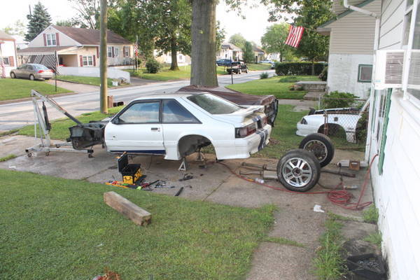

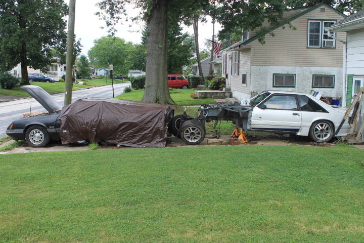

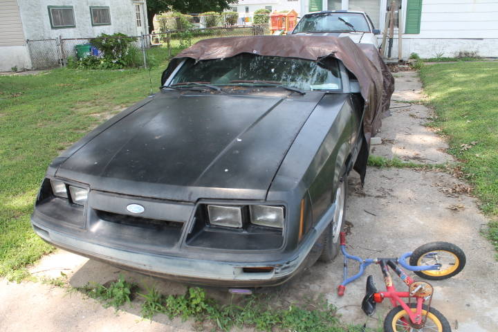

    The donors!

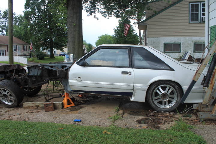

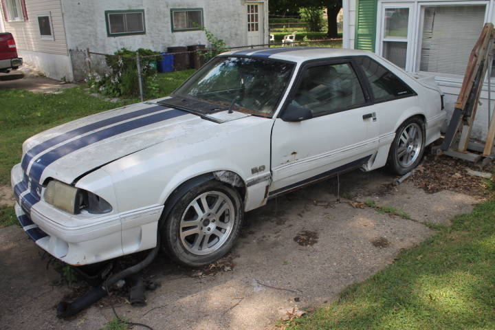

    The white car had a lot of performance parts, but the motor was shot. Cobra brakes and ford racing lowering springs are coming from the white car. The 1986 has the tremec and a running stock engine. I am going to keep the fuel injection with mass air. I'd like to step up to a long rod 351 in the future. The goal is daily driver with good useable power to surprise unsuspecting performance car drivers out there.

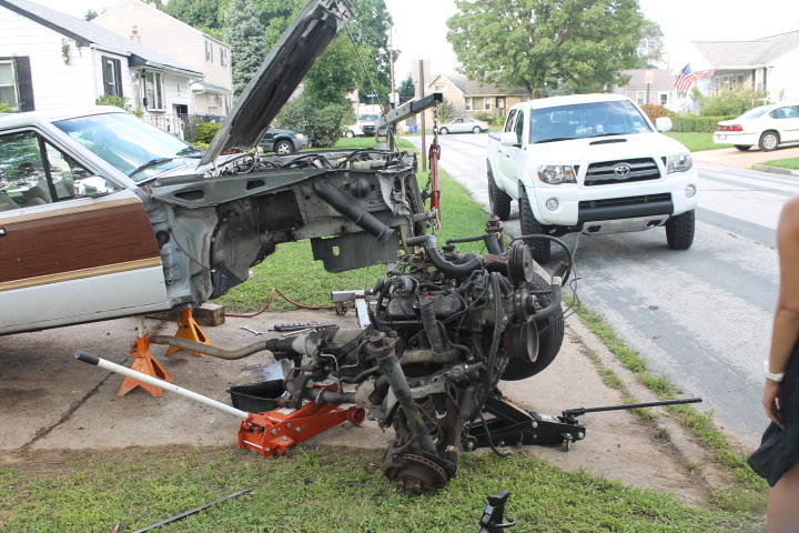

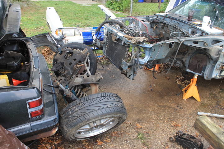

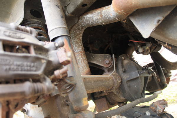

    First, I pulled the front suspension with cobra brakes.

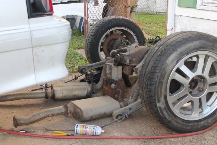

    Then I pulled the rear axle, also with cobra brakes and an auburn with 3:55 gears.

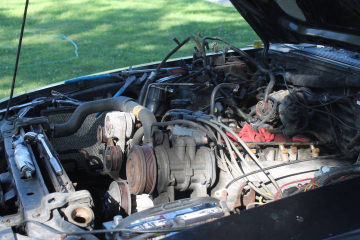

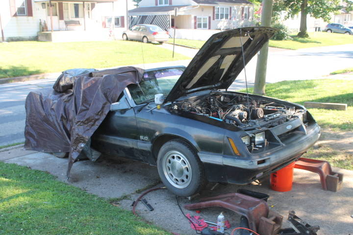

    Then I pulled the engine and trans out of my 86 gt.

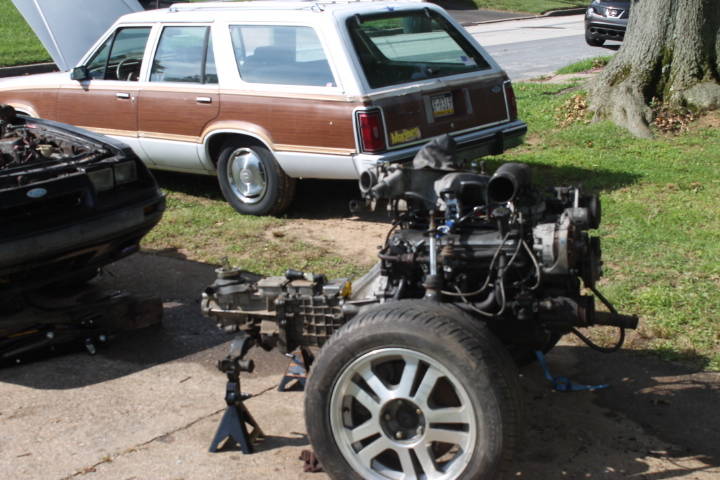

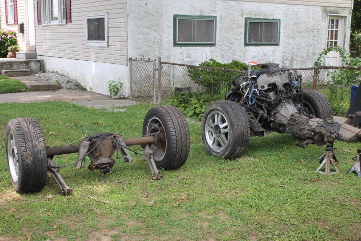

    I setup the parts for installation into my wagon. This was how I spent 2 weeks of vacation in August.

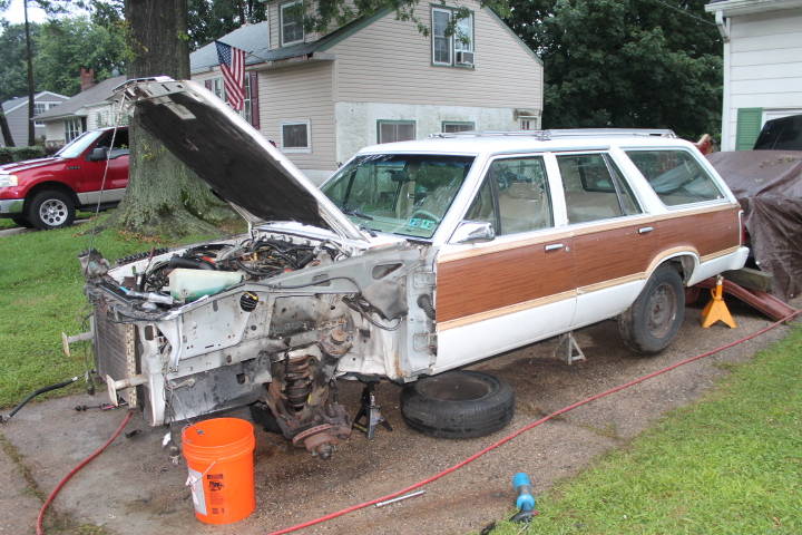

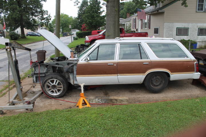

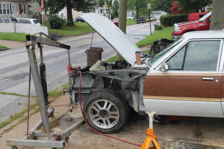

    It was time to finally start tearing into the wagon!
    Out came the 3.8 v6 and c5 automatic.

    In went the 5.0 and tremec 5 speed.
