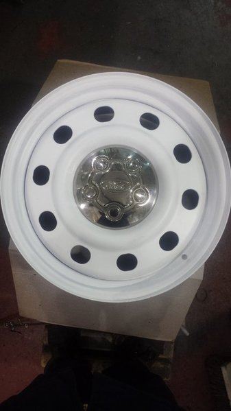

    Yeah. The guys at work are always telling me to get back to working on the daddywagon. I bought crown vic 17" steel wheels for the sleeper look. I got another 351w short block because I didn't like the helicoil repair that I did on a timing cover/water pump bolt hole. I think it was drilled offset previously so when I repaired it, it ended up off center. I pdipped one of the wheels to sample white but I have since peeled it off and it is black again. The offset of the wheels tucks them alot. I will have to run spacers up front but won't have to roll the fenders in the back. The big push this summer will be the engine. I will strip down the shortblock tonight and bring it to the machine shop tomorrow.

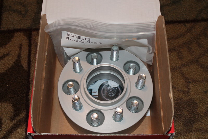

    Well. I bought the wheel spacers from american muscle. They arrived in the mail yesterday. And today I ordered pistons on a whim. Impulse buy.

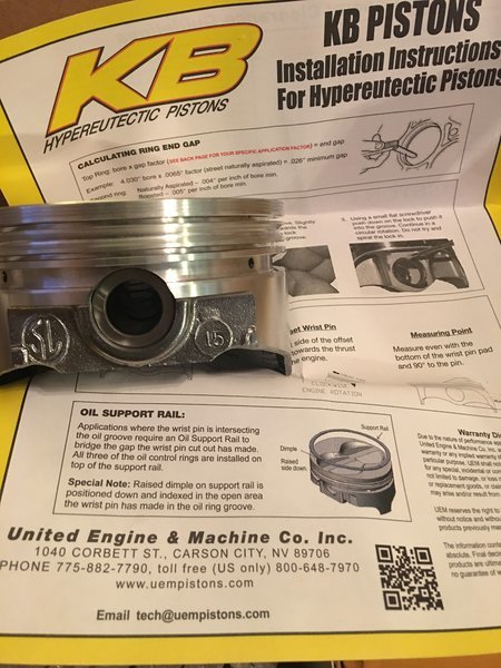

    I know, and I really do appreciate it. My focus right now is on the proposed engine for the daddywagon. As noted I am attempting a longer-than-stock connecting rod 351 windsor. The handful of testimonials I have read claim increased power on 87 octane pump gas with a smooth idle. In that vain I have purchased connecting rods, 4.030" Keith Black KB333 hypereutectic pistons, two 351 windsor engines and I am currently in touch with someone on craigslist about a '93-'95 cobra camshaft.
