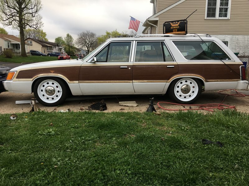

    1985 Ford LTD midsize. It was the successor to the Ford Fairmont wagon. One of a couple of vehicle models, including the mustang, which were built on the same Ford fox chassis.

    I mounted up some tires at work in a different size. I'm going with 225/50r17. I had to cut the front wheel studs almost half an inch to accomodate the eibach spacers. The spacers work great but the factory studs stuck out from the spacers and made contact with the wheel surface. These crown vic steelies are ideally suited for the rear but up front they contact the calipers if I don't run spacers.

    I plastidipped 2 of the rims to see if I want to powder coat them.

    I think they look good white but black is more sleeper style to me

    That's exactly what I was thinking. I think the white turned down a little would look good. My brother suggested brown for the wheels. Which leads me to a nice bronze possibly?

    I agree, the white stands out a bit too much. But bronze would be interesting!
