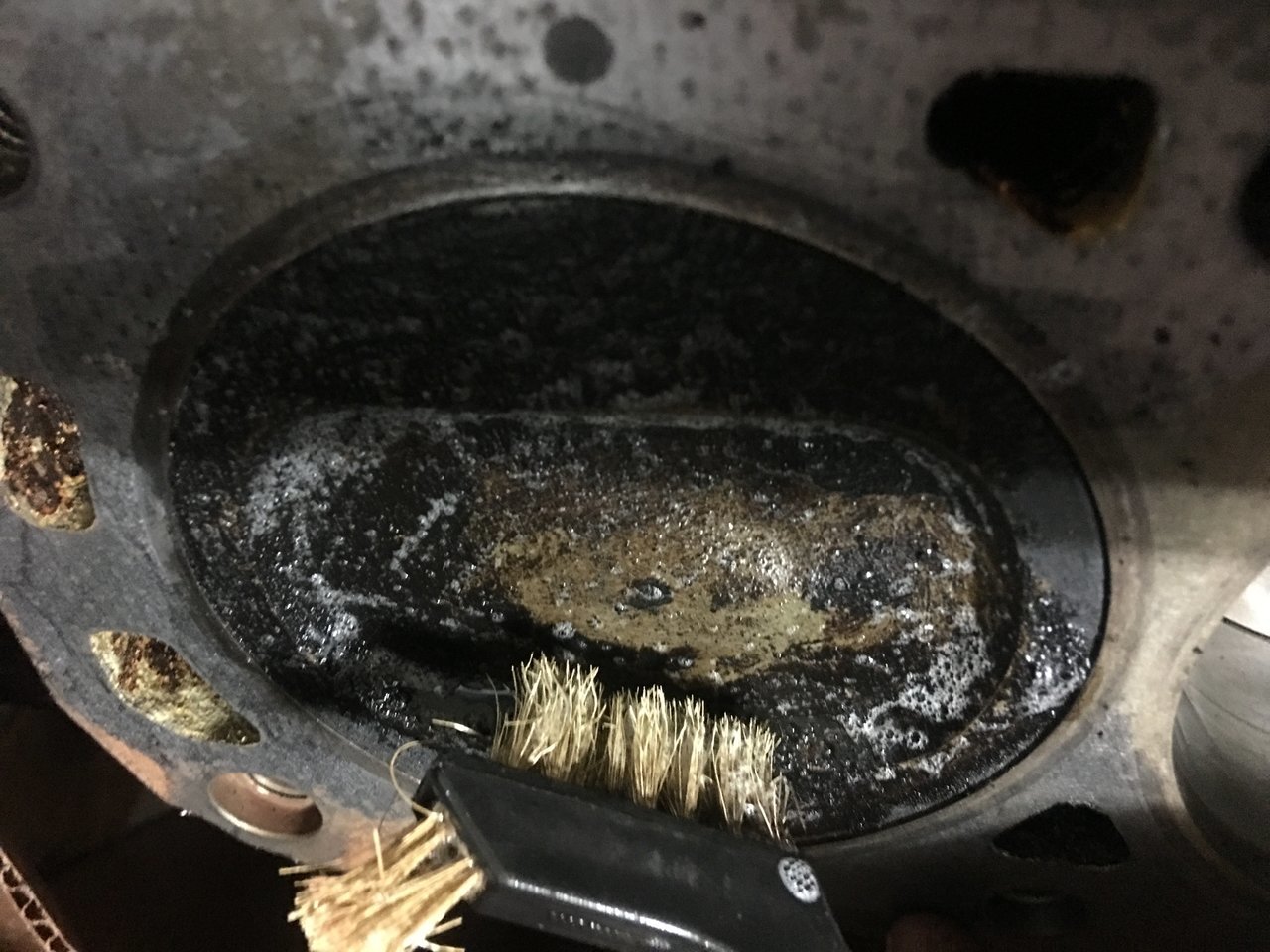

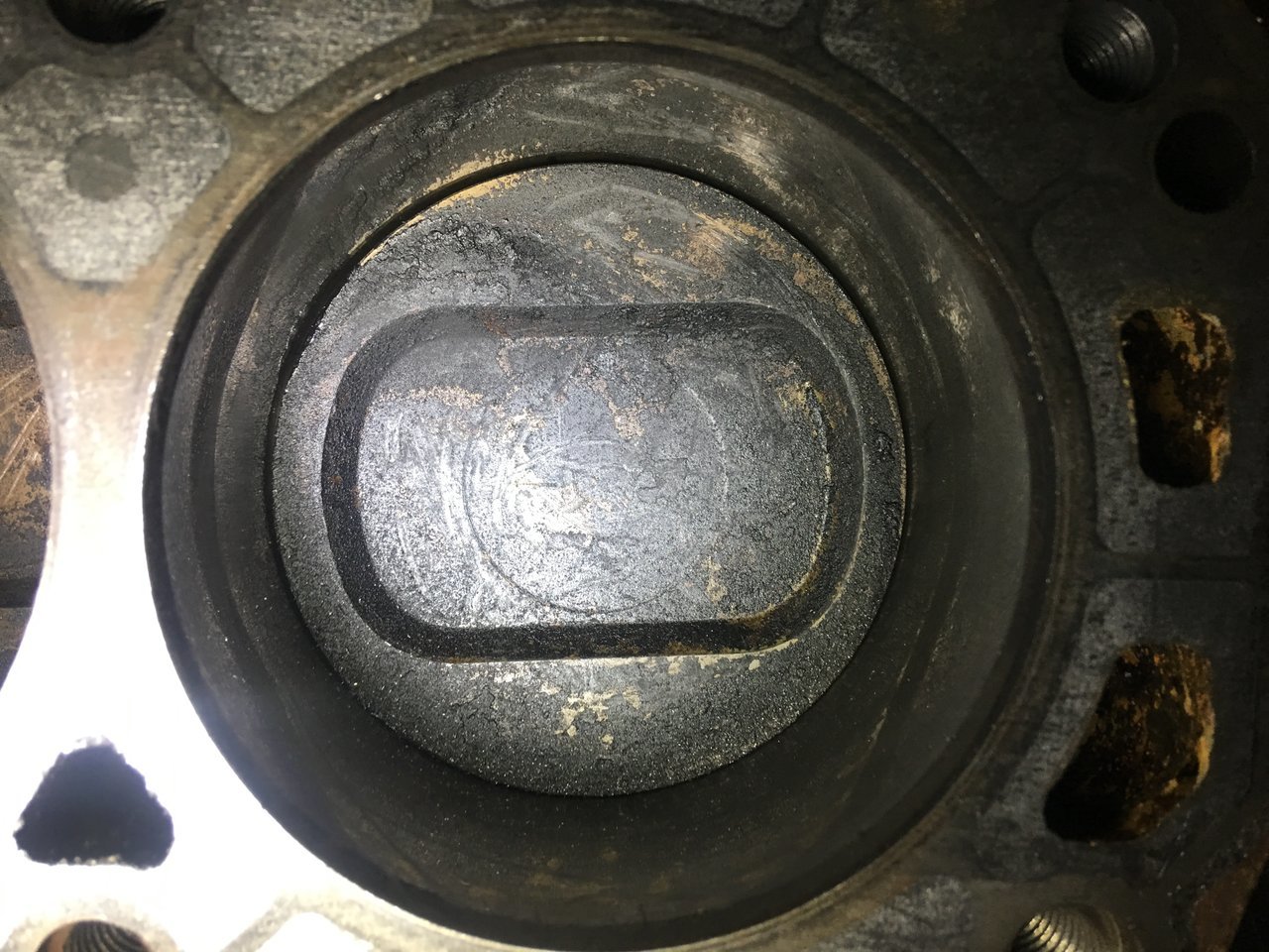

    This is cylinder #8 of my lightning motor and is pretty representative if all the piston tops. I am gonna clean them up as much as I can and reseal the engine with some valve seals and gaskets. I’m not gonna tear it down completely. Just gaskets and hope for the best. I have been driving the 302 pretty hard. I can only imagine what a good engine would be like. My 302 pulls hard and I can dump the clutch with the rpms elevated and spin both rear tires, but it smokes because it needs valve seals and could probably use a timing adjustment. The extra displacement of a 351 should help. I installed a standard mustang HO camshaft. The heads have 1.72:1 ratio roller rockers which I am hoping allow more air in and out without changing valve event timing so I can maintain a smooth low idle.

    I used a golf club cleaning brush and som dish detergent to clean the piston tops.

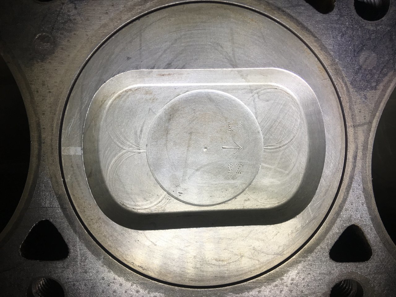

    Are those OEMs with that dish?

    Yes. They are the stock cast piston in every late model 351 windsor. If I were rebuilding this one, I would bump up compression with some flat-tops with valve reliefs.
