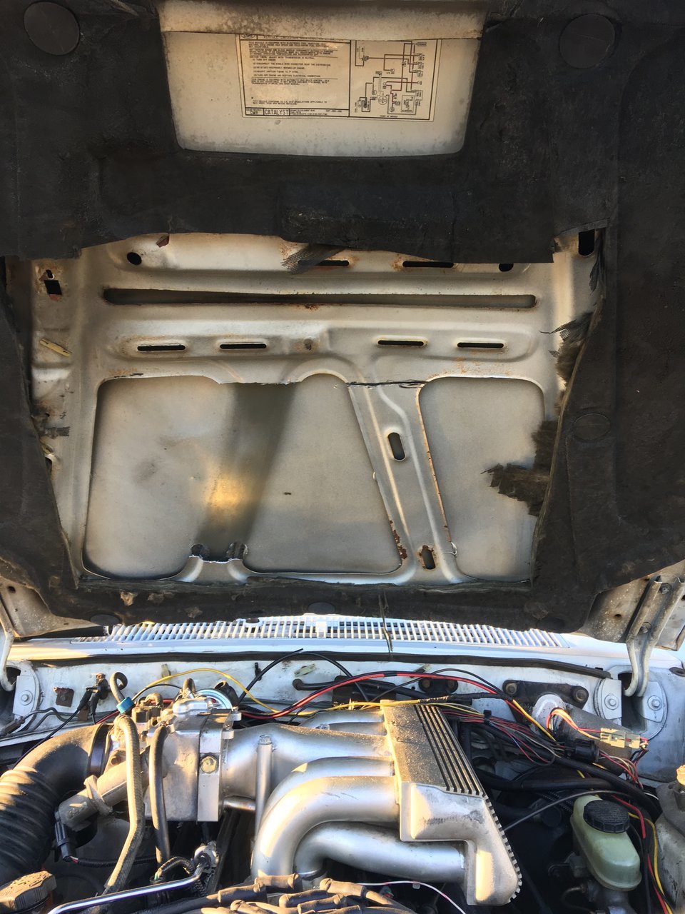

    I cut them out. Now I have to hammer so I can close the hood.

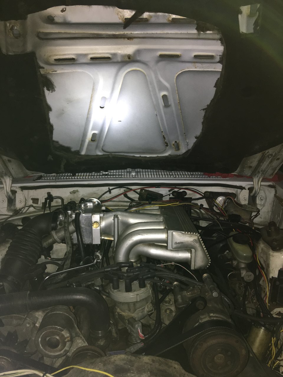

    I actually cranked the engine. It would not start. I sprayed starting fluid and still no. I’m gonna have to check for spark. I will re-stab the distributor tomorrow and check for spark.

    Haha! It started! I was drinking Johnny Black while I put it together after work but it started! Hahahaha! Lol! I may be a wee bit inebriated but oh well! I am pretty pleased with myself! Just a couple of odds and ends and I should have this thing back on the road soon... hopefully. If all goes extremely well I will deliver on a Daddywagon burnout video. Fingers crossed. I am honestly thrilled because I wasn’t sure about the Lightning motor. I have no motor health gauges yet so I still have work to do. Oil pressure and coolant temp are tops on my list.

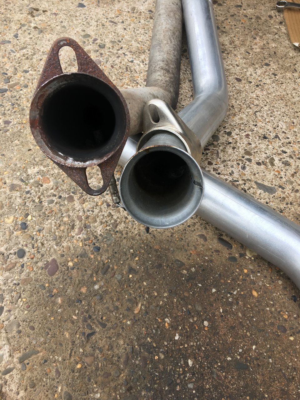

    I am so close. The water pump from the local auto parts store is leaking. The exhaust is leaking between the passenger side header and the h-pipe. I can hear the valve-train when the car is just idling.

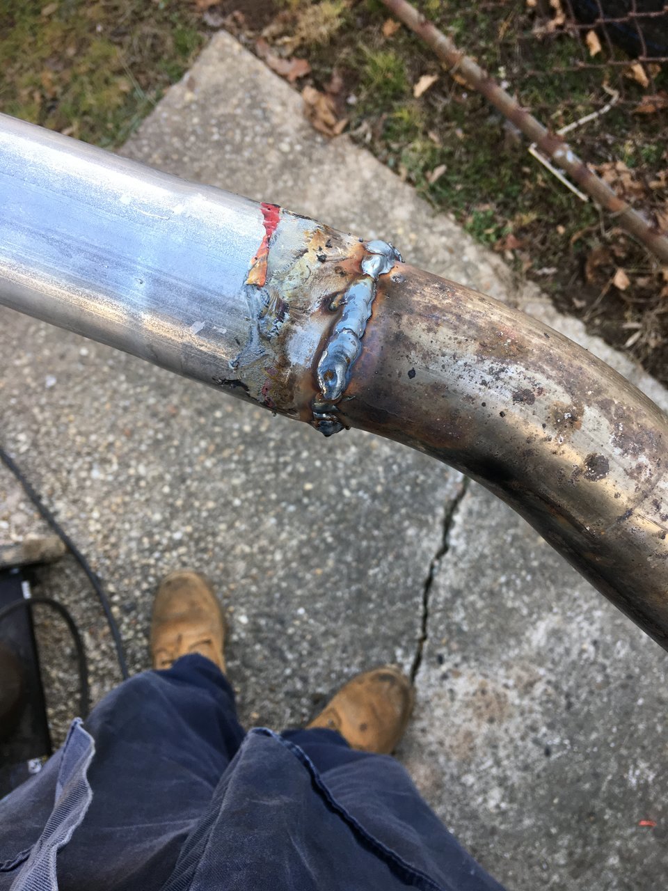

    Last weekend I tried to re-seal the water pump... it leaked right away. On saturday I tried to seal up the exhaust leak by cranking down on the bolts while having the driver's side loose hoping the passenger side would seal up... no change at all and the plate on the h-pipe that pulls it is all bent up. So... I ordered both from Summit. Waiting game again. I am really anxious to drive the Daddywagon again. I was having such a blast with the smoky worn out 302. I was having fun but the trail of smoke was bad, and with the cobra exhaust tips pointed straight back it just collected the oil cloud behind the rear bumper and coated the back hatch in oil. I cut off the old tips and welded on turn-downs.

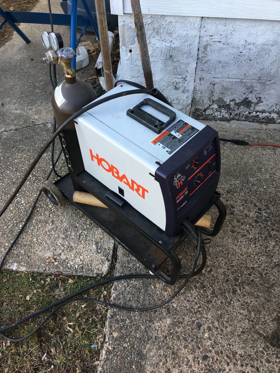

    still trying to master welding... I have a tig machine as well

    Well, I had an exhaust leak and a coolant leak at the new water pump. I bought a new water pump... it leaked right away. It turns out I have a revised timing cover for reverse rotation water pumps. The gasket that was supplied did not match the timing cover. Three times I did this water pump over and watched it leak as I filled with coolant. I figured it out eventually and goop gasketed it. The exhaust leak was solved with a new off road h-pipe.
