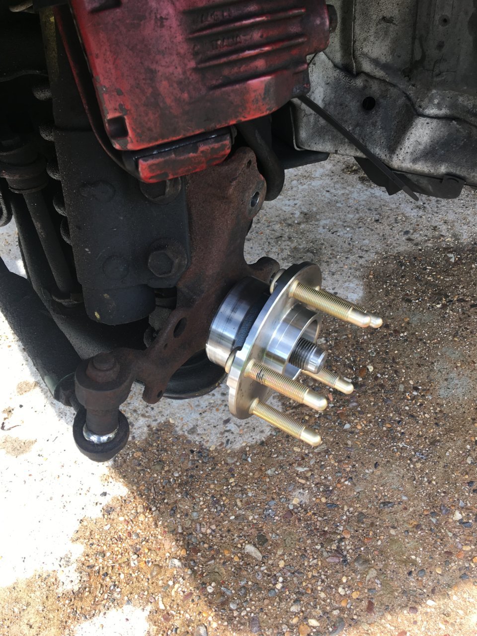

    I like the crown vic steelies too much to give up on them just yet. I originally went with 25mm to clear the cobra brakes and to make sure that when I get the cobra “r” brembo calipers I would definitely have enough room... well I probably over-did it. 25mm equates to about a 1” spacer which has studs pressed into it and bolts to the hub’s studs. I have decided to go down to a 1/2” spacer and use longer studs on the hub. Fingers crossed.

    Thanks! Haha! Parts ordered!
  5. Oct 14, 2018 at 2:56 AM
    #485
    nelztaco
    nelztaco [OP] Well-Known Member
    Sep 22, 2009
    #23137
    1,175
    Neil
    Levittown, PA
    09 TRD Sport DCLB 4x4 SW
    UNDERCOVER, EIBACH COILS, TSB 4 LEAFS, TRD WHEELS, 255/85R16 KM2
    Parts arrived. I had to bring the hubs to work to enlarge and drill out the holes to 39/64. Once that was done I pressed in the new longer ARP wheel studs. the job is done and the Daddywagon is back on the road. My coworker sent me a link to Jalopnik Radwood Philadelphia, which is today and I am thinking about attending. It’s basically a show for 80’s and 90’s cars. We’ll see.

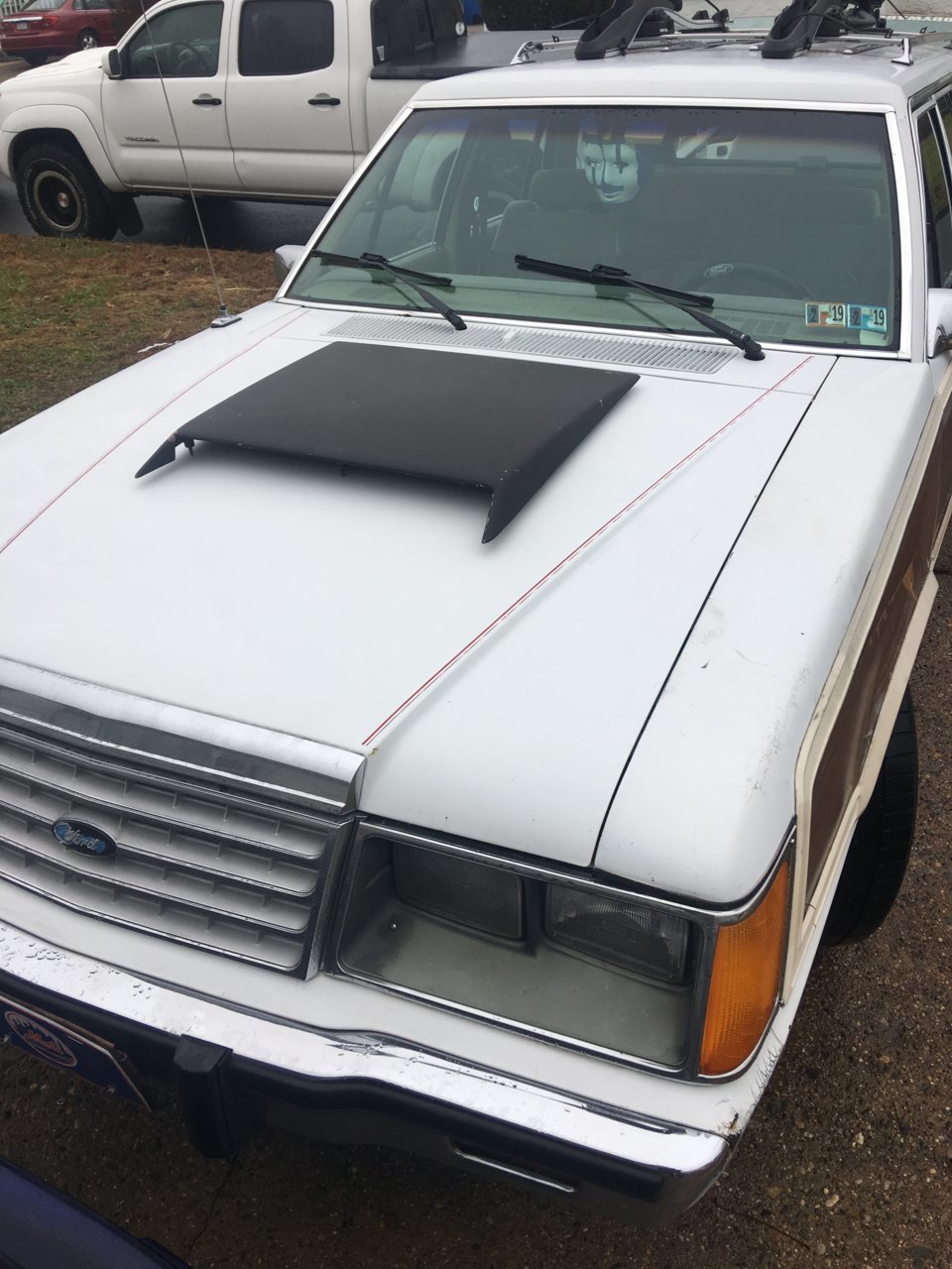

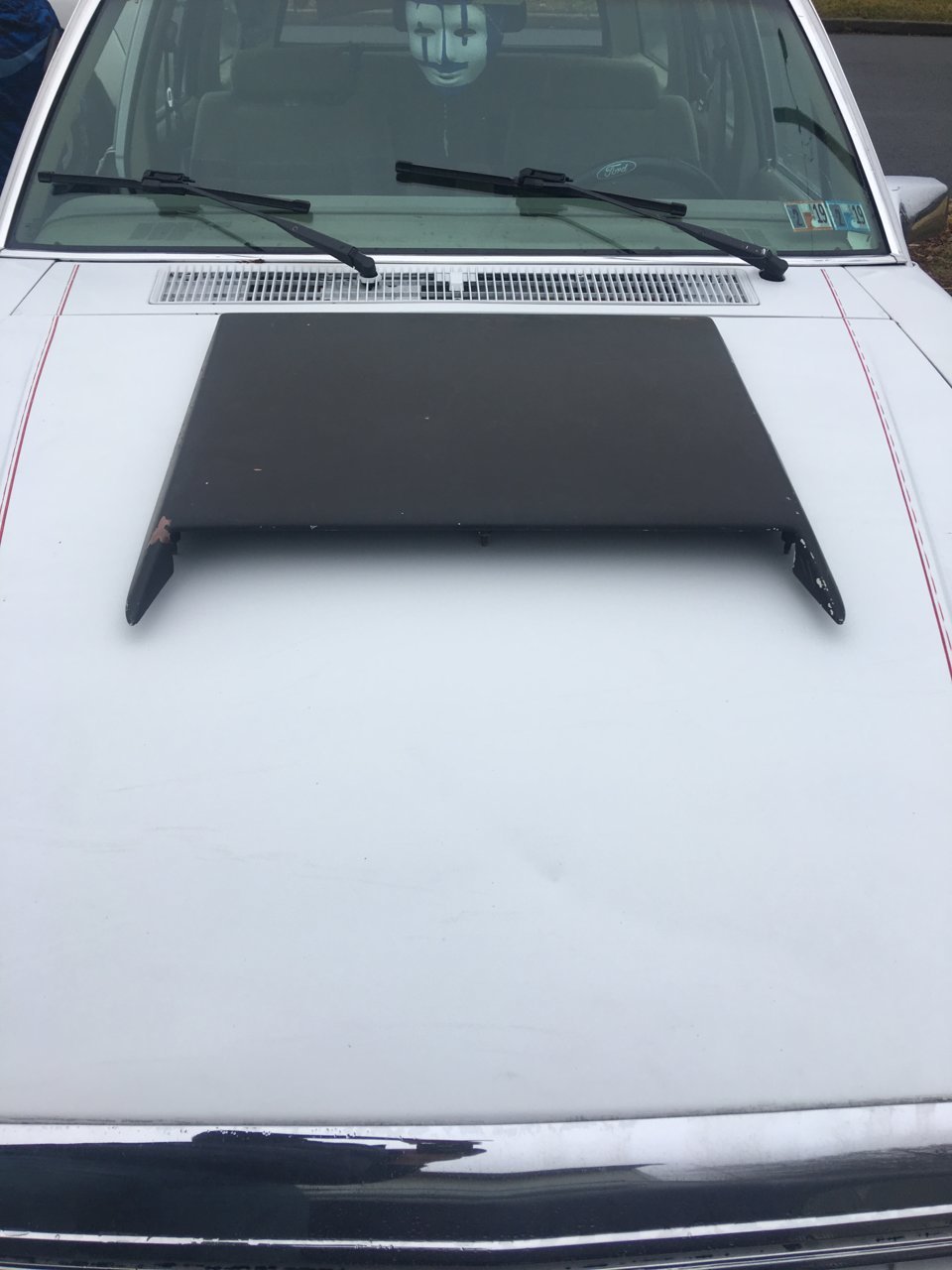

    The engine doesn’t fit and rubs against the hood. Craigslist to the rescue!!

    Neil
    Levittown, PA
    So much for sleeper status.
  20. Dec 15, 2018 at 5:19 PM
    #500
    nelztaco
    Sep 22, 2009
    #23137
    1,175
    Neil
    Levittown, PA
    It isn’t mounted yet in the above pictures. I still have to cut the hole in the hood. I also have to get flange nuts to mount and drill holes for the mounting studs.
