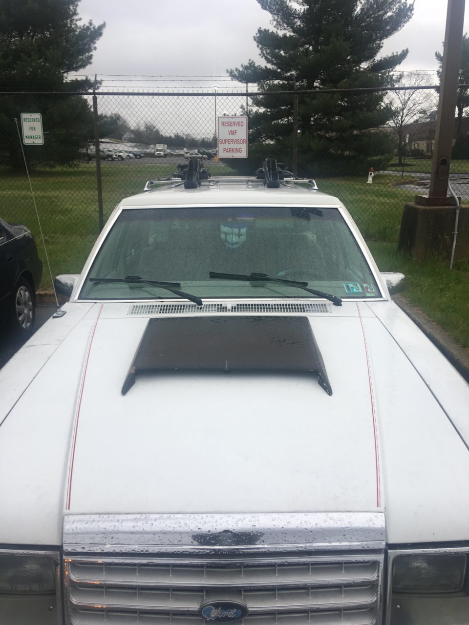

    The Daddywagon finally made it to the new job. I drove it there and back 3 days this week. The commute is 32 miles each way. So that’s 64 miles per day. I got 15 miles per gallon according to my calculations. That is about the same as my Tacoma.

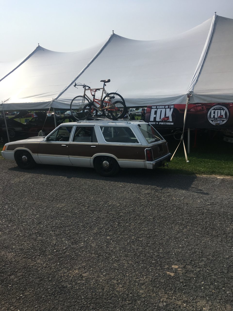

    I still feel this way. I am gonna try and drive it 140 miles each way to the All Ford Nationals in Carlisle, Pa. tomorrow. When I get there I’m gonna register for the showfield and walk around! Wish me luck!

    We made it! And we made it back home.

    The ride was all turnpike. I’ll just say we made good time...
    The Daddywagon drew a lot of positive feedabck.

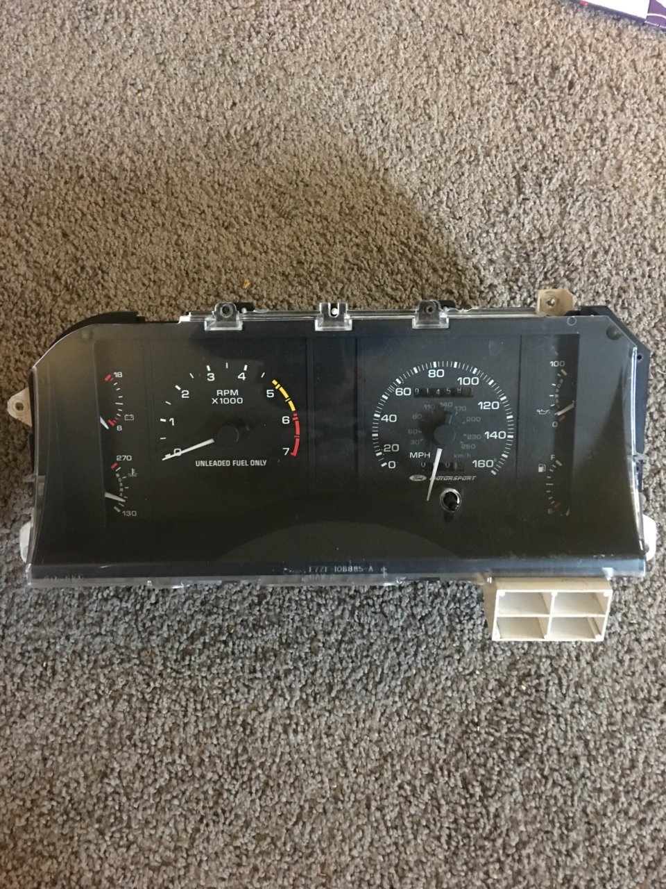

    Thanks! I am constantly thinking of things I want for the car and addressing wear and tear. The mustang dash and console are next. While I was at the Ford Nationals I bought a 160 mph dash cluster. I’m hoping it is completely functional.

    Not liking where the speedo needle is sitting at rest. This was necessary because the dash and console are out of a 4 cylinder with an 85 mph cluster.

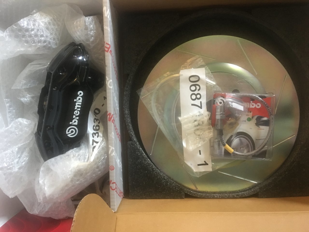

    Just checked and it’s a no go. The calipers are much bigger because of the two additional outboard pistons. Currently there is between .5 and .75 inches of clearance between the caliper and wheel depending upon where it’s measured, but even that does not cover the width of the brembos. I am running longer wheel studs with 1/2 inch hub centric spacers. I am hopeful that 3/4 inch spacers will do the trick. I don’t like the 1 inch spacers with the studs built into them. I don’t like them because I had the Eibach versions of them and studs were failing on both sides of the car.

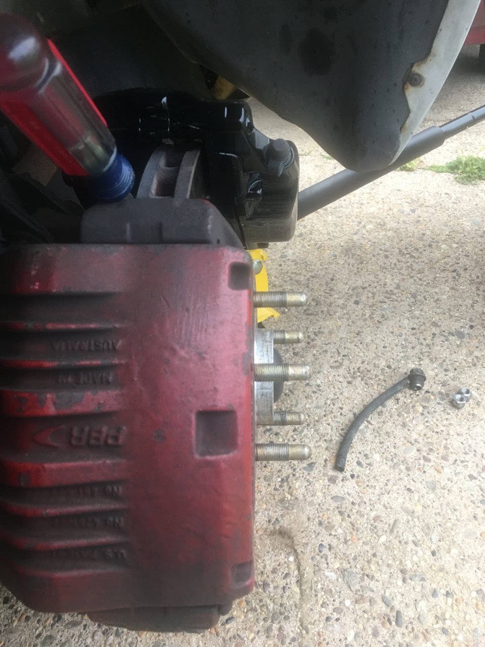

    The cobra brake caliper is in the foreground. In the background I put the brembo caliper over the rotor and you can see how much further the caliper sticks out.
