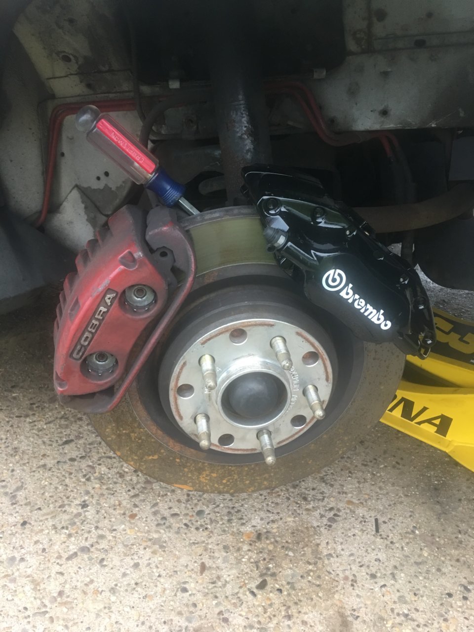

    Once I solve the Brembo fitment issues I can transfer the cobra brakes to the Mommy-mobile!

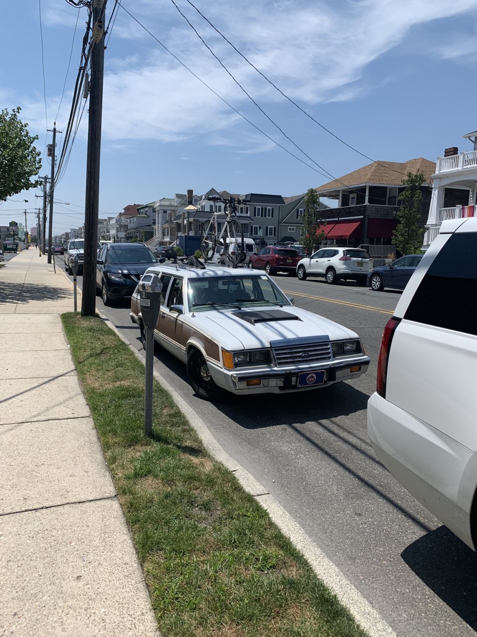

    Shore vacation mission accomplished! It was hot! On the way to the shore it was hot! On the way back it was even hotter! The Daddywagon has prevailed... so far! I figure ambient temps in the 90’s mean little to the internal combustion engine provided the cooling system is intact and functioning properly. I beat the piss out of the Daddywagon! I took on everybody who wanted some! This is a highway cruising machine! Light to light you’ve probably got me beat! But the wagon is top end pulling like nobody’s business! So much fun! I have to step up my video game. That YI 4k cam is just not doing it! I think mainstream go-pro is in my future.

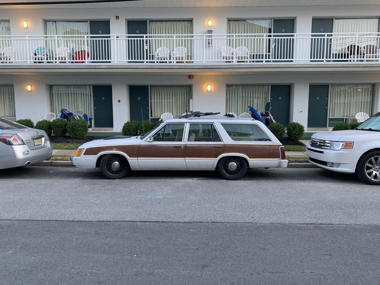

    I know. But not only does it reach those speeds...
    It needs a cosmetic restoration. I may try to do the work myself.

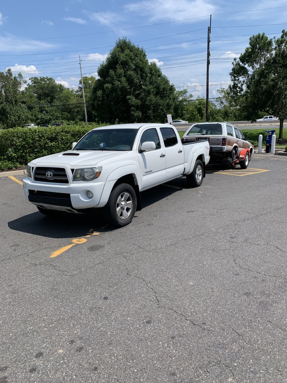

    The Daddywagon left me stranded on the way to work! Not sure exactly what the problem is. Leaning towards fuel pump. I got it on the tow dolly and then it started. Frustrating. Old 80’s fuel injection. Return system with an in-tank pump. Initial key-on and the pump primes for a couple of seconds. Once running the pump will stay on! Well I cycled the key a couple times and tried to squirt fuel from the schrader valve on the fuel line, and got nothing. So I am assuming fuel pump.

    Well... it started right up once I had it strapped onto that tow dolly. I actually drove it off the dolly and into my driveway. Maybe the pump is just starting to fail or I have something else going on. It was a bear putting the car on the dolly all by myself. I basically had to set the car up on jack stands and back the dolly under it with my truck.

    NO GO! The 3/4 spacer did not do the trick! Looks like the steelies are going bye bye! I tried. I have offset stagger cobra r’s that need paint or powder so I am gonna bolt those on and see what happens!

    Ok! I tried ! I am gonna have to go with the cobra “R” 17x9’s! I have different offsets front to back to accommodate brembo calipers! 17 x 9 all the way around!

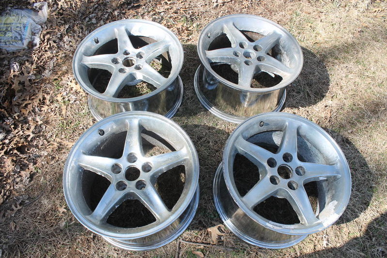

    These are the rims. The chrome is peeling badly. So I have to strip them down to bare metal and then paint or powder. Also with the wider wheels I am gonna have to roll the wheel well openings.
