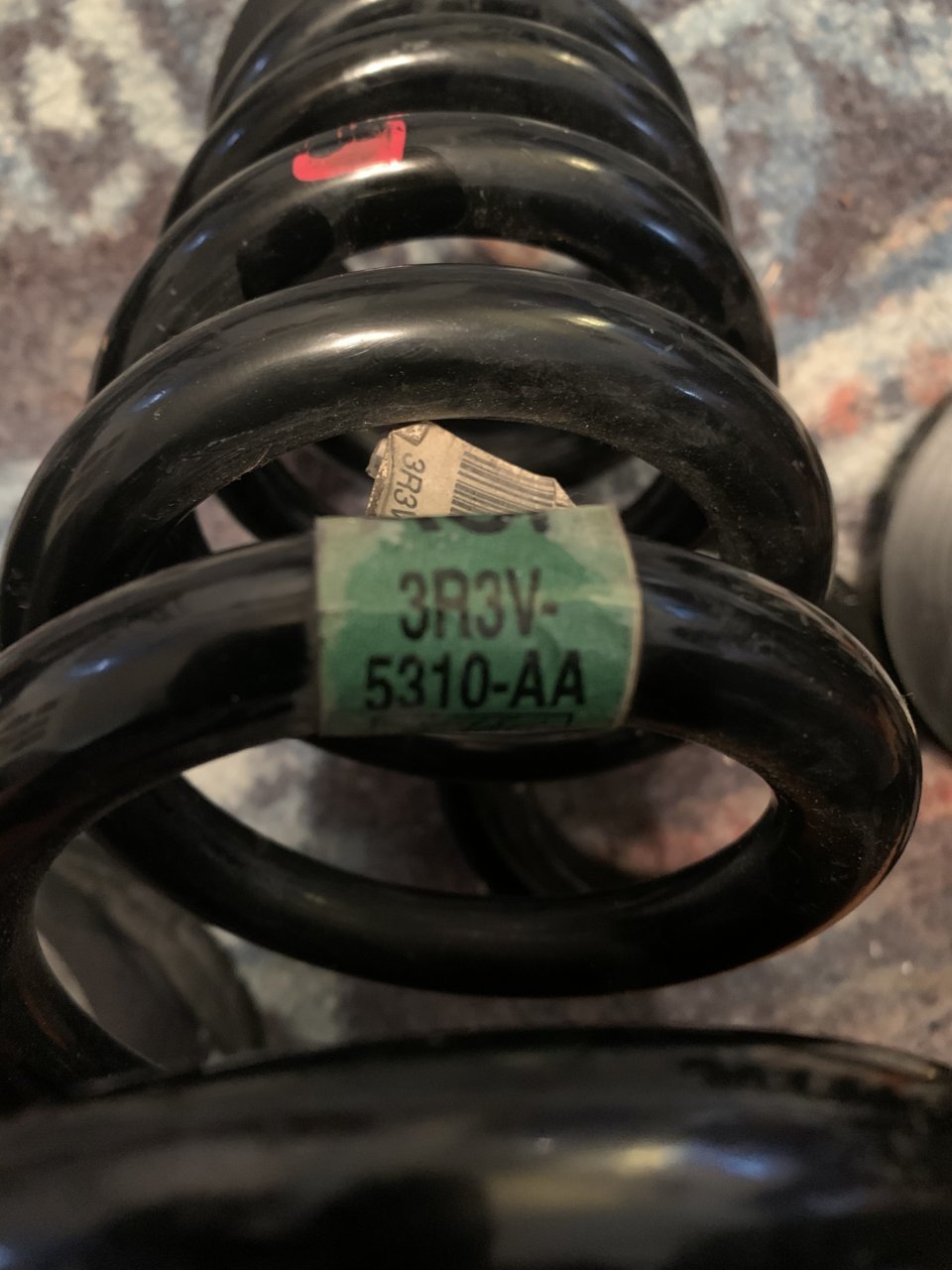

    UNDERCOVER, EIBACH COILS, TSB 4 LEAFS, TRD WHEELS, 255/85R16 KM2
    Here is one of the front cobra springs and the corresponding part number.

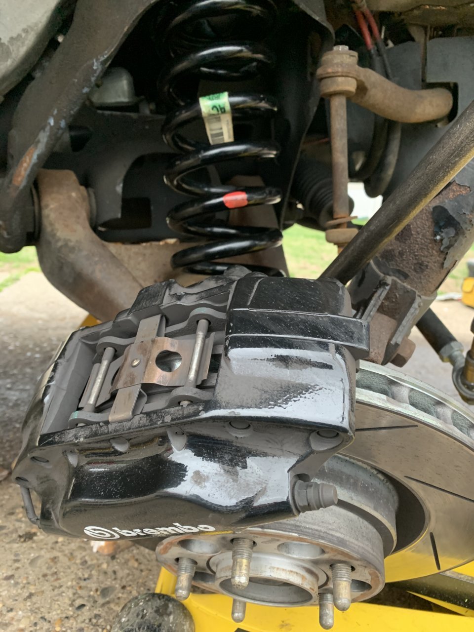

  2. Mar 30, 2020 at 2:12 PM
    #642
    nelztaco
    nelztaco [OP] Well-Known Member
    Sep 22, 2009
    #23137
    1,175
    Neil
    Levittown, PA
    09 TRD Sport DCLB 4x4 SW
    Lower polyurethane spring isolator installed.

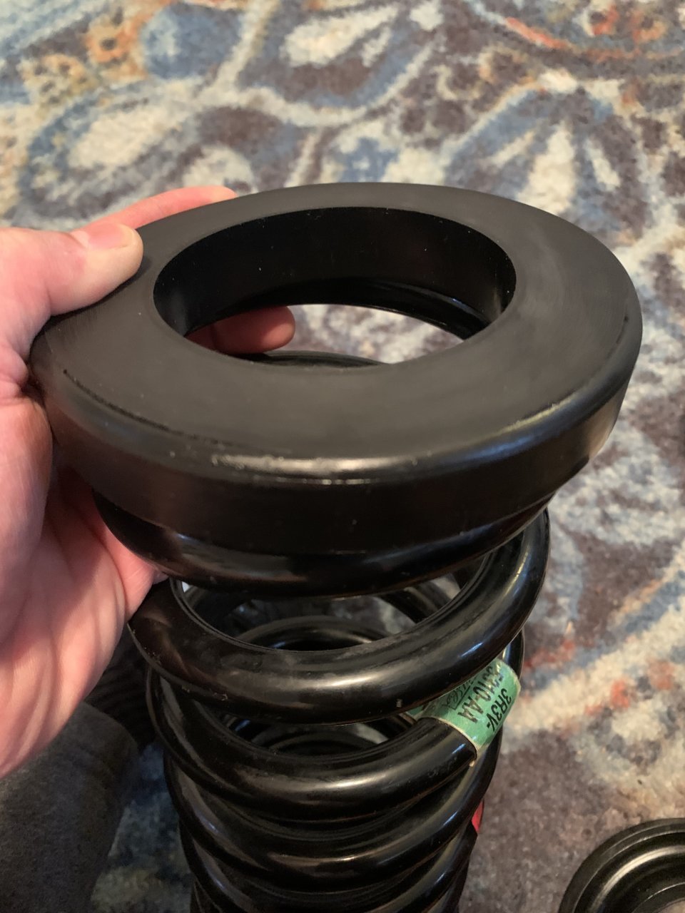

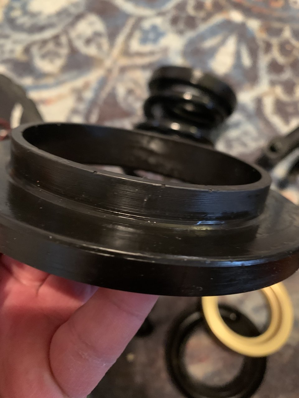

    Her is the upper spring isolator for the rear cobra spring.

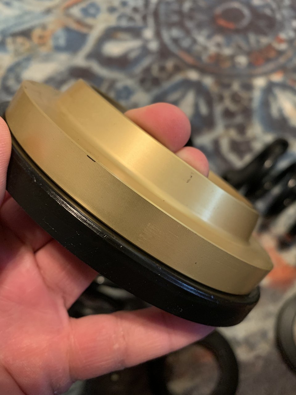

    The same isolator combined with the 1/2 inch spacer.

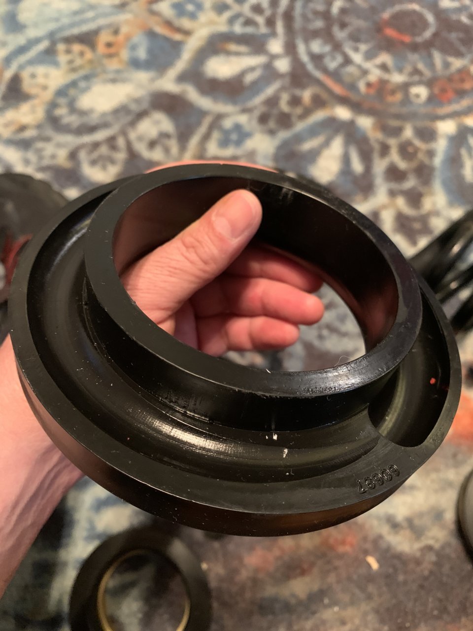

    And finally the lower spring isolator for the rear cobra spring.

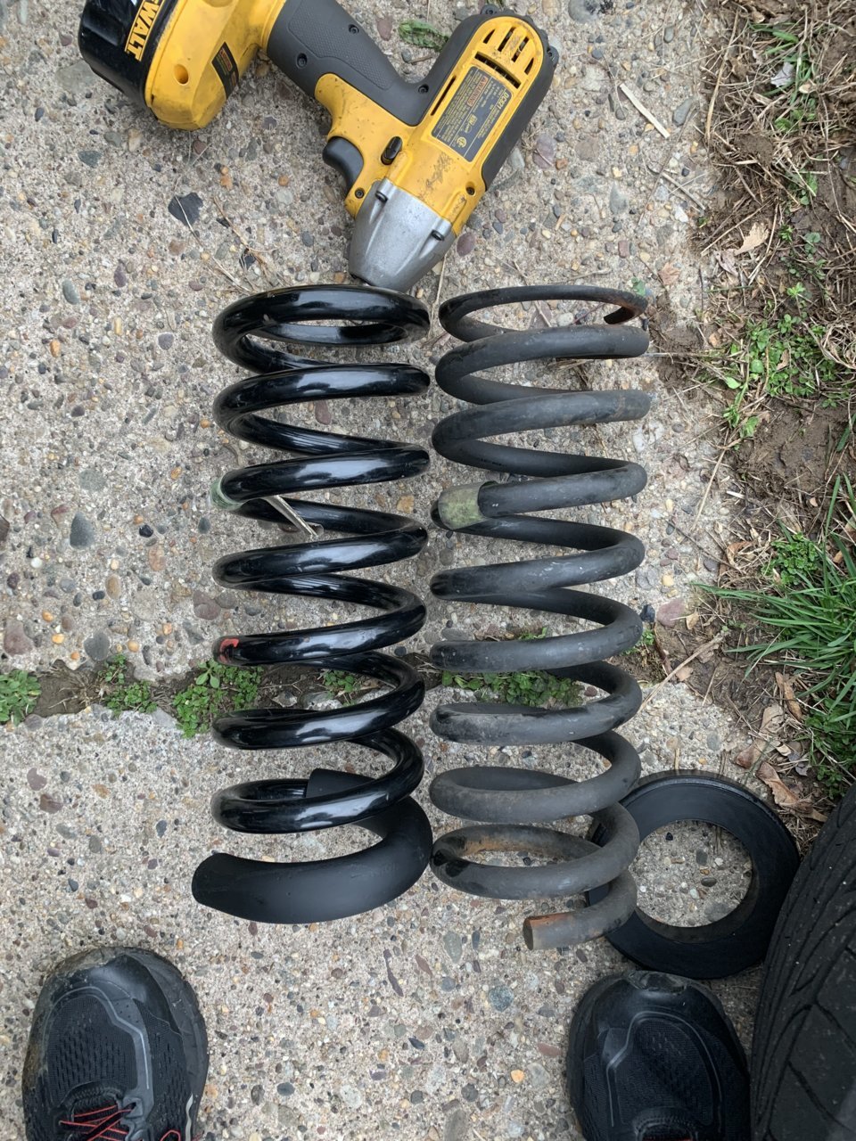

    Ok! I think the front end is definitely gonna ride higher. The wire gauge of the cobra springs is thicker. The uninstalled length of the springs is identical. The springs that I am taking out are Ford “B” springs. “B” springs are supposed to be progressive lowering springs. The cobra springs are linear 600 lb/in. The real question is how will they ride. I’m looking for softer but that spring rate is pretty high. I was unable to complete installation because it’s a pain in the ass. I have to compress the spring to install without killing myself.

    The old and new spring side by side.

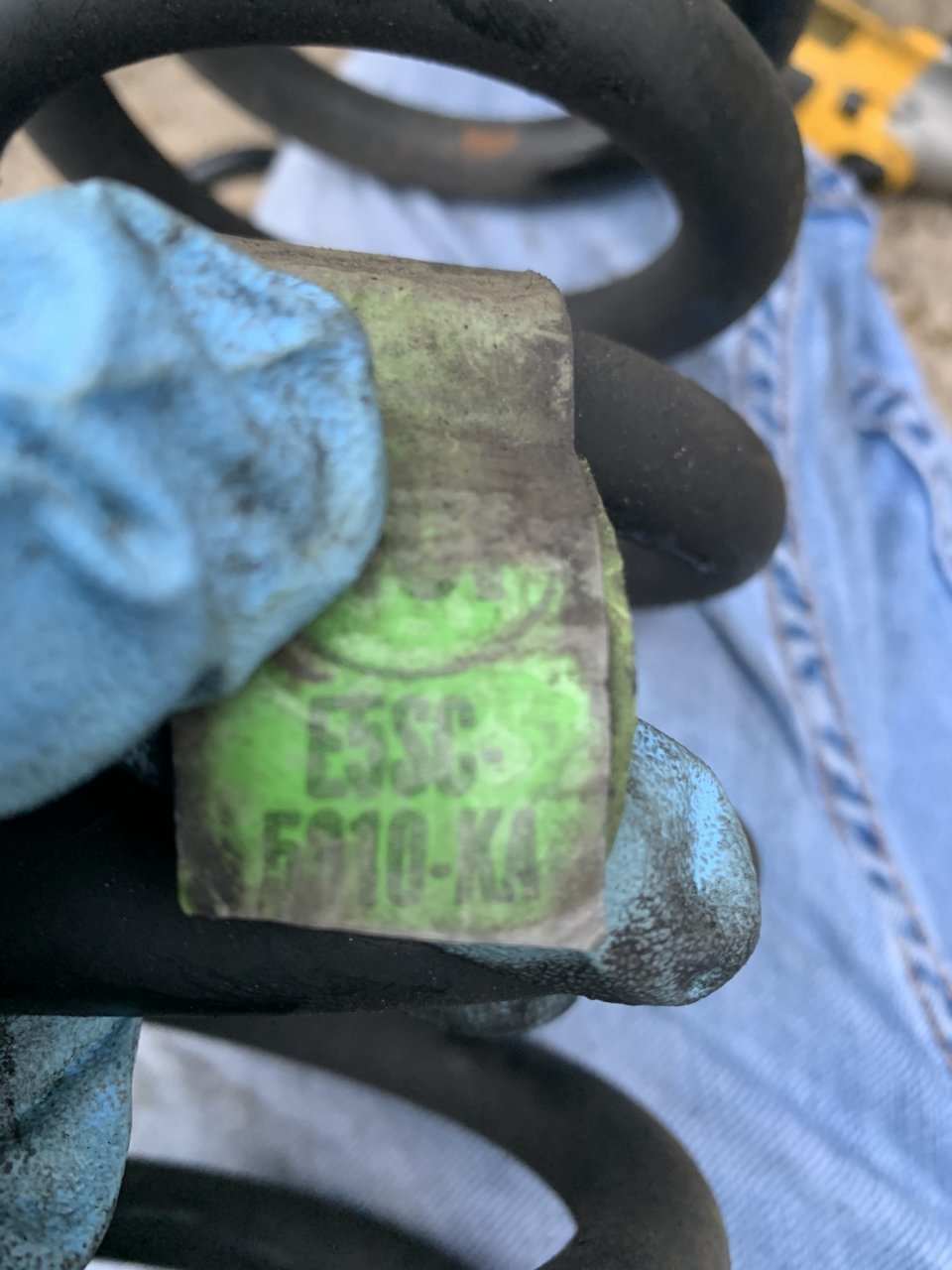

    Part # for the spring I took out confirming Ford “B” lowering spring.

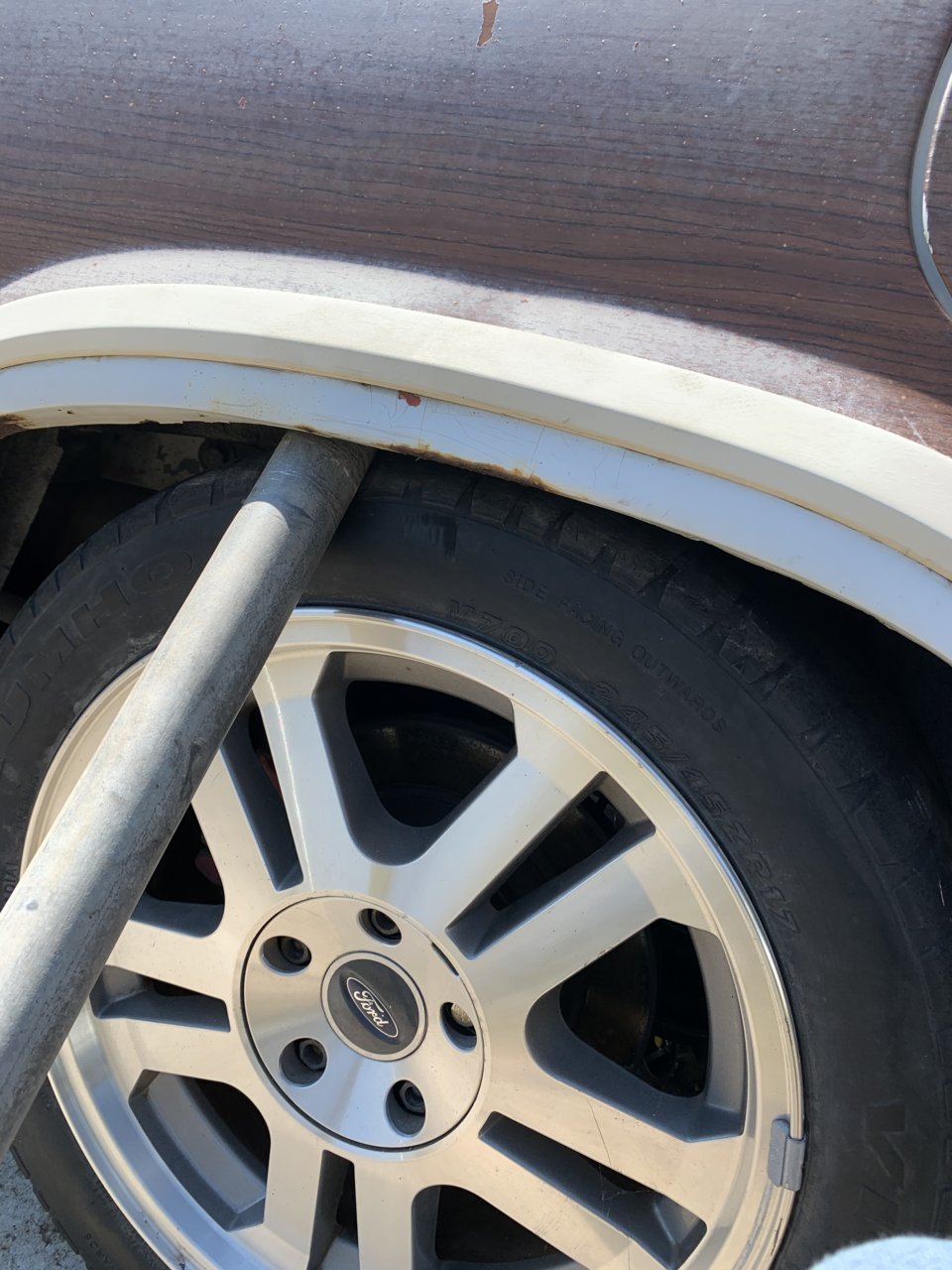

    This took some ghetto-fabulous fender rolling.
