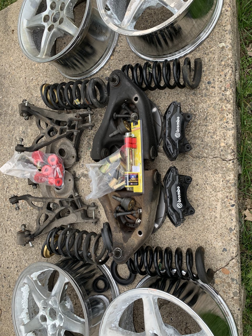

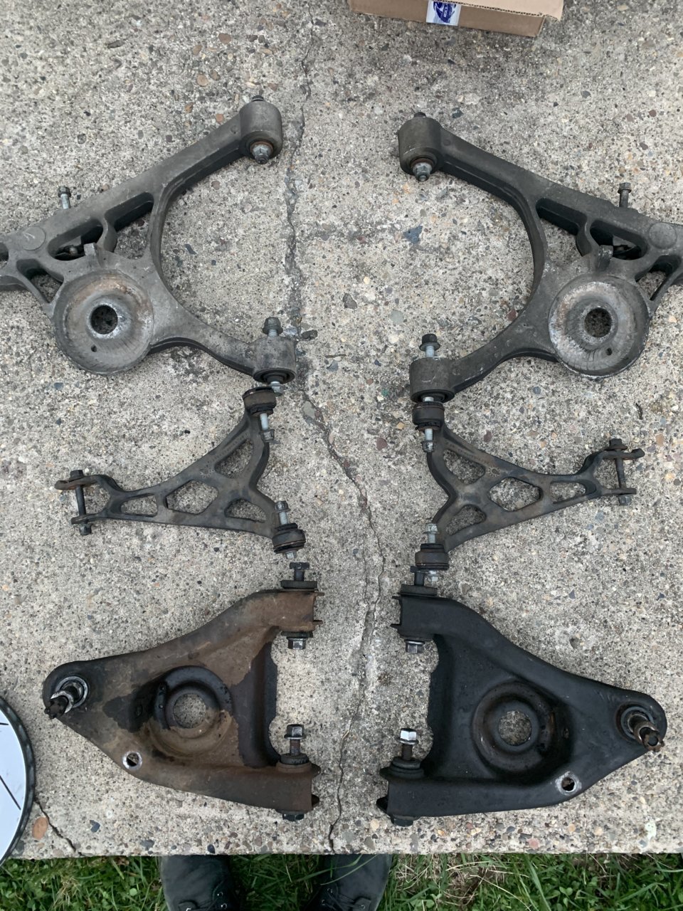

    It turns out the only bushings that look questionable are the rear upper control arm bushings. I was expecting something up front, but the ball joints are still solid and the control arm bushings up front look great. I already bought the bushings and I took apart the car so I'm gonna replace them but I am left wondering what is rattling up front in the passenger side going over small bumps.

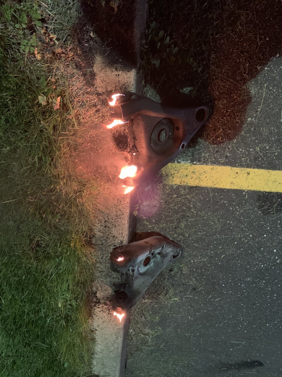

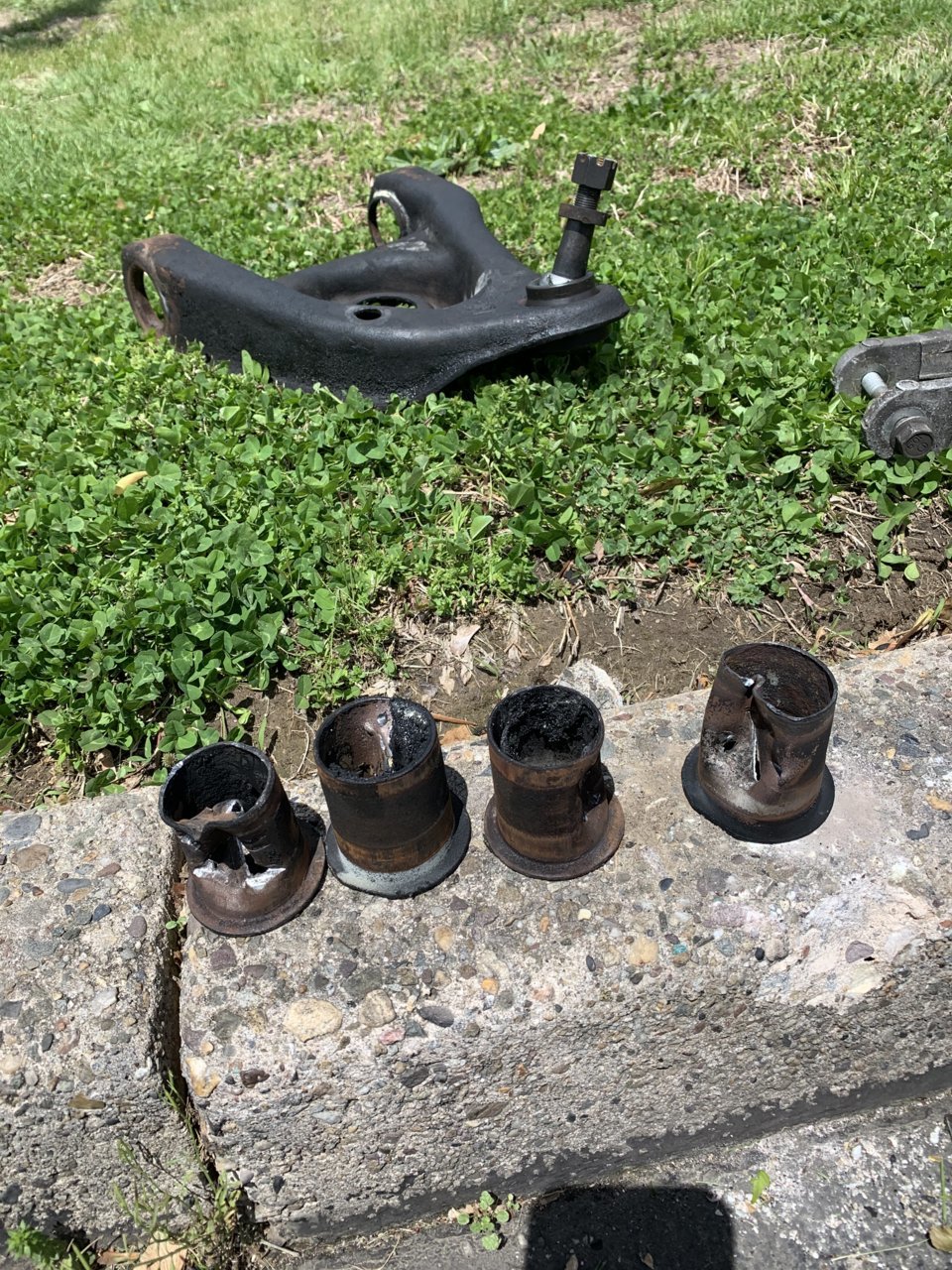

    I set the front control arm bushings on fire. The next step will be to smash the sleeves until they come out. After that I have to press in the new sleeves and install bushings. Then I will tackle the rear control arms.

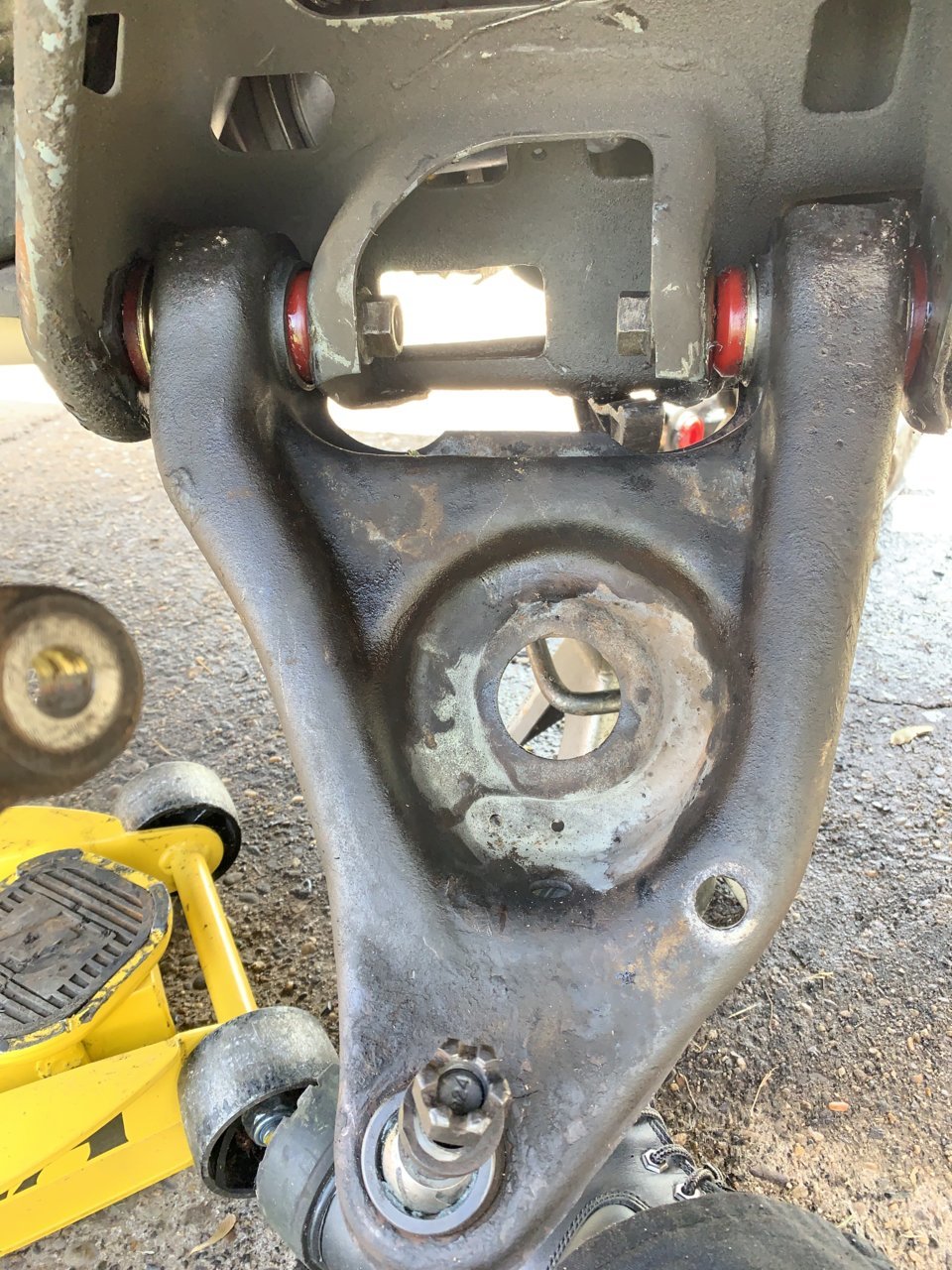

    Front bushings are installed.

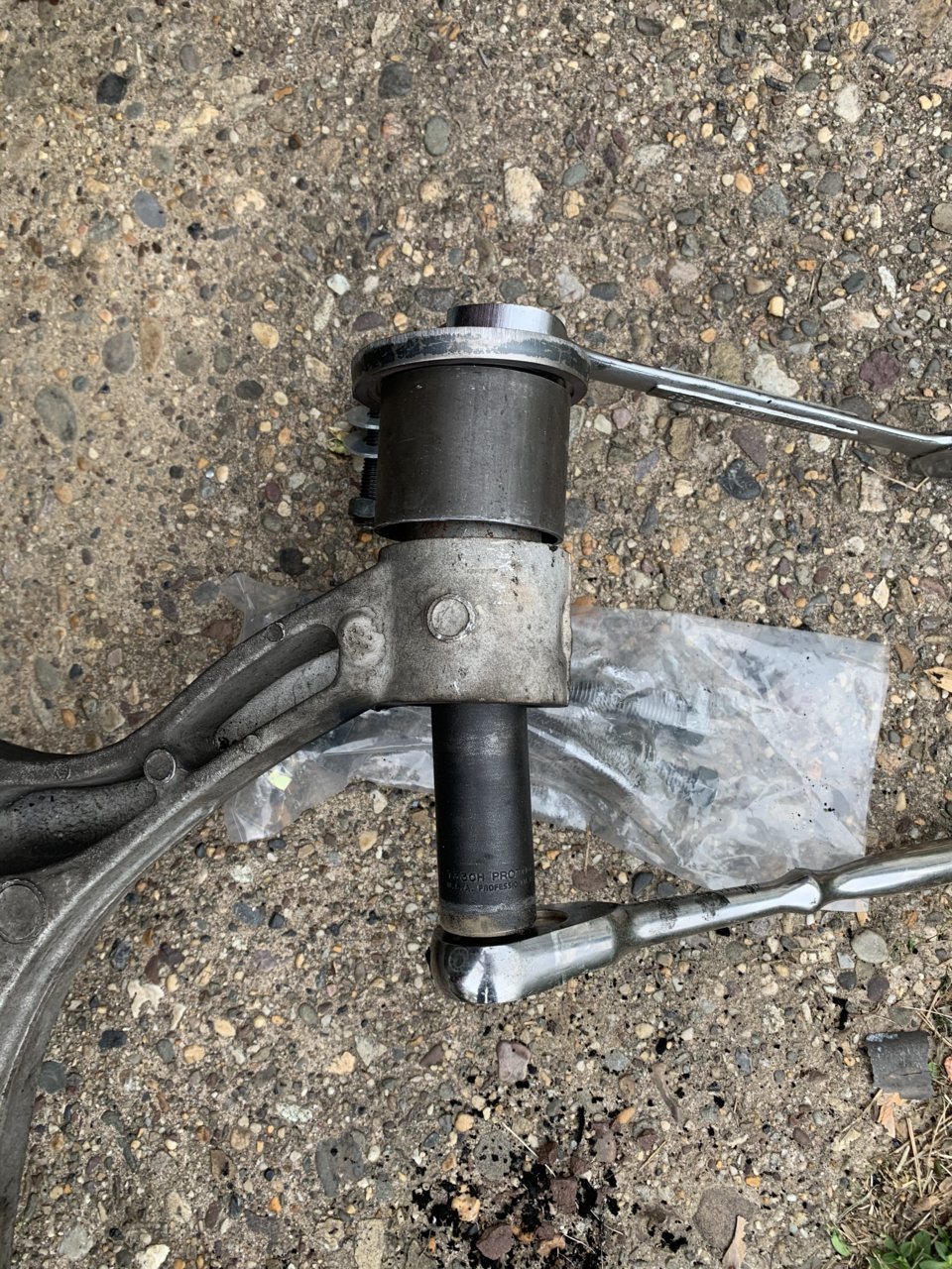

    I still have the rear control arms to do. The upper control arms are gonna be easy. Easy because the sleeves don’t have to be pressed out. The lower control arms however need the sleeves pressed out. That is gonna require tools. I have to purchase the tools. Aaargh!

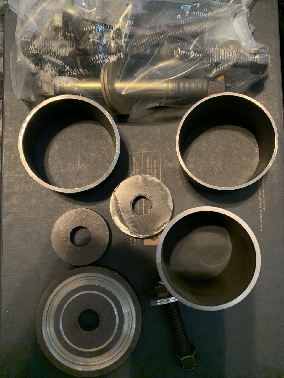

    Yeah. I am sure there is a generic bushing tool, but I didn’t want to take the chance that I wouldn’t have the exact diameter I need. I ordered the tool from Full Tilt Boogie Racing. They produce and sell many upgrades for the Cobra IRS so I figure the tool they sell will get the job done.

    The tools to remove the bushings came in the mail today. The tools are absolutely necessary for removal especially considering the control arm is made out of aluminum which takes away my alternative barbaric methods of removal.

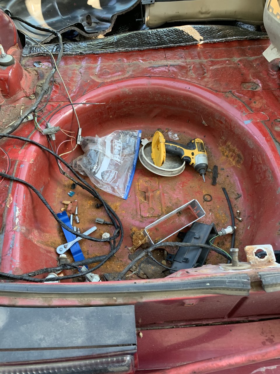

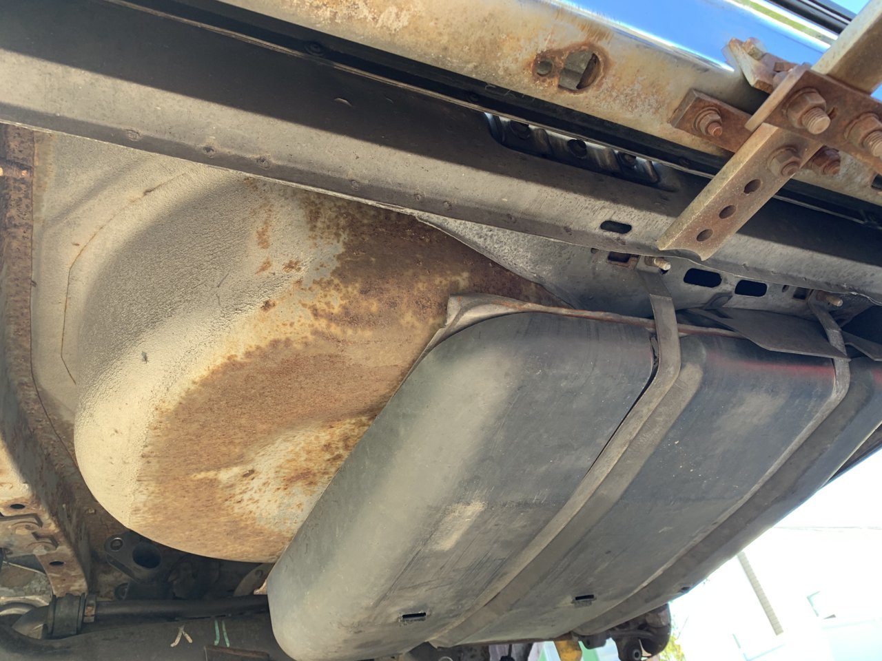

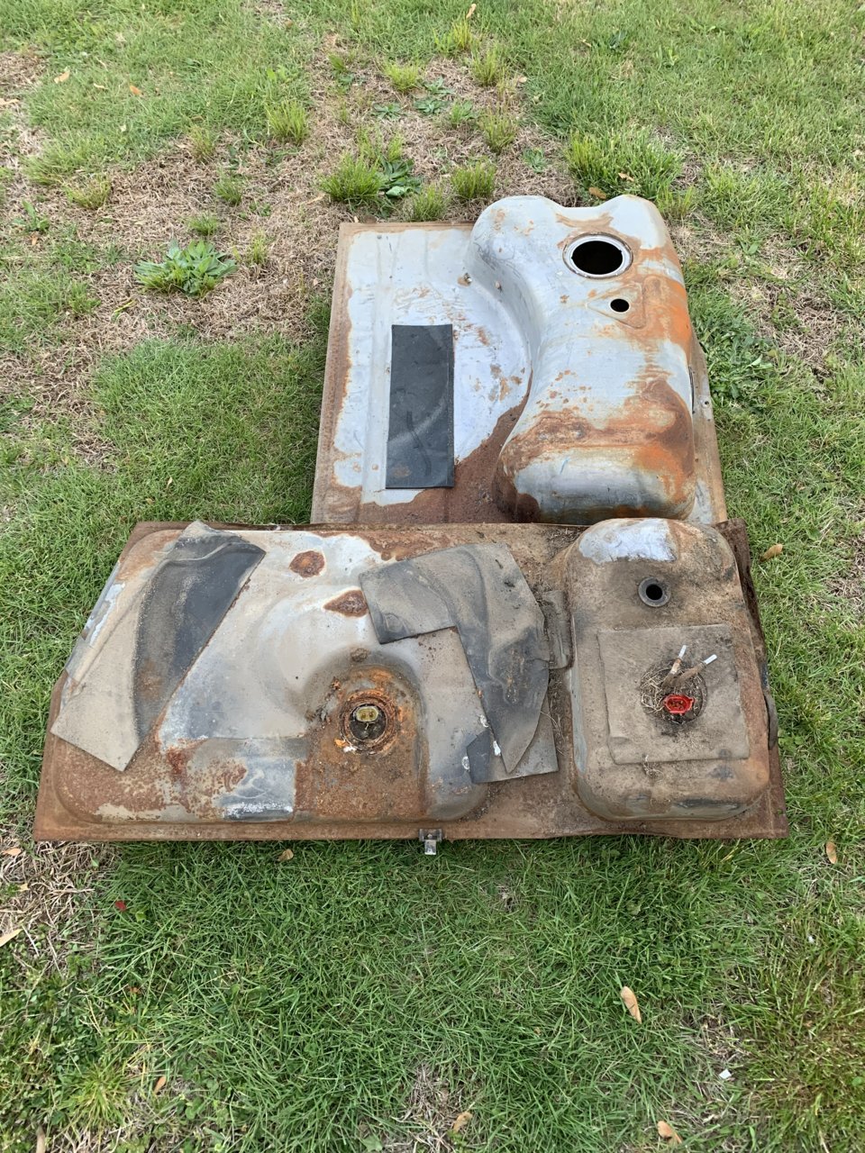

    As I prepare to rewire the Daddywagon with 1989 mustang wiring it occurs to me I have the opportunity to fix the inoperative fuel gauge/sending unit. Since I am switching to the mustang gauges/cluster, why not switch to the mustang fuel tank/sending unit?
