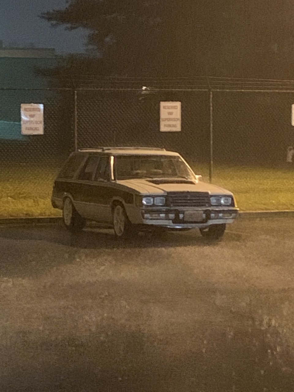

    Its one of those used car badges

    I had to go back to look at my picture of the car... yup! It's a match.

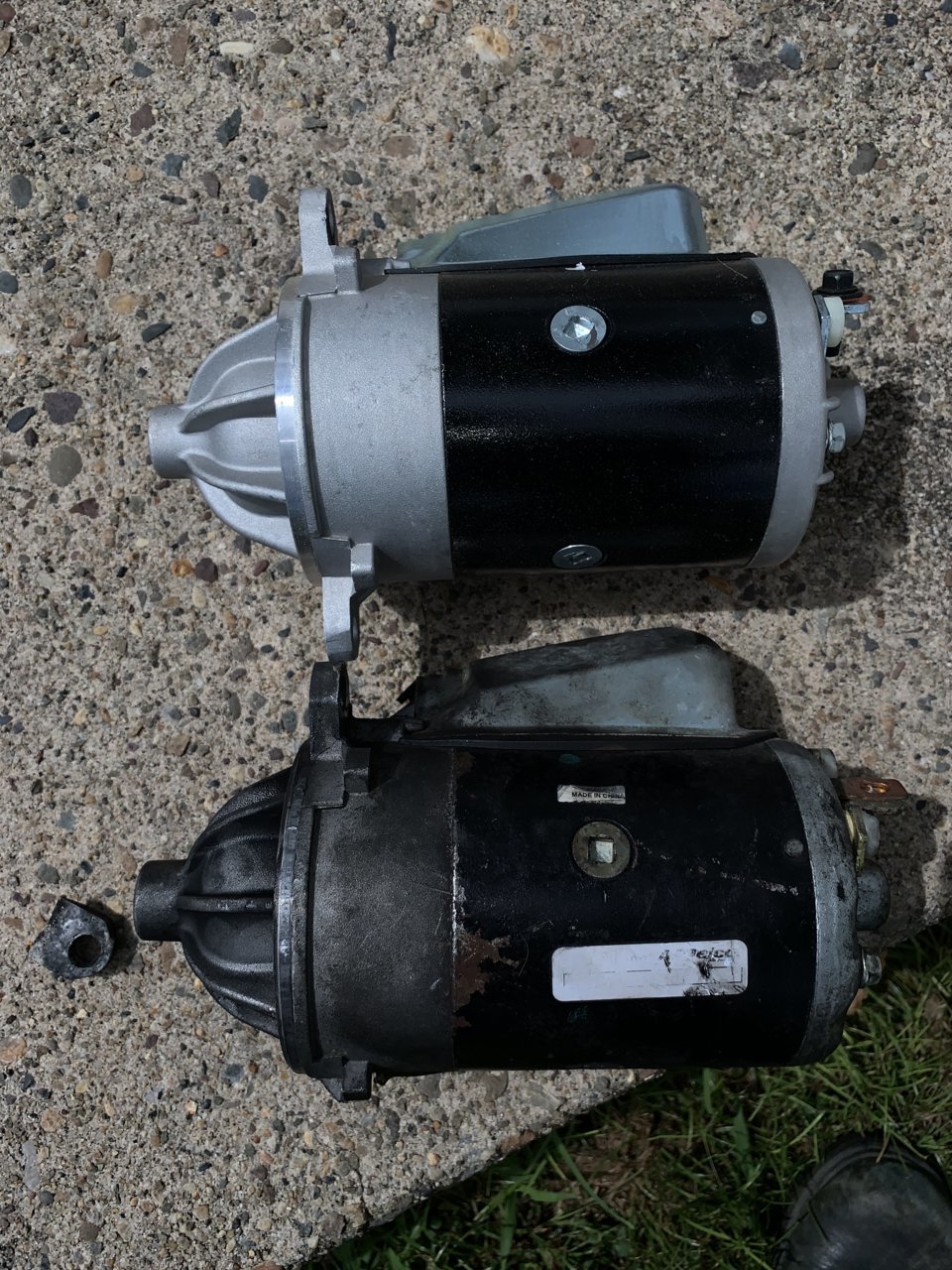

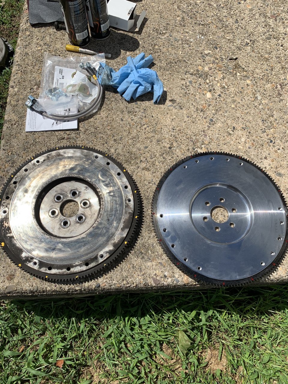

    I ended up doing the starter and flywheel in the street because I couldn't push the car into the driveway.
    Here you can see the broken ear on the old starter. Hopefully the new starter will fair better.
    I counted the teeth on the flywheels to make sure they matched up. The old flywheel may look good on this side but on the other side of the flywheel you would see that the teeth are all chewed up.

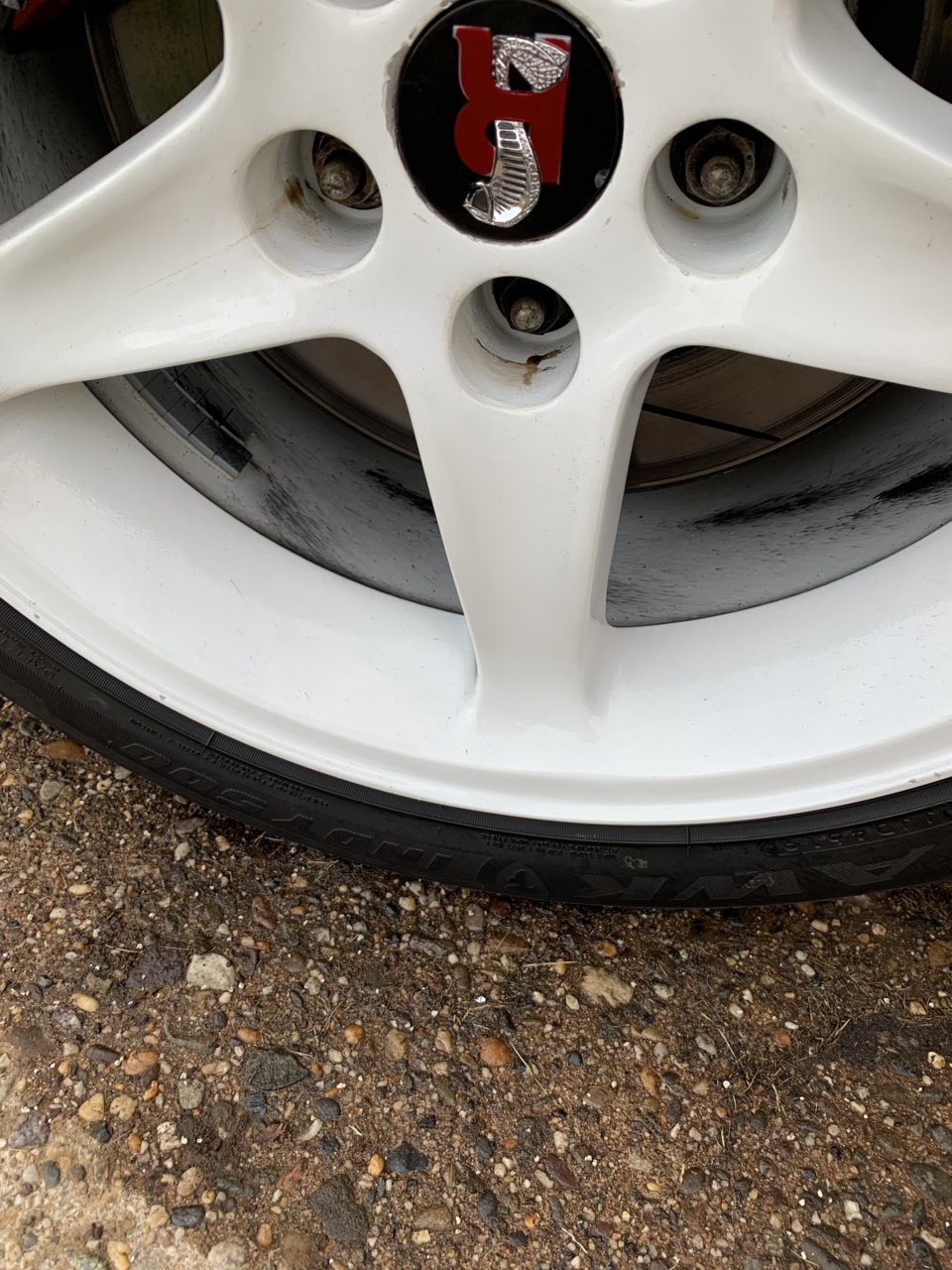

    The calipers still look like crap but I put them on anyway. I've been busy trying to grow a new lawn in my backyard but I finally got back to the wagon today. The Galfer brand pads that came with the Brembo calipers are brake dusting really bad. The picture is after maybe a 10 mile test drive. I have to buy ceramic or something to decrease the brake dust.

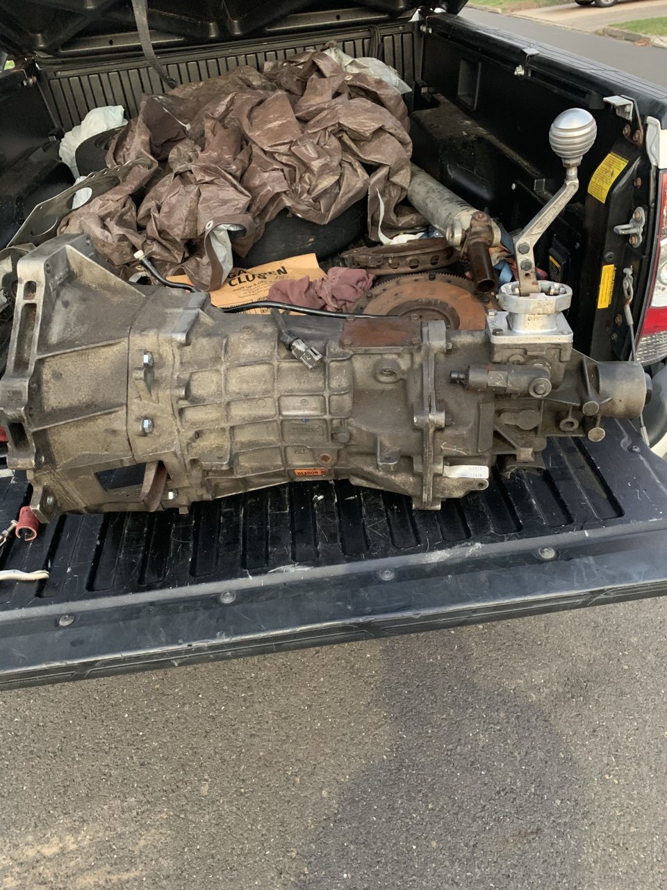

    Ok... it's not a T56 Magnum but it is a T56! The current gearbox will not downshift smoothly into second and the gap from fourth to overdrive is annoying. The T56 will hopefully address both of my complaints!
