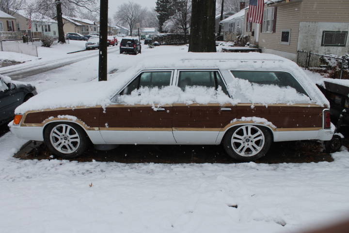

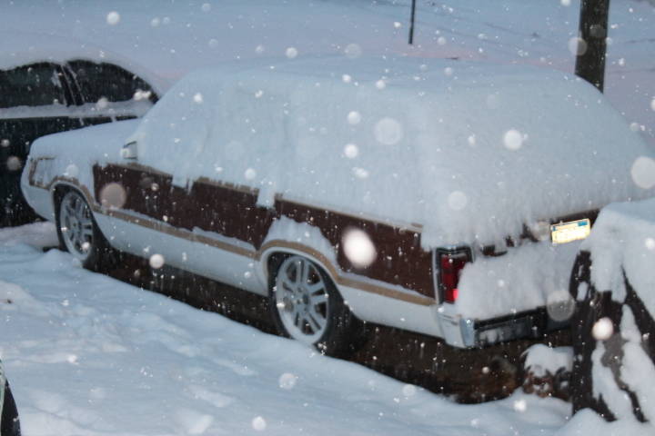

    Sadly it's winter and I don't have a garage. The last thing I did was the connecting rods and with the fuel tank out I pulled the sending unit for installation of a high volume pump. I have the money set aside for an aftermarket fuel injection harness to simplify installation. The tires on the car are the wrong size and I'm on the lookout for a roller cam 351 on the cheap. The wagon is currently covered with snow.

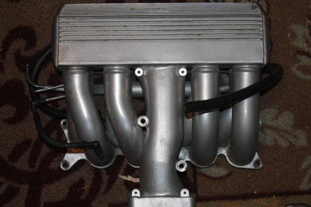

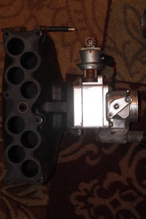

    My Daddywagon as it sits has a 5.0 in it. However, I just took another step towards eventually swapping in a 351 windsor. If you are not familiar with the ford stuff, this lower intake is pretty hard to come by, and I'm pretty excited to get my hands on one!

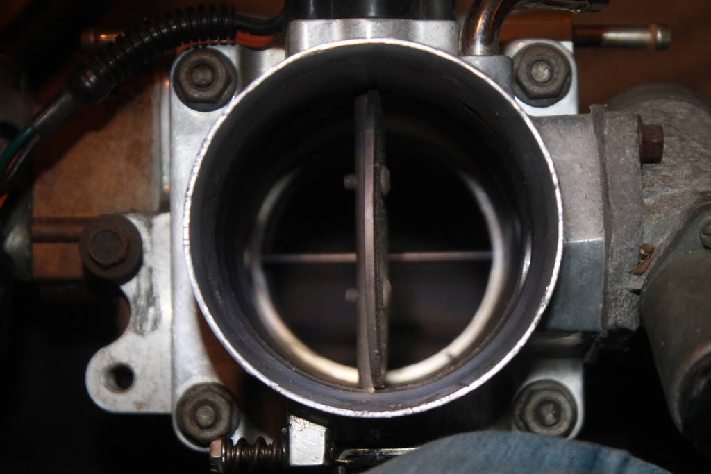

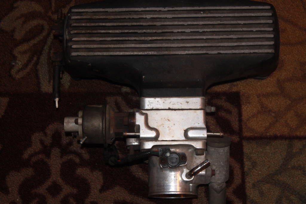

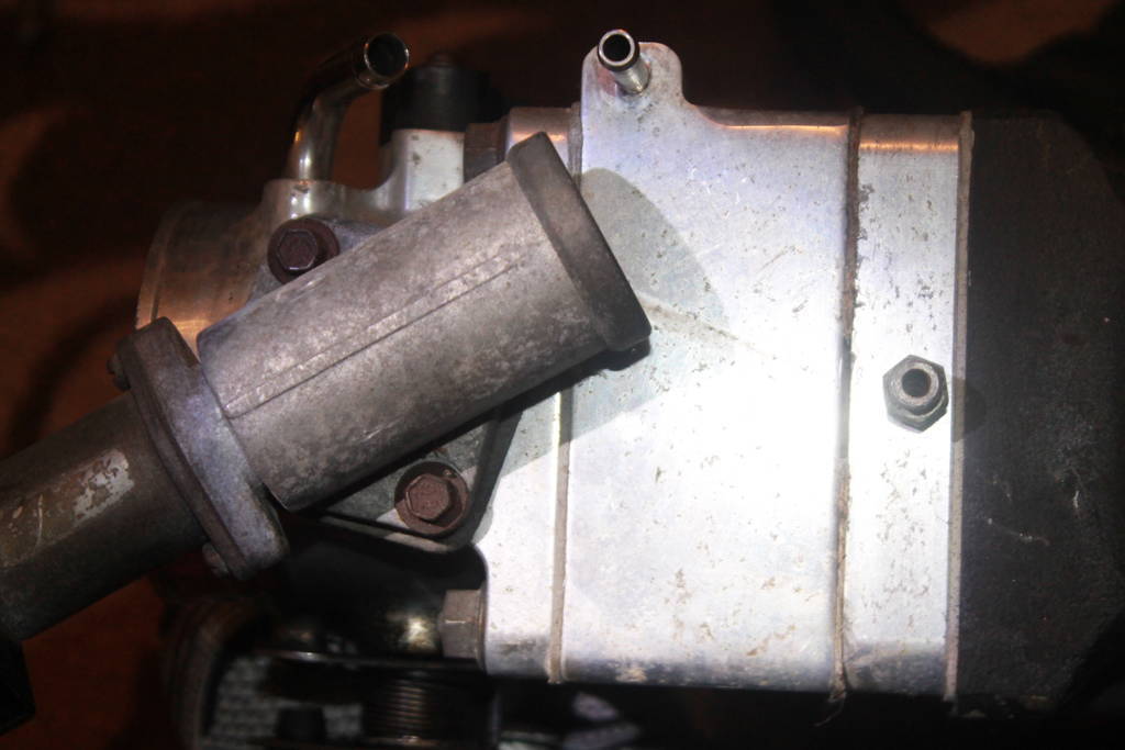

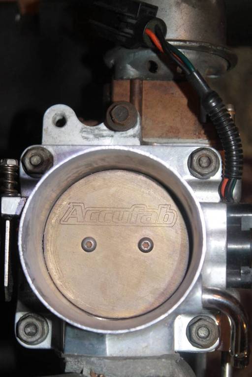

    The intake above came off of the white car. The throttle body and egr measure 70mm. You'll also notice a nitrous plate between egr and intake!

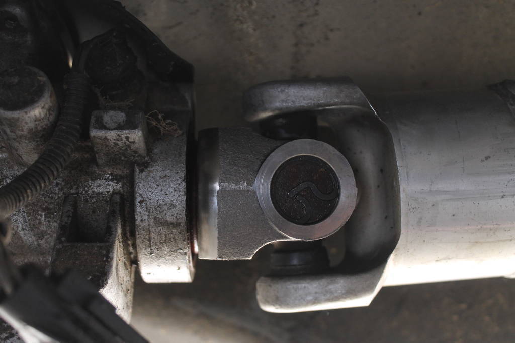

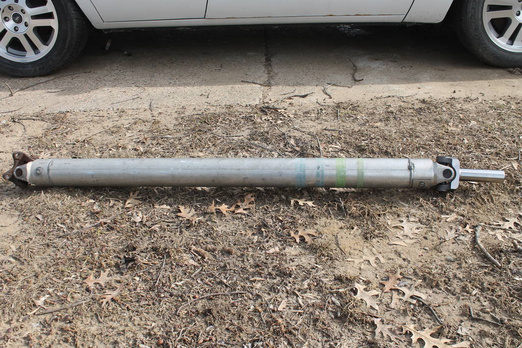

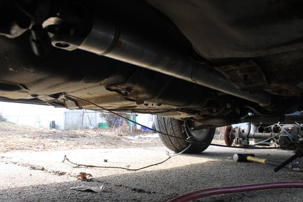

    I miscalculated my driveshaft length! The aluminum driveshaft out of a 2wd ford explorer would have been perfect if I were sticking with a solid rear axle. With my cobra mustang independent rear suspension the driveshaft line "shortened".
