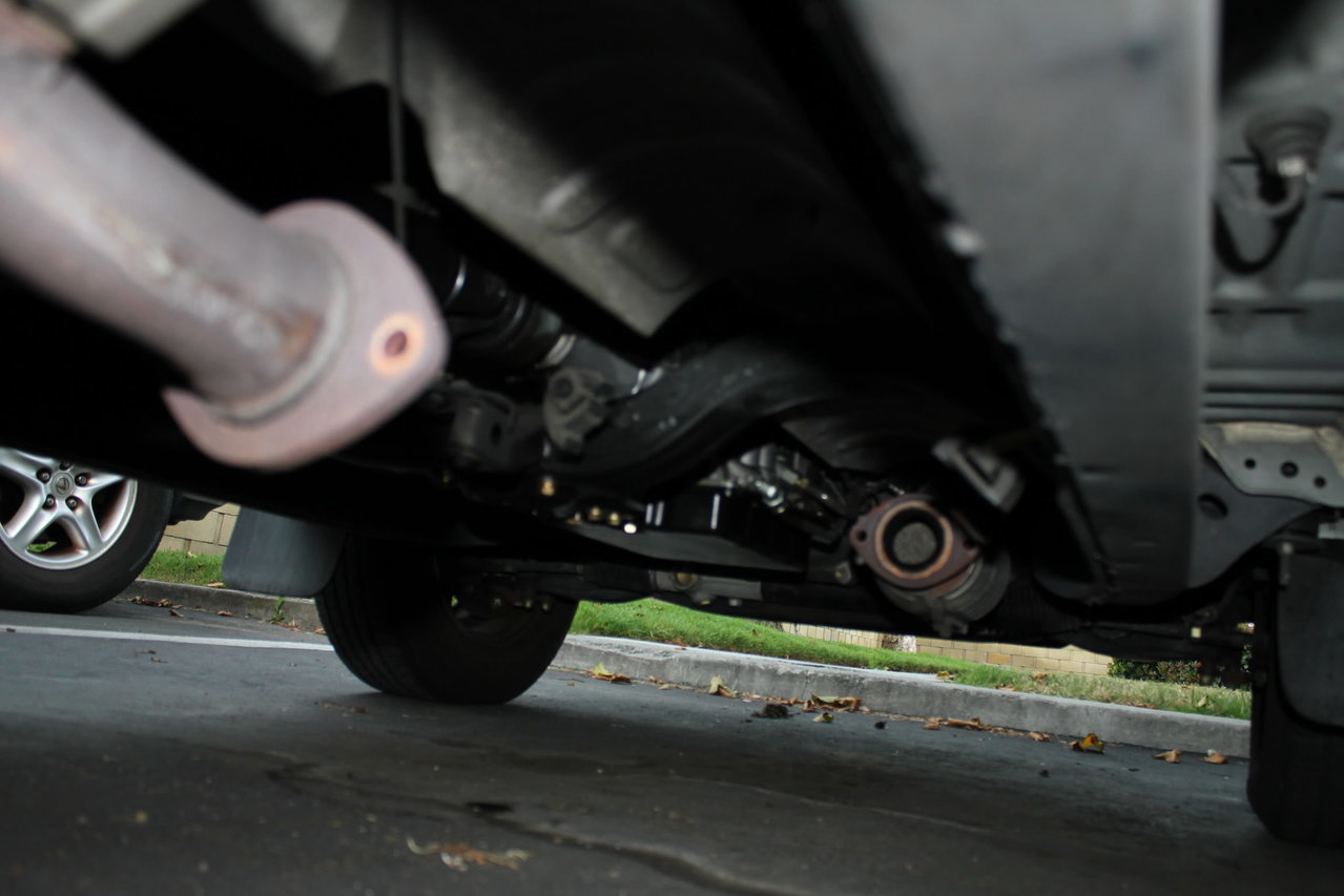

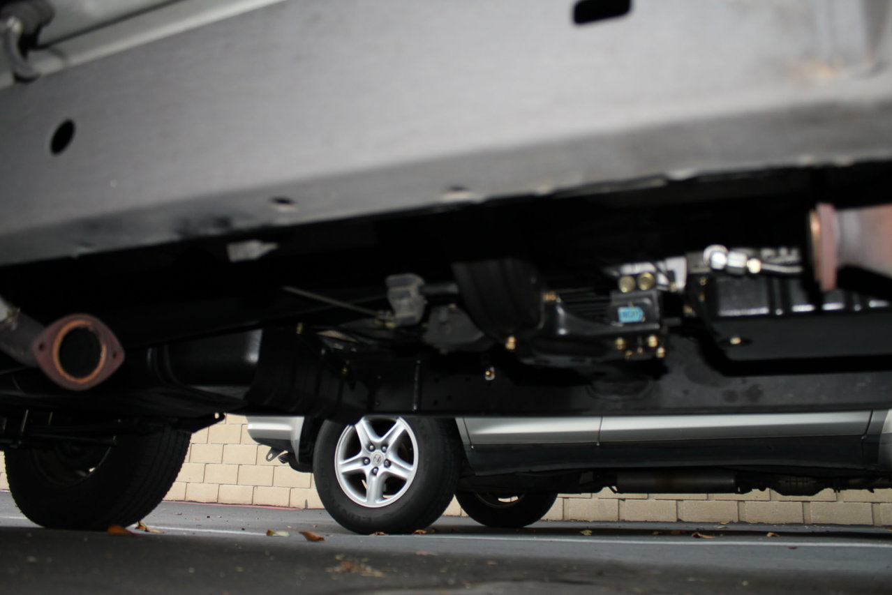

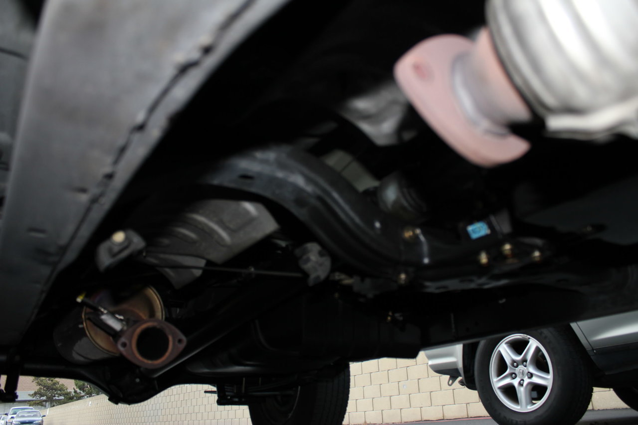

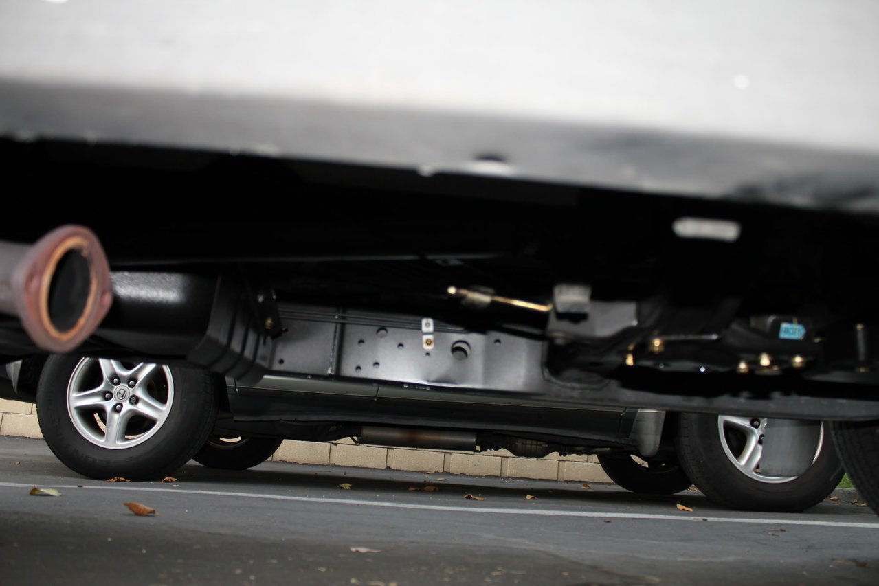

    Last night my dad's truck's pipe/cat were stolen, since I am not very familiar with the Tacoma, I'd like to ask you guys what are missing on this truck?
    It's a 2004 Tacoma regular cab. Also do you know where he can get cheap replacement parts? I also noticed that his hangers/rubbers were cut off. I hope the o2 sensor is still in tact. Below are the pictures.

    Damn that is the strangest thing! i have never seen a stolen cat where they actually unbolted it! every other one i have heard of the thief used a piper cutter or a sawzall. Sadly you cant get a good aftermarket cat they dont tend to last more than a year (at least on the 1st gens). The factory one happens to be stupid $$$$ but its the only reliable option. My advice is make friends with someone who works at toyota so you can get a new cat at employee discount:D. It looks like everything else is still there. You will need new cat+bolts+exhaust gaskets. And maybe a converter lock.
    Edit: Definatly call the police and report it. Who knows it may show up at a scrap yard.

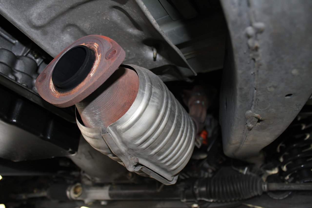

    it appears they stole the resonator. you can see the cat in the picture.that is unless you dads truck is a 6cyl.if so they only stole one cat.but i was always under the impression that the reg cabs only came with 4cyl.

    No they definatly stole the correct part. That is the cat on a 4 banger.
    OP Seems like a few People have had luck with magnaflow cats. However also a few of them only lasted a year before failing. Aftermarket doesnt seem to put enough precious metals inside their cats.
    Edit: i was looking at that backwards the cat is still there???

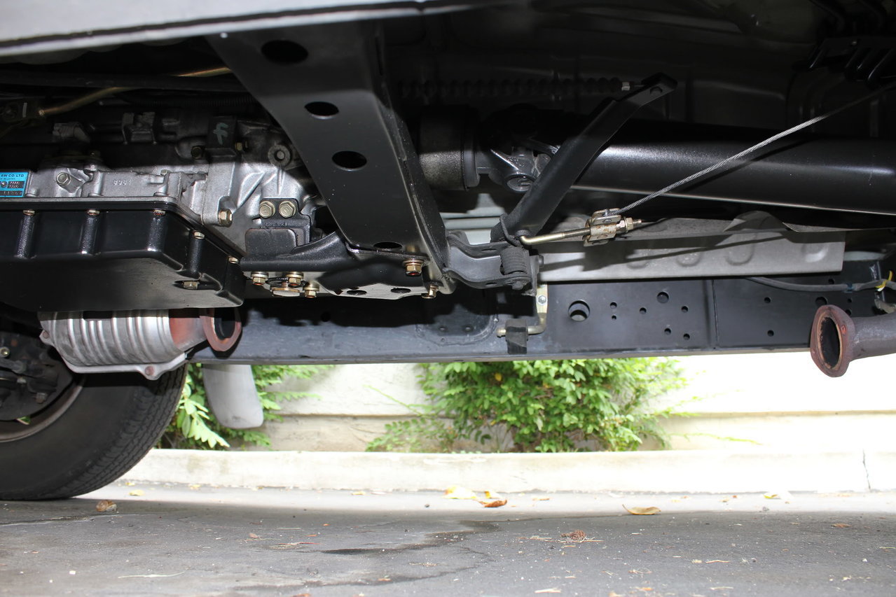

    What is #6? That is what it looks like they stole

    The cat is still there. unless there is 2 cats?
