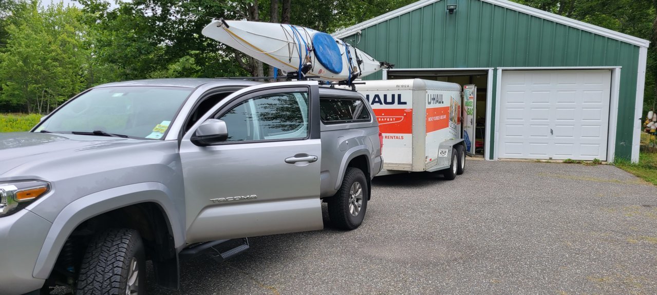

    I've got 2888s & AALs w/ 5100s on my DCLB and recently pulled a completely full 6x12 Uhaul trailer. It was only ~110mi but I intentionally avoided interstates and I left it in S4 and had no problems. The bed had stuff but mostly lighter items and a kayak on the roof.
