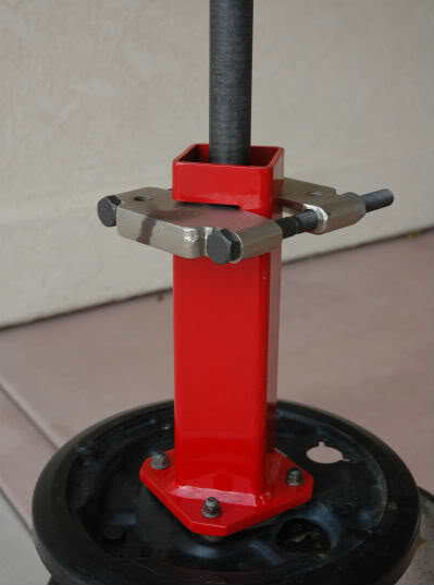

    Just got the press and made a make shift ring remover first before I make the bearing remover. Just posted in case some one needs ideas and are going trough the same thing since I haven't seen this type on the web. You'll need to cut the first ring and head up the big ring to remove it since the welded metal is not that thick to take on both at the same time

    Press is cheap, watch sales. Make sure you dont press on bearing to far!

    The diameter of the ABS reluctor ring is 2 3/4" so using a tube with an ID of 2 7/8" or better will allow the shaft to be pressed out of the 2 retainers, ABS ring and the bearing in one operation. The snap ring must first be sacrificed by carefully bending and pulling it out from between the outer retainer and the ABS ring.
    There is a bunch of subtle tricks to installing a new inner seal in the ABS equipped housings, way beyond just driving it in. Search this forum for "rear axle bearing", titles only, for all the tips and the Toyota TSB on the subject. Also if the rear is an e-locker and the truck does not have ABS the ring can be left off.
    This fellow was made of scrap salvaged from a huge CNC mill shipping support and of course "color matched".

    Hi dirty.yea that's the photo that i got the idea to make mine with. I just used parts I had available. The tube couldn't take everything off at once. The bottom piece was bending badly removing the bearing and one retainer. The bottom piece is 3/16 thick. Do you know how thick is the bottom piece of that one?

    It's 1/2" and does not even flex.
