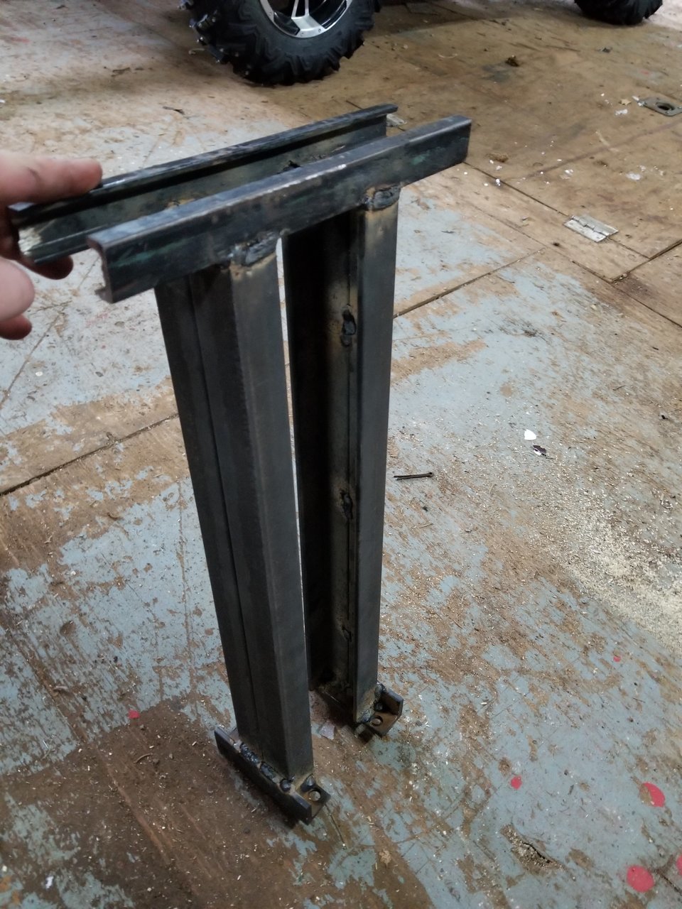

    What the purpose of that. can't you just position the ring by itself were the seal rides?

    Marlin once fooled around with a reducing bushing of sorts that would allow seal placement in an ABS housing to mimic a non ABS housing. I don't think they were ever produced in bulk for sale. This would allow the use of the "non ABS only" chromo shafts in ABS tubes without functioning ABS.[​IMG]
    If one fabs a press adapter from an old housing try and find one with ABS. The larger/deeper hole will allow pressing off the 2 retainers, the ABS ring and the bearing in one shot.

    I see now. The Removing tool I made was for a non abs axle. But I made a clam shell looking deal that just catches the abs ring. It bolts to the flange on the tool I made.

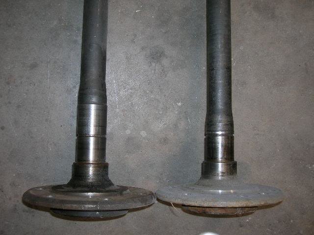

    yes, the non abs housings had seals that did not push in as far, as the axle shafts shoulder was much shorter. It is my understanding that on the non-abs housings, the seal is near flush with the outside mating surface of the axle housing. On abs axle housings, the seal is in much further. Ideally a machinist would need quality measurements of both an abs, and non abs axle housing, and maybe? the seals. I would easily pay fora set of those machined rings. If I could just buy them, it would be such an easy process. Especially now after doing bearings once or twice. I could just freeze em, pound them in, change axle shafts (You can buy the retainer rings individually from toyo btw), and make it an afternoon project.

    Yes the none ABS seal sits almost flush with the end of the axle tube.

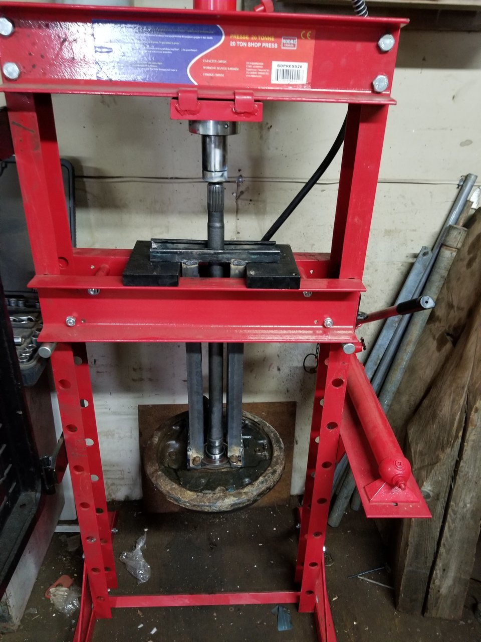

    Doesn't need to be anything fancy to hold the shaft in a press. I rigged this up and it worked great.

    I would hope so. They are the same axle. Only difference could be ABS, if he didnt have ABS and made his tool with tight tolerances, it may not be able to fit all the way down on your ABS axle, but I would imagine it will be fine.

    Some dont have abs correct?

    Correct. Only difference on the shaft itself, had a slightly wider collar for the tone ring to sit.

    you remove the axle shaft and brake backing plate as one assembly. The press comes into play when you want to remove the shaft from the backing plate.

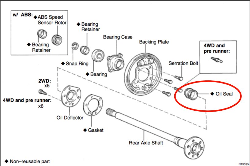

    Has anybody had trouble with the outer dust seal causing a squealing noise at low speeds after changing the bearing/seals? I am getting ready to change the bearings on another axle and am trying to figure out what I can do differently to prevent it

    The outer dust shield, the o-ring that goes over the axle housing and seals to the brake backing plate?

    Im pretty sure its this oil seal that is causing the squeal. Its the larger stiff seal that pops into the bearing case. Ive considered giving it a good coat of grease when I put it together but am concerned about putting much on it because if the grease ever gets out then it will be in the drum brake assembly. Just curious if anybody else has had this issue or had any ideas to fix it
