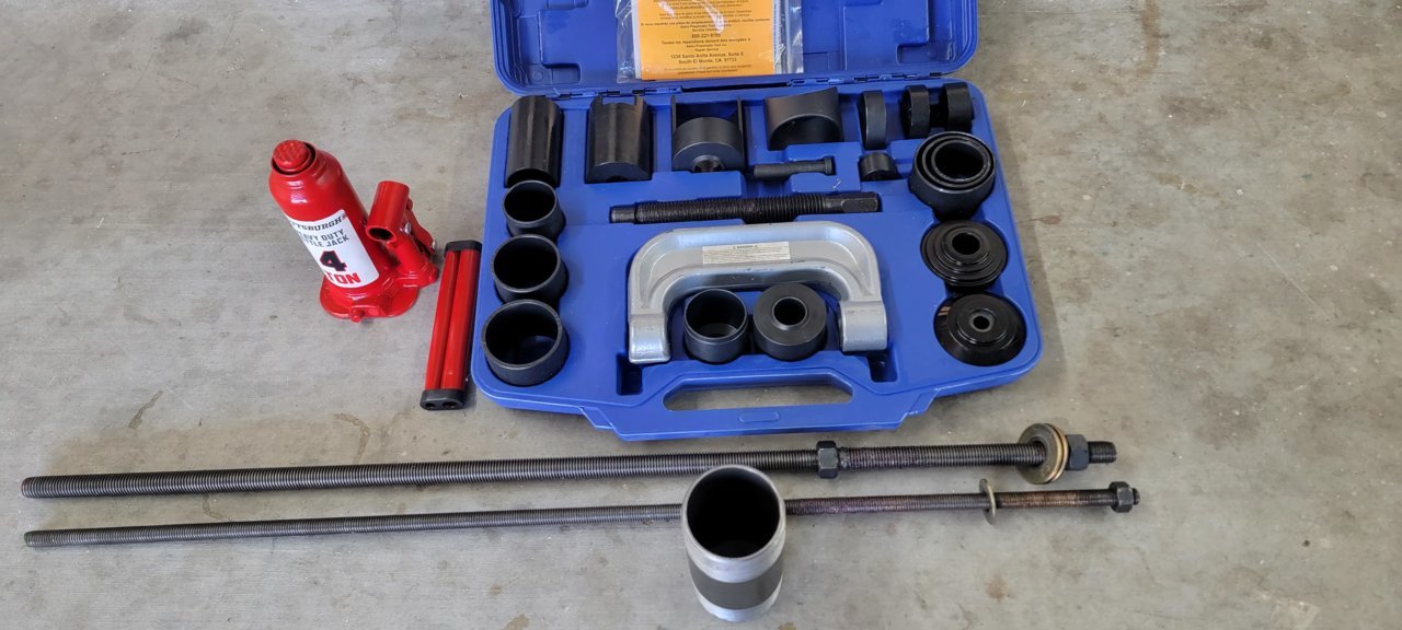

    For this rebuild, the following items were purchased
    1. 2- Moog upper ball joints K80811, and 2- Moog lower ball joints K80827. Total $106.48
    2. 2- NAPA bushings 267-3784, 2-NAPA bushings 267-3783. Total $277.58. These are bushings for the LCA's only as I did not see it necessary to replace the upper bushings. The rubber on the UCA bushings is still pliable and the inner sleeves were perfectly centered. I originally purchased a poly bushing kit from Energy Suspension but decided to go with rubber bushings for a couple of reasons. One, I don't like the thought of possibly having to re-grease the inner sleeves periodically to combat squeaking, especially when I am not an "offroader", and would probably never appreciate the performance of poly. Two, I didn't like the requirement of Energy Suspension's kit of having to grind the OEM washers off and re-swaging them back on to the inner sleeves. Rubber bushings seemed to be the better route for my situation.
    3. Astro Pneumatic Tool 7897 21 pc. ball joint press kit. Total $131.99
    4. 2.5 x 6" steel nipple. Total $33. I had to purchase this because the ball joint press kit didn't have a suitable size cylinder to properly press the larger of the two LCA bushings in. The closest size in the kit started to deform the flange of the bushing, and I didn't have anything on hand that would work.
    5. 9/16"x 36" and 3/4"x 36" grade 8 coarse threaded rod with two grade 8 nuts and two hardened washers for each. Total $82. This was used to pull the bushings into the control arms. One has a ID for 3/4" bolting, and the other has a ID for 9/16" bolting.
    6. Harbor Freight 4 ton bottle jack. Total $30. This was used to press the old bushings out of the control arms. Perfect size for the task.
    Other tools you need/may need that I already had
    1. Torch to heat control arms up while pressing out the bushings
    2. A bench vise. Not absolutely necessary but is extremely useful while pressing and pulling.
    3. Wrenches for all-thread nuts (7/8" and 1-1/8" in my case)
    4. Large 1/2' drive breaker bar OR impact for using ball joint press (7/8" socket for my specific press). I used a breaker bar and it wasn't horrible but an impact would have been nice.

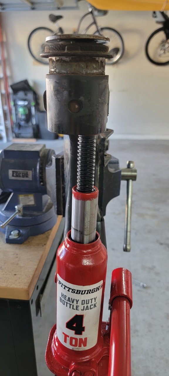

    2) Bushing removal. Place LCA in vise (if applicable) and then put the 4 ton jack in between the arms. Put some force on the bushing but don't get too crazy. Evenly heat up the socket of the control arm being careful not to get it insanely hot where you start melting the rubber or catching it on fire. What you are trying to achieve is heating the socket up so it expands while minimizing heat transfer to the bushing outer sleeve and bushing rubber. After its fairly hot, apply more force on the bushing with the jack, and in my case it popped loose. If it doesn't pop at this point, apply more heat and force. When mine did pop from being fully seated, it was easy to fully remove it by grabbing it with pliers to avoid being burned. I saw this method somewhere in this forum but can't seem to find it, and was pleasantly surprised how easy this part was. Repeat for the remainder of lower bushings.

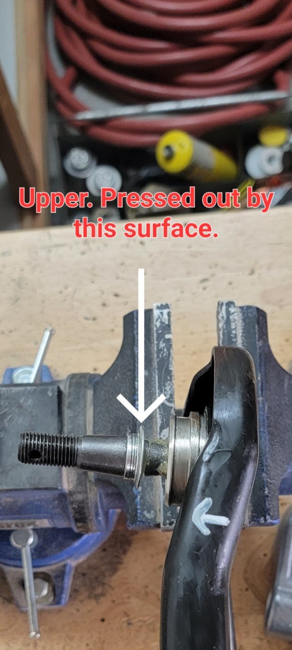

    . The Astro press kit I purchased had adequate parts to remove all ball joints. I did find that there wasn't and "ideal" piece to meet up with the upper ball joints to press out. What I ended up doing is placing the eye of the clamp on the flanged portion on shank to press it out. If you have a piece of 1-1/4" steel pipe, you could use it to sit on the land of the ball joint body to press it out. For installation first CHECK ORIENTATION! You will have to monkey around with the pieces to make it work, but this kit is suffice. I again had to use the eye of the clamp, where I pressed the lower ball joints in, due to not having room and an ideal piece. As previously stated, I used a 1/2" breaker bar for the install, and it took some muscle to make them move. It did seem that the clamp would slightly deflect under heavy torque, where the ball joint would start to get a little wonky. To mitigate this, I simply reoriented the clamp as close to 180 degrees out. An impact would have been nice but I suppose that manually pressing it made it a slow and more controllable evolution while ensuring the ball joint is evenly moving. If you do it manually, I would say you definitely need a vise.

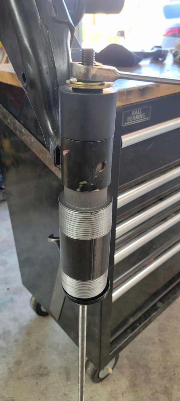

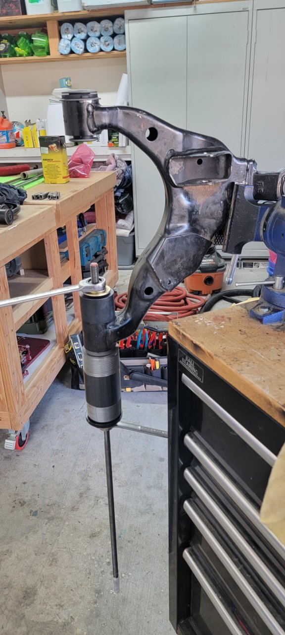

    . This is where I used the threaded rod to pull them in following a link in another thread provided by @DrFunker. https://www.suspension.com/blog/how-to-install-a-bushing-without-a-press/
    CHECK ORIENTATION! Remember, if they are oriented the incorrect way, a bottle jack will not be able to press them out. The only thing I can add to this is I had to use the 2-1/2" steel nipple to properly seat on the larger lower bushing flange. The Astro ball joint kit doesn't have a great size for this, and the closest one in the kit started to deform the flange.
