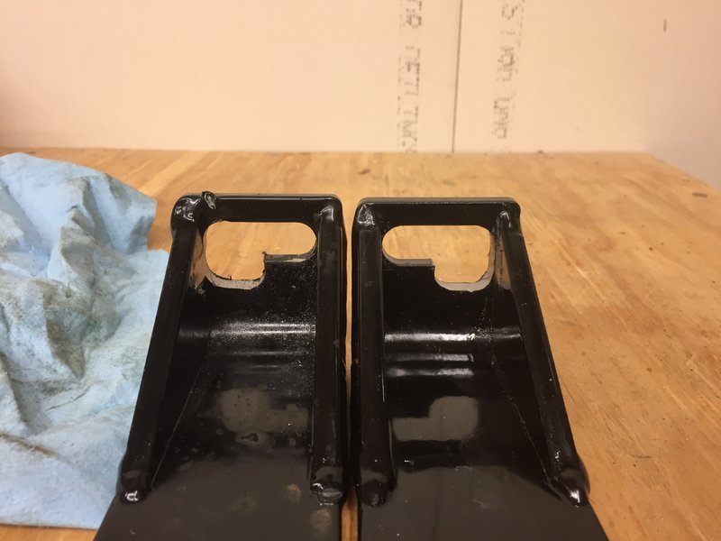

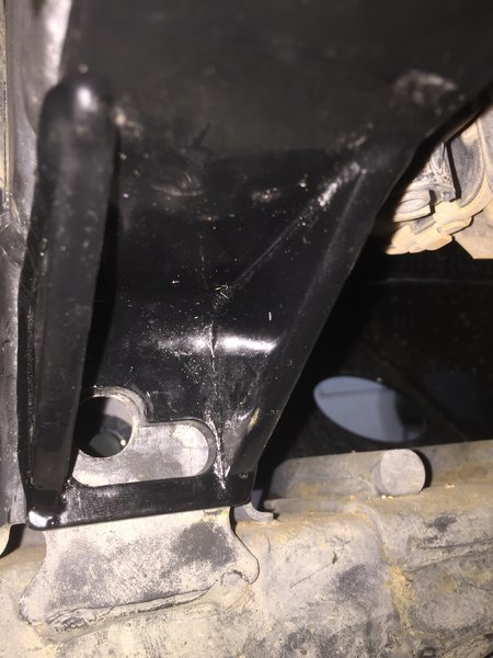

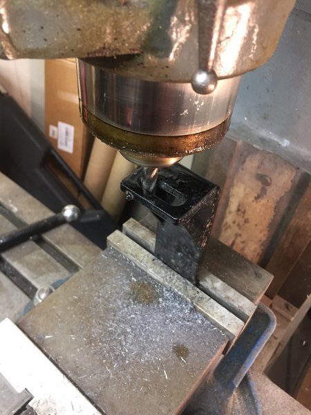

    IMG_2351.jpg I couldn't ever get the sway brackets too align. It was about 1/4 inch off, the weld on the bottom of the frame looked to be the issue. So I ended up milling out the part I need on the bracket instead of grinding on my truck IMG_2349.jpgIMG_2350.jpg

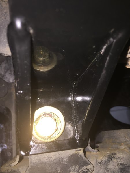

    image.jpg IMG_2352.jpg I just put them back on worked fine. Had to get bigger washers alittle tight

    Mine took some grumbling and messing around to line everything up but mine were not off by as much as yours look. Interesting. Might be a unique truck issue, as we know, our trucks have a ton of little differences even between model years and sub models.
