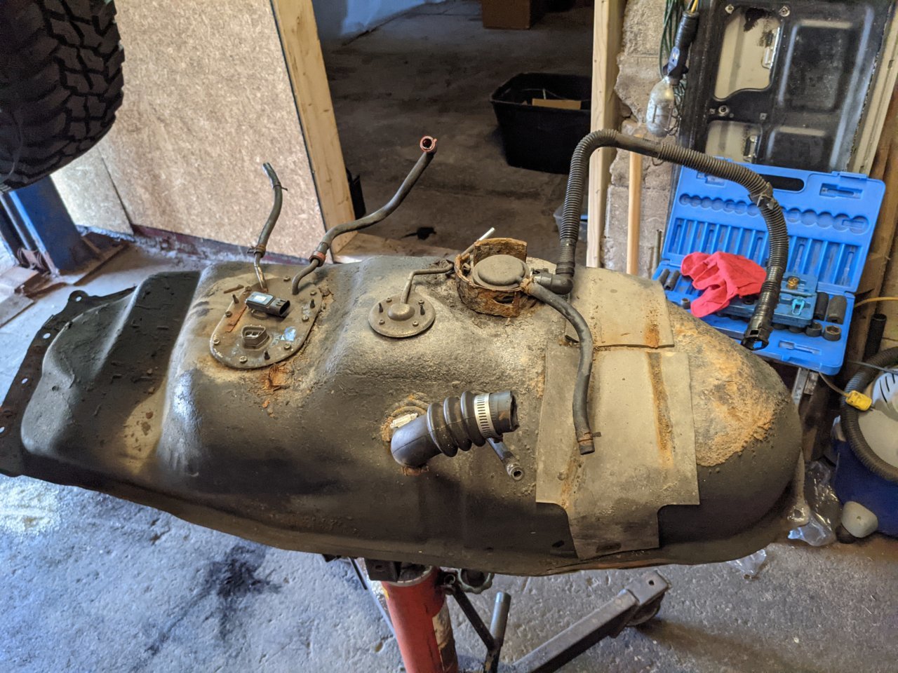

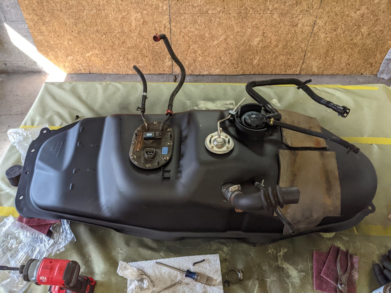

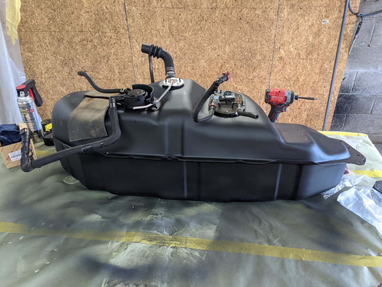

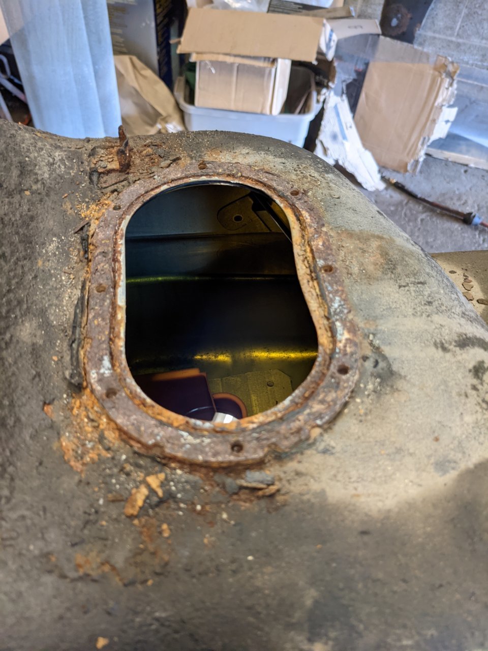

    Misc:
    - In the theme of rust repair, along the way I’ve replaced the gas tank and fuel pump due to the rust around where the fuel pump assembly connects was causing an evap leak. I gave the tank a quick spray paint job to help protect it a bit, we'll see how it goes, but it's much much better now
