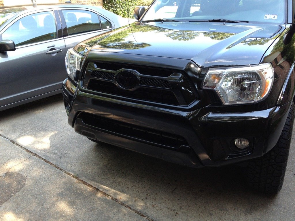

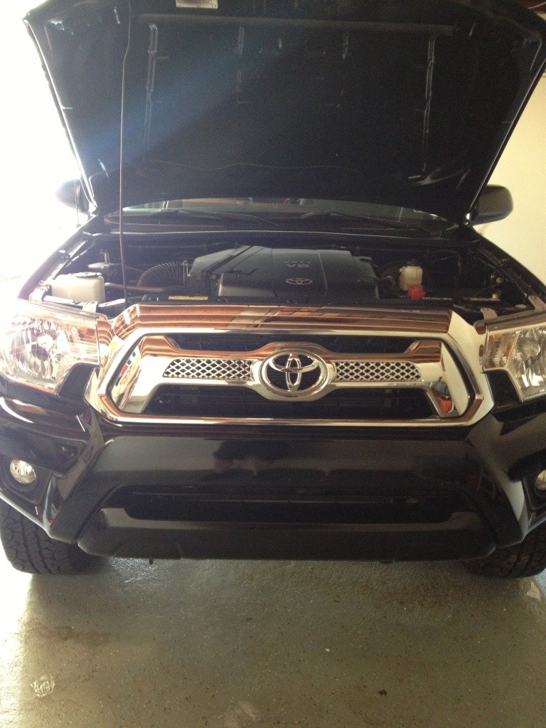

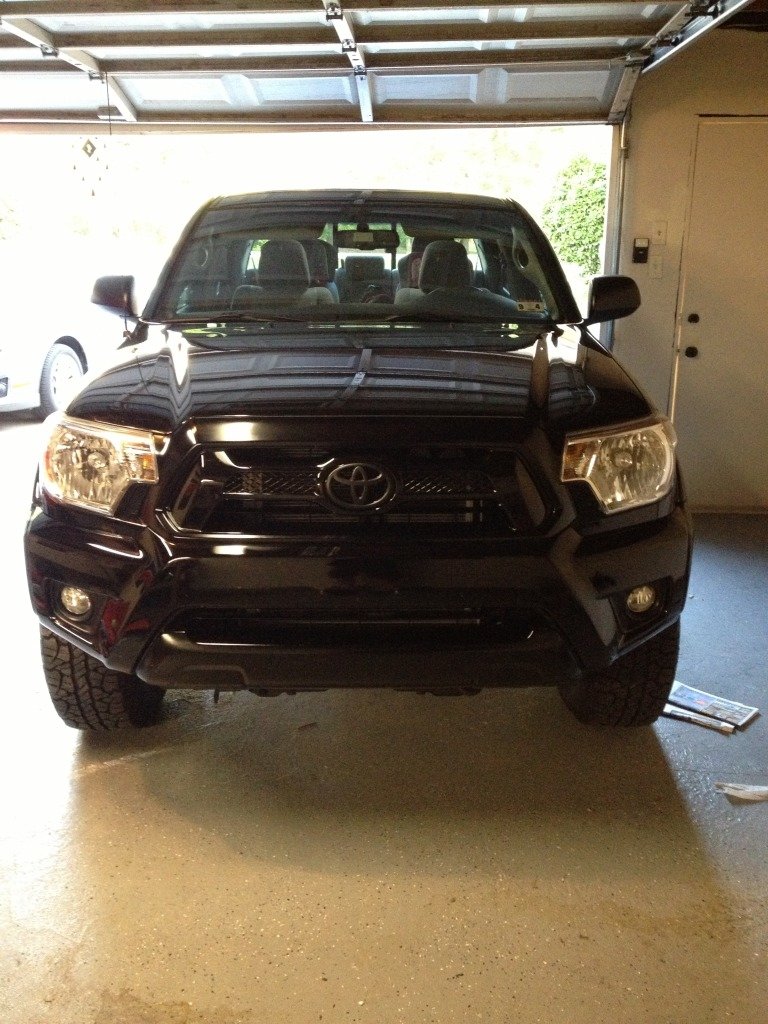

    I hate chrome so i sanded and painted it. The center chrime thing just popped off so i didnt have to paint the grill itself, just the surround part. Wetsanded 600 grit, primed, wetsand 600 grit, 3 coats black, 4 coats clear, 1200,1500,2000 wetsand, polish with 3m extra cut rubbing compound, 3m final glaze n done! All in all bout 5 hrs. Plastidipped the T emblem tho! I know the murdered out thing is kinda old but ida done the same with whatever color it is! My 4runner is a limited model with no chrome and i always liked the color matched look. Already added led dome/map/ license plate lights too. These pix are before wetsand and polish.

    Sandpaper is whatever auto parts store has it in stock, paint is from paintscratch.com. I just make sure to soak the sandpaper in soapy water for a bit before i start and keep the painted piece wet! I did the hood and bumper on my old z as well with paint from them. With air gun and compressor tho. This was just rattle canned but same result. Patience and time works well!
