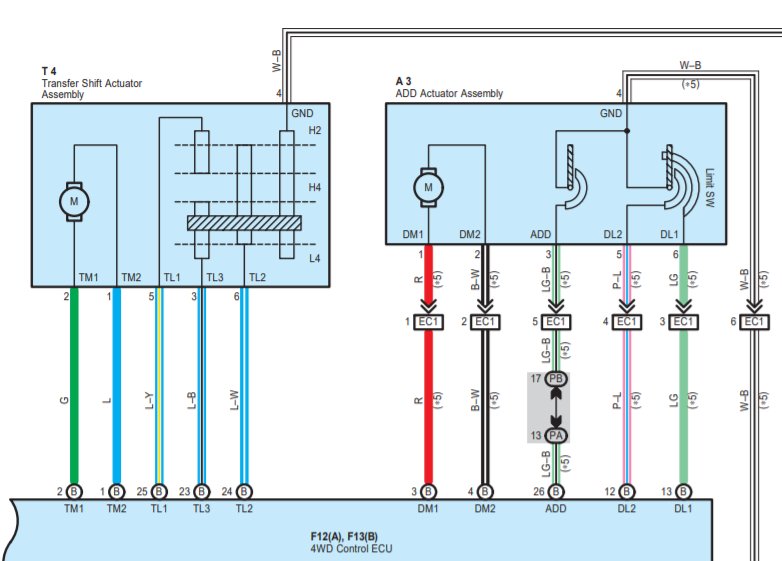

    As far as simple testing of voltage to the servo motor, the connector of the front ADD Actuator includes a red wire (terminal 1) and a black wire/white tracer (terminal 2). When the ADD servo motor is being driven to lock the differential (4WD switch turned 2H-->4H) there should be +12v measured at the red wire (terminal 1) with the black wire/white tracer (-) (terminal 2). The reverse polarity should be measured when the servo motor changes direction (4H-->2H selected) to disengage the ADD.
    For the Transfer Case Actuator, there is a lavender wire (terminal 1) and a blue wire (terminal 2) included in the connector. +12v should be measured at the lavender wire (terminal 1) and the green wire (-) (terminal 2) when 2H-->4H is selected. When 4H-->2H is selected the reverse polarity should be measured.

    That all sounds accurate minis the wire colors. The t-case has a blue and green wire going to the servo. I'd be checking electrical before tearing into the transfer case and checking shift rod, save that for last.

    3,115
    Thanks for that diagram, I miss my 1988 Nissan 4x4 King cab, with the 4-wd shift knob on the floor and without the electronics.

    See attached for the voltage readings you'll need to check to diagnose the 4wd electronics. Get yourself some meter leads with the skinny needle type leads to get behind the connector terminals for an easy and accurate reading.
