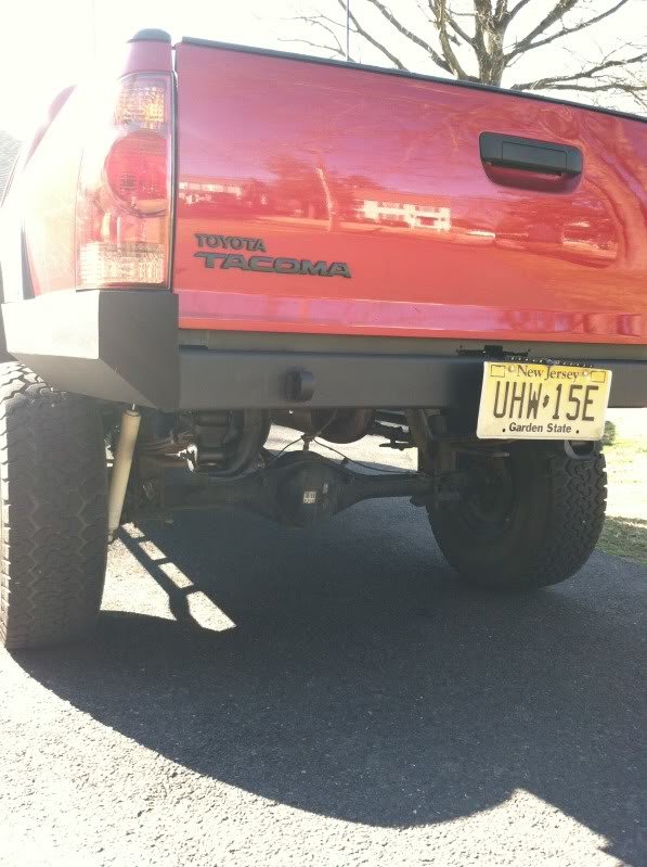

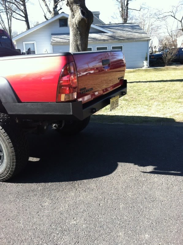

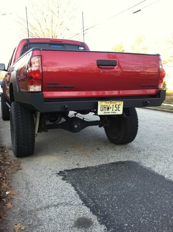

    Thanks everyone for the replies. I wasn't able to finish up this weekend, other things got in the way with school work and everything. What I was able to do so far got ground down, cleaned up and painted, as I need to have something on the vehicle for the week. I'm hoping to have it finish as soon as possible. I still need to add another mounting point for the bottom of our C channel frame and cap the top of the wrap around pieces. so whenever I get time, I'll make some templates for the top cap of the wrap around pieces, cut it out of steel and weld it on. Anyway, here are some pictures of it cleaned up and painted of what I have so far.

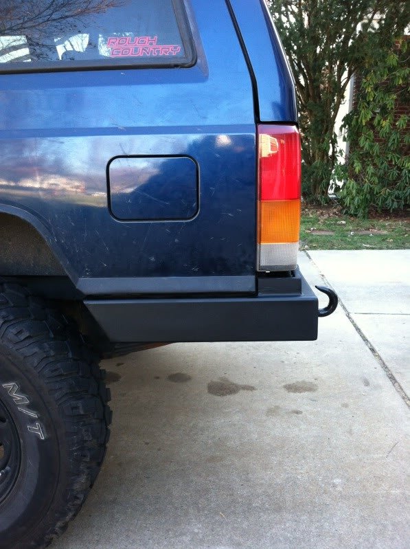

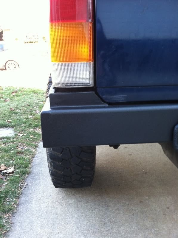

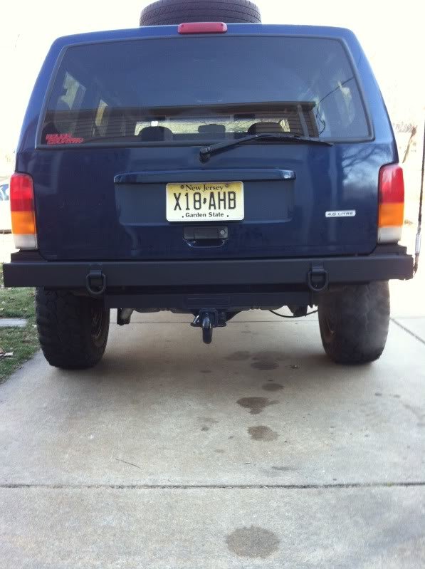

    I recently built one for my buddy's xj. Here are some pics of that one finished up.

    Looks good, but one piece of advice: You're gonna want more space between the bedsides and the bumper for frame flex. I'd say take about 1/4" off the top of that thing, otherwise you might buckle the bedsides offroad.

    Yeah I planned on taking the cut to the bottom of the taillights to give me the additional room. Thanks though I appreciate any comment that will help me out.
