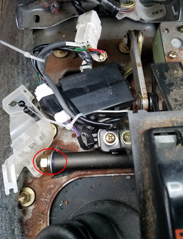

    if you have an automatic transmission the shifter inter-lock switch is not being activated by the shifter handle. Push forward on the shifter handle and it should allow you to turn the key to the off position. The bushings that the shifter pivot on are shot and need to be replaced. It is a pretty easy job. Many posts on the forum describing the job.

    Maybe the shifter bushings are worn. I had a similar problem in my 1st gen that was fixed after I replaced them.

    If you do need to replace those bushings, it's pretty easy. There is a plastic bushing on each end of this shaft. 30 minute job max, and bushing are very inexpensive at the dealership.
    I did mine last Winter. Shifter feels like new again.

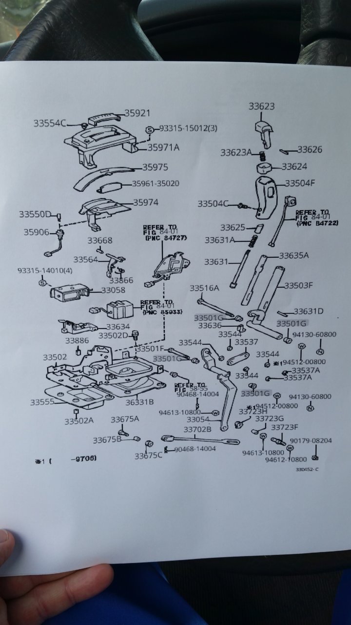

    When I recently had the same problem on my 2001, I seem to remember a shorter sleeved shaft that mimics the primary gear selector shaft. Check those bushings too. Mine is a 4x4, so perhaps yours is different. I'm going by memory from 3 moths ago....
  11. Jun 1, 2020 at 3:21 PM
    glandnut
    glandnut Reserve Squirrel Hair
    Jul 8, 2009
    #19461
    384
    Florida
    16' 4Runner TEP, 01' Ext cab 4x4
    secret stuff.
    I did my original temp fix by shimming metal washers of each side of the shifter pivot "tube". This thread reminded me to pop by the dealer and pick up the 4 bushings, all of which were the same part# for my 01' Etra-cab 4x4. Part number for my truck was 90385-11003. Whopping $1.78ea.
    Schematic below shows the parts highlighted "33501G".
