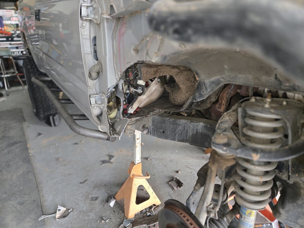

    And more cutting done.

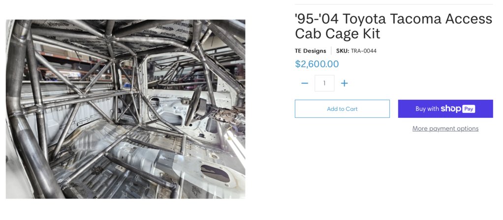

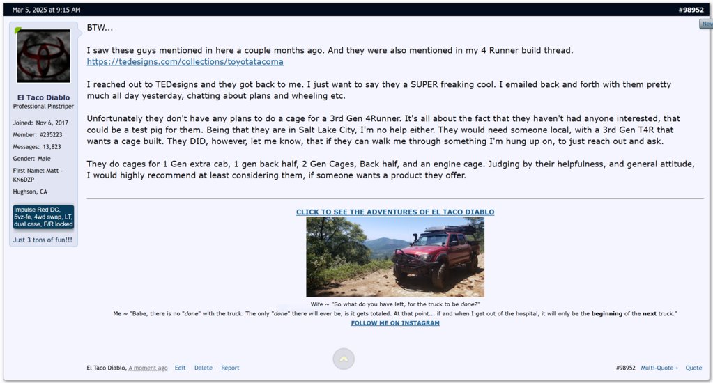

    BTW... I reached out to TEDesigns and they got back to me. I just want to say they a SUPER freaking cool. I emailed back and forth with them pretty much all day yesterday, chatting about plans and wheeling etc.
    Unfortunately they don't have any plans to do a cage for a 3rd Gen 4Runner. It's all about the fact that they haven't had anyone interested, that could be a test pig for them. Being that they are in Salt Lake City, I'm no help either. They would need someone local, with a 3rd Gen T4R that wants a cage built. They DID, however, let me know, that if they can walk me through something I'm hung up on, to just reach out and ask.
    They do cages for 1 Gen extra cab, 1 gen back half, 2 Gen Cages, Back half, and an engine cage. Judging by their helpfulness, and general attitude, I would highly recommend at least considering them, if someone wants a product they offer.

    Was completely NOT motivated to do anything yesterday. First order of business is to get the garage somewhat cleaned up from last weekend.
    Hoping to at least get the rest of the cuts done on the front aprons and check for clearance tonight. That's going to be somewhat a pain in the ass, because I discovered my son welded the battery tray, he made, to the inner apron. Big, fat, 1/2 inch plug welds... fun.
    Hopefully I get through that and in to removing the rear bumper, and marking the rear fenders for cuts.

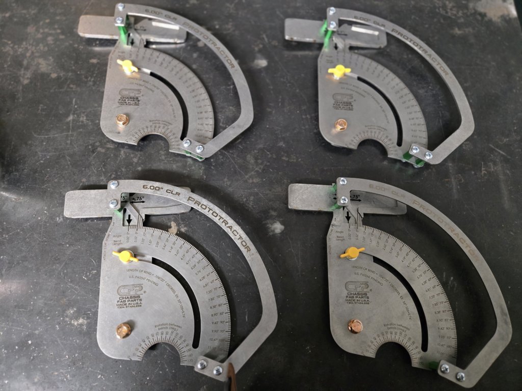

    The Prototractors from Rouge Fab are out for delivery. Kind of excited to see what they are all about.

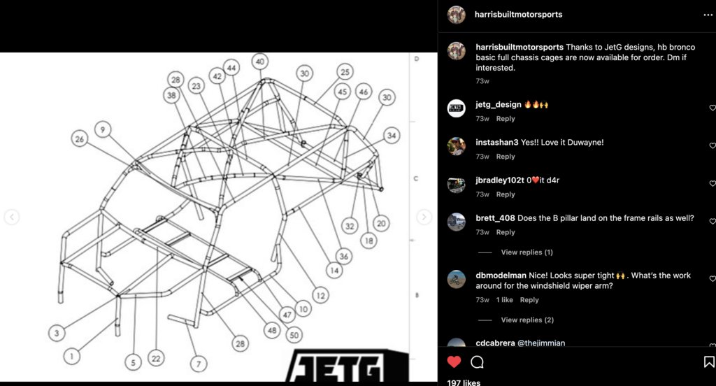

    While no one (besides 4xInnovations) makes a 4runner cage, you could check out Bronco cages for some ideas you might incorporate into your cage.
    Solo and Desolate make them as well as Harrisbuilt Motorsports

    Prototractors got here.
    These things are fricken NICE! Very high quality tools in my opinion.
    Hopefully they take a little bit of the guess work out of the process.

    https://tedesigns.com/
    @10YSON suggested these guys. They do make 2 inch tube, race spec cages for 1st gen and 2nd gen Tacomas, they make back half's too. (Shipped ready to weld) I reached out to them about a 3rd Gen T4R. They don't make them only because they haven't had someone come in that wanted one. (They need a test pig to fit).
    Unfortunately they are in SLC. So, this rig won't do them any good. They are SUPER FREAKING COOL though.

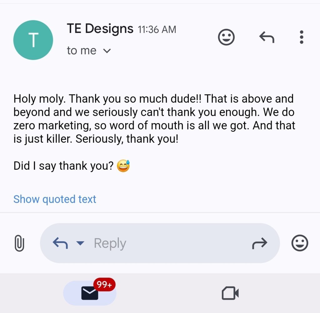

    Here's the type of people you're dealing with, with TEDesigns.
    I sent them a screen shot of the shout out I gave them in the LT thread.
    Here was their reaction.
    They seem like really good people. A small, local, shop just trying to get by. They obviously do good work judging by what dude in the video was saying.
