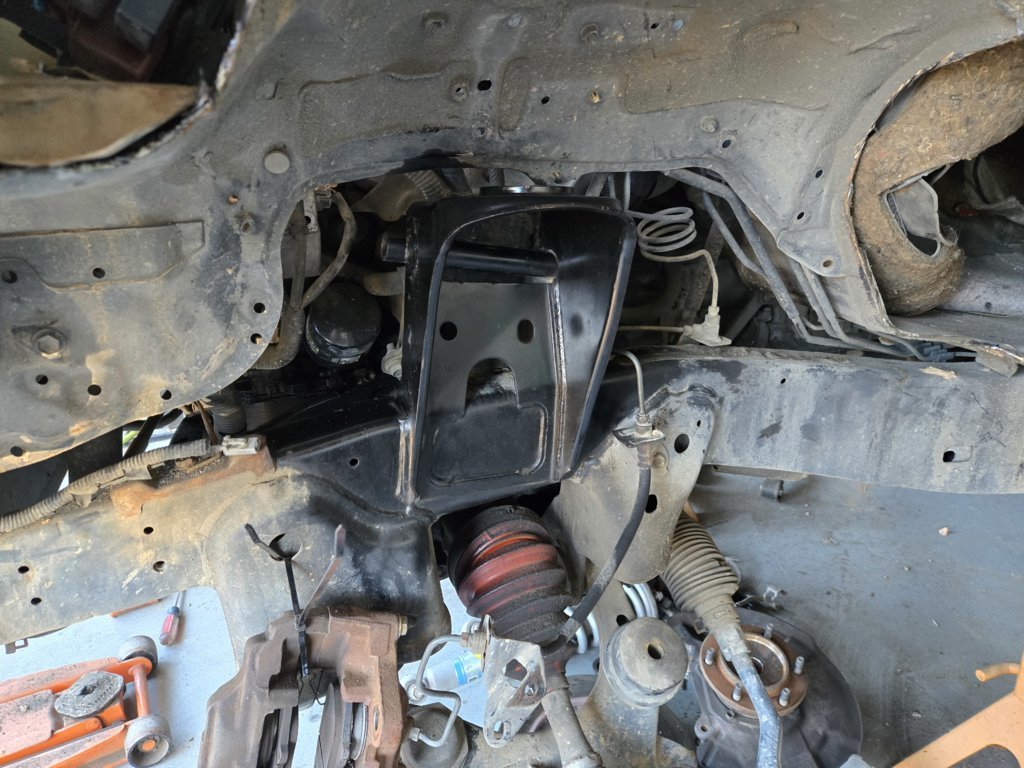

    Well. @Pella was able to grab the un-jank-ified air box for me. I'll get it from him this weekend.

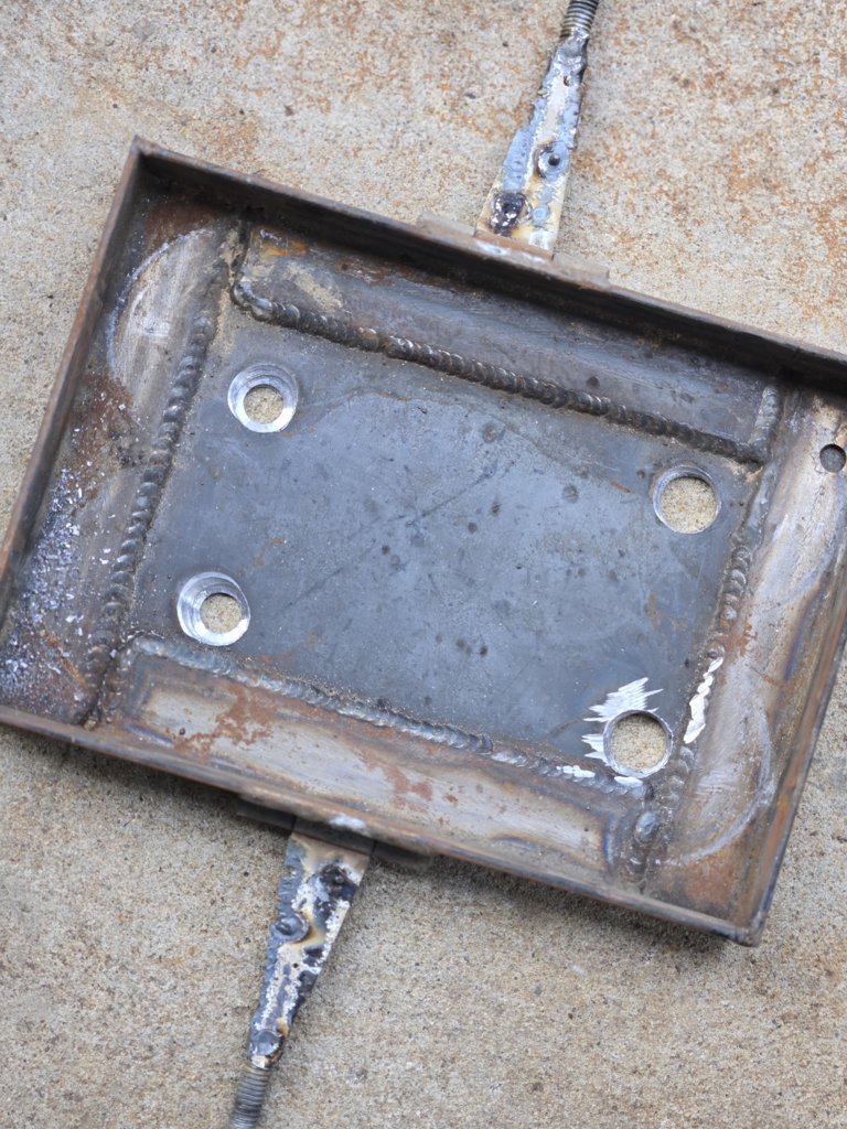

    Got the battery tray Robert made out. JAYsus that was a pain in the ass.
    The tray was made out of 5/16 and his plug welds were 3/4.

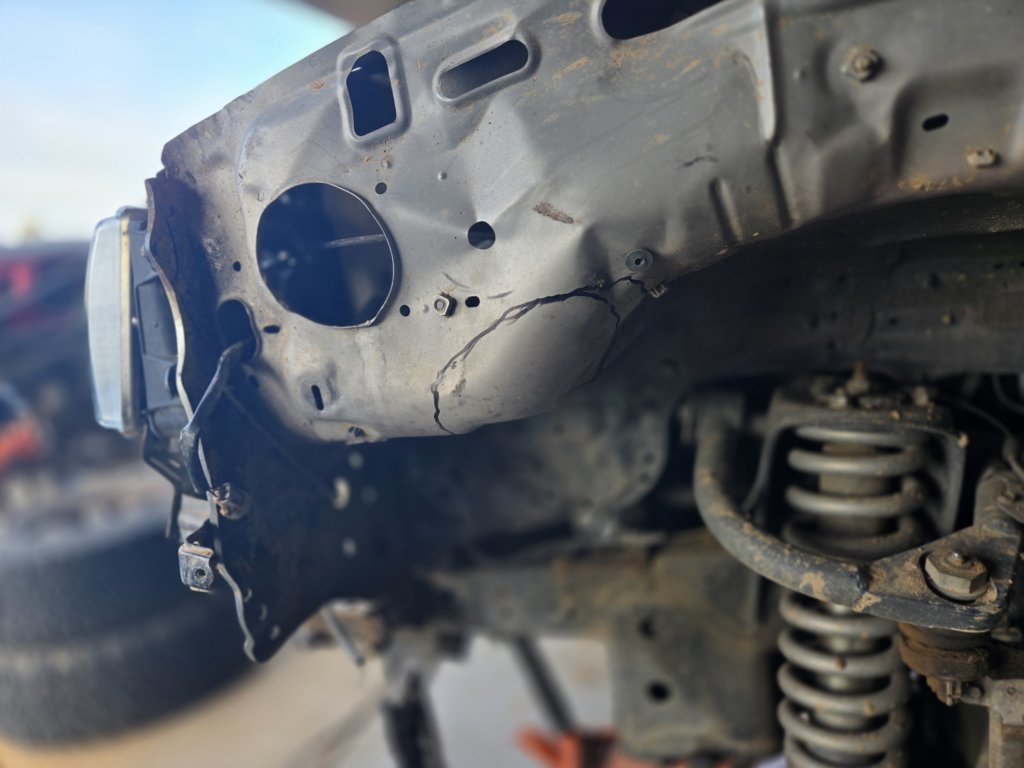

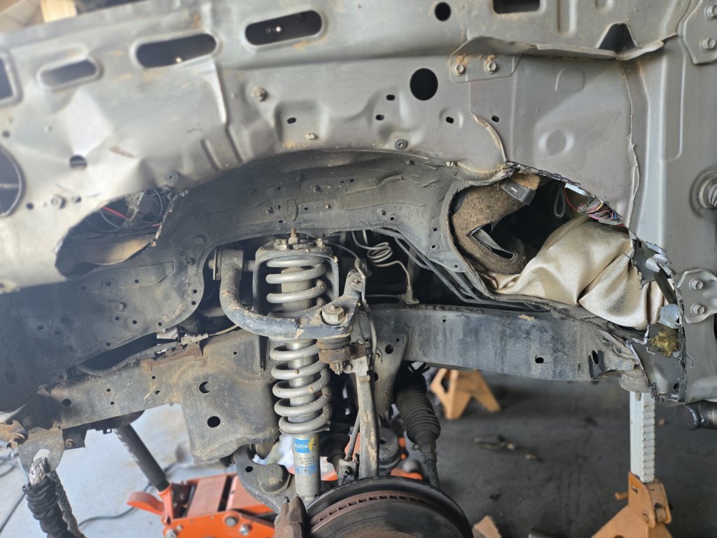

    Gunna go to town on some more fender/apron cutting.
    Going off my truck, that should clear 37s. Mine doesn't rub at all.

    Any further clearancing on the front can be done with a hammer. I'm done for the evening.
    Tomorrow will be on to the rear wheel wells.

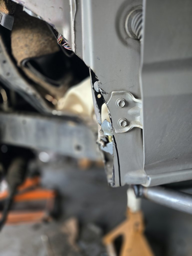

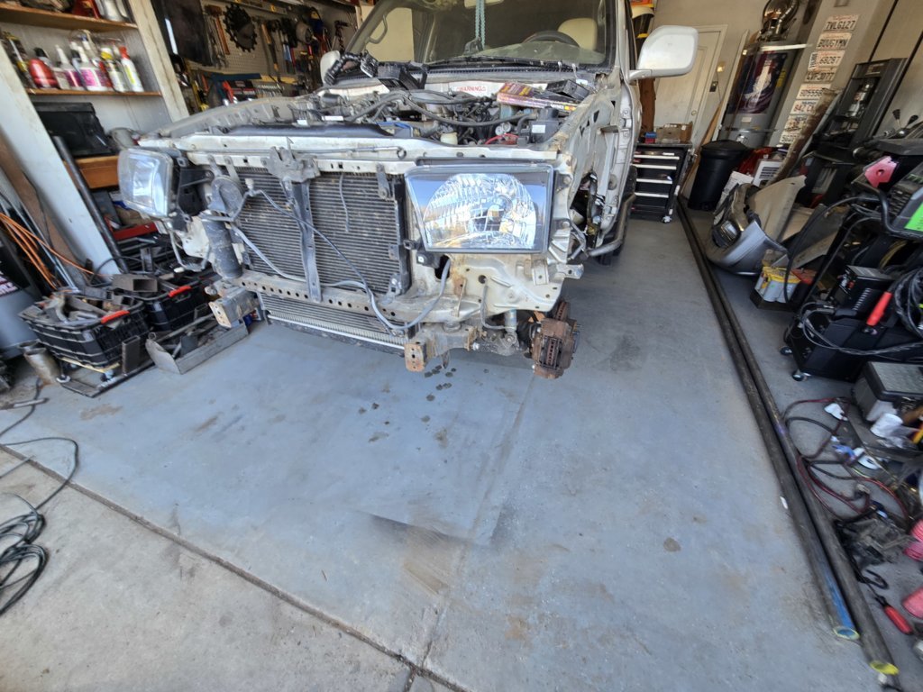

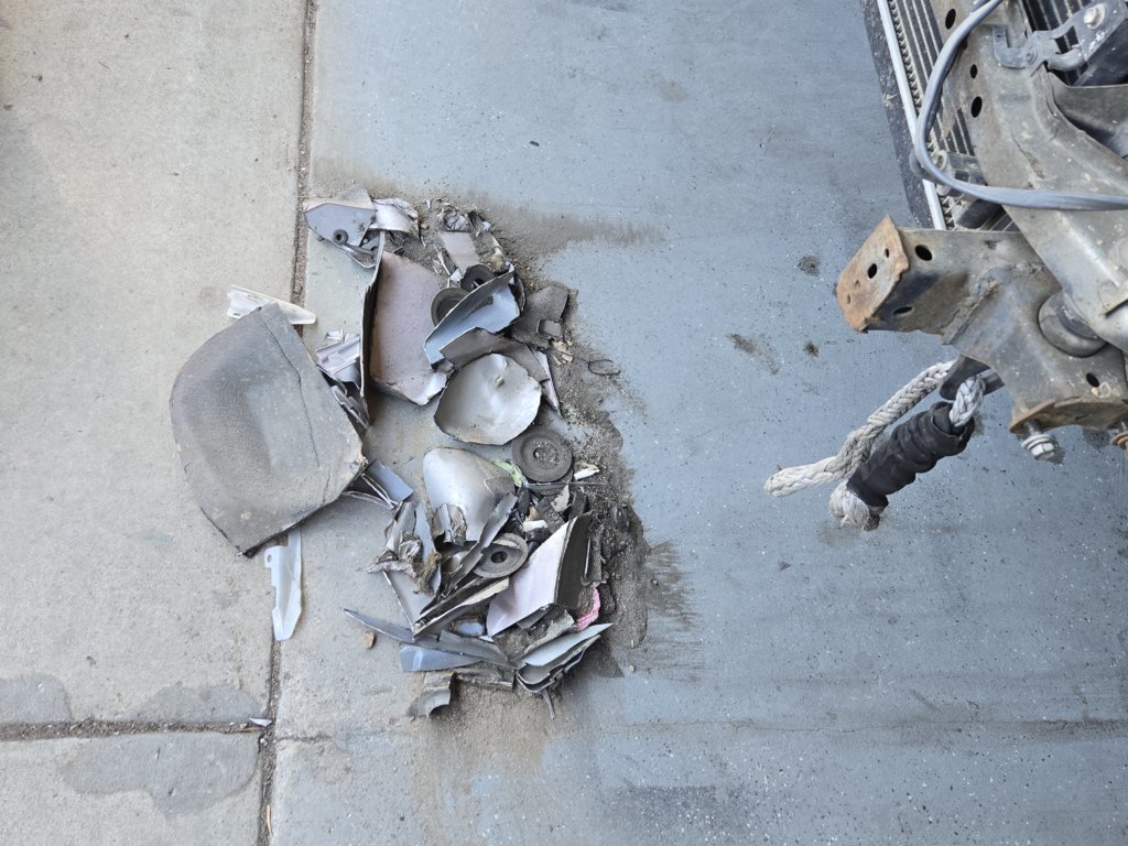

    Straightened up the garage this morning. Well, as much as I could, with the room I have.
    Some of the aftermath of the fender/apron cuts

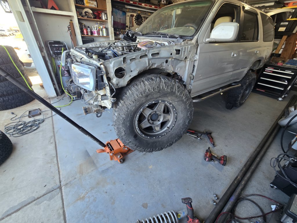

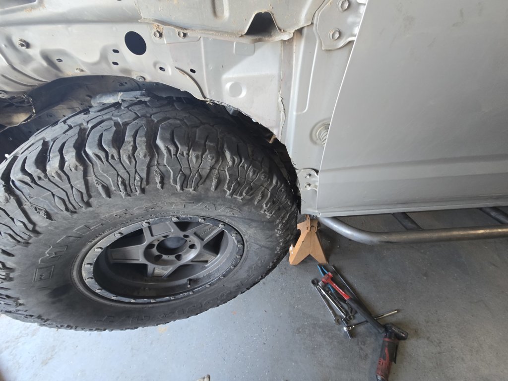

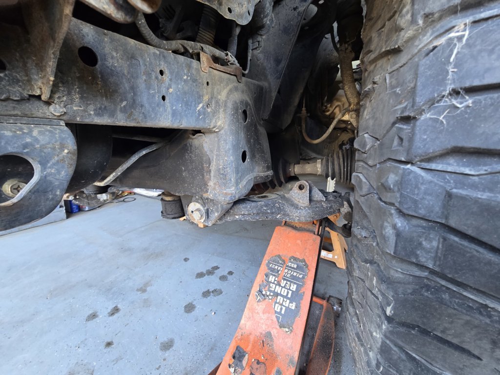

    Ok, so I checked my work.
    Removed the coil overs and bump stops. Mounted a 37, jacked it up to within a half inch of where my up travel will end.
    No rubbing on the fenders or apron.
    I do rub on the frame (3.5 LT will fix that) and the UCA (going from 4.75 back space wheels to 3.5 back space will fix that).
    AND... I still have a 1 inch body lift to install.

    @MattJakobs @theesotericone @JTFisherman
    How did you guys clearance the back?
    Meaning, I removed the coilover in front so I could jack up the wheel without jacking up the truck. Did you guys remove the coil to do that in the back?

    Yep. Remove the rear shock and coil then cut way more then you think you need too. When the rear articulates its gonna do things you can't replicate unless you got a fork lift laying around. Which I think @JTFisherman might. lol

    Ya, speaking of articulation. When this thing is done, it's going to articulate even differently than it is now. That's one of the things I'm keeping in mind.
    Longer axle will put the tire in a different spot, and different links are going to swing the axle to a different spot as well.

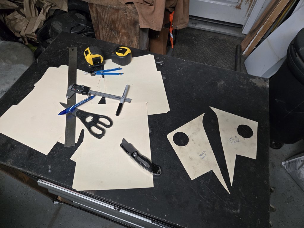

    Arts and crafts time

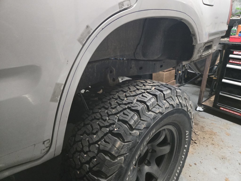

    rear tires, I would maybe relief cut it then just roll it up under with a big ass hammer.
    when I went to 37s I cut and welded the passenger side, driver side I just took what was already done and rolled it up under an extra inch with a hammer.
    I think driver side looks better and it was way easier.
    truth is, I probably clear by a good everywhere in the rear now that it has a rear sway bar, so if you plan to add one you probably don’t need to go wild, but it is nice for peace of mind. I also never notice the loss of flex from the rear sway bar, I love that thing.
    this is the most I see with sway bar, extended durobumps in the rear… no good pics on a forklift with the sway bar lol
    And before sway bar, 35s with 1.75” of offset on a stock axle, they tuck in
    Before sway bar, 37s with 2.75” of offset just eat the fenders. So if you plan on 66+ wms rear this is about what it would look like. It isn’t bumped out yet here, just wedged into the fender and bumper.
