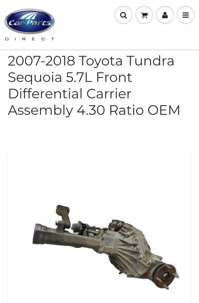

    I'm really interested in the 9 inch Tundra front. Once I saw that Treehouse Phin dude do it to a 1st Gen Sequoia, I knew it can be done. (You're fitting it in the same space, essentially). And he's still wheeling that thing, and building it (He just did rear coilovers not too long ago).

    Thing that steers me away from the 9” is it will either stick out the bottom of the skid or take a significant motor lift. I don’t want a body lift and it gets too tight with the motor pushed up that much. Main limiter is the bell housing, hammering oil pan would be no big deal imo.
    I lifted my motor 2” and lifted the trans maybe .5” (unbolted and let it pivot on the duals mount) and this is how it looked, I think I have more pics in my thread and have a bunch more pics and videos if you want.

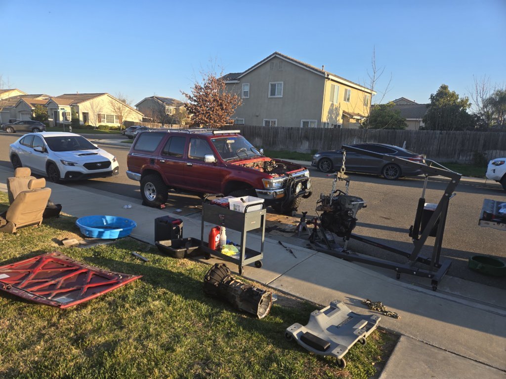

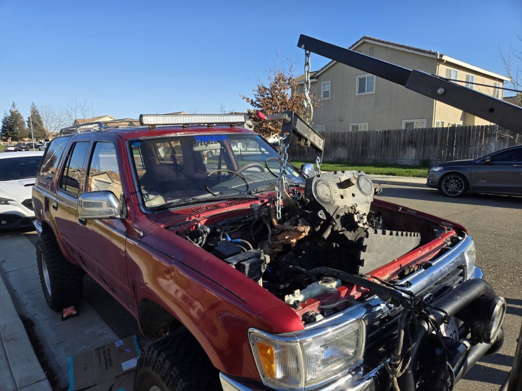

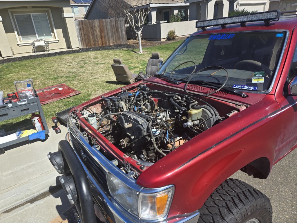

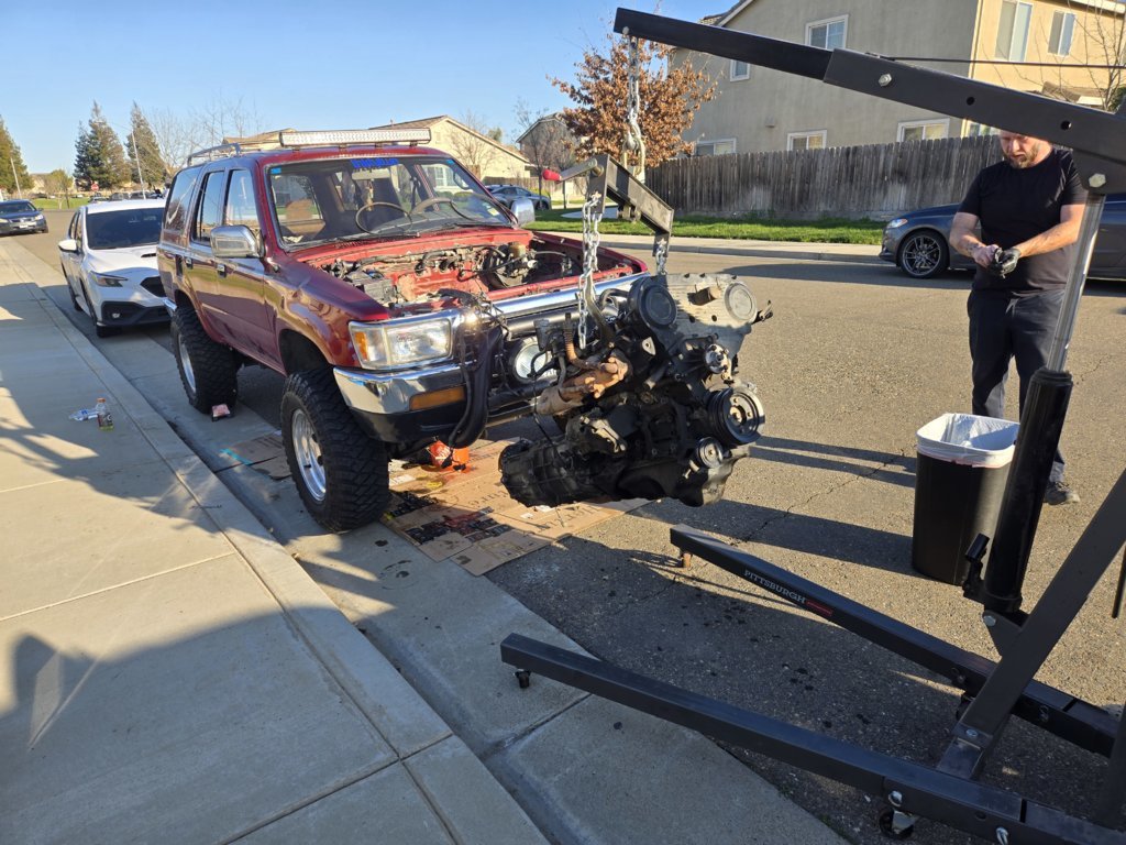

    More pics of today's festivities

    5vz going in?
  12. Mar 9, 2025 at 8:49 PM
    #272
    El Taco Diablo
    El Taco Diablo [OP] Professional Pinstriper
    Nov 6, 2017
    #235223
    13,979
    Matt - KN6DZP
    Hughson, CA
    Impulse Red DC, 5vz-fe, 4wd swap, LT, dual case, F/R locked
    Just 3 tons of fun!!!
    I keep telling him he should. But he ordered a fresh 3vzfe from Yota1. But he's going to do the exhaust reroute. Nick (owner of Yota1) said he's never seen the cylinder 6 issue happen on a 3vz with the reroute done.
    5vzfe would be more powa tho. :burnrubber:
    It's my buddy's kid's project. A Yota1 5vzfe would have been another 2 grand. And he's already doing this motor swap, SAS, and Chevy 63s in back. So, I get the budget. Just glad to be helping them with their project.
    rob1208 and Dalandser[QUOTED] like this.

    I respect the sidewalk engine swap

    I know right? His garage is set up as a gym and his driveway is to much of an angle. So... we just did shit in the street.

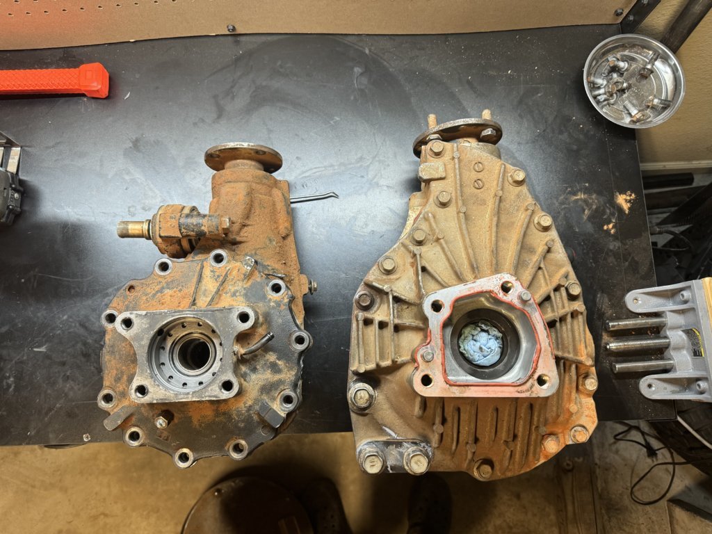

    Yes that is it.
    don’t know what your junkyard situation is but I think I got the diff and CVs for like 150 on a 50% off day, worth checking to see if there are any tundras atleast.
    I did get lucky someone pulled the motor on one though so I just had to pull the diff out of the engine bay lol

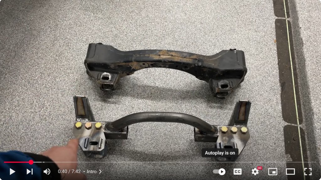

    I was brain storming the front end of this thing all friggen night last night. Kept waking up with ideas. I'm going to brain storm a bit right here.
    First of all. I reached out to Nathan yesterday. What a good freaking dude! He sent me a file with about 1000 pics (no joke) of his build. One of the things he is working on for his race truck (that ties in to this, bare with me) is the front cross members.
    https://youtu.be/1Rt86OpDOGI?si=w-ZIQvBro0ASkNE2
    That thing is BEEF! I want to do that to the T4R AND my Tacoma lol.
    Later on in the video, he mentions he wants to do something with the rear LCA crossmember as well. But, mentions that is where the steering and rear mount of the diff is located. (I'm not sure if he has made any progress towards that, I haven't had a chance to ask him yet.)
    Now here's where it ties in to the Tundra diff.
    My plan is to pick up a Tundra diff. But I'm ALSO looking at trying to snag a front frame section (Like he's got later in the video) for mock up.
    As stated earlier, I'll be 1 inch body lifting the truck. That gives me 1 inch to raise the motor to get back to the same engine compartment relationship as stock. I could go up another .5 to 1 inch and then have to possibly deal with hood issues with an SC and with engine cage cross over bars. I can deal with that.
    By fabricating new LCA crossmembers, at first I thought, what if I dropped them down .5 inch (basically a mini drop bracket)? But that would change the distance between the UCA and the LCA, and I don't think I want to do that.
    BUT... What if I keep the LCAs where they are and drop the steering rack .5 inch? The only thing I can see that would affect is the rag joint, that would already need to be addressed with the body lift, and the steering link angles. It would actually put the steering link angles closer to the stock angle anyway.
    Am I missing something?
    I can see where this would add a LOT of work here, but I'd rather do it now, than have to tear everything apart again later.

    I love how he makes the ears a replaceable part.
    But I question the need to go all the way to making that 1/4 inch 4130. I think that's overkill. I'm thinking normal mild steel would be fine there. It would be WAY more cost effective and also WAY easier to deal with (welding perspective). I also think the ears can be removable, but they should be removable in an assembly (front and back ear together) because they should have a plate of the side facing the inside of the truck. (Making that assembly three sides, if you will).

    if you drop the steering rack it would change bump steer some because you are moving the centerpoint of the arc that the tie rod travels in, probably wouldn't be anything crazy but it would change it.
    I forget the reason why he is beefing up that crossmember so much... I have taken some fucking hits and mine still looks ok. I also feel like the rear LCA bolt sees more force than the front.
    also worth mentioning since it seems like you are serious about this... I would 100% ditch add and just shorten the tundra shaft to spline straight into the diff. Weak point of the tundra diff is the add stub, it necks down a ton compared to the jackshaft. You could get a custom one made, but I think you could just send the existing jackshaft to dutchman or similar and they could shorten as needed and re-spline the end to go straight into the diff.
