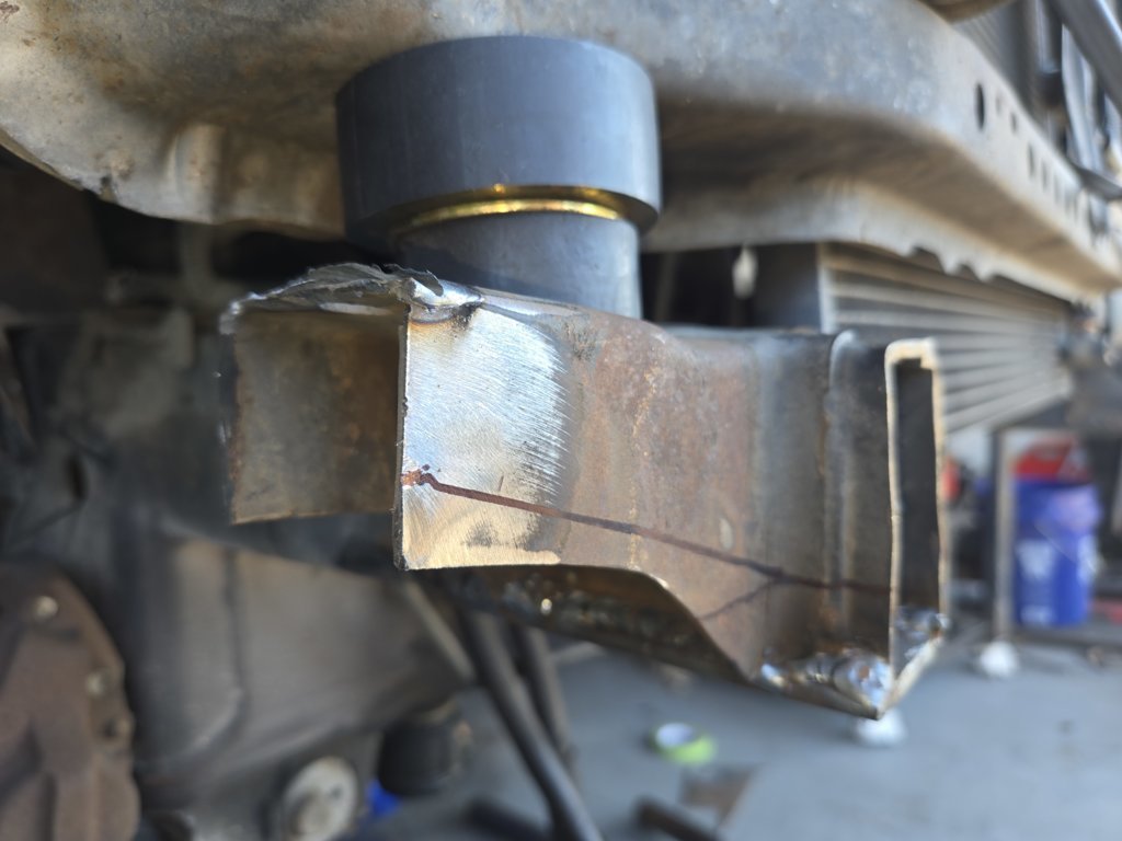

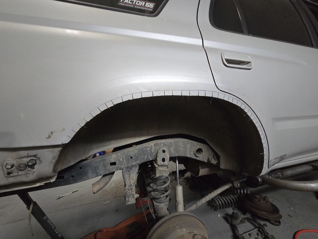

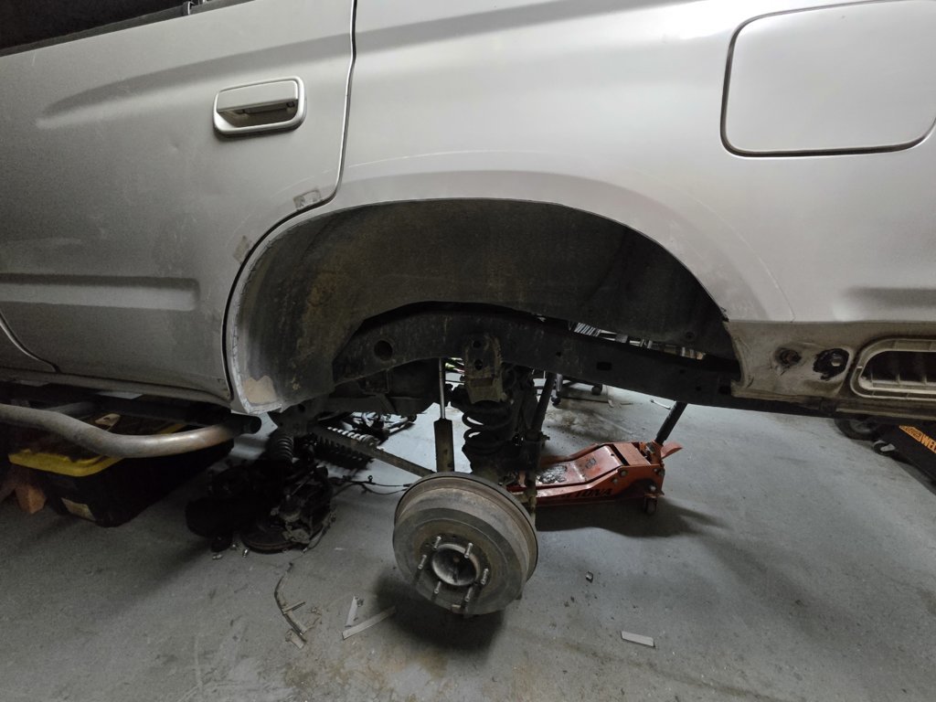

    Didn't get a lot done, but chipped away at it a little this evening. Pulled the bumper back off after I marked locations I need to cut the frame and body mounts to.
    Also mounted the power steering cooler, and pulled the radiator. (Radiator would have been in the way when I'm making the frame cuts).
    Also turned the body mount bolts so the excess thread is up, out of the way, when I re-mount the bumper.

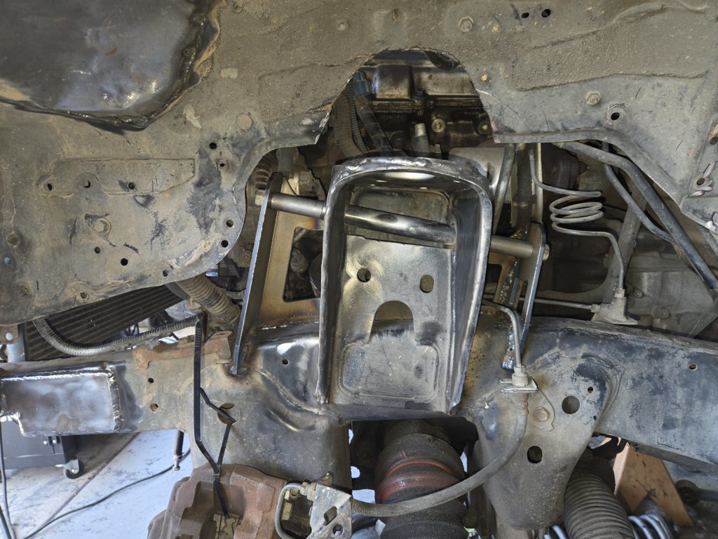

  7. May 9, 2025 at 6:50 PM
    #347
    El Taco Diablo
    El Taco Diablo [OP] Professional Pinstriper
    Nov 6, 2017
    #235223
    13,969
    Matt - KN6DZP
    Hughson, CA
    Impulse Red DC, 5vz-fe, 4wd swap, LT, dual case, F/R locked
    Just 3 tons of fun!!!

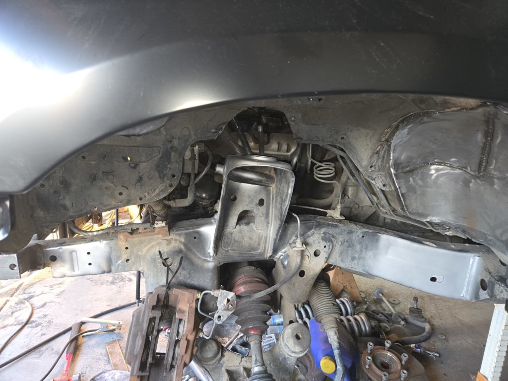

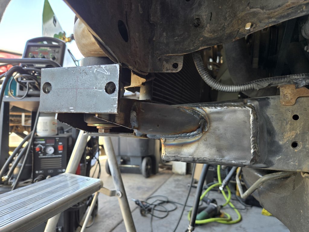

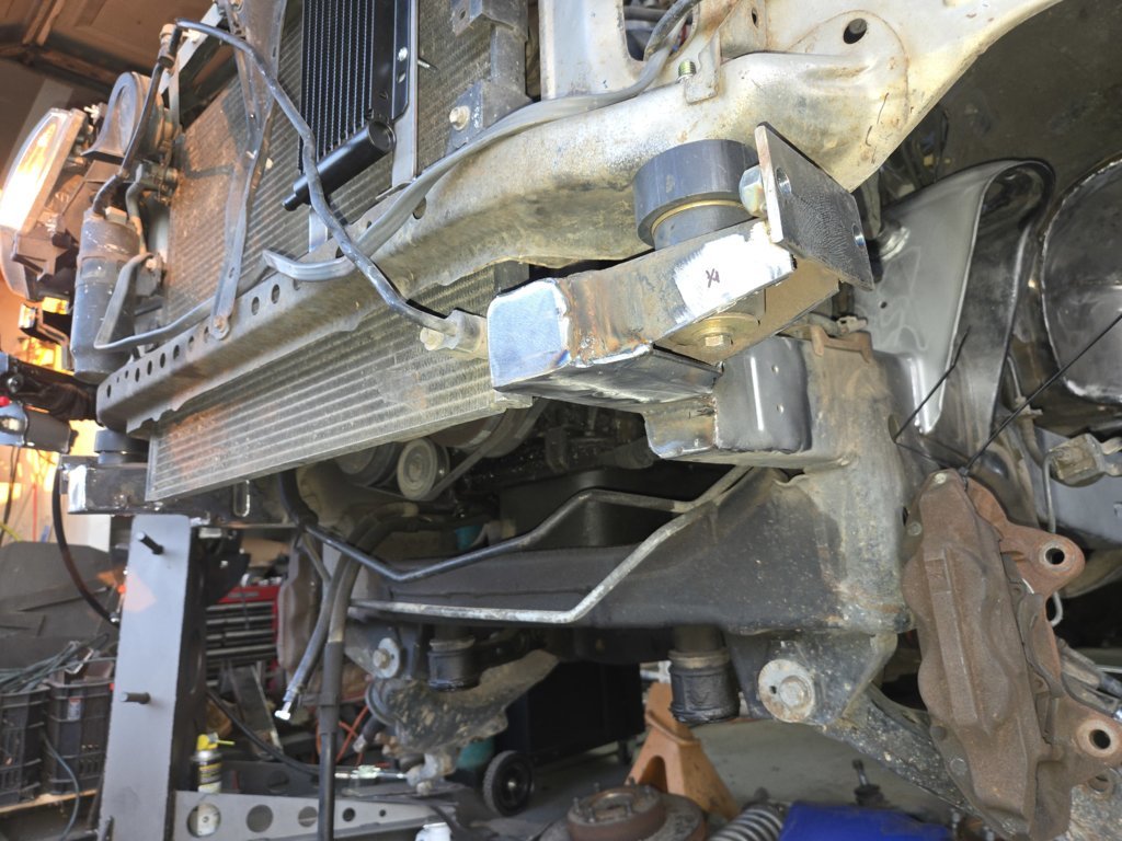

    Frame and body mounts trimmed. I'll patch and reinforce them tomorrow.

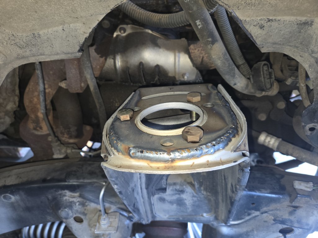

  8. May 10, 2025 at 8:11 PM
    #348
    El Taco Diablo
    Nov 6, 2017
    #235223
    13,969
    Matt - KN6DZP
    Hughson, CA

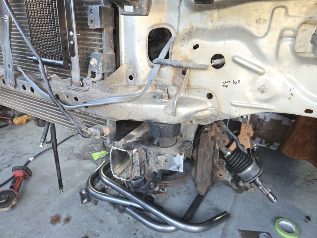

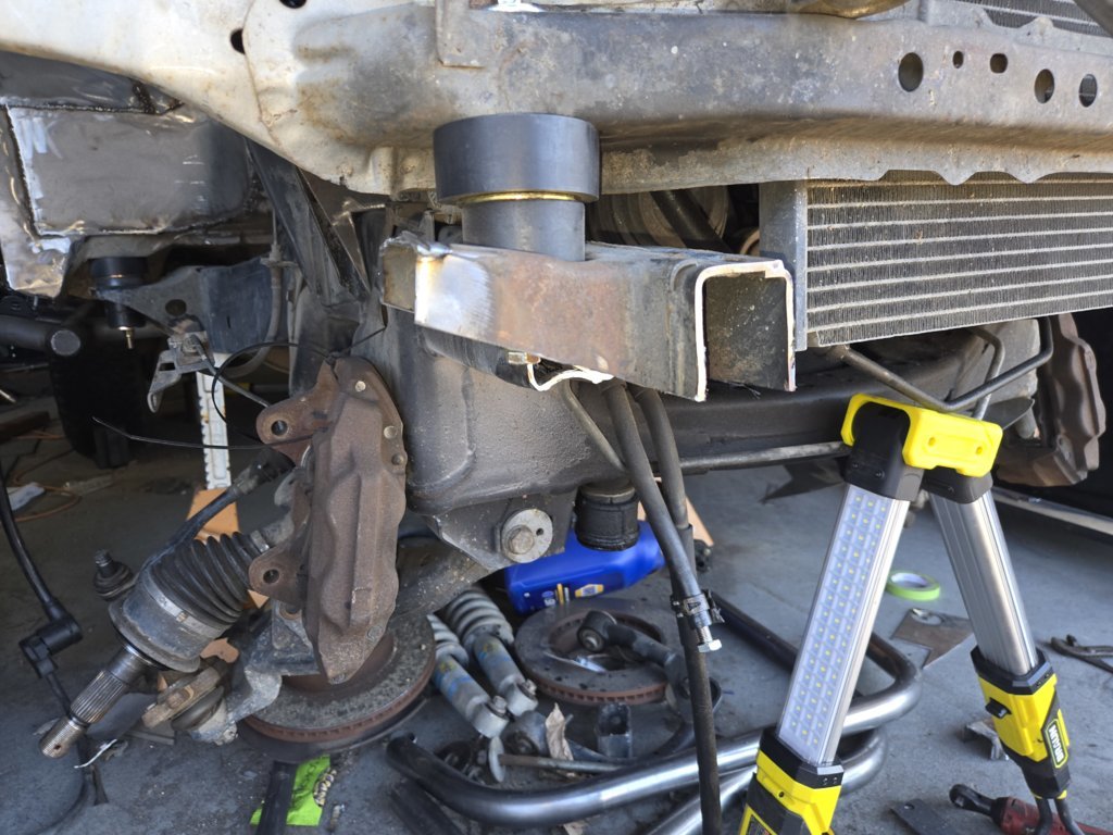

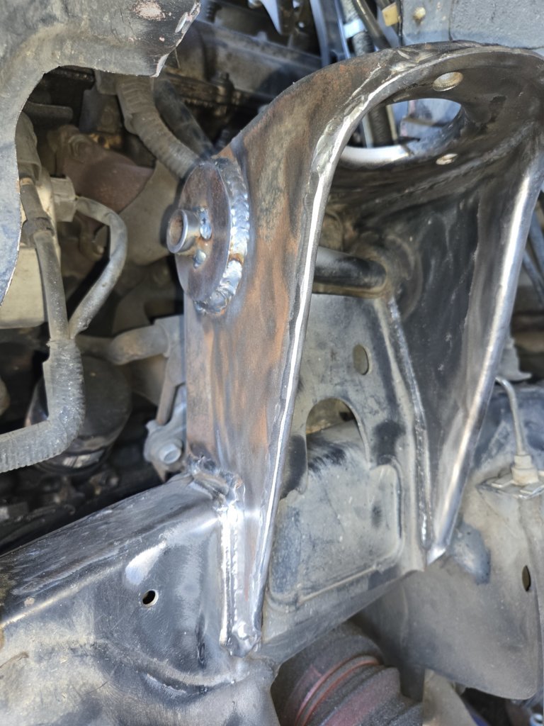

    Doesn't look like much. But it was a LOT of f'n work.
    Blue Canary likes this.

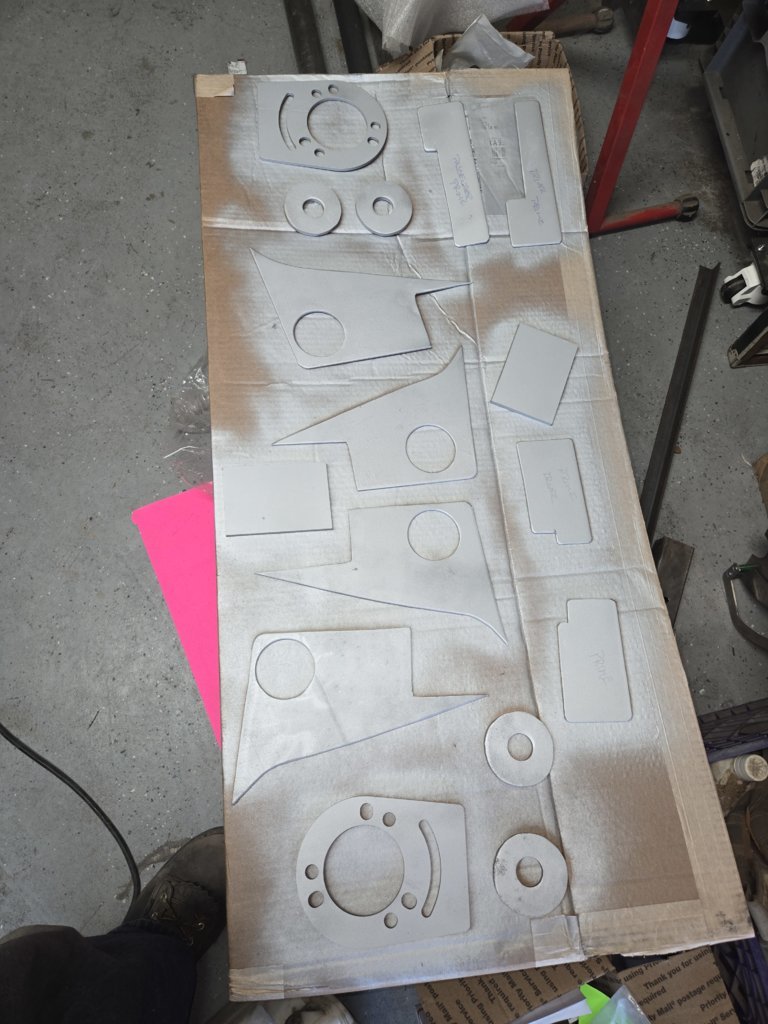

  9. May 11, 2025 at 11:25 AM
    #349
    El Taco Diablo
    Nov 6, 2017
    #235223
    13,969
    Matt - KN6DZP
    Hughson, CA

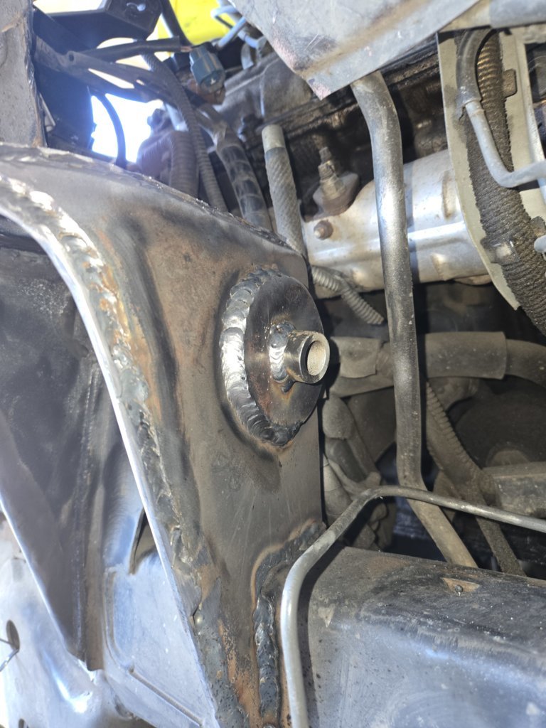

    I've never messed with weld through primer before. Don't really like it. Makes for dirty welds with lots of spatter... But, it is, what it is.
    Progress being made.

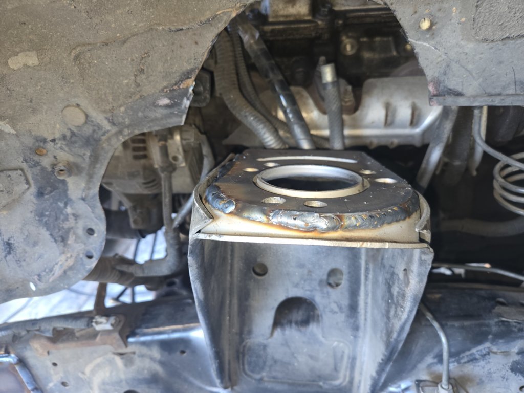

  11. May 11, 2025 at 4:47 PM
    #351
    El Taco Diablo
    Nov 6, 2017
    #235223
    13,969
    Matt - KN6DZP
    Hughson, CA
    Driver side UCA Double Shear = done

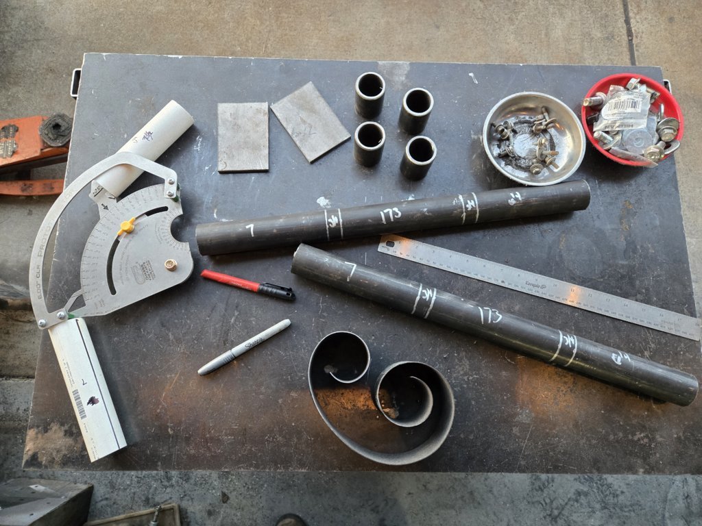

  12. May 11, 2025 at 8:06 PM
    #352
    El Taco Diablo
    Nov 6, 2017
    #235223
    13,969
    Matt - KN6DZP
    Hughson, CA

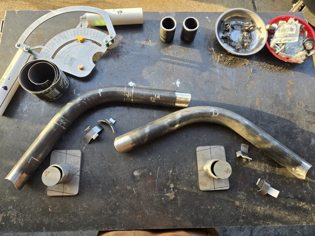

    Bypass hoops are marked, and ready to bend.
    But that's a wrap for today.

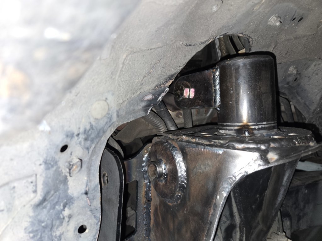

  13. May 12, 2025 at 8:14 AM
    #353
    El Taco Diablo
    Nov 6, 2017
    #235223
    13,969
    Matt - KN6DZP
    Hughson, CA
    I have to say. The UCA Double Shear/Coil Tower Reinforcement from @TOTAL CHAOS is MILES better than the Solo Motorsports version I put on my truck. It's considerably thicker/stronger.

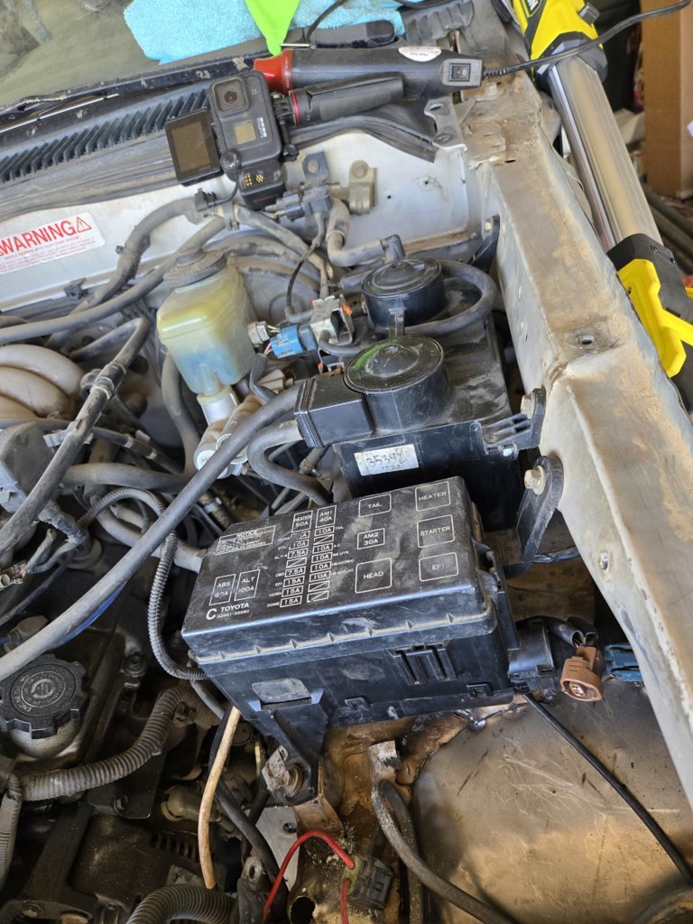

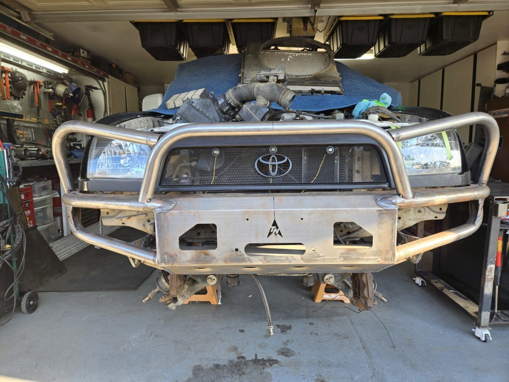

    Completed the fuse box and mounted it back where it goes, bolted down how it should be.
    Replaced the evap canister. All of the mounting legs on the old one were broken.
    Got the bypass hoops fabricated and welded as far as they can be on the truck. Now I can let them cool, then cut the tacks to remove it, and finish welding them without have to worry about things heat shifting around on me when I do the last few welds.
    Then I'll recount them and fully weld the attachment points.
    Did a little reinforcing of the front body mounts just in case (because I had to cut a bit of the bottoms off to fit the bumper).

  16. May 16, 2025 at 5:50 PM
    #356
    El Taco Diablo
    Nov 6, 2017
    #235223
    13,969
    Matt - KN6DZP
    Hughson, CA
    Considering I'm dealing with a truck that was wrecked in the front end... and I'm trying to put everything back straight.
    I'd say I nailed it :thumbsup:
    CemenTRDgen and BEAR_KNIFE_FIGHT like this.

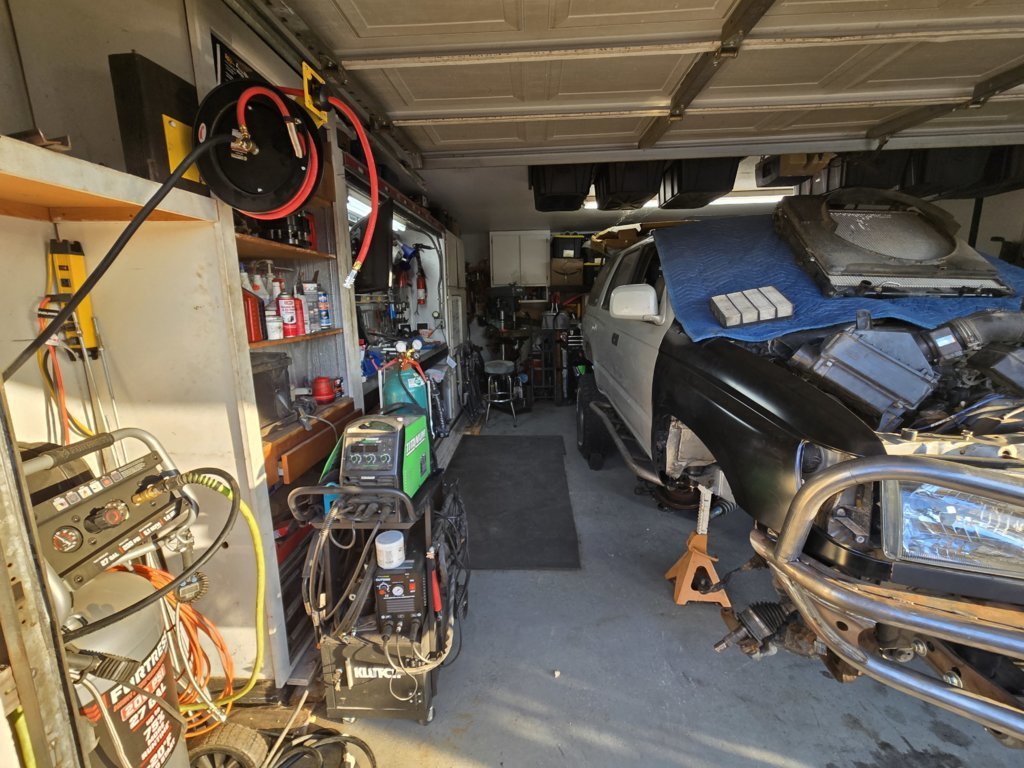

  18. May 18, 2025 at 9:16 PM
    #358
    El Taco Diablo
    Nov 6, 2017
    #235223
    13,969
    Matt - KN6DZP
    Hughson, CA
    In progress
    Here's what it looks like when it's done
    CemenTRDgen likes this.

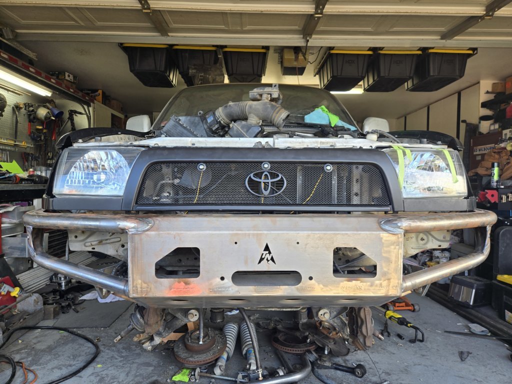

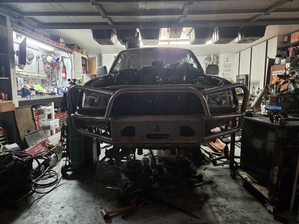

    Here' a better look at the front bumper, in the daylight

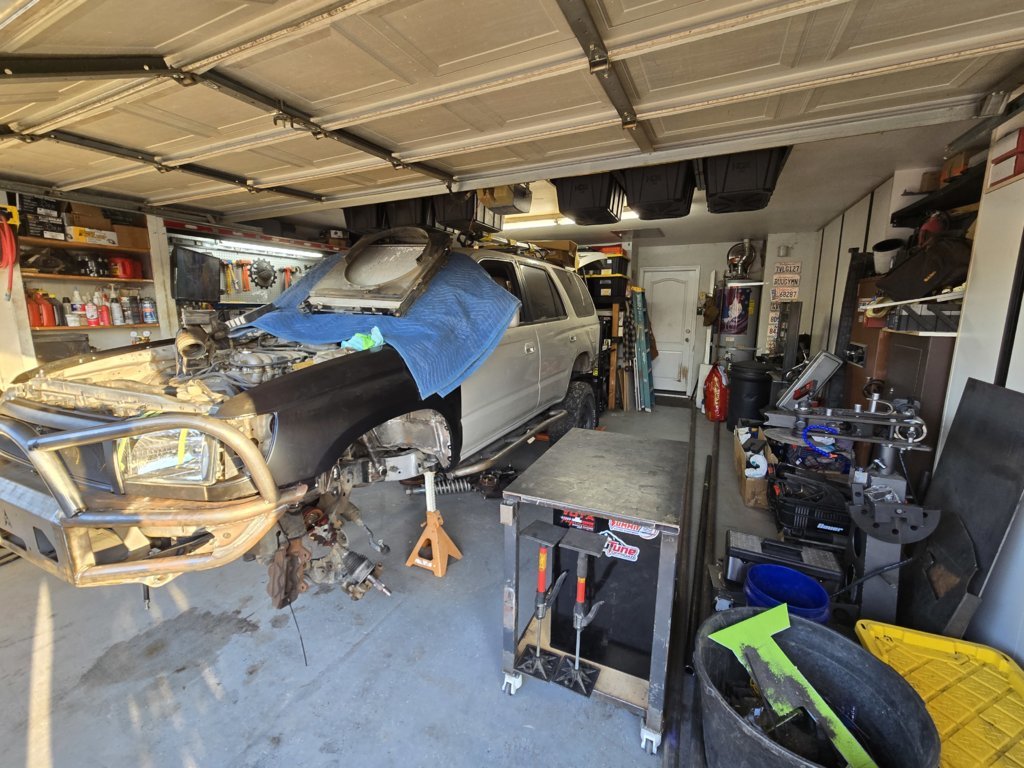

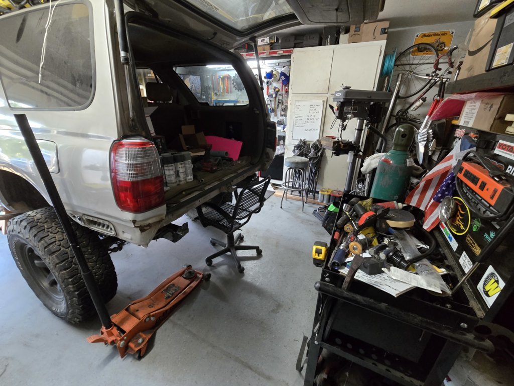

  20. May 18, 2025 at 10:06 PM
    #360
    El Taco Diablo
    Nov 6, 2017
    #235223
    13,969
    Matt - KN6DZP
    Hughson, CA
    Got sick of tripping on everything. So, Saturday was spent getting organized again.
