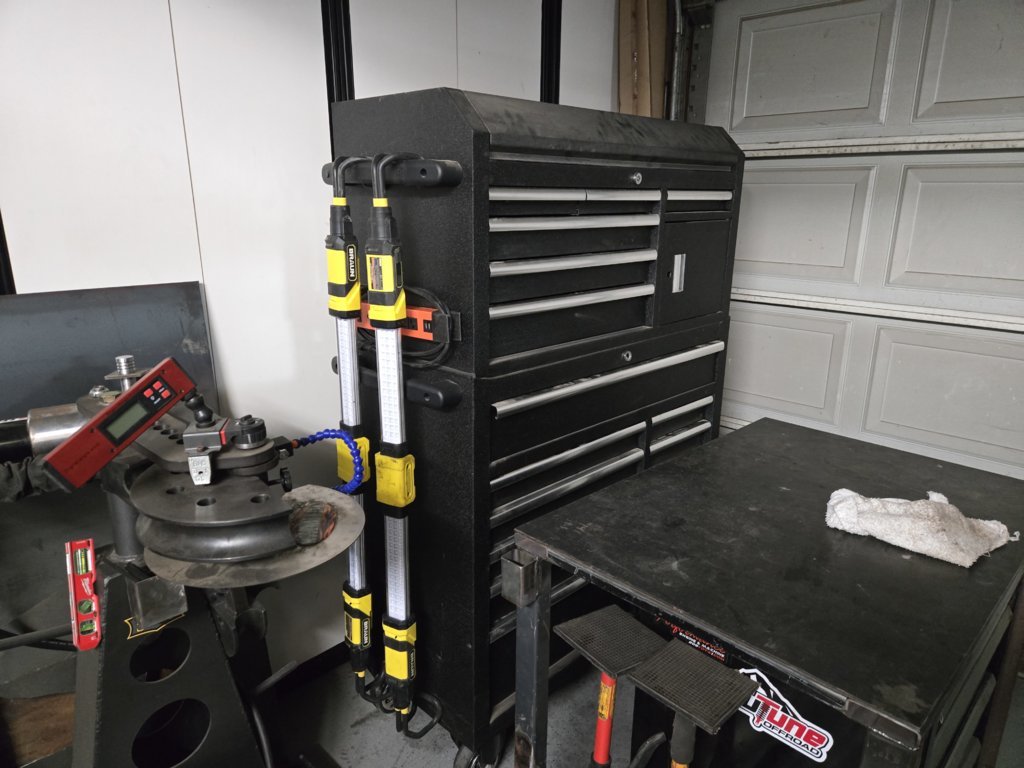

    After having gotten everything cleaned up yesterday. @Pella made a donation to the cause today. This will be a game changer for me keeping organized, and also getting the tools located closer to where I need them.

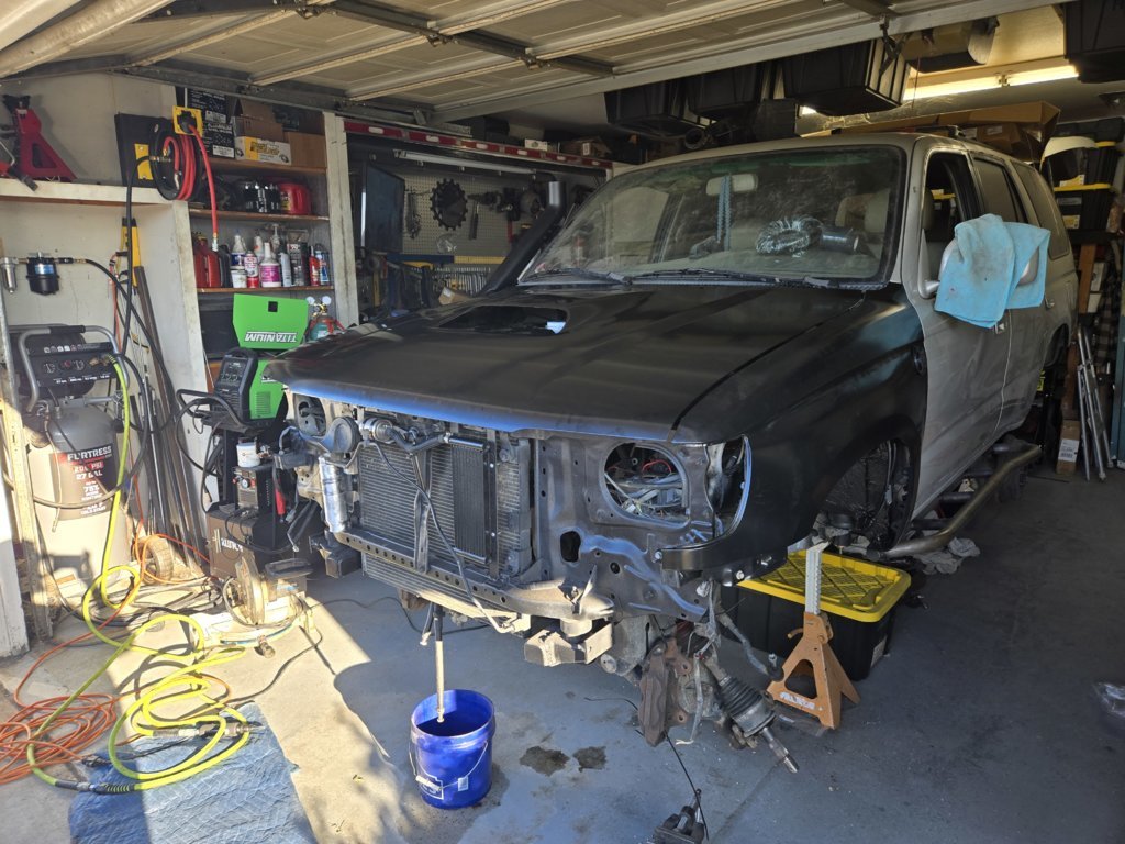

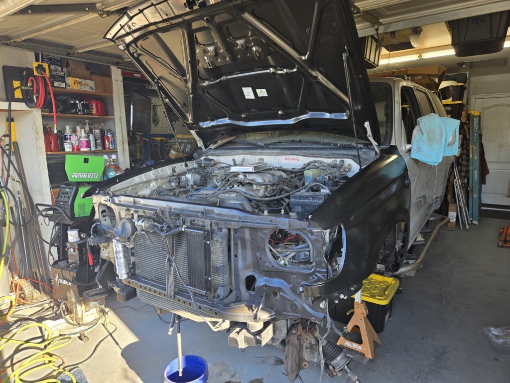

    Finger painting is fun

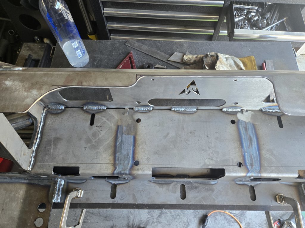

    20250524_193101.jpg More new stuff

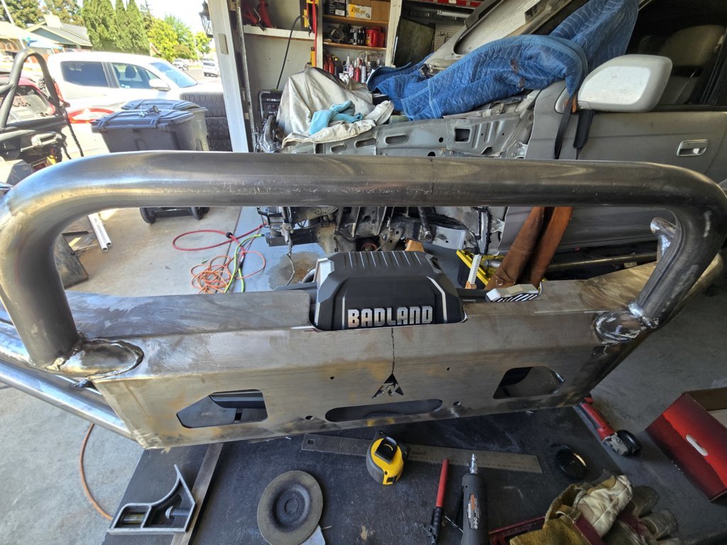

    And bumper is fully welded. I'll be cleaning it up to start painting tomorrow.

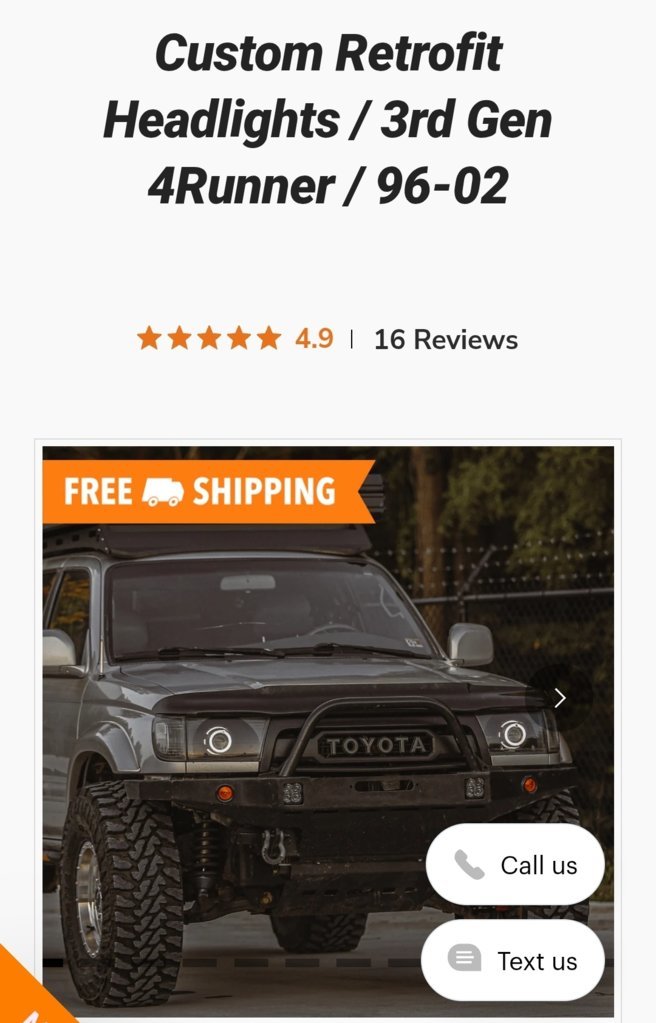

    Headlights and corner lights are ordered, and on the way. :thumbsup:

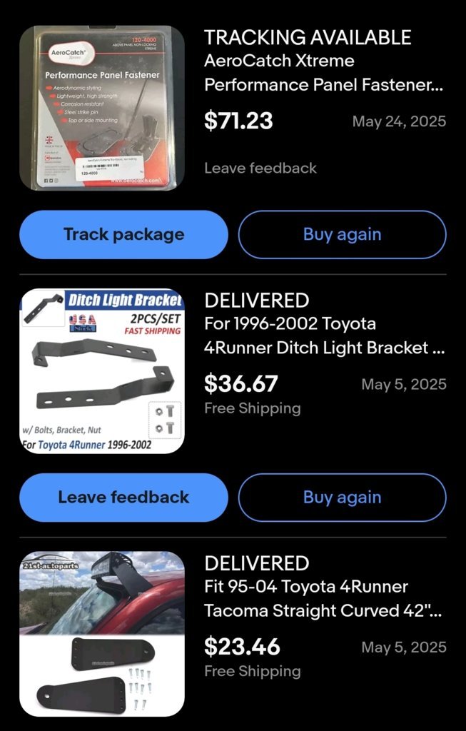

    Light bar bracket and ditch light brackets arrived.

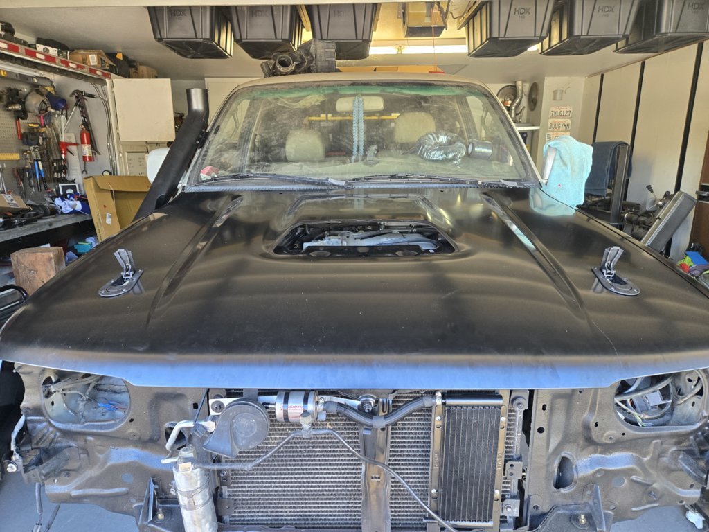

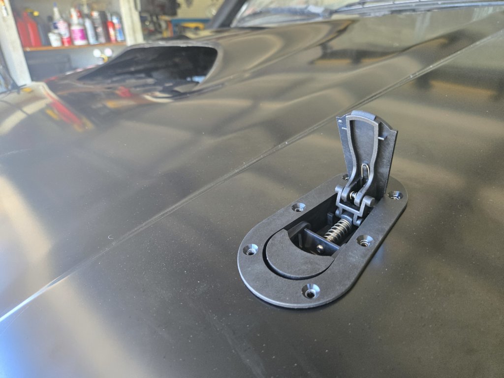

    Hood latches should be here some time this week.

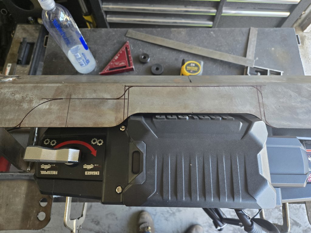

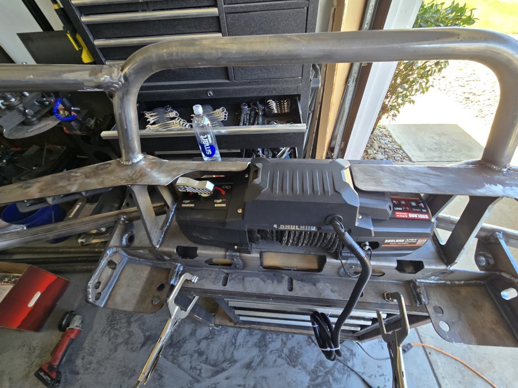

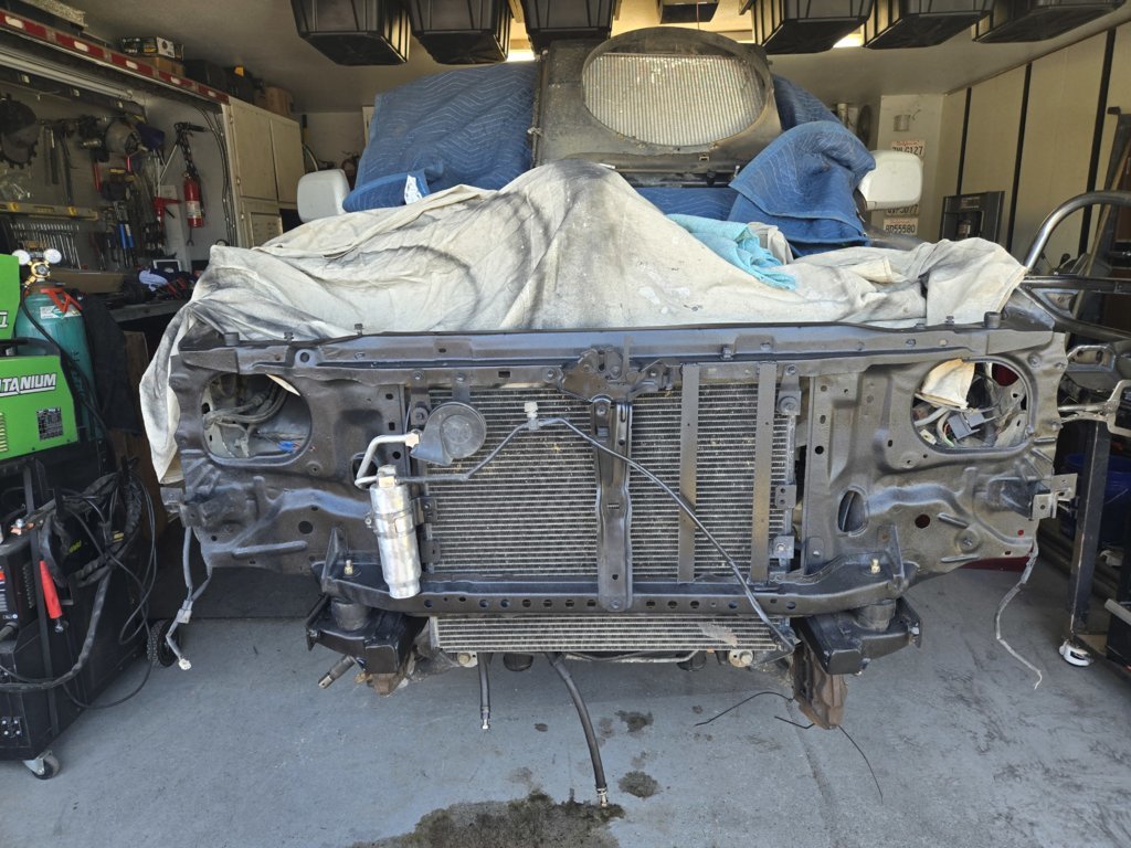

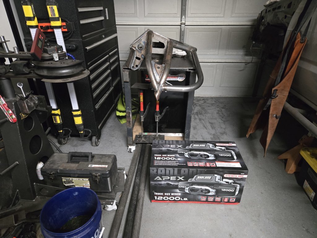

    Took a little fitting, to make the winch fit.
    20250525_125109.jpg 20250525_131202.jpg 20250525_142053.jpg 20250525_142115.jpg

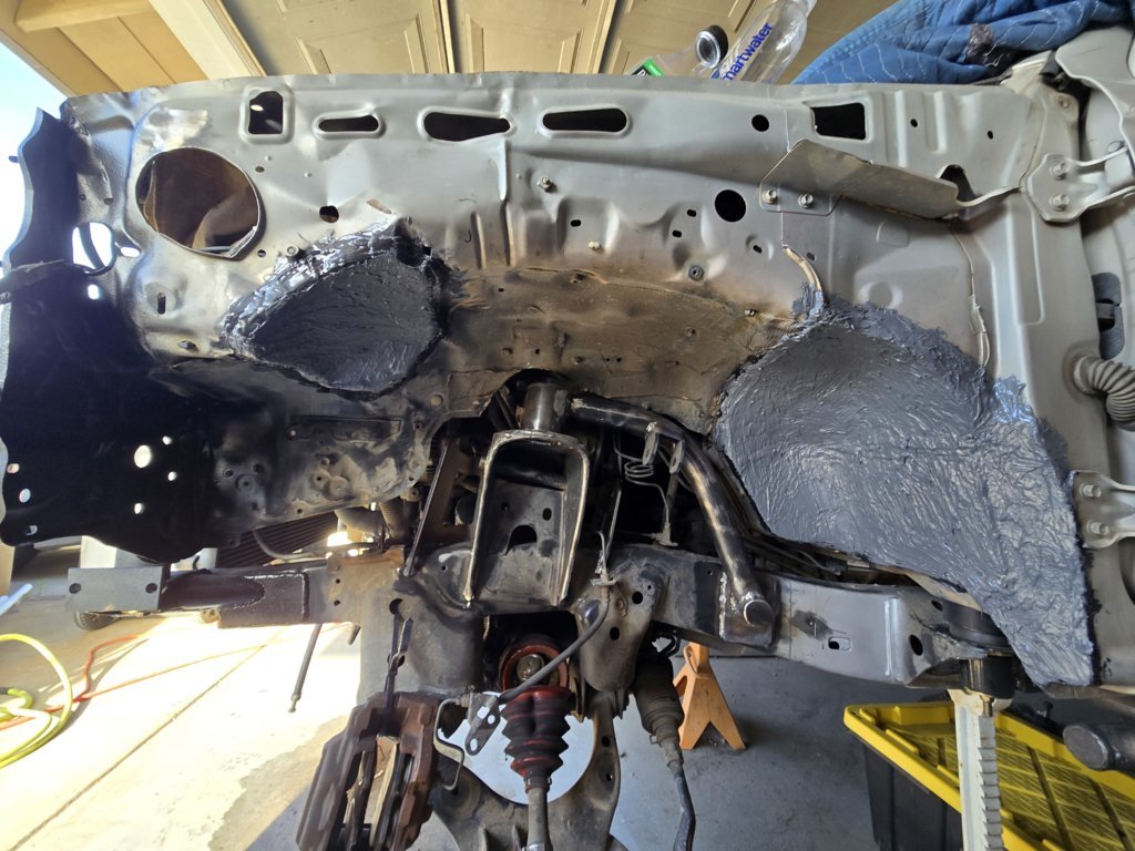

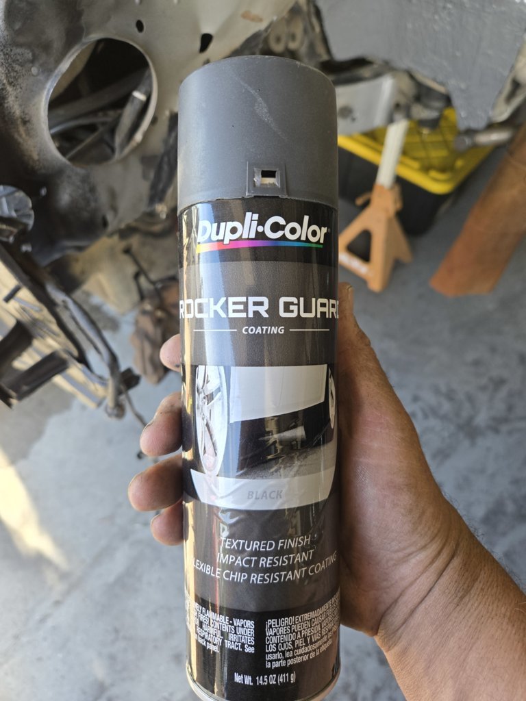

    Painted the entire core support with Rocker Guard paint. It's slightly textured, goes on thick, and stays a little flexible. Shouldn't have many problems with it chipping.
    Black behind high clearance bumper hides a lot. That light gray would have looked dumb.

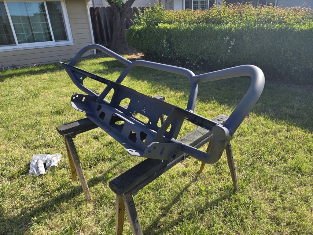

    Cleaned up the bumper and wiped it down with acetone. It has gotten a full coat of (green) self etch primer, and one side of (gray) sandable primer. I'll let this side dry for a bit and flip it.
    Hopefully I can get the Raptorliner on tomorrow and put this part of the project to bed.

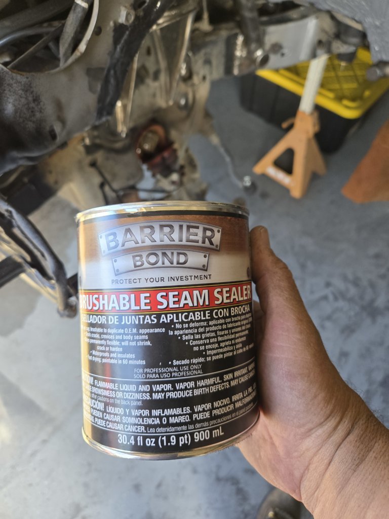

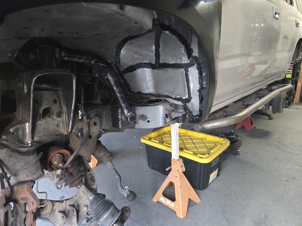

    Applied Barrier Bond to all the pieces of patch metal. If you've never rubbed before, and don't know, it's a good idea to apply a thick, rubberized, product to the bare metal... unless you want to hear all the tings and pings from the rocks getting kicked up and hitting the metal.
    essjay likes this.

    Who else keeps aluminum foil in their paint prep kit?
    Undercoating complete

    Bumper got first coat of Raptorliner. I'll let it sit till tomorrow, then I'll turn it over for final coat on the front.
    Pro tip. Just paint the inside of the winch cradle with good paint. And then just let it get the overspray. That area would take a lot of Raptorliner to cover completely. Paint is cheaper than RL.
