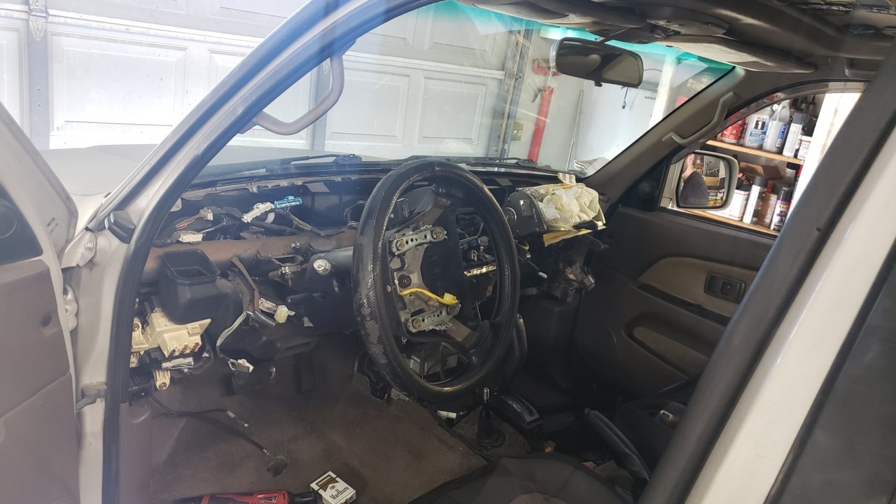

    Awesome! Then we can grab the dash that's being stored by @foxrcing07 and interior will start coming togrther.

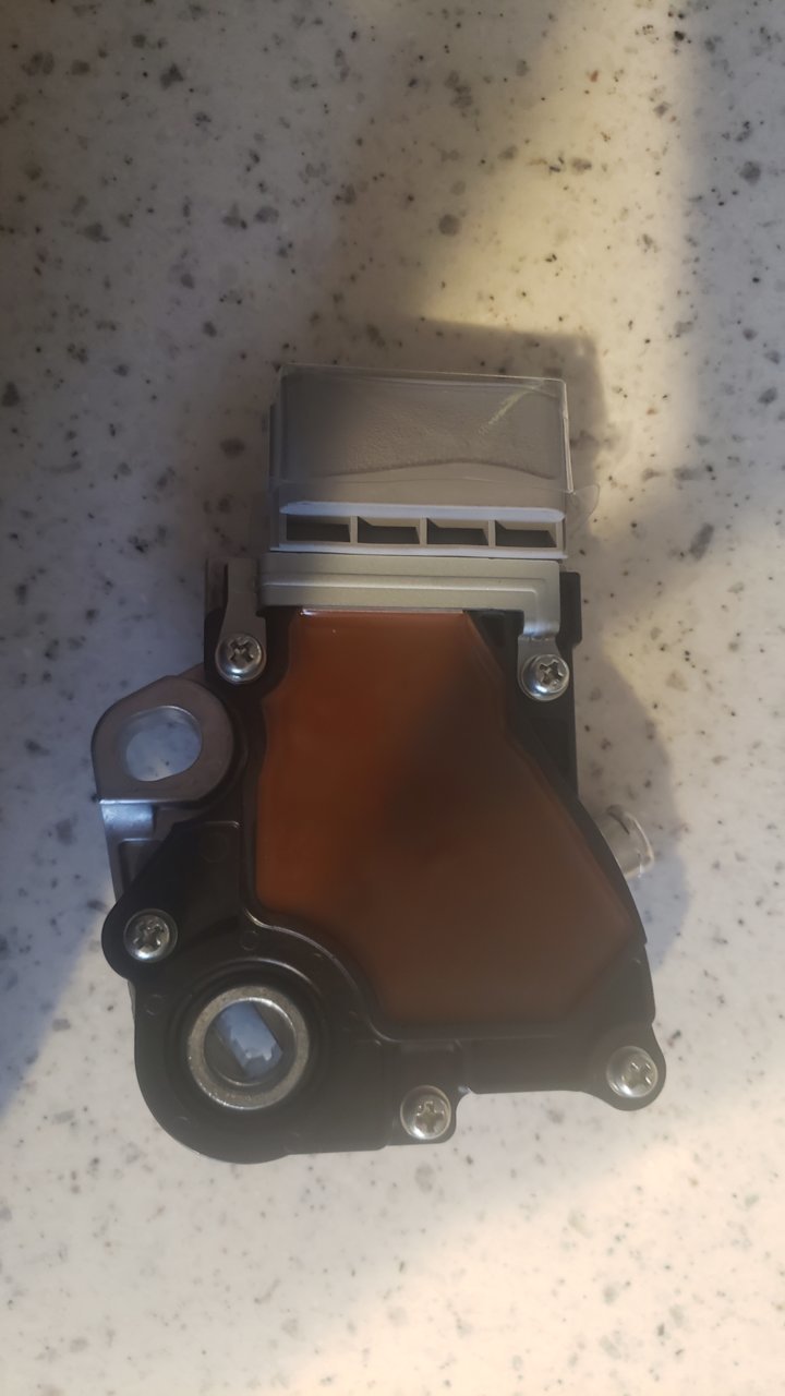

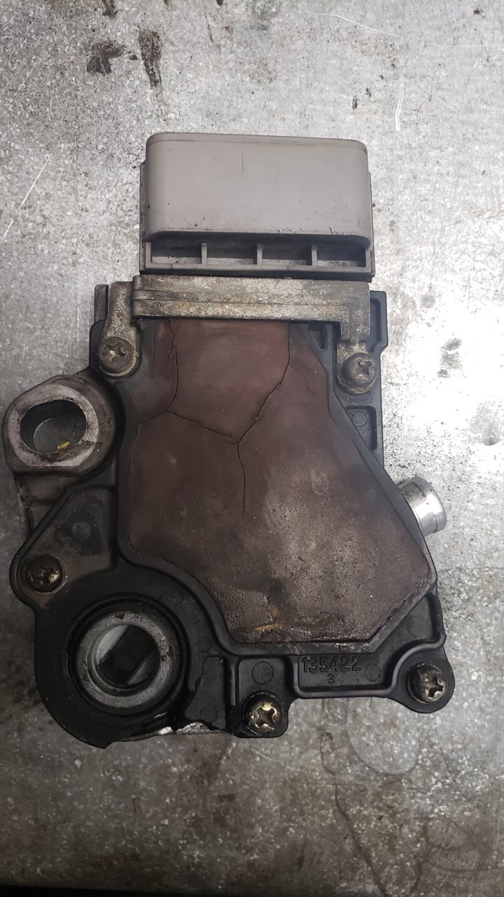

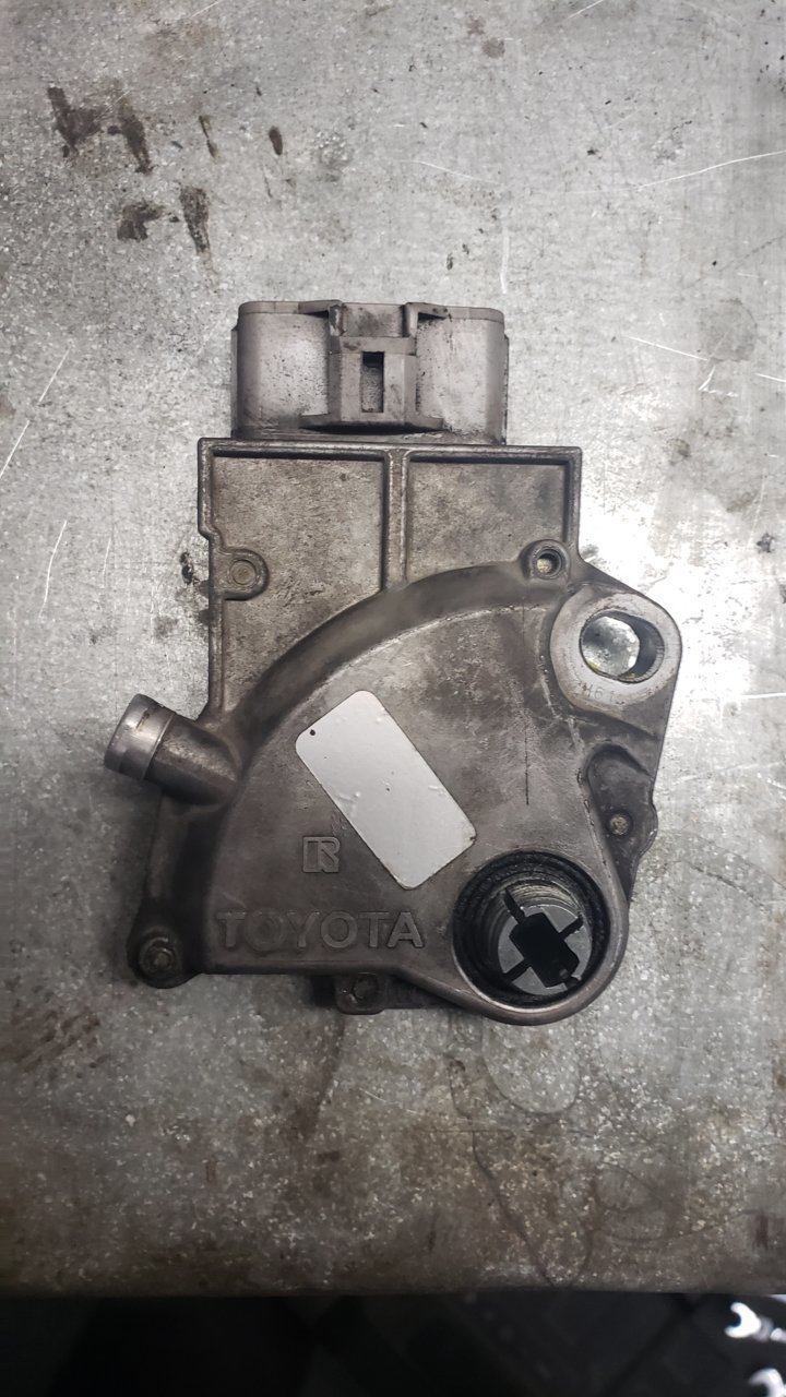

    So, we started having problems getting the truck to start. Figured out it wont start in park but will start in Neutral... classic sign the Neutral Safety Switch is bad.
    We popped it off the trans and found that it was in pretty bad shape. Hopefully that means this was the problem.

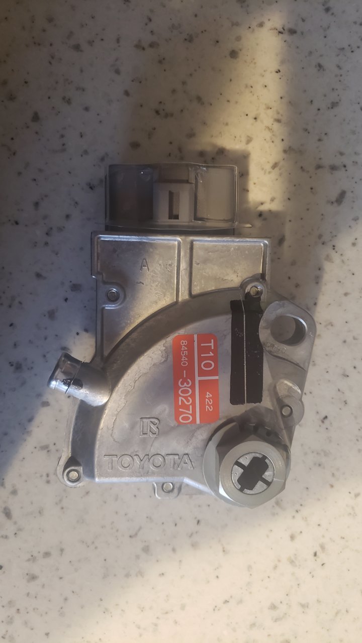

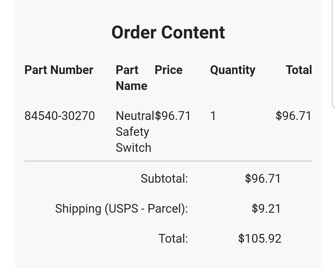

    Went ahead and got a new one on the way.

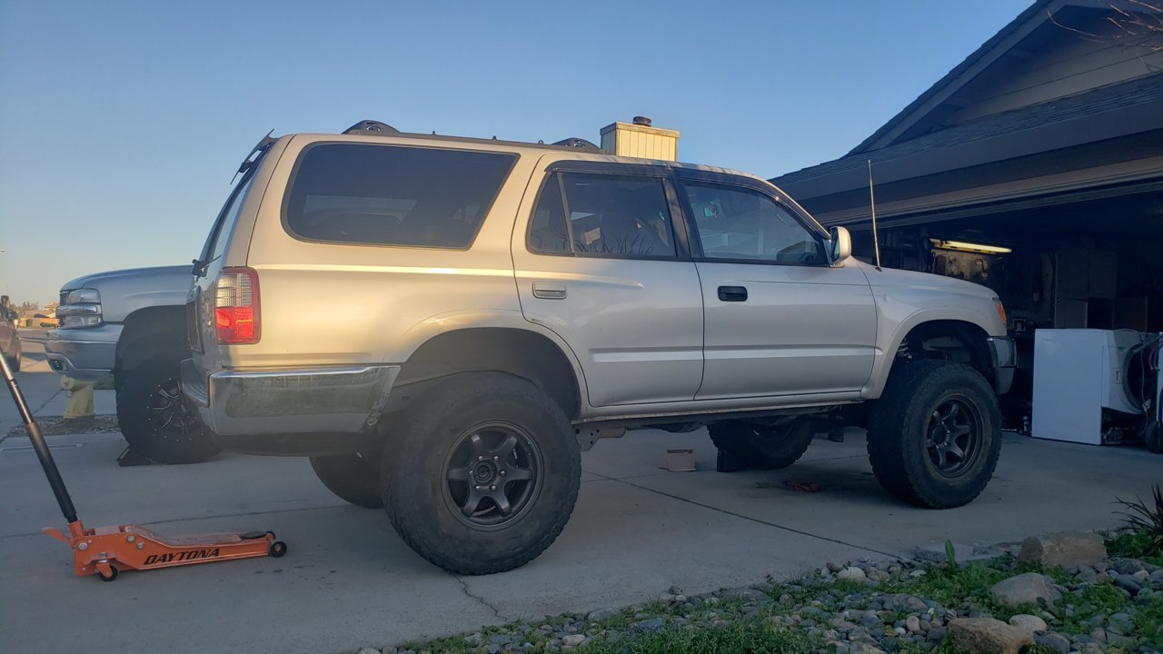

    And in other news... it got some new (used) shoes. Wheels and tires via @MattJakobs... they look beast brotha!

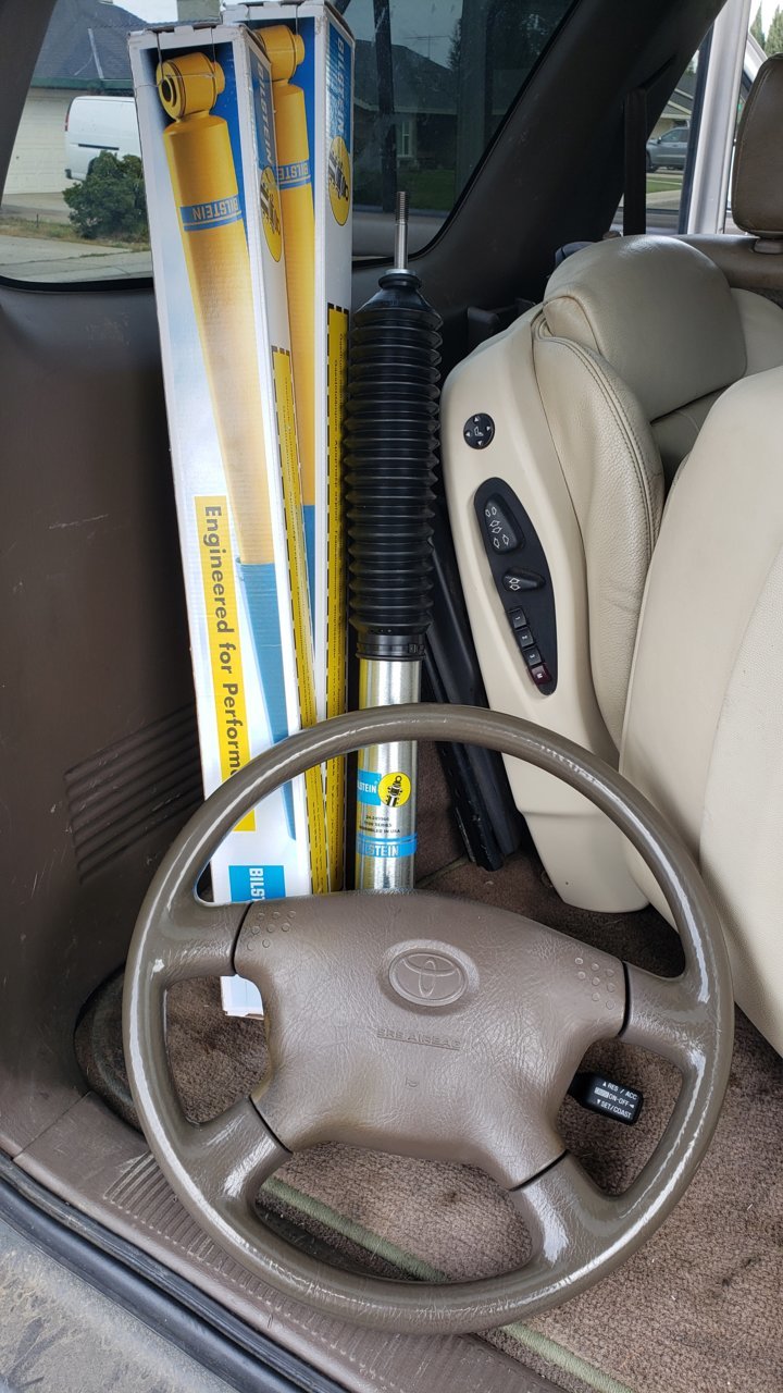

    what did you remove here?
  5. Feb 25, 2020 at 9:00 AM
    #45
    siznarf
    siznarf Everyone my age is older than me...
    Sep 3, 2016
    #196375
    2,930
    Francis
    Kommiefornia
    08 Taco
    91 Octane
    I have the steering wheel
    rob1208 likes this.

    So we fixed the problem with no start in park. The Neutral Safety Switch arrived and solved the problem.

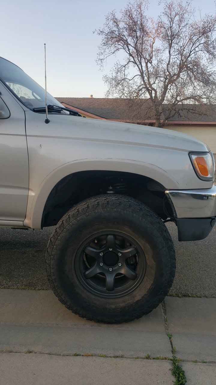

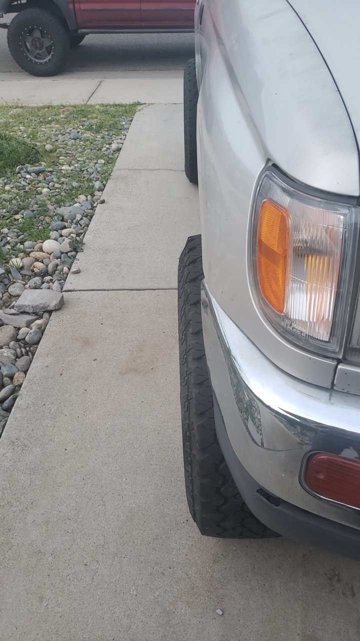

    We also finally made it to the alignment shop, and got everything squared away. SPC UCAs are now at their recommended neutral setting. LCAs are pushed outward and with a bit of positive caster (not maxed, but good) to pull the tire away from the pinch weld a bit. For now the tire looks like it may be a bit close to the bumper valance, but a Trail Gear bumper is in the works so that issue will be solved. (If the tire rubs the bumper valance before a new bumper happens, the valance is going to get a hair cut)

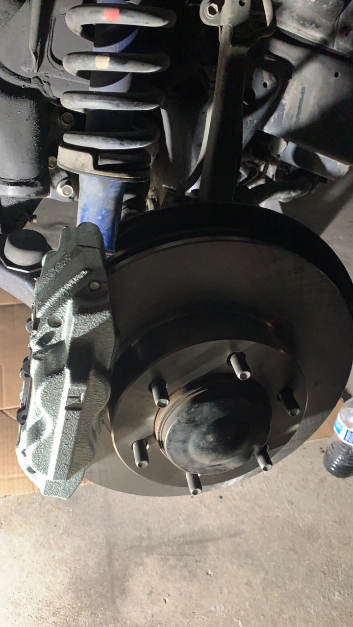

    @siznarf came by and we did some brake stuff on his T4R. Also mounted some Eibach 620# coils on his 5100s.
    And he brought us some goodies. :thumbsup:
    Steering wheel by from @Taco pelado. by way of @rob1208 :thumbsup:

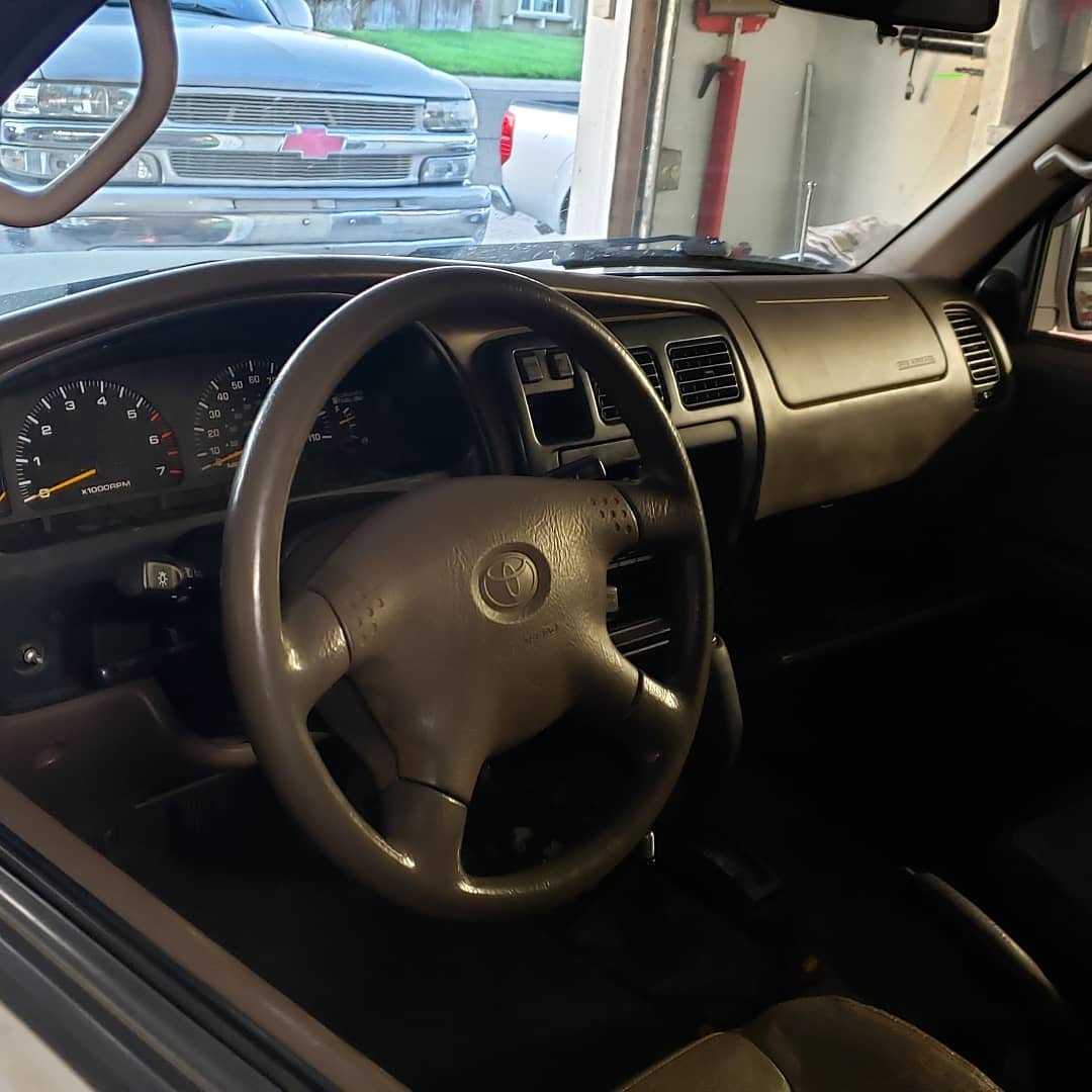

    Made a bit more progress this evening. Replaced the dash, steering wheel, and both air bags.
