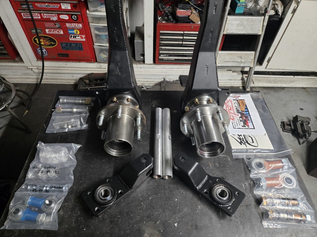

    Working having a friend pick these up for me.
    4x Innovations. Same as what's on the Taco. They have done very well for me.

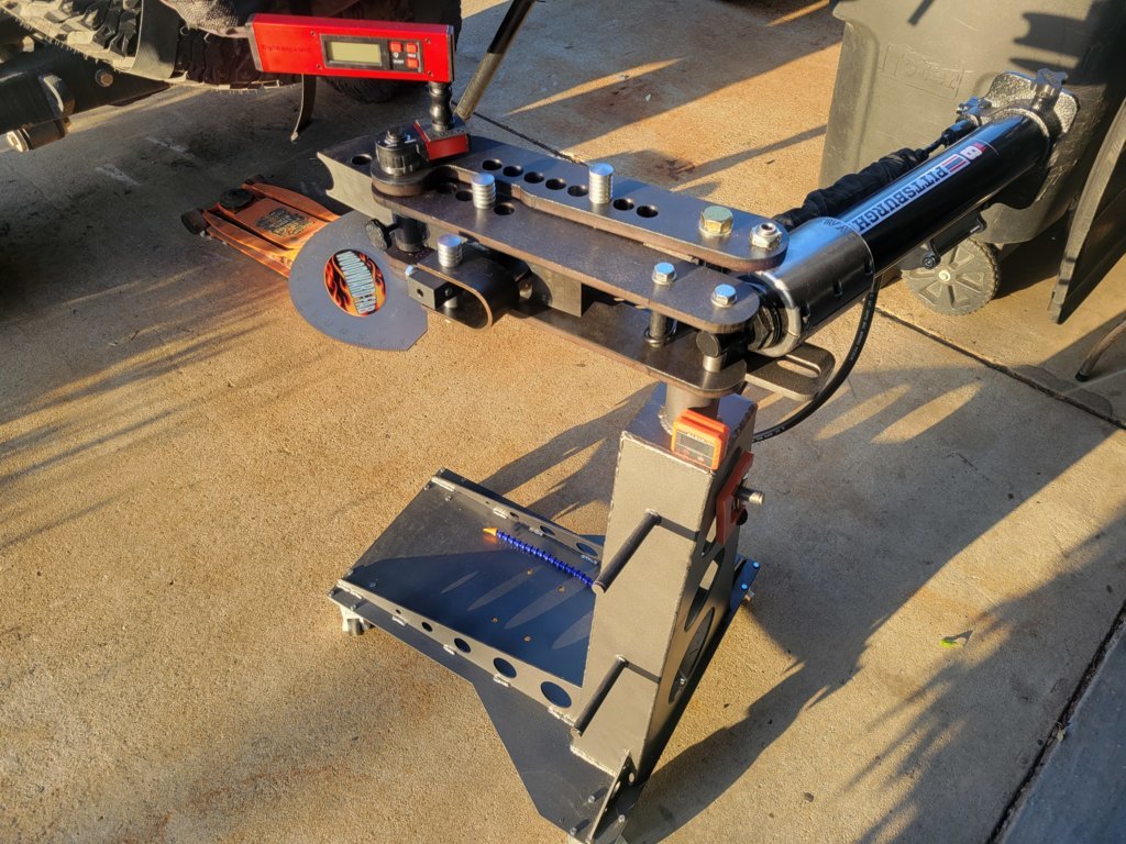

    which bender/notcher do you have?

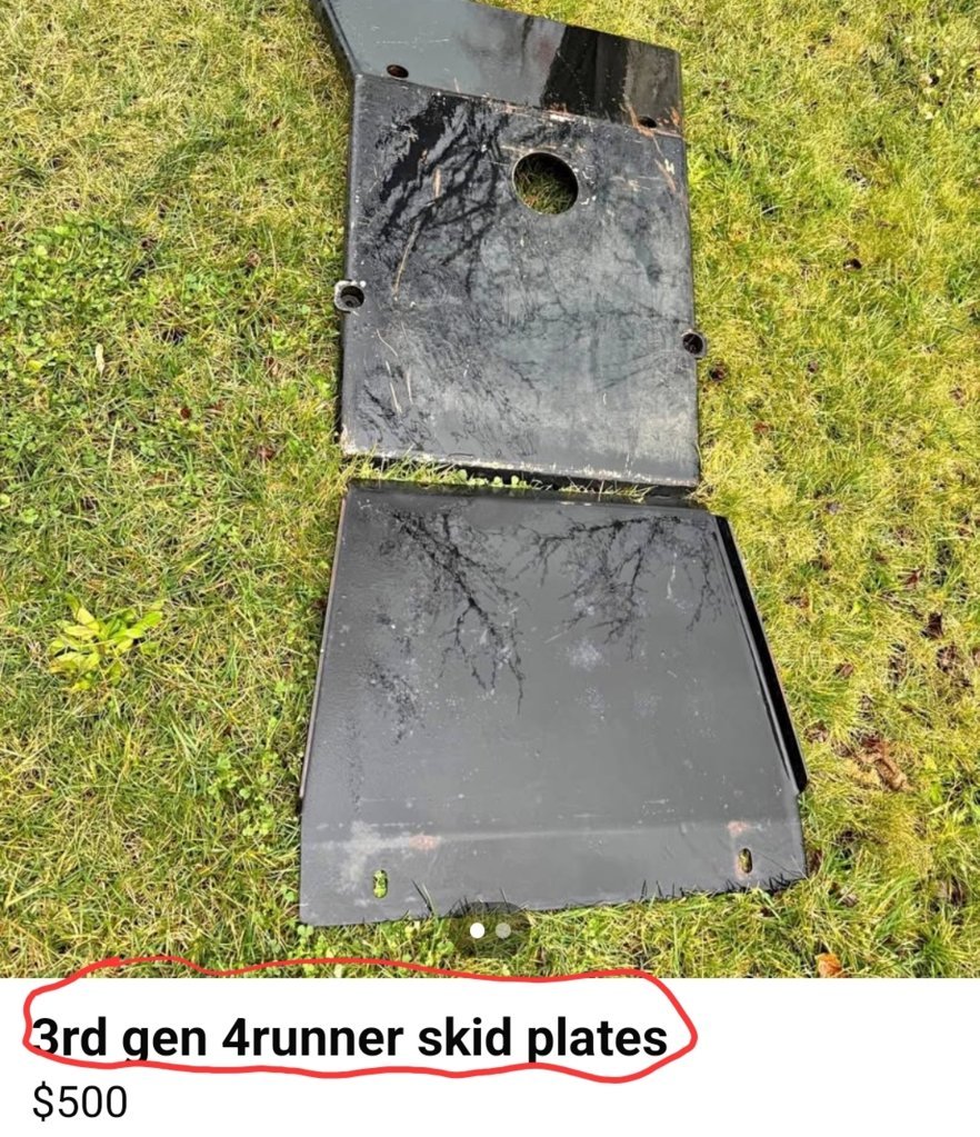

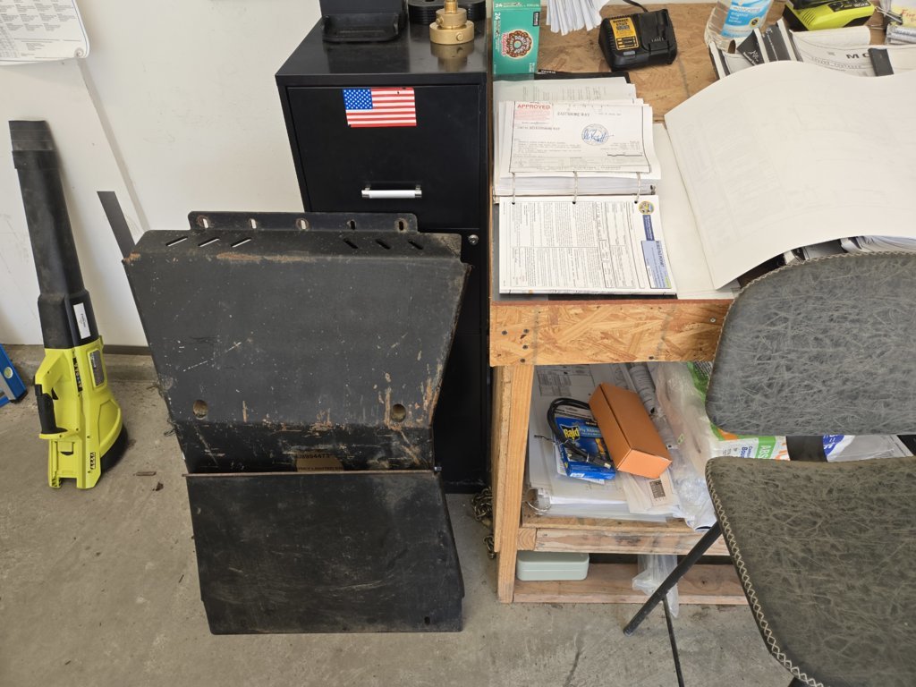

    Parts already showing up. Buddy picked up some skid plates for me and brought them to work.
    4x Innovations. The same as what I have on the Taco, so I know they do what I need them to do :thumbsup:

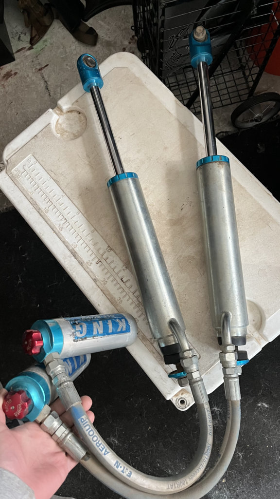

    Let me know if you guys are interested in these and I'll make you a good deal. I know you're not a king fan but they're just sitting in my garage
    IMG_2718.jpg IMG_2715.jpg .

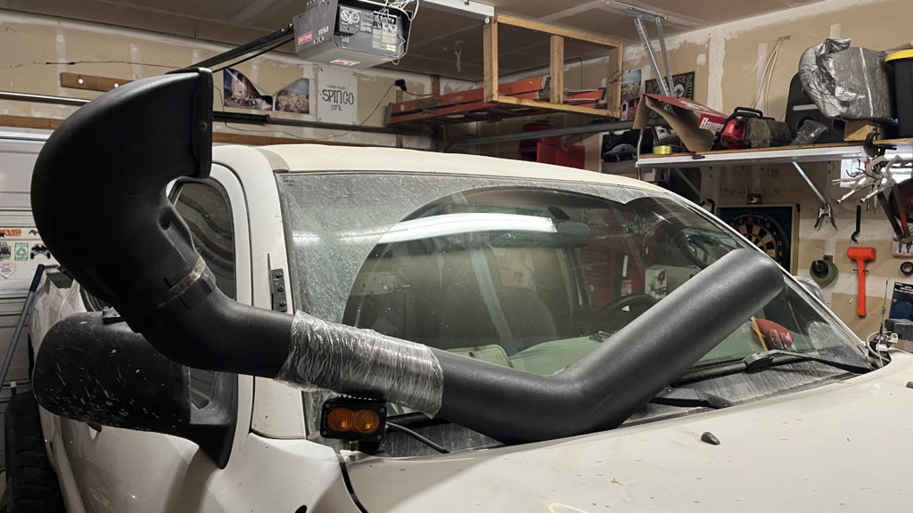

    If you think you can make it fit you can have the snorkel.
