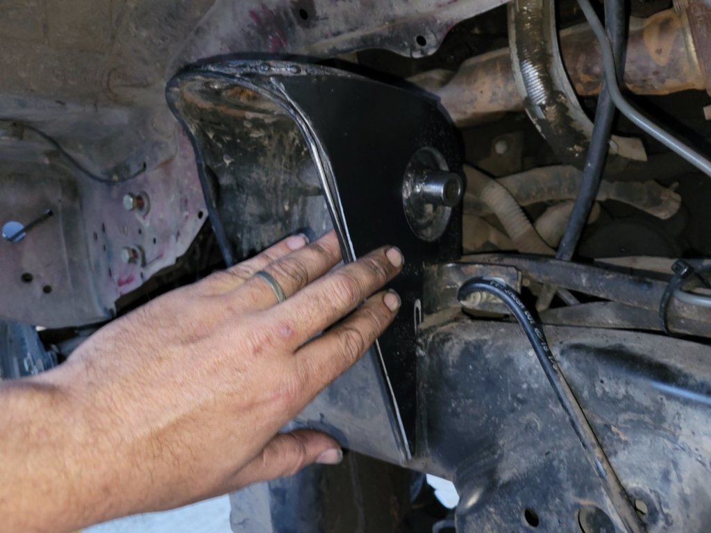

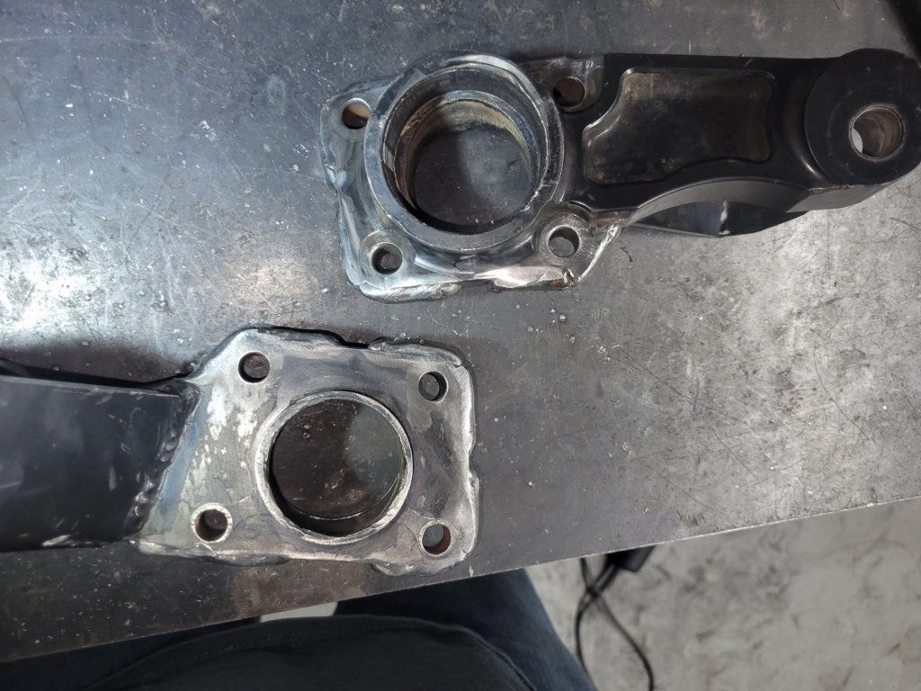

    Between those reinforcement plates and the UCA double shears...
    I'm remembering how much of a PITA all this is going to be.
    The motor may be coming out of this thing, before I get going to far.

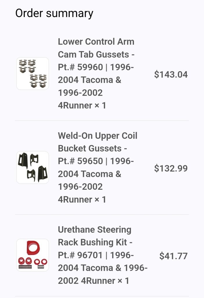

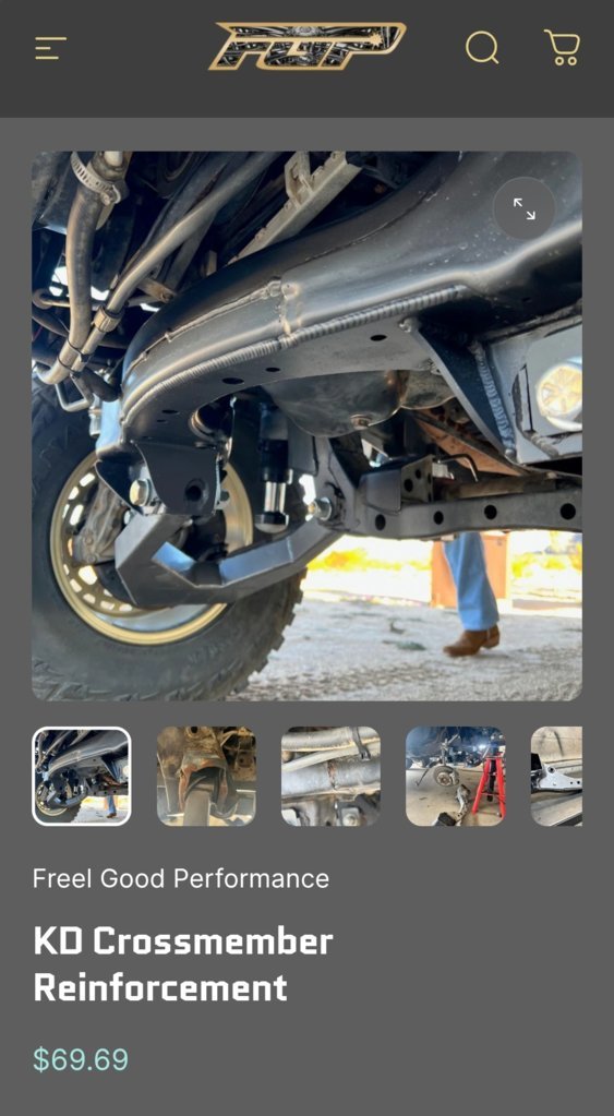

    Ordered a crossmember / control arm mount reinforcement kit.
    I've never seen this one. I may have to order one of these kits for the Tacoma too.

    Ordered a few things from @TOTAL CHAOS while I was at it.

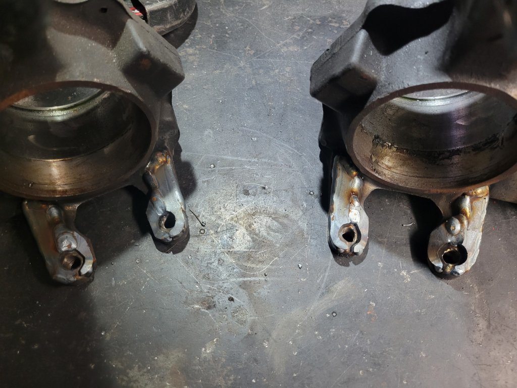

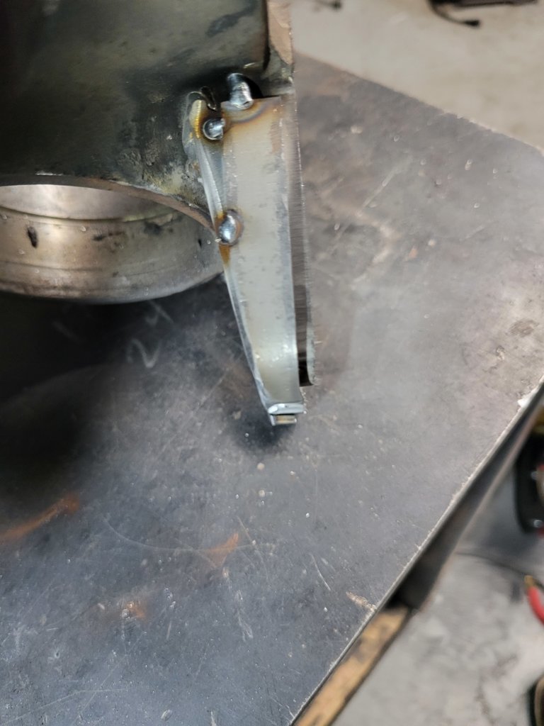

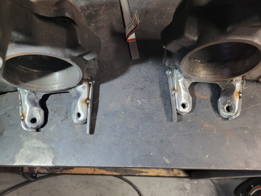

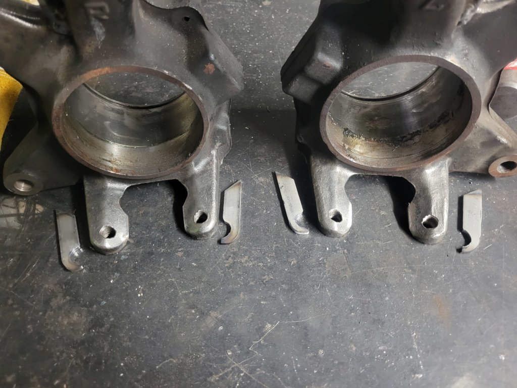

    I started making modifications to the spindles for the truck, before I decided to just go the rest of the way down the Solo Motorsports rabbit hole on it.
    Now those modifications will get finished up for this build.
    20241028_183854.jpg 20241028_200026.jpg 20241029_185409.jpg 20241029_191914.jpg 20241029_185359.jpg 20241029_185253.jpg

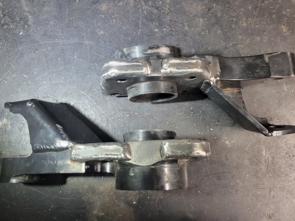

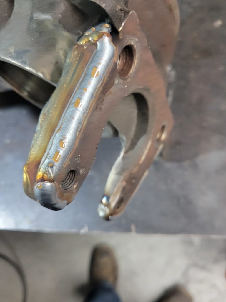

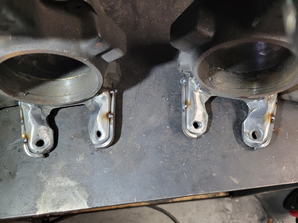

    Reinforcements to the LBJs.
    Dalandser likes this.
  19. Feb 20, 2025 at 6:05 PM
    #119
    El Taco Diablo
    El Taco Diablo [OP] Professional Pinstriper
    Nov 6, 2017
    #235223
    13,979
    Matt - KN6DZP
    Hughson, CA
    Impulse Red DC, 5vz-fe, 4wd swap, LT, dual case, F/R locked
    Just 3 tons of fun!!!
    This allows me to replace the 10mm bolts (original) with 12mm bolts.
    I had the 10mm fail with the Tacoma. It's not happening on Jen's rig.
    Yossarian likes this.

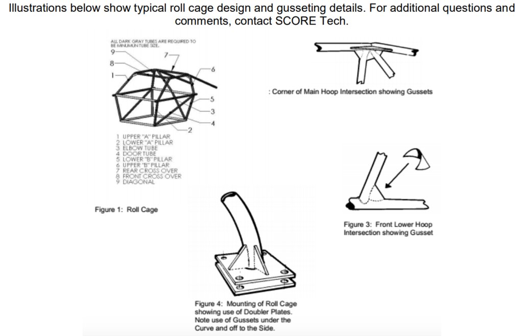

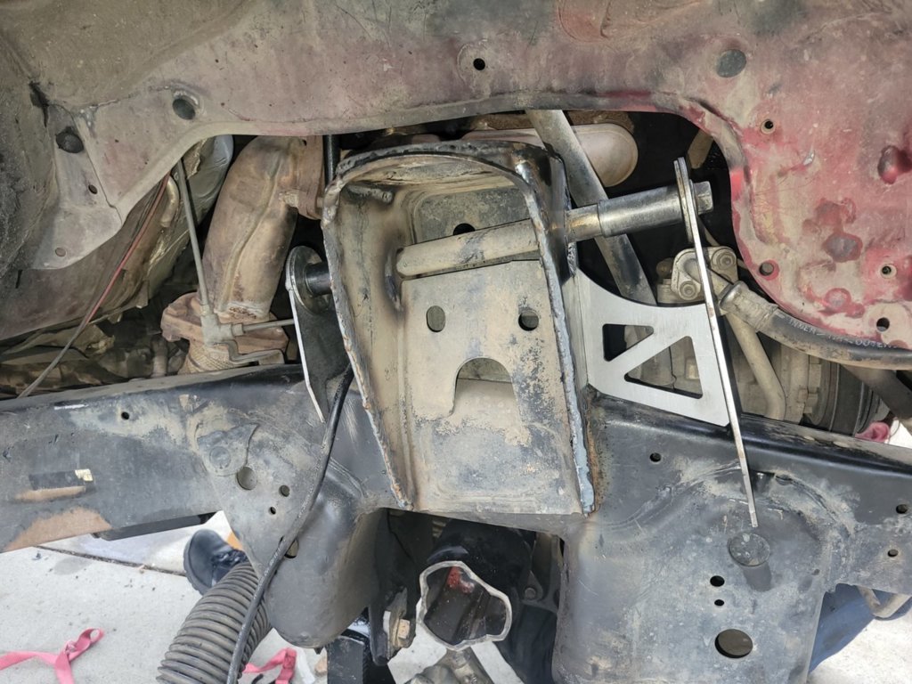

    Frame motor mount perches should be gusseted if you're going fast / racing plus the Bonzen style solid motor mounts.
